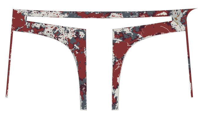

Recently recieved my boba fett helmet from Daz Bobamaker and im gathering ideas and stencils to "attempt" to paint the mother! I have
attached a picture of the mandibles with the weathring on....were do i start basically? Is it a matter of starting with the red then masking the red out for the next colour? then what? Is the rest done free hand??:confused

well, i am no expert on doing layered paint jobs, but i do believe you want to recreate actual damage to the helmet, where the paint gets chipped off, or discolored with grime...so think of the helmet as metal, meaning the first layer should be silver...then you mask off the silver damage using a liquid mask, then paint the grey, mask, then dark red, mask, and finish with the actual mandible color...
i personally painted mine topically...i put the main color down, then followed the stencil for the damage on top...first i did the silver, to give me a good reference for the other colors....be careful to not do your silver damage to large, or any of them for that matter...you want to space yourself out in each area...i would recommend making reference points from the stencil to the area that you are painting...try to print the stencil off the same size as your helmet, then find specific points in the damage, measure, and put that same measurement on your helmet so you dont make the damage too big...once the silver is down, you can then go in with the grey, put it down, and then finish off with the maroon...hope that helps a little...
