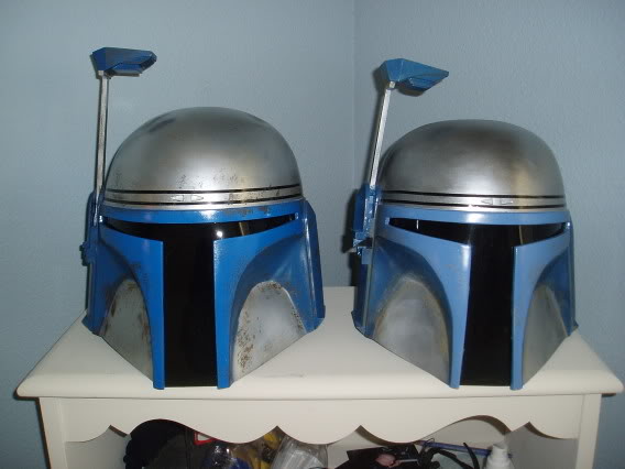

Helmet on the right is a Don Post plastic Boba I changed over to Jango. Helmet on the left is my BKBT I'll be using.
