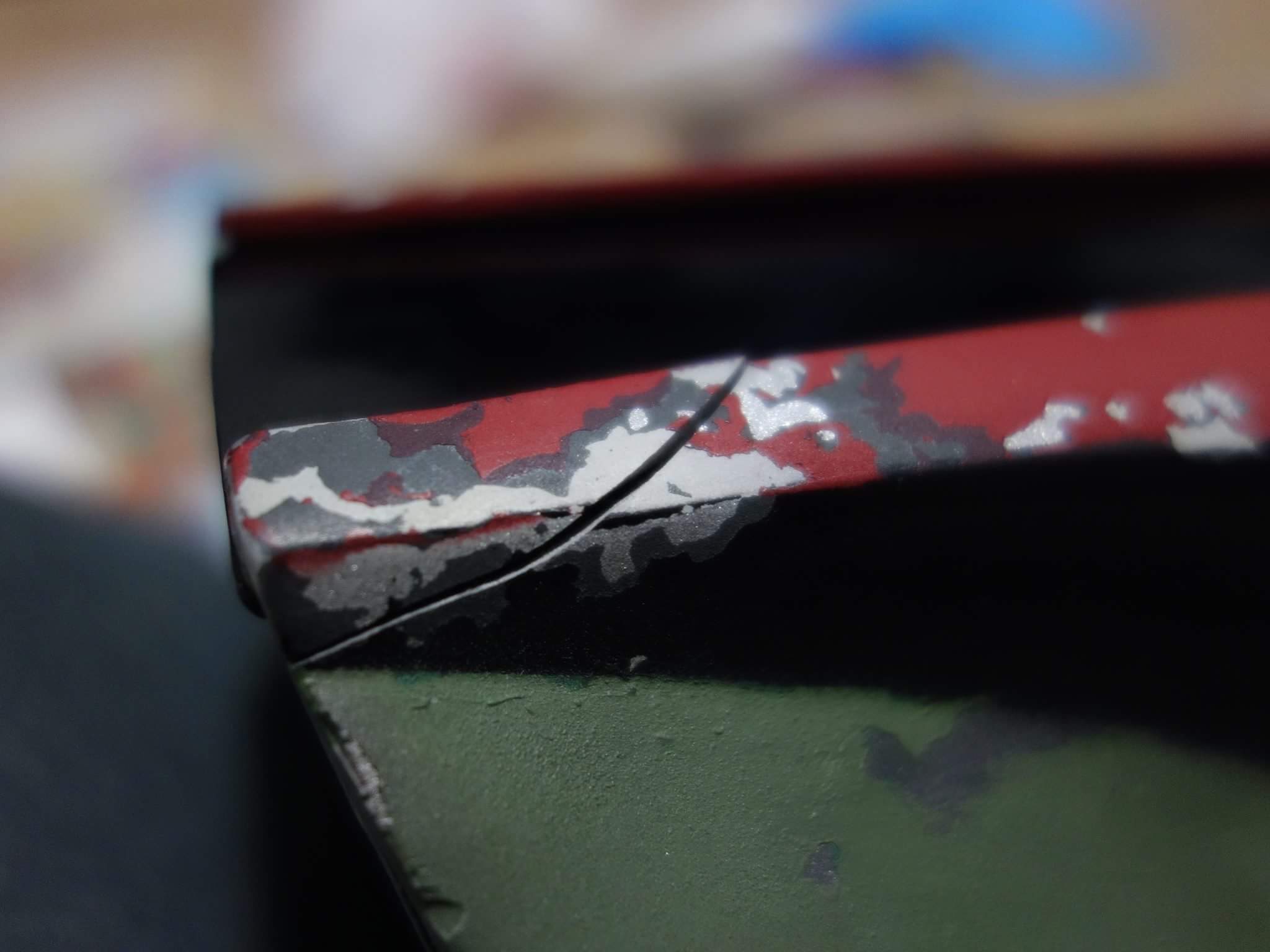

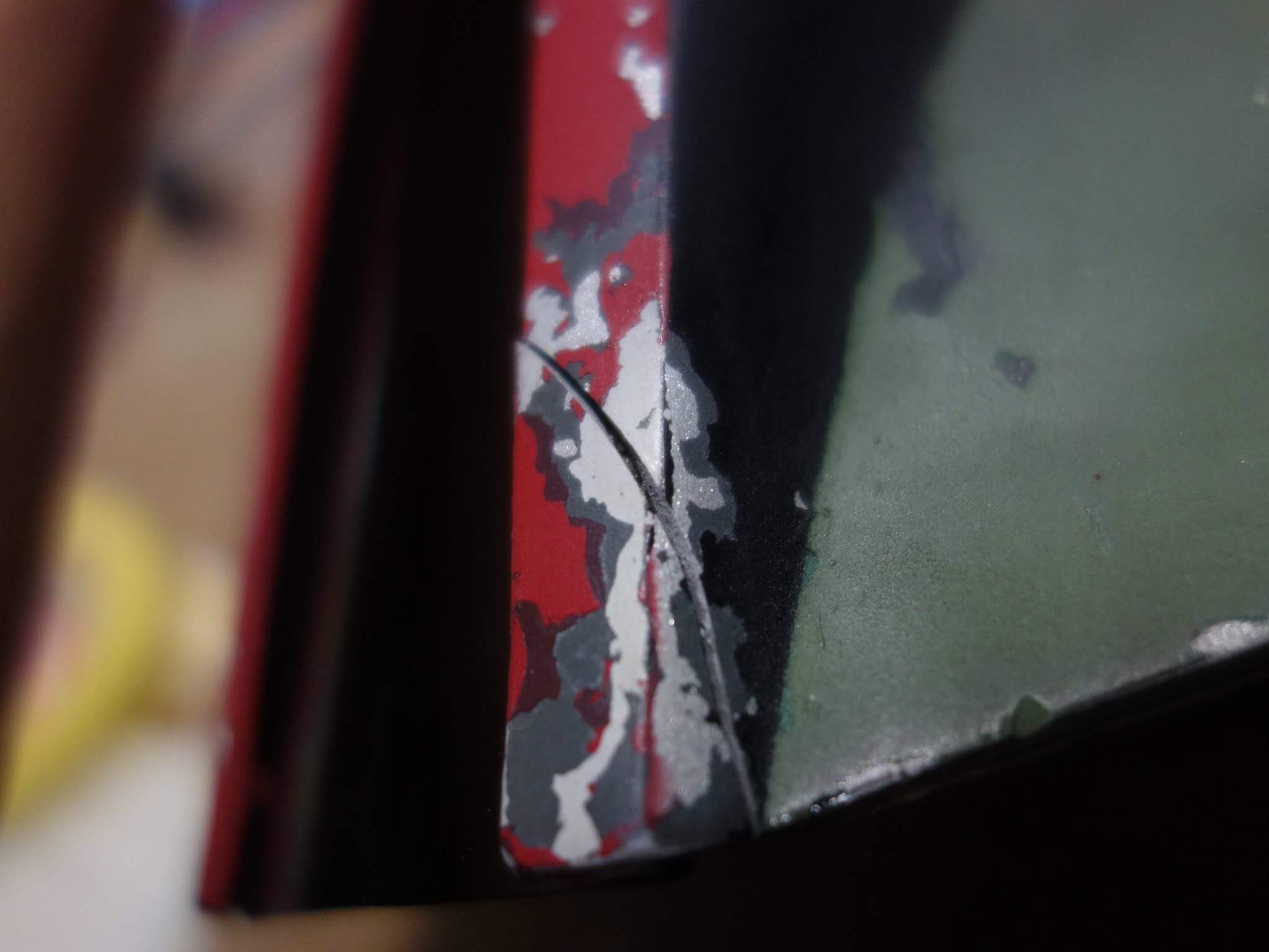

Hey all, I just sold my first helmet, but the helmet supposedly arrived damaged by the post. I packed it very well in a 14x14x14 box will plenty of bubble wrap, plastic bags, and coupon booklets/newspaper adverts etc.
He'd like me to comp the cost to fix the damaged portion, its the bottom part of the mandible where the visor connects. I'll upload pics, basically he wants 100 bucks to fix the damage, I'd don't mind at all to pay to help to fix it to pay for the entire cost to fix it due to it being no fault of my own is a little... out there to me. I offered to pay for half of it, what should I do?
The way he's speaking now it seems like he's trying to scam me. :/ He's telling me it was caused by the tension of the visor being held into place by the nuts.
Dunno if anyone has dealt with a Mike Rosa before. Cruzer have you ever had a mandible crack on a fiberglass AND resin helmet from the tension of your visor installation?
He's a trusted friend to me. That particular area is hollowed out with a small channel that is then backfilled with the t-nut and CA glue. I've never had that happen to me before but an inward hit/pressure at the tip could cause that to happen on any helmet. It could be fixed with a little CA glue or smoothing the area out on the inside and applying a thin coat of fiberglass cloth. If that is your previous helmet on which I installed the visor, let him know he can send it to me for fixing or for purchase and I'll pay him whatever he paid you plus his shipping expenses. Hope that helps.

$200 !?!? That can be fixed in 5 minutes with some UV adhesive. Years back I bought a Don Post Royal Guard here that included a wooden stand. When I opened the box I noticed that the stand was put up inside the helmet, during shipping the stand slid back and forth like a battering ram and blew a hole out the top of his lid, it was also winter which probably wouldn't help a vinyl helmet. the piece that blew out was a perfect match to the hole, I put some UV glue around it, sanded and painted it. All was right with the world again.
