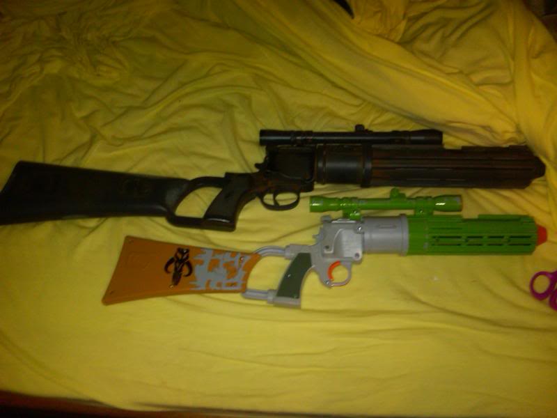

I got one today, too. Here's a pic compared to my MR blaster...
Ooooh, nice. I picked one up at work (I happen to work at Target). Would you be able to post the length of the barrel and the stock? The parts in this picture:

On the MR blaster, the barrel is 9 and ¼ long. Its height is 2 inches tall without ribs and roughly 2 and ½ with ribs. The stock length is about 10 ¾ along the top and 11 inches at the bottom. Height is 4 and ¾ tall at the rear and 2 and 5/8 at the front where it connects to the D-bracket. Does that all make sense?
