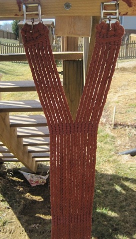

I just ordered a 40" mohair girth belt from horseloverz.com. When it showed up it was ALOT shorter. I measured it and it was 31 1/2 inches. Going to call them tomorrow but after reading this thread sounds like they have changed the dimensions quite a bit. Anybody else have such a drastic change with their order? Now I am not sure what size I need to order. AAAGGGHHHH

Just as a followup. I talked to HorseLoverz.com and spoke with them and the 40" girth that I ordered was supposed to be 36" so it was a fluke that it was 31 1/2. All has been fixed and new one has shipped. I ordered a 46" girth and they measured it before it shipped and it was 42" from buckle to buckle.
Just wanted to update everyone in case they are getting ready to order one. Running about 4" shorter than specified length.
so do you order your actual waist size or 4 inches larger... Confused a bit? working on my Jango and not sure of the length to get...
I needed a 48" belt to fit over my waist and the armor. I read some where on the boards that you need 6" for the straps that connect the two sides of the belt. So I ordered a 46" belt. It measured 42" from buckle to buckle. I know lots of measurements. Does this make sense?
No problem. I hope that was clear. After reading it, I got confused! Just a follow up. I dyed mine today using the method that was explained in these boards with the latex stain. I couldn't be happier! Yeah! Now if the rest of the costume would turn out as well!
