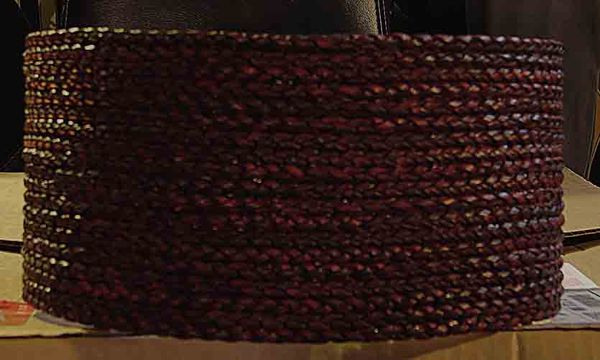

i got the bolo glued down to one in about 2 hours and my fingers are killing me from pushing them tight together..but i did manage to come up with about 5 1/4" with all 19 strands. I'll post a shot of the way it looks tomorrow..i have to get to work now. I was doing mine first but i made this one a tad small so i think jango72 or tony will get the first one..lol as they are the smaller guys ordering. I'll have to see what the final measurement will be seeing as tony is a 35 and jango72 is a 34...

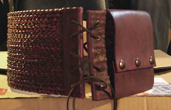

so looking at cruzer's old thread it looks like he made the flap for the back about 5 inches based on my ruler to the computer sceen scaling...so I'll do the same with three snaps to close. I have both silver snaps and weathered dark grey snaps that i grabbed. not sure whats cannon but i kinda like the darker ones, which happens to be the color eyelets i grabbed too. He also had commented that the on screen version used white shoelace to lace it up in the back. I had grabbed leather lace so if you guys want to switch it out that shouldnt be a problem. It's hidden anyway and maybe the regular shoe/boot lacing may be stronger than the lace in the end and easier to tie.

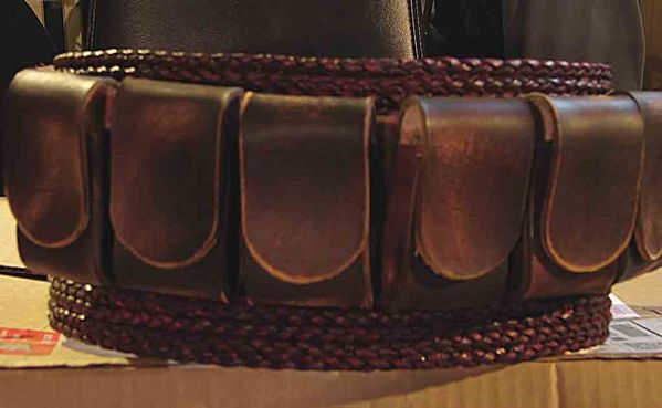

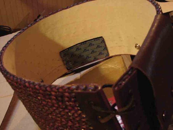

here are some shots of what everyone can expect that ordered one. I actually ended up hitting the bolo with a tad of bismark brown to soften up the redish tint but it looks good i think. The two snaps inside will be for the sides of the cod and the velcro in the center is for the holster center piece to hold everything together. I'm supplying the lace tie but like i said if you want to go with a white shoelace for screen accuracy be my guest to replace the lace! I also included in these pictures what it looks like with my seeker belt i have so you can get a feel for it with the ammo pouches... let me knwo what you guys think...my pictures came out a tad over exposed for some reason so i played with it in photoshop a bit to match the way it looks in person.
if you want to darked the leather cover and edged a bit to be more brown i would suggest using a little dark brown dye over what is there. I started with some mahogany(1 part) to cordovan(2 parts) to reducer(2 parts) and then brushed some bismark brown over that mixture as well as a touch over the bolo. I tried to match it to the contrast i could see in the reference pictures using my seeker belt shade as a starting point. I would also suggest a good weathering to this using some corse sandpaper and lightly rubbing the belt to rough it up a bit
