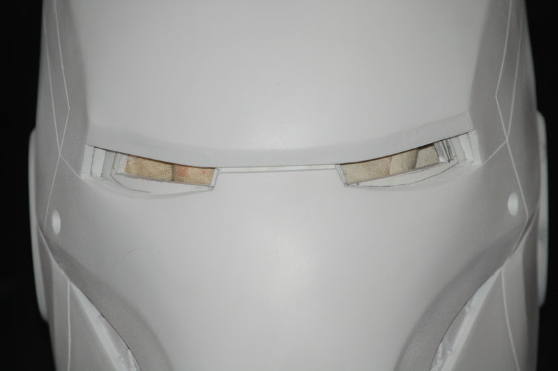

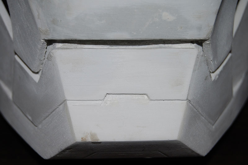

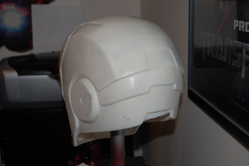

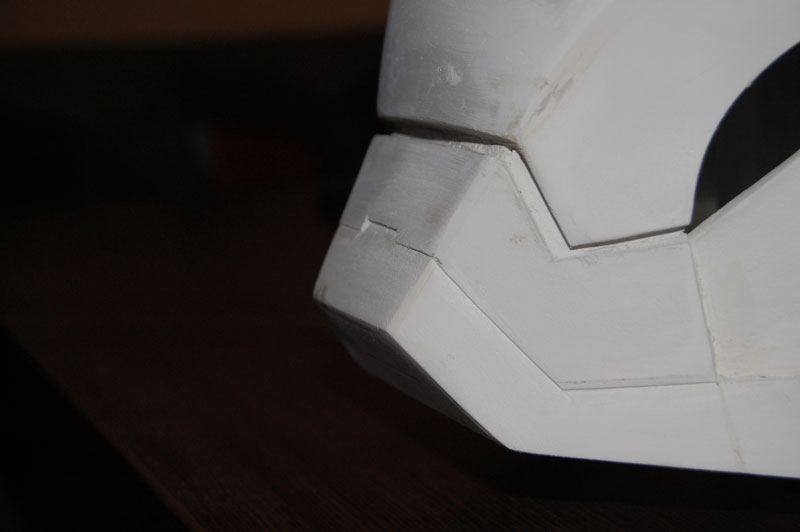

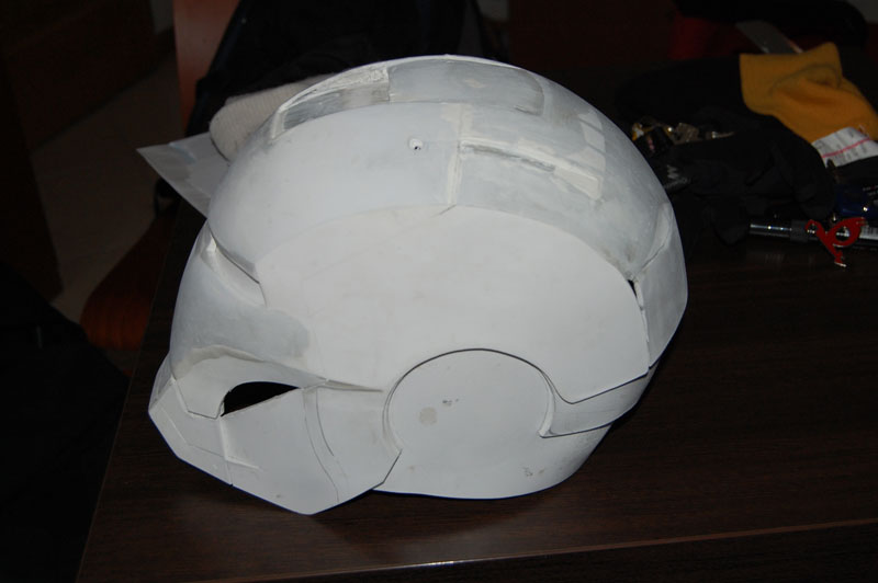

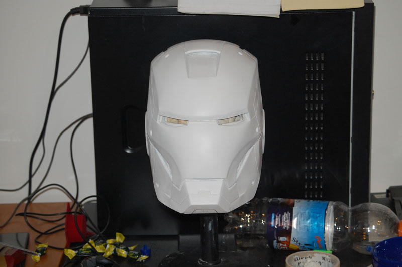

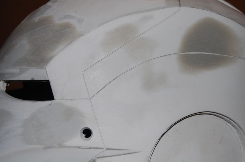

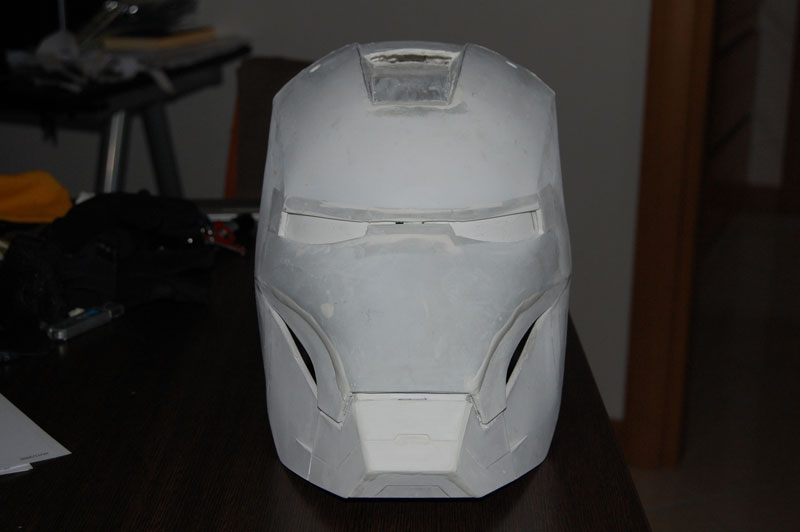

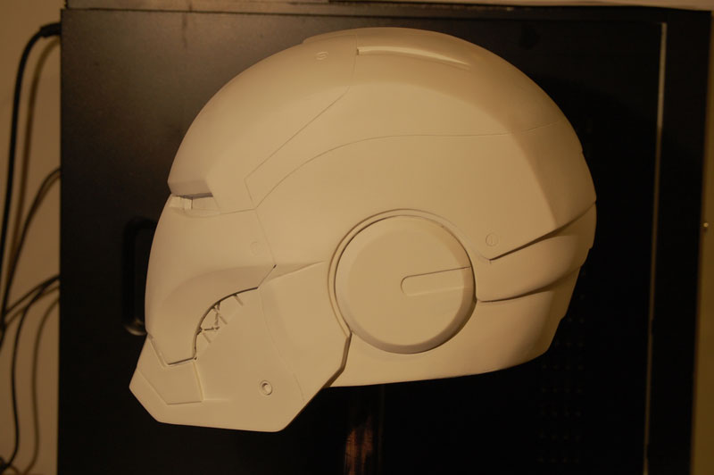

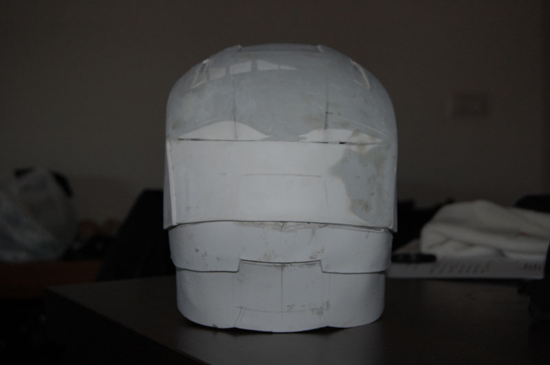

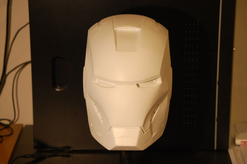

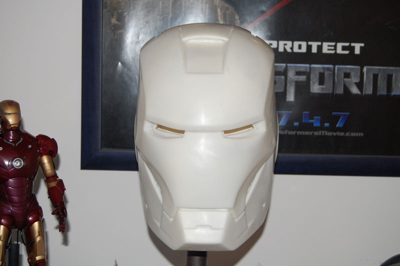

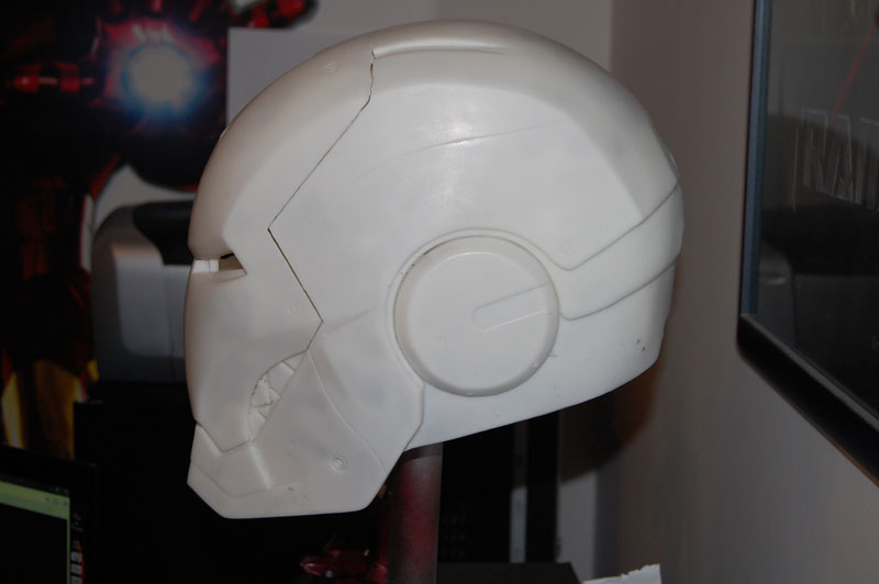

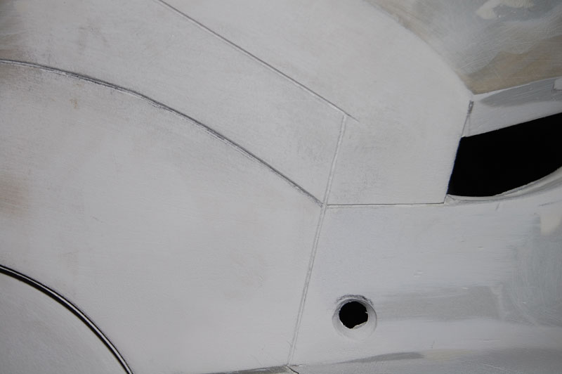

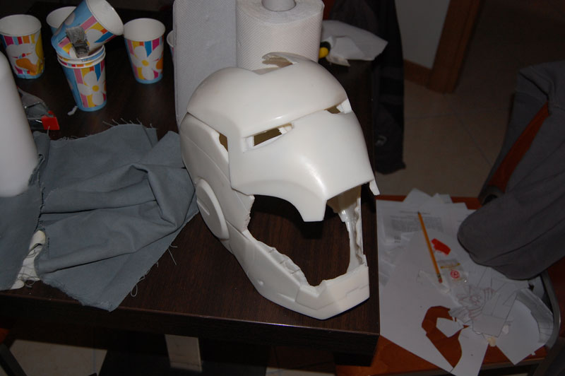

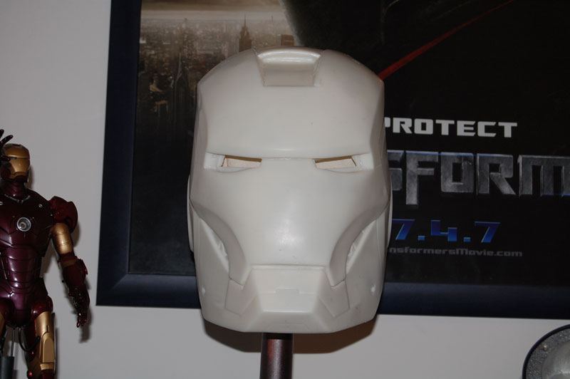

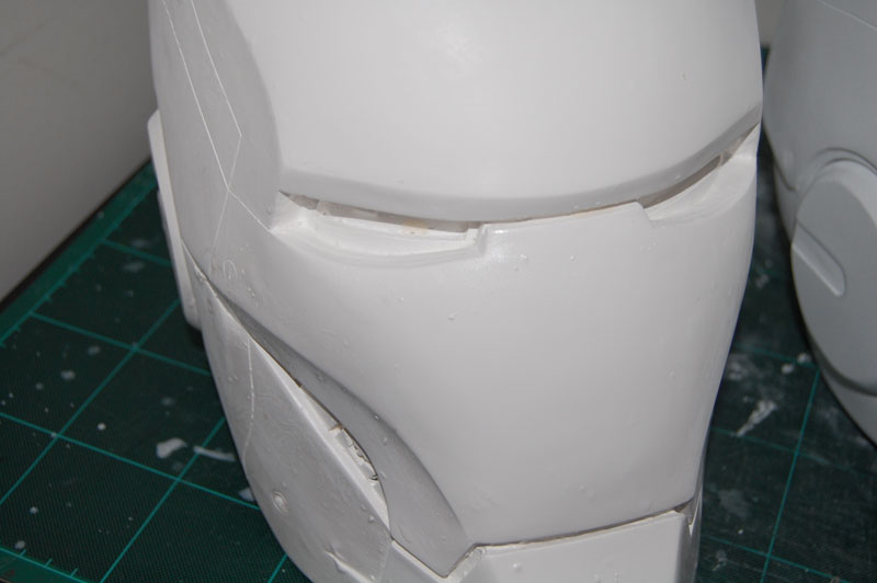

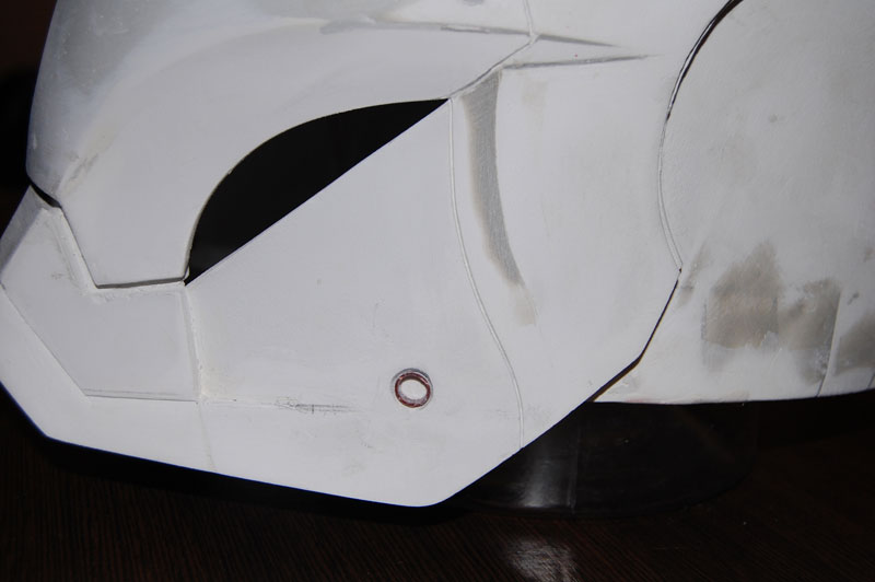

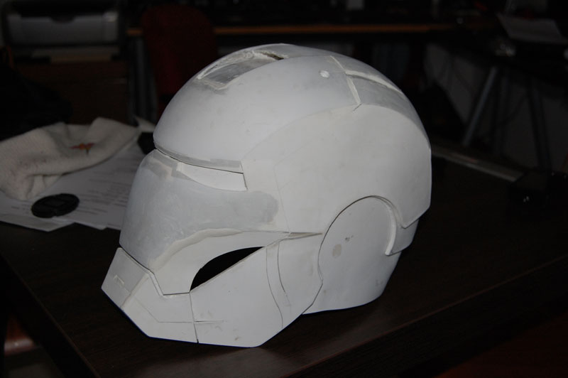

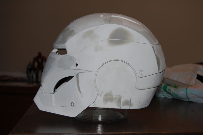

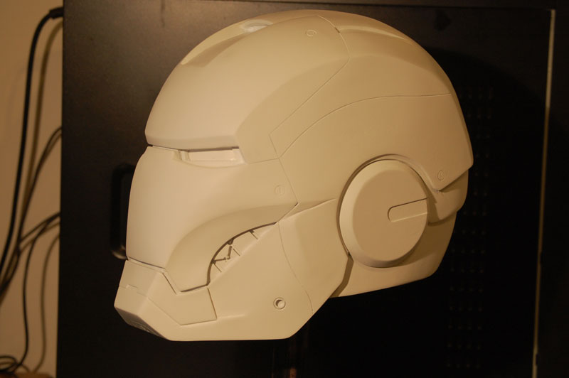

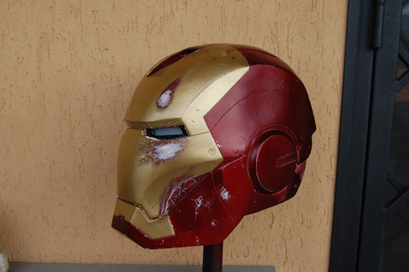

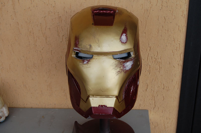

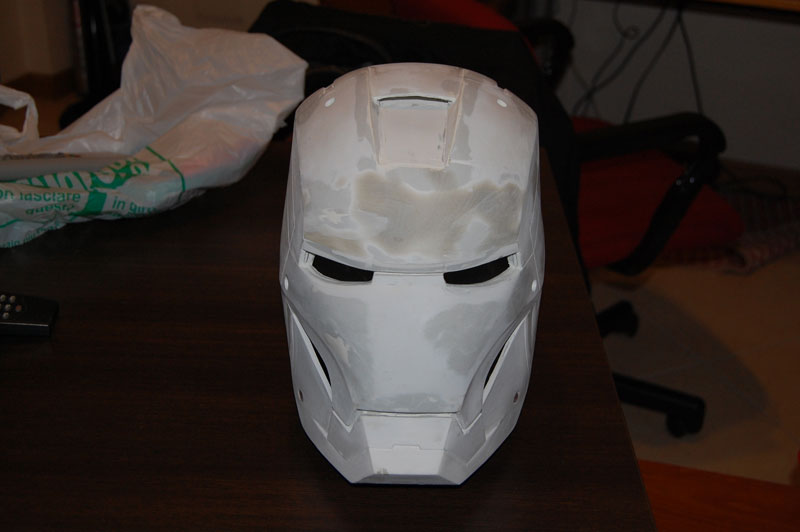

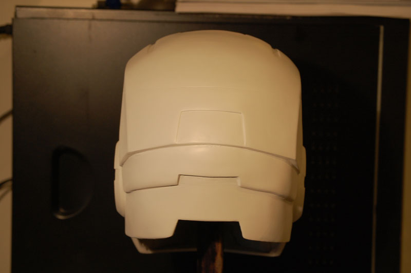

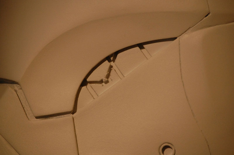

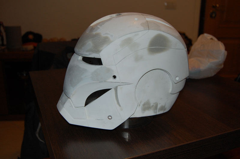

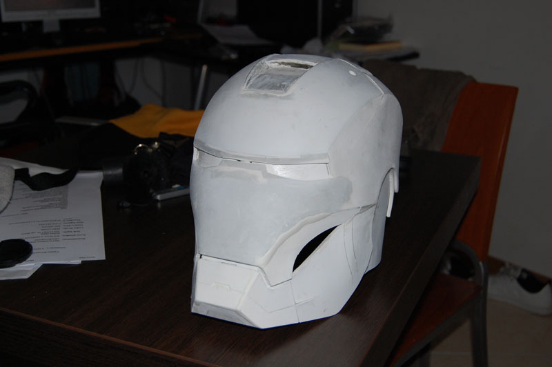

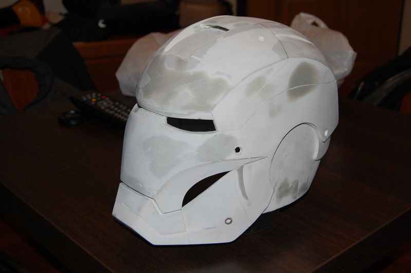

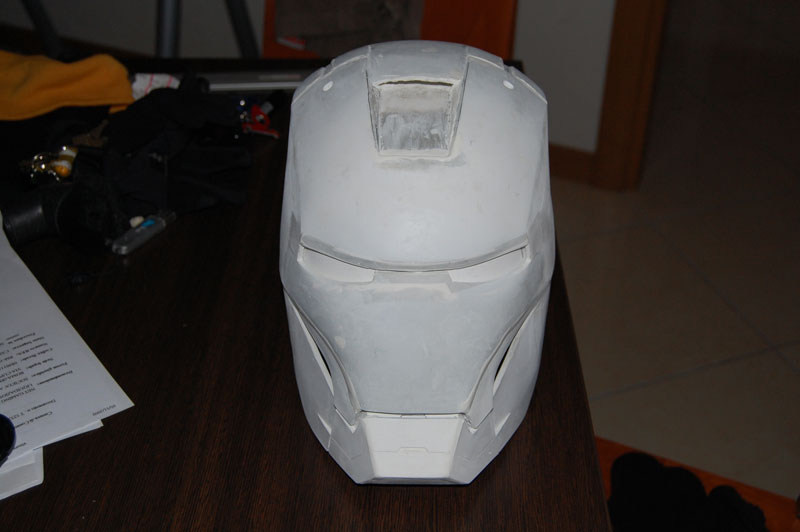

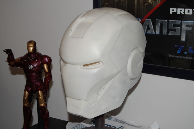

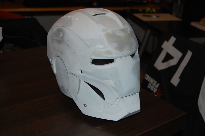

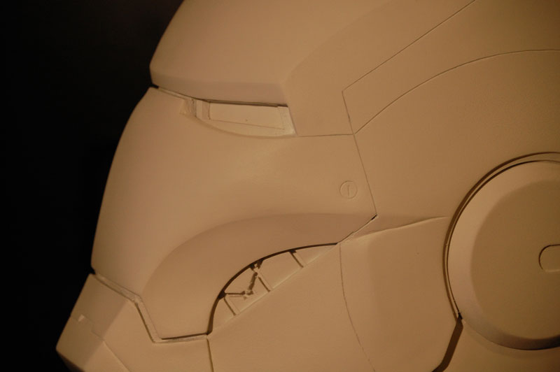

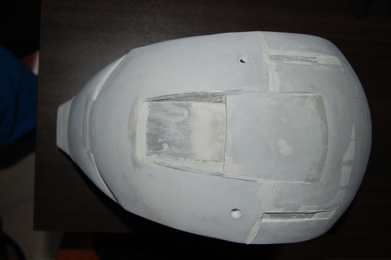

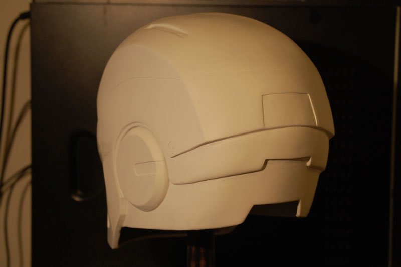

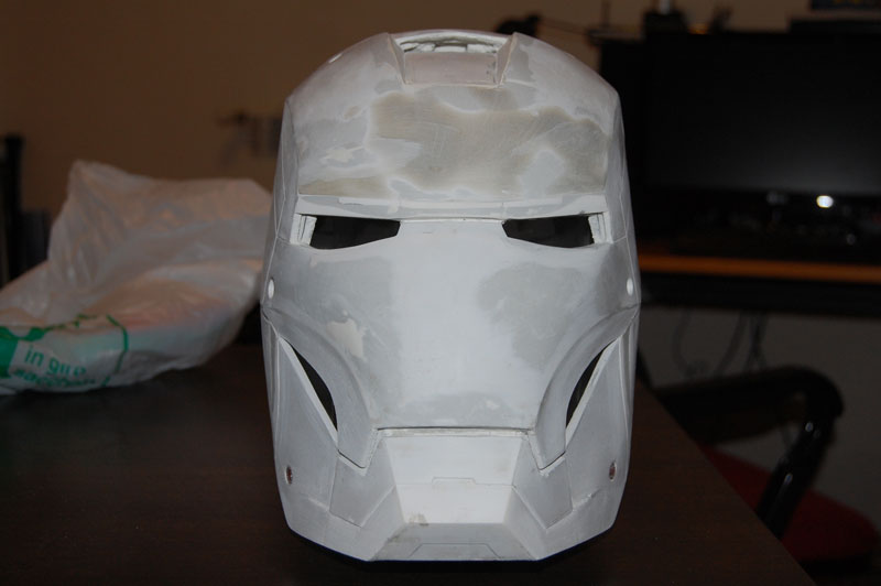

The helmet was first created on a flat template on photoshop using sideshow bust as visual reference, I then moved the template to a sintra sheet and then I cut it and started to shape it.
Other materials used in the process where milliput, bondo and final tamiya putty to cover little holes and dents.

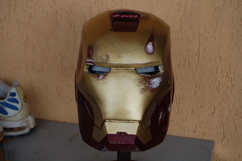

It's been an awfully difficult and time spending job, but the final result was really worth it.
I'm really glad with the way it turned out.
Hope you guys like it.
For any questions you might have, please go ahead and ask, I'll reply as throughly as I can ;)

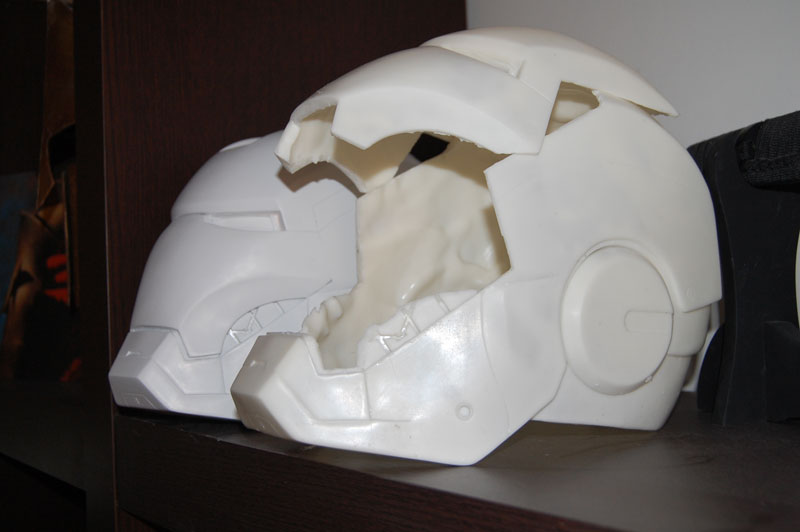

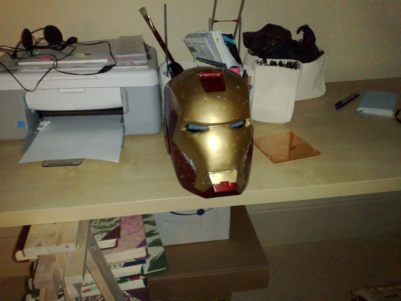

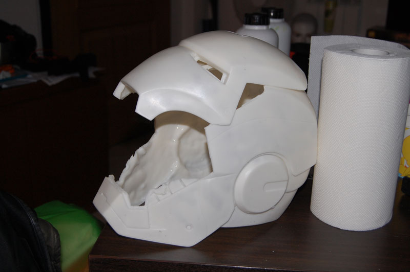

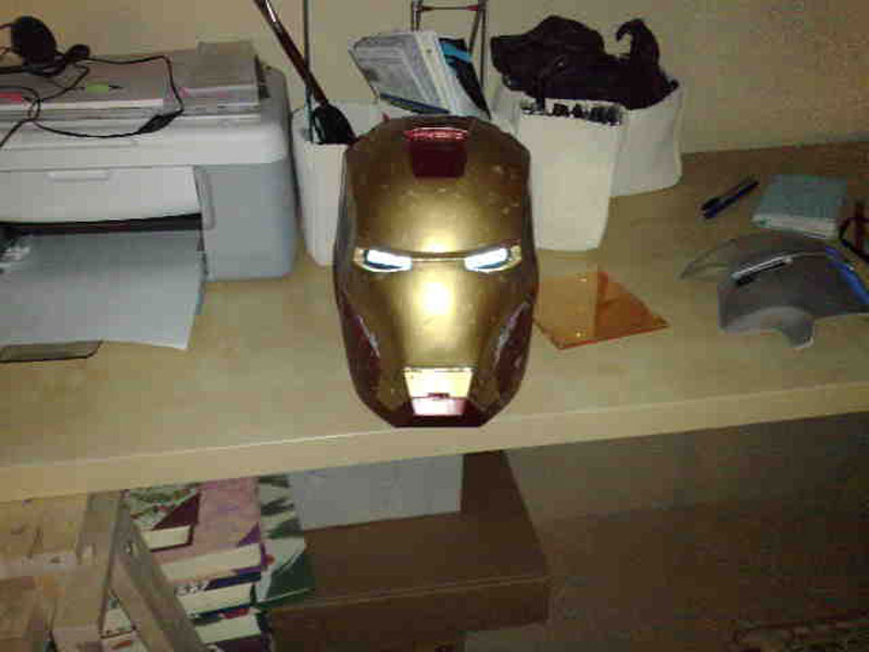

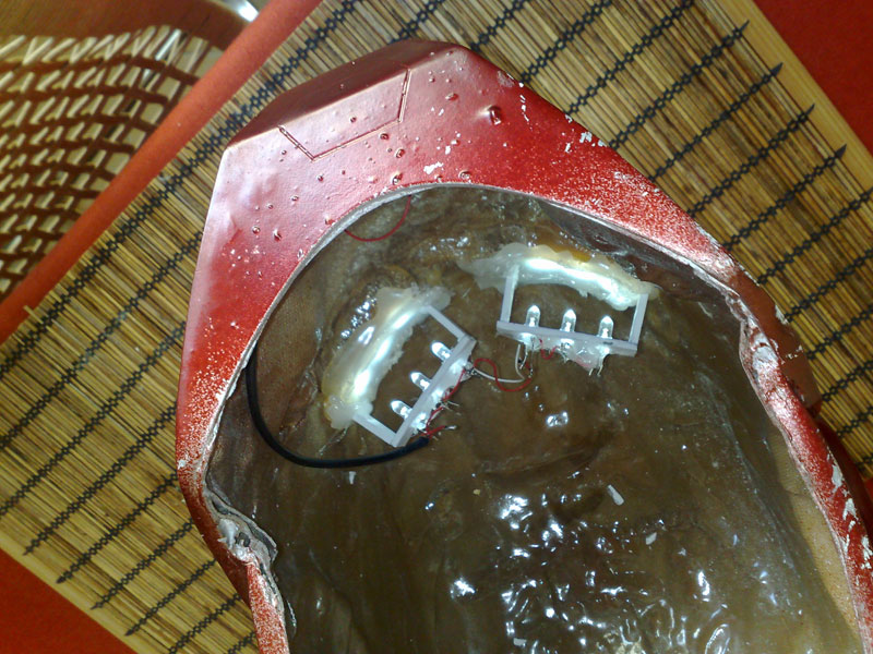

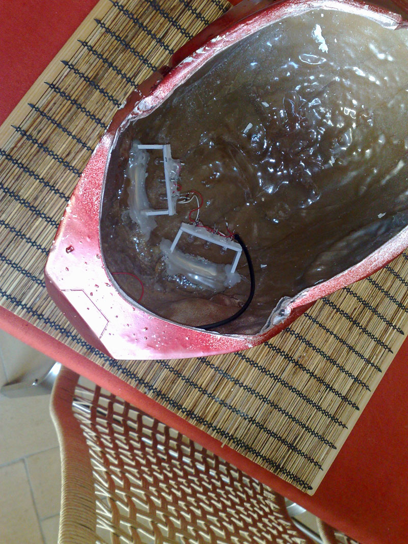

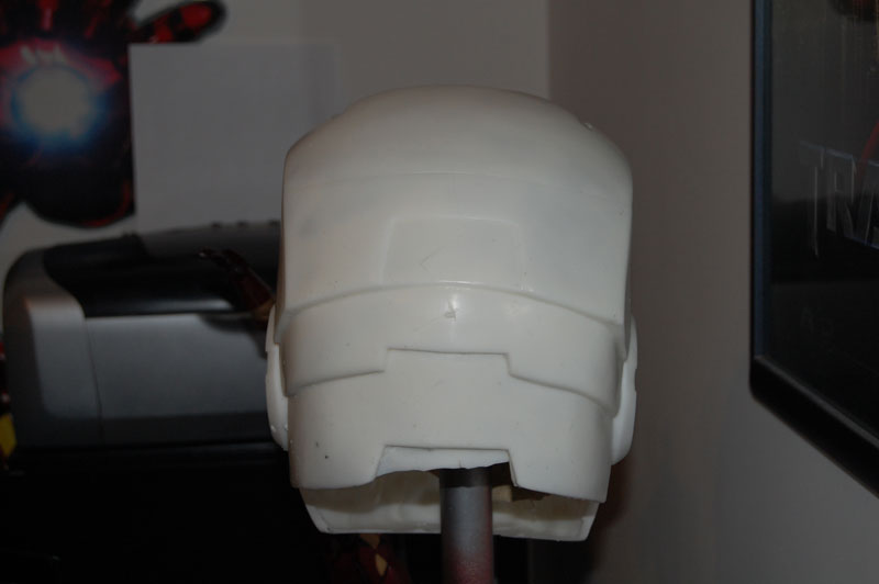

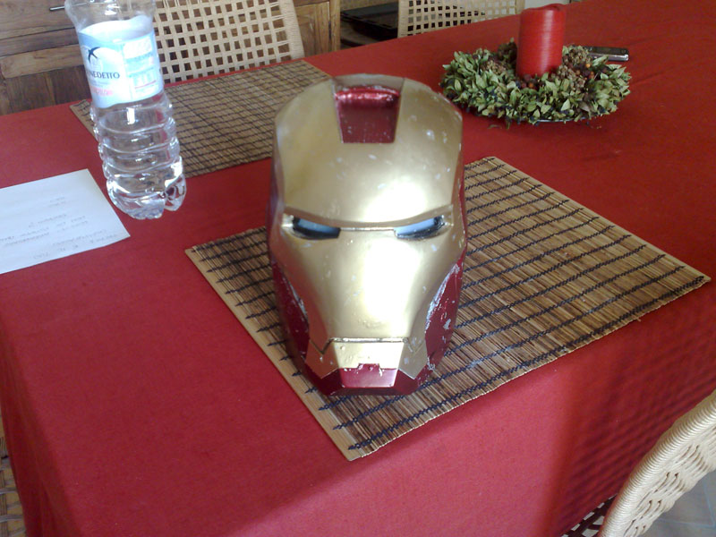

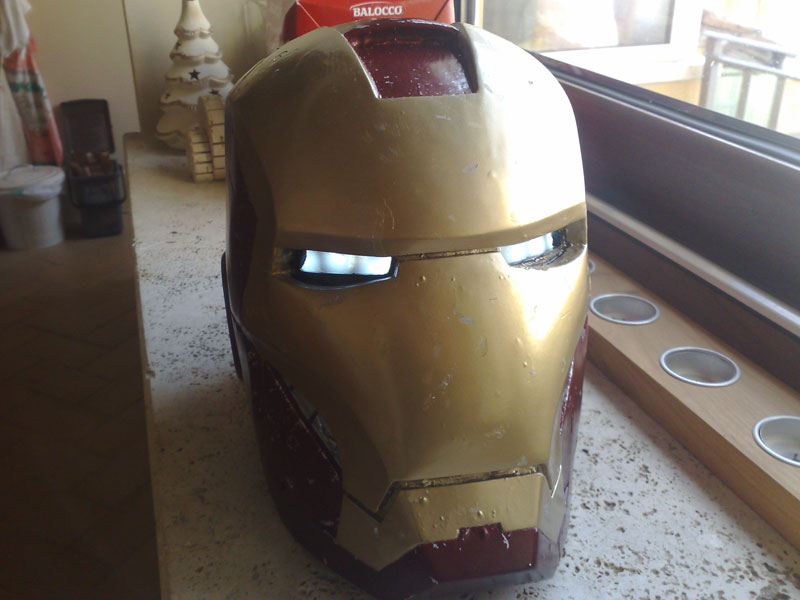

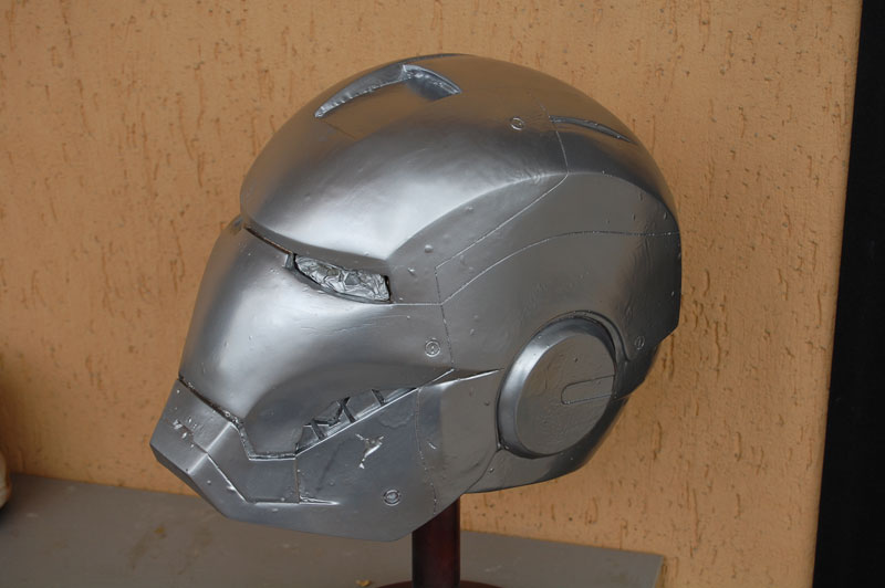

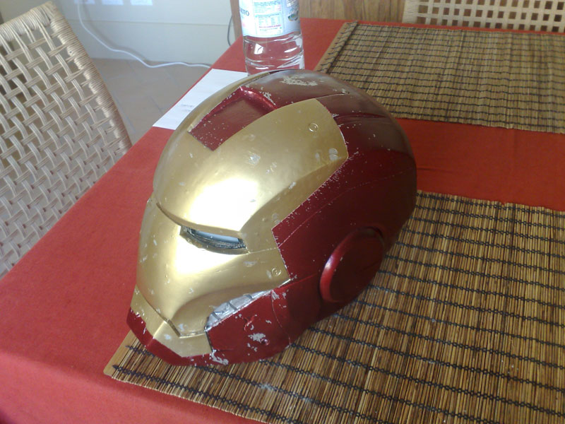

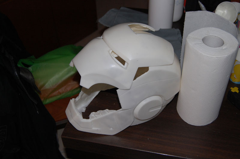

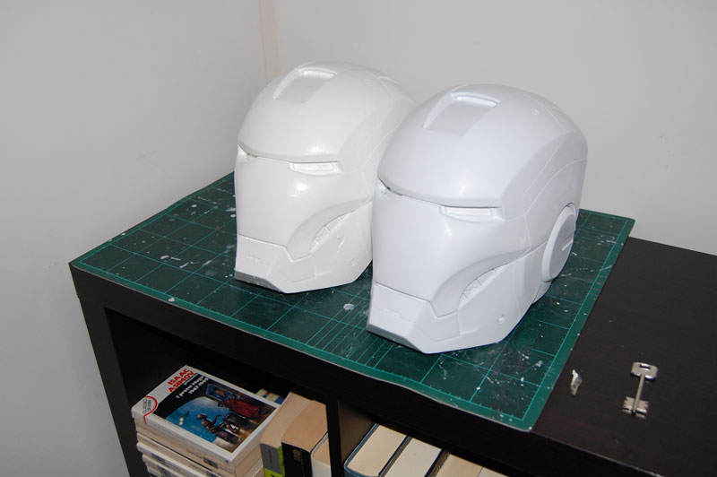

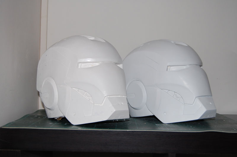

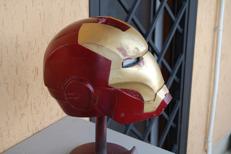

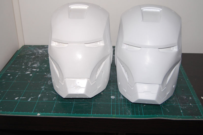

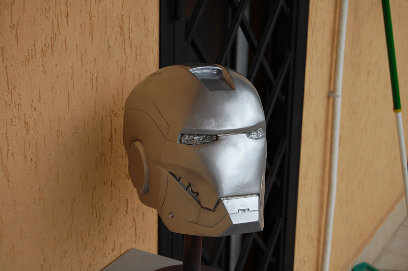

Ok, the first cast you see, was pulled from a mold that didn't turn out pretty good.

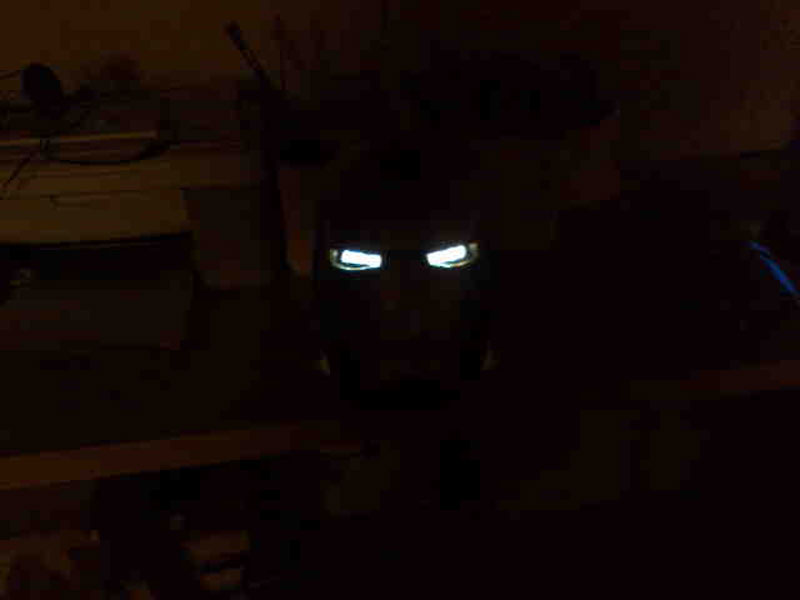

But I had to give it as a present so I couldn't even fix it...didn't have time...I went on to paint it, hurrying that too...and put lights in.

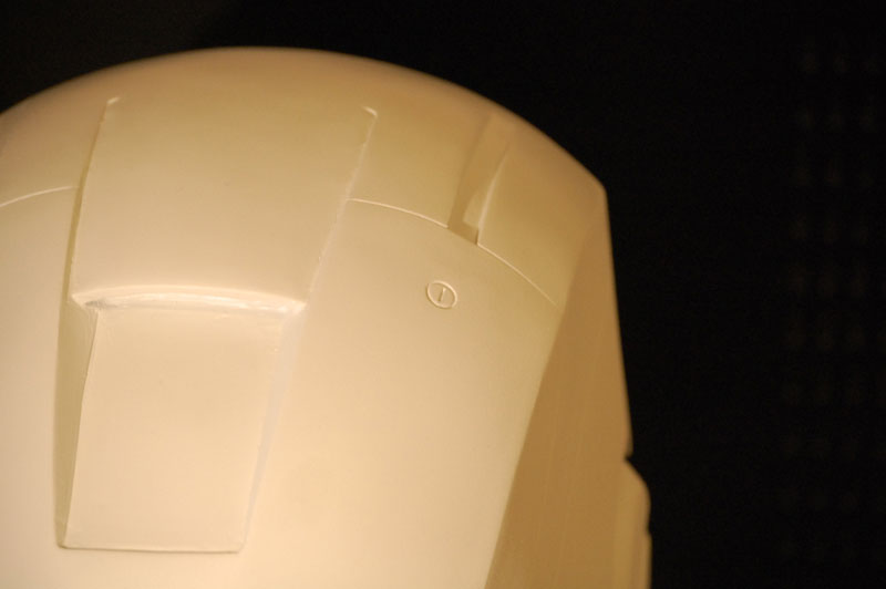

I'll post the pics of the new mold and cast in the next post under this one
