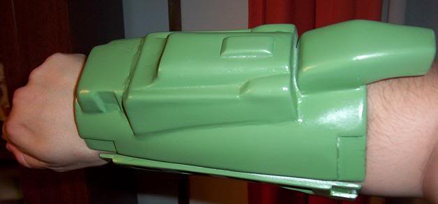

I've completed the MK2 version of the lower clamshells... and managed to un-stick my fingers! :lol:
After Alan and I chatted about some areas that needed some minor adjustments on thickness etc, the final set of templates were born...
I'm really happy with them - especially the way they form around the arms.
Next I'm gonna try and mould the lower left clam and add the upper section to the right...

CGN... I used 1mm Foamex board and layered it with the inner and outer halves, then included another 'rim' to give the clams further depth? Hope that helps? or I can send ya some pics if ya want?

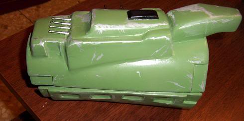

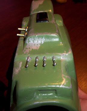

jejeje...here more progress, incluided darts from my own recipe... :)

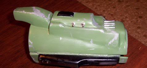

Ahem, so I have a question... Can someone post a picture of the back end of the left gauntlet? I cannot figure it out! Or find a picture... It has the strange little cut out, and...I'm not really sure what's going on. Any help would be awesome!!!! PM's work too. :)
I'll post a picture of the right gaunt as soon as its cleaned up and less embarrassing looking... lol It's sturdy though! I can through it at the wall without worry. ;)
thanxs Kasssh, thanxs Mojo...
Violentyoda, this is a pic from a member (is he don't want I show this one, I will remove it...) is the only I have thats show the back of it...
hope that help
