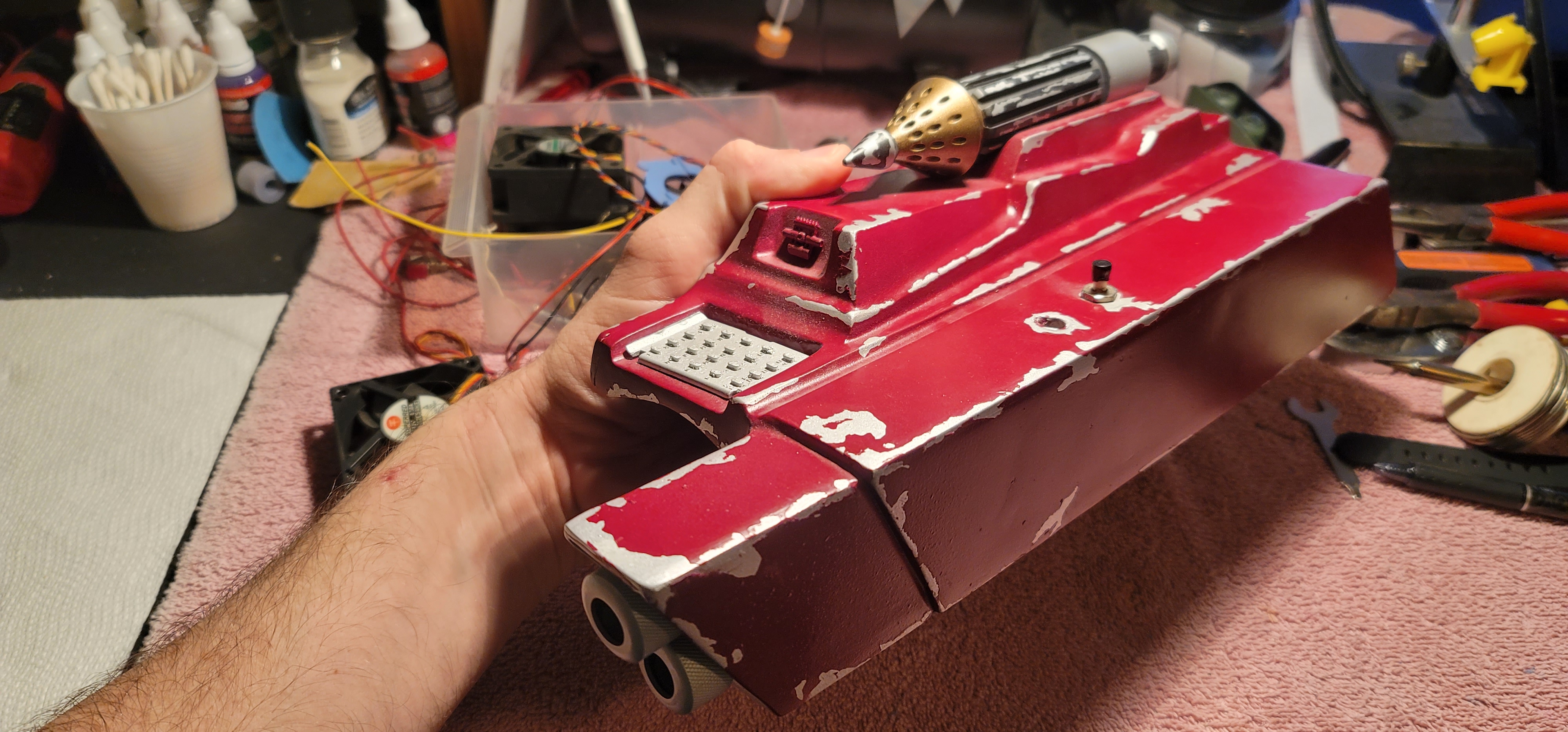

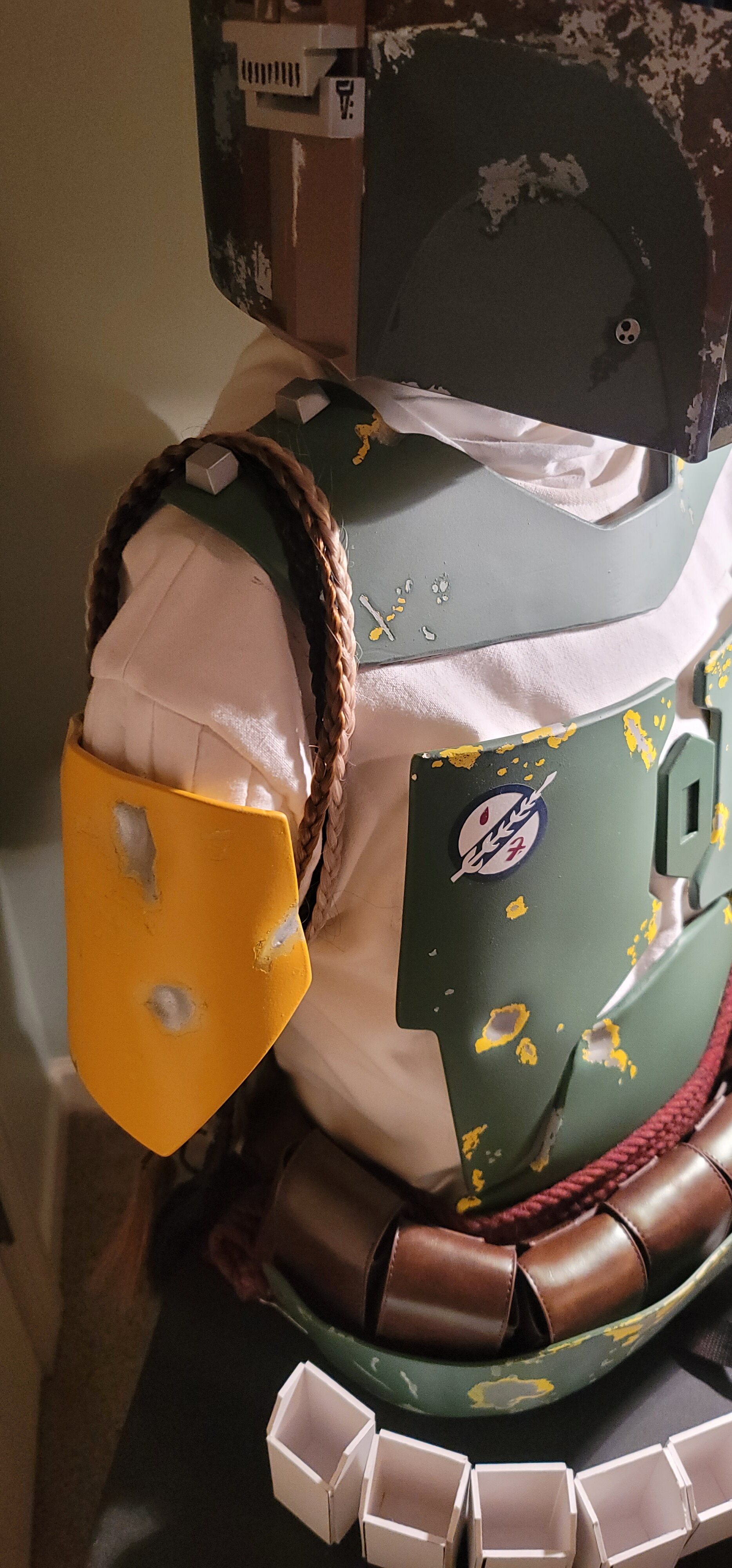

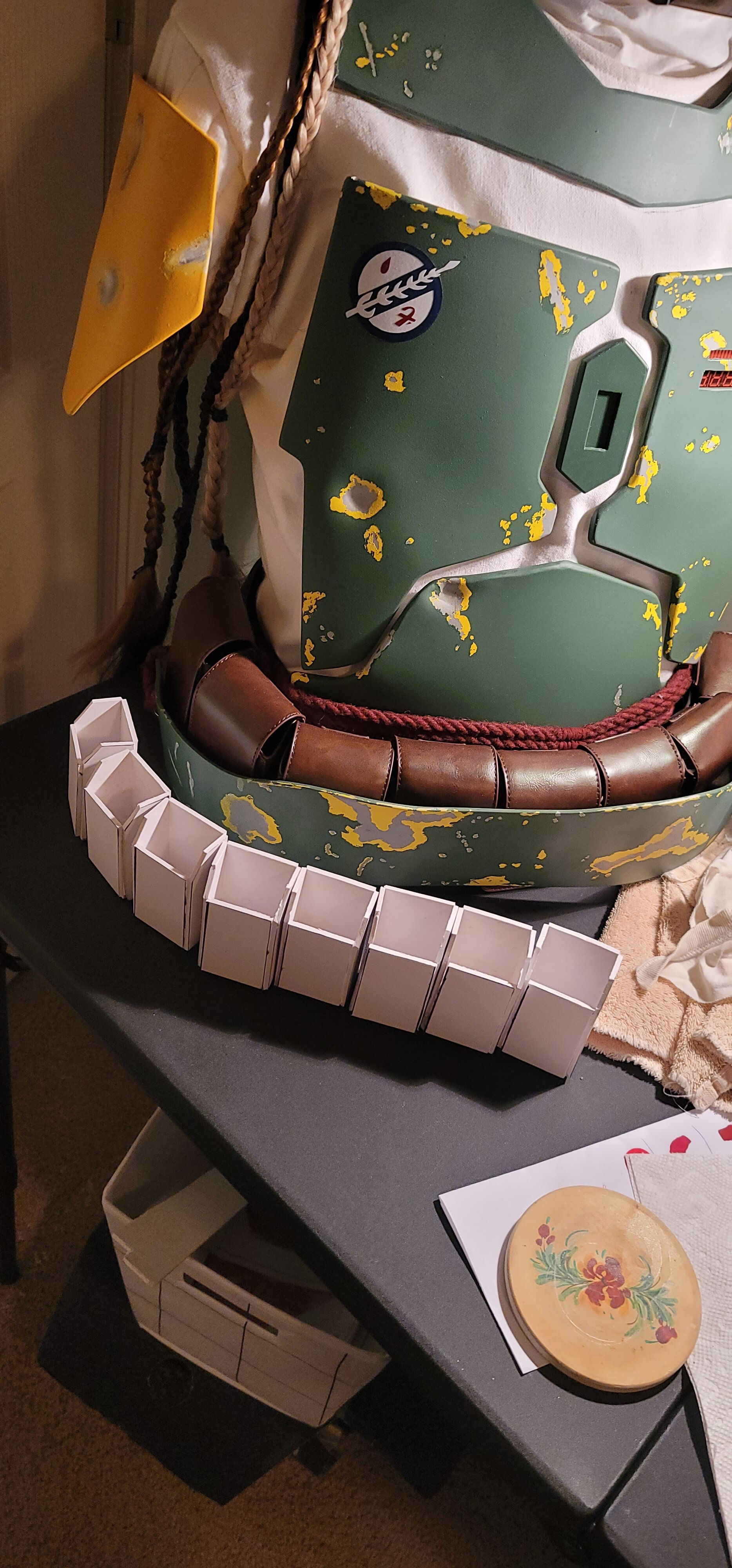

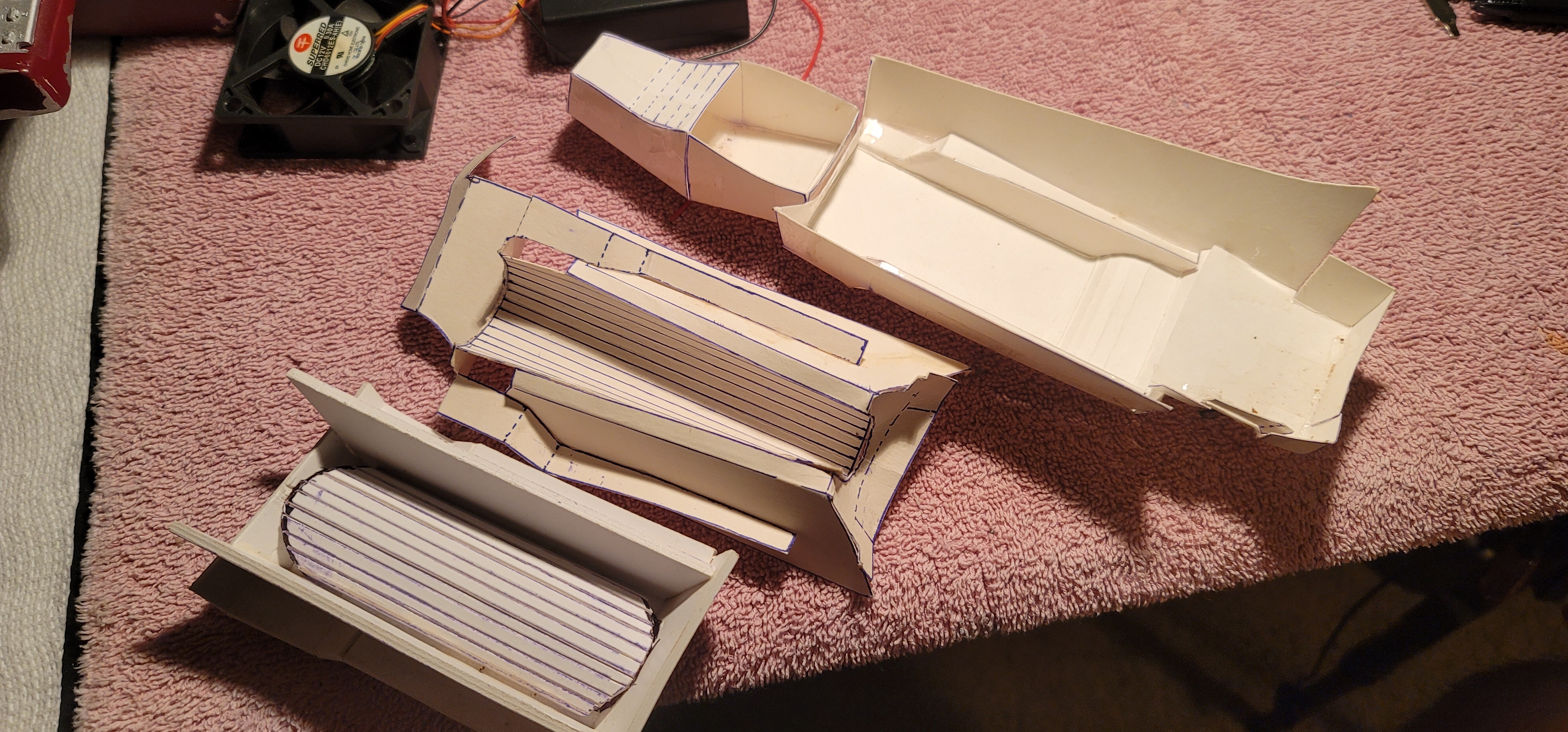

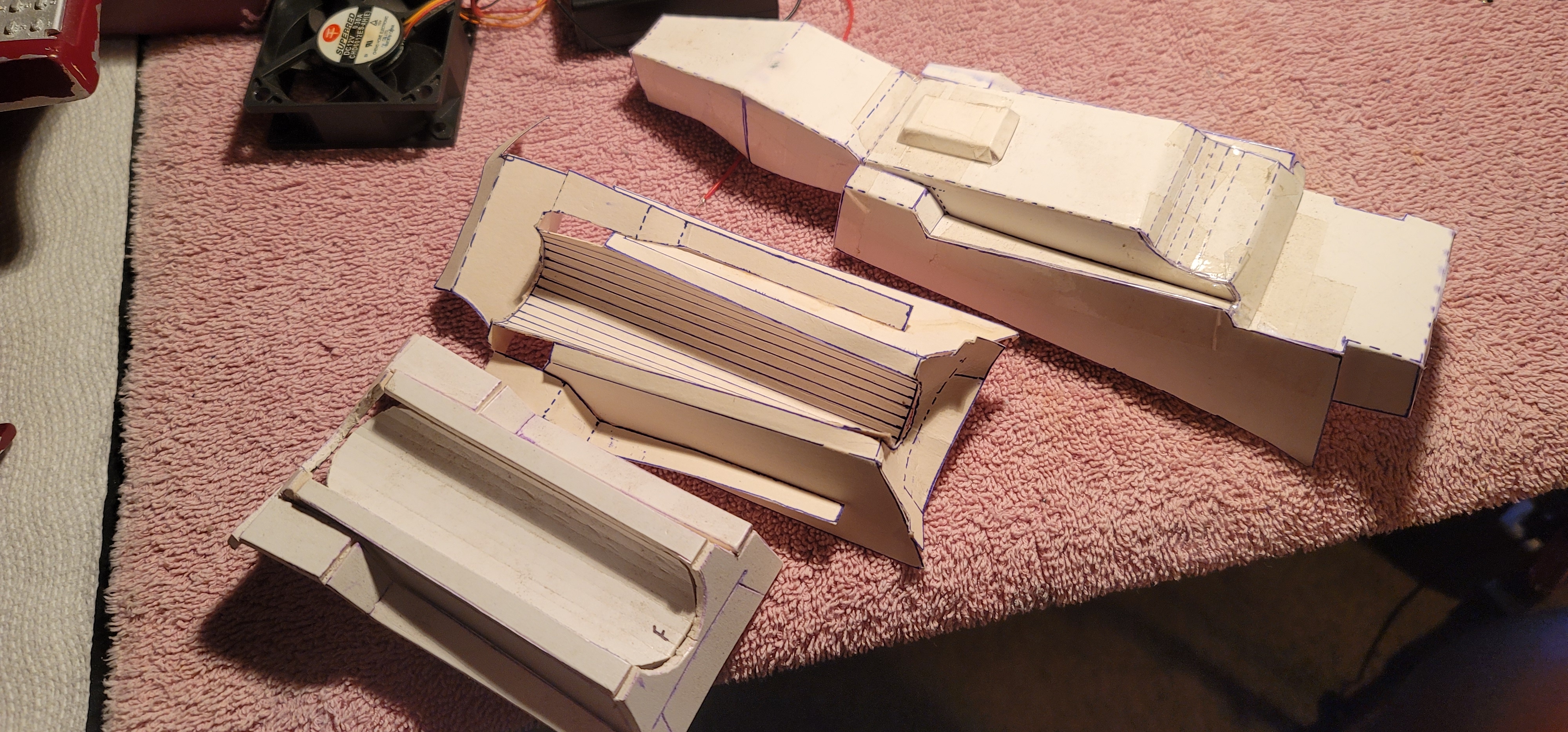

Hey guys, thought I'd add my experience with this topic and share my results. When I began this project, I had in mind a budget build, yet possibly worthy of the 501st's approval. I used WOF's templates for the all armor pieces with exception to the bucket. I found the templates super easy to follow and work with. For the gauntlets, I printed them, cut them out and laid them to card stock for a rough mock-up assembly using superglue or scotch tape. Once satisfied with how easily the went together, I got a 4'x8' of 3mm sintra from a local sign shop. Originally, I had planned to build the JP with sintra, so got an entire sheet. Anyway, here's a few pics of the process.

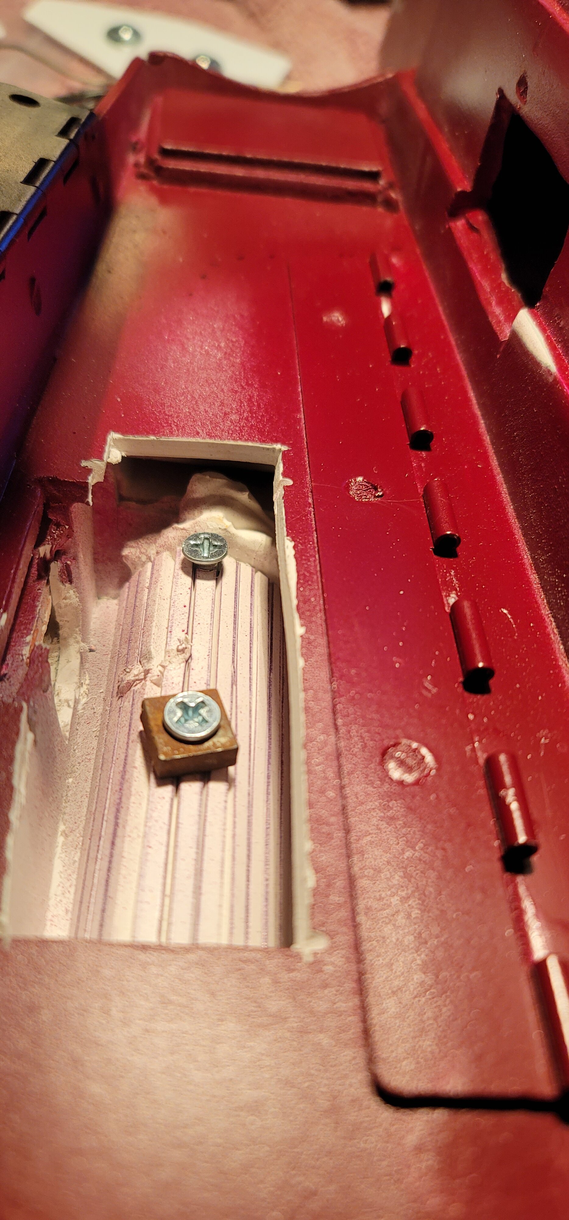

For the curves, radius and contours, I just scored the sintra, enough to make the bends while keeping the material together. You can see what I mean by the underside of the rocket nest.

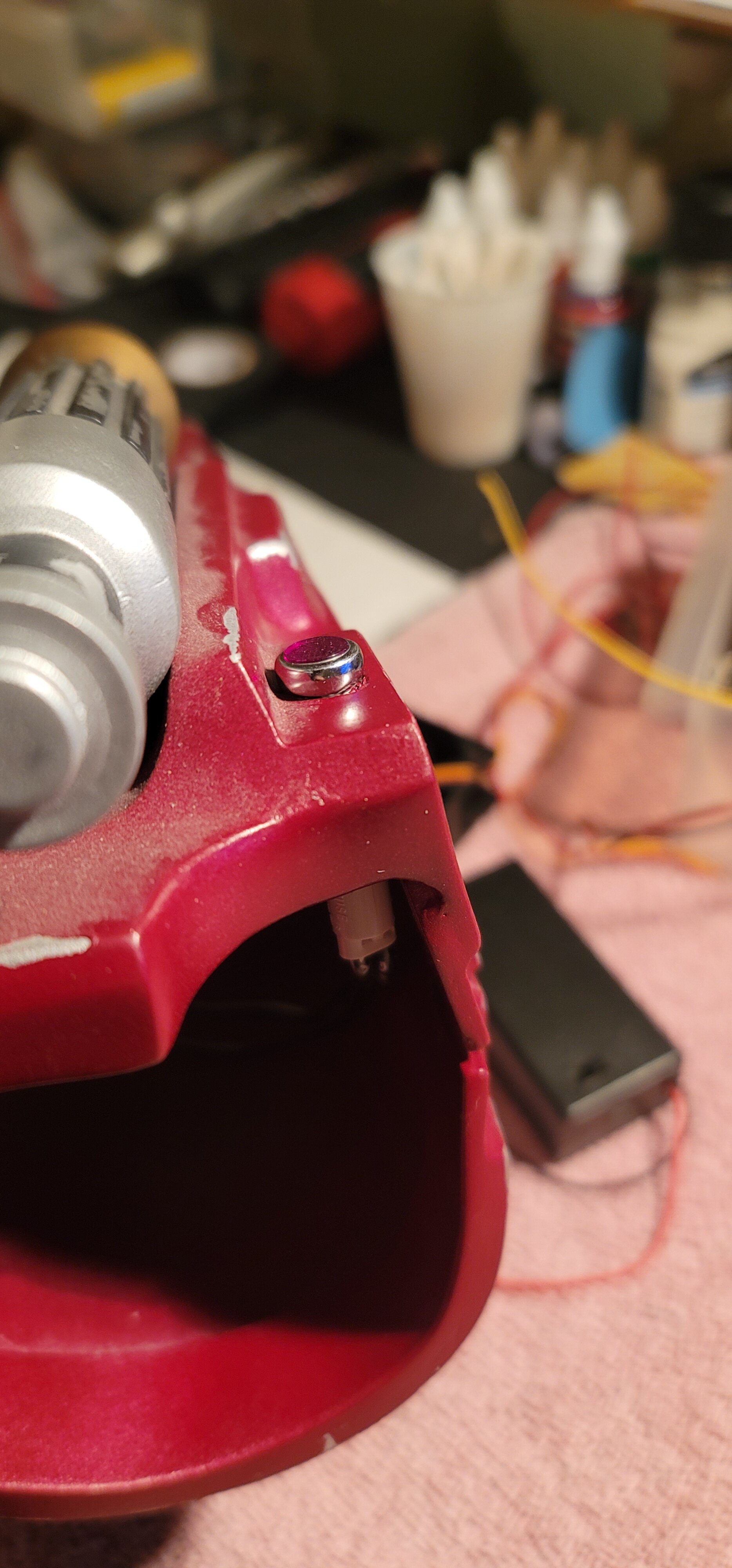

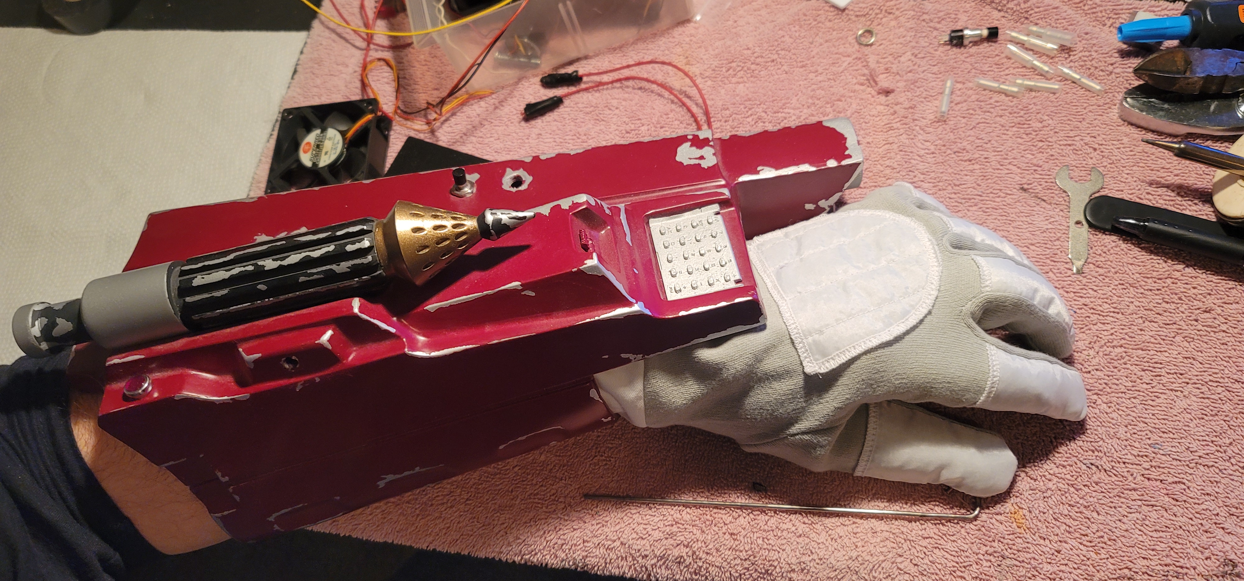

Assembly results...

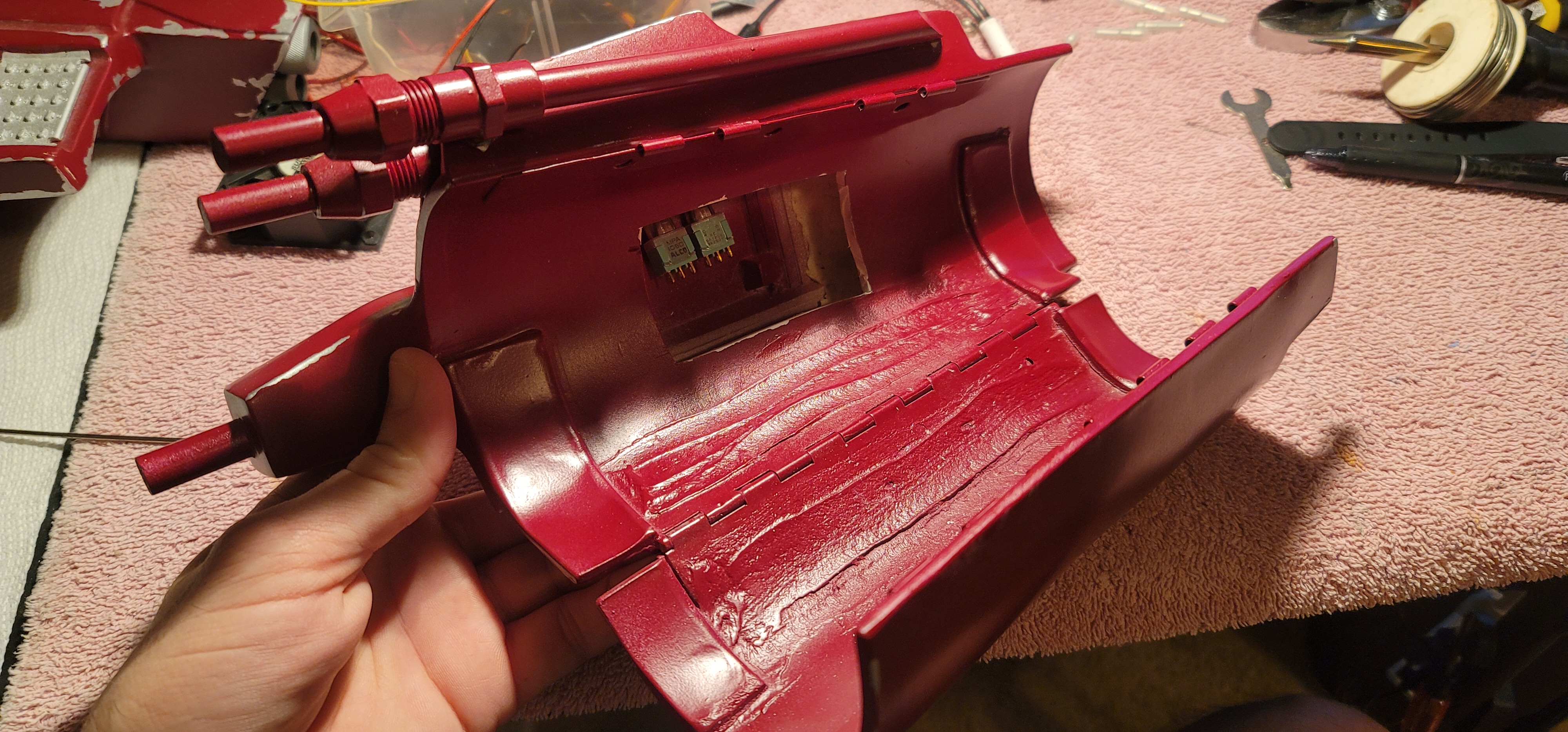

I still have a ways to go to get them completed. Wiring the leds for the flamethrowers and the corner contant-on red led, weathering, etc. Considering changing the piano hinges for velcro, as putting them on requires a 2nd set of hands.

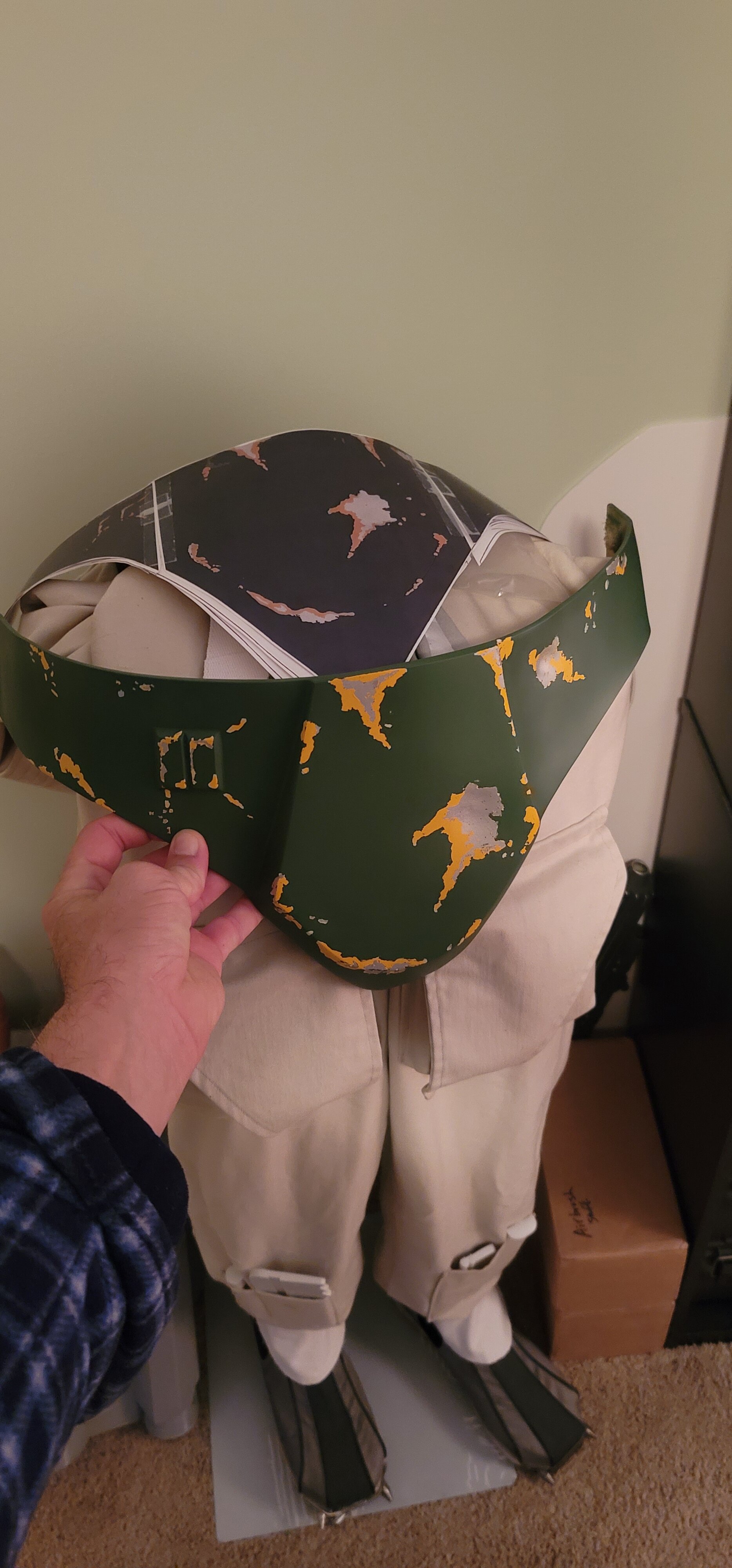

Here's the rest of my 1st attempts with sintra armor.
