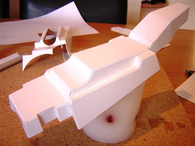

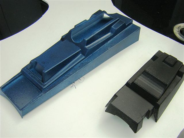

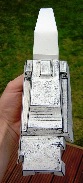

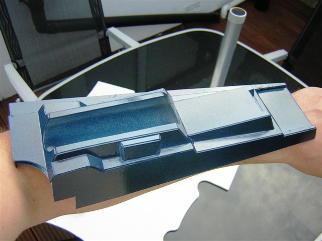

I know that I have been away from these for awhile and many folks have been asking on updates for Boba’s gauntlets templates. Well you are in for a pleasant surprise. I have to admit that I have been extremely frustrated at my lack of progress on these templates. They have been the most time consuming and complicated Fett project that I have done so far. So at the encouragement of MOJO-Fett (Gavin) I have managed to finally get the draft set of templates near completion and Gavin took on the tasks of reorganizing my mess of template parts into a much more user friendly form, from which he has done a fantastic job assembling the prototypes. Thank you my friend!
There are a few more thinks to work out before the final templates will be posted, so stay tuned!
Material used is 1mm Foamex (Sintra) So on to the pics;

Thanks to Alans great work...:thumbsup:
Ignore the colours, I only wanted to show some colour on them as it showed more of the details... (only cans i had) :lol:
