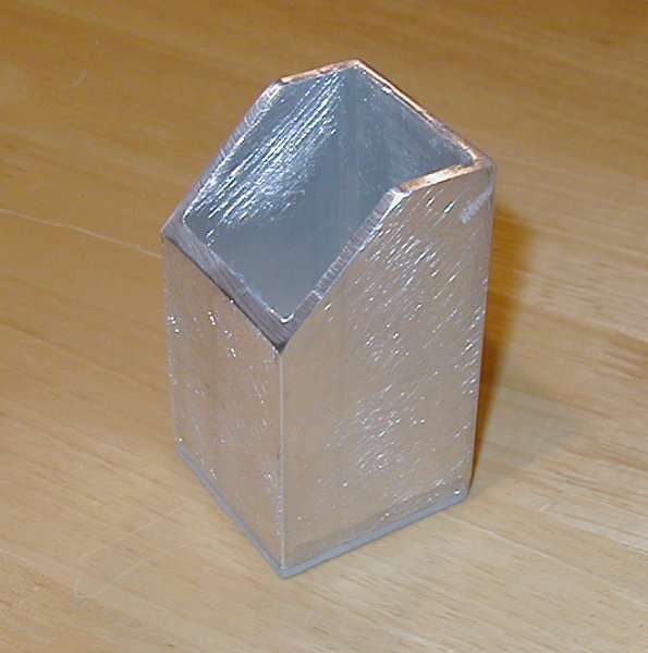

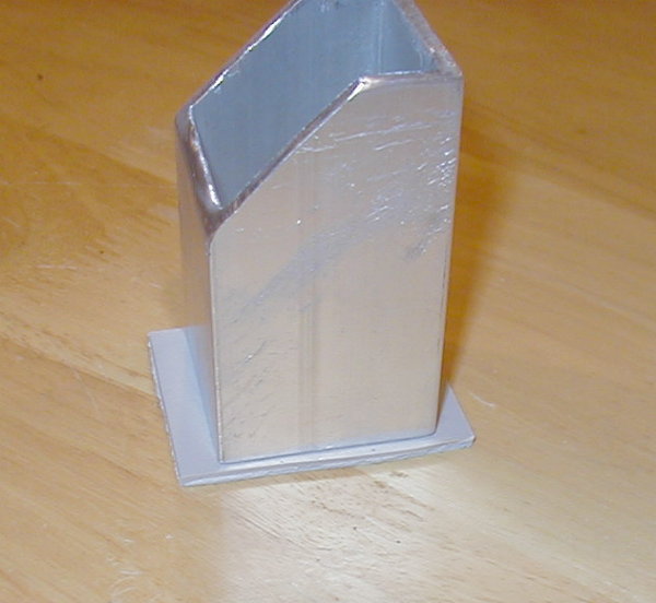

For a base I bought a 1-3/4" x 1-3/4" x 3' long aluminum square tube, and cut it to the approximate size of the wood block on TK409's site. I took an extra 1/8" off of the height to account for the piece of sintra that I would glue on the bottom of the block. Once the glue dried, I sanded the sintra to the size of the tube, and prepared the aluminum for the leather.

Have you tried to uphoslster one of the tube pieces yet? I'm curious if the flap on top will dent in where the opening of the tube is.
Also, what did you use to cut the tube? Very nice looking cut.

I have not made the flaps yet, but I think the leather is thick enough not to sag into the opening of the tube. I will keep you posted.
I cut the tube with a floor mounted band saw, with at metal cutting blade. I then used a floor mounted 18" disk sander, to smooth the edges and even out the cuts. Lastly, I finished off the edges with a sanding drum on my Dremel. I have access to an industrial metal shop at work. :p One of the small perks for working in the auto industry.

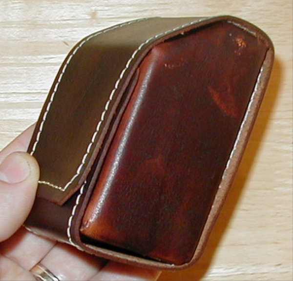

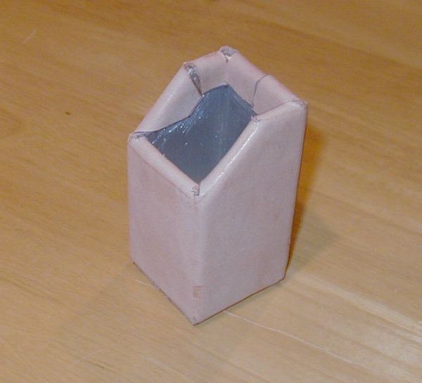

Over the last few days I was able to make the pattern for the leather pouch. I followed the same method that TK409 outlines on his site. However, since the top of the tube is open, I had to modify the template slightly to accomidate the pouch opening.
In the second pic you can see that the leather at the tube opening wraps around and into the pouch, rather than just over the top of a wodden block. The top flap will end up being seperate, and wrap around from the front to the back and over the top of the pouch. Again, similar to TK409's pouches. The last pic shows the height of the pouch, without the flap.

:D wha that's awesome!!! and REAL leather... great job man! but are you gonna dye them a little to make them darker? it looks a little pale...

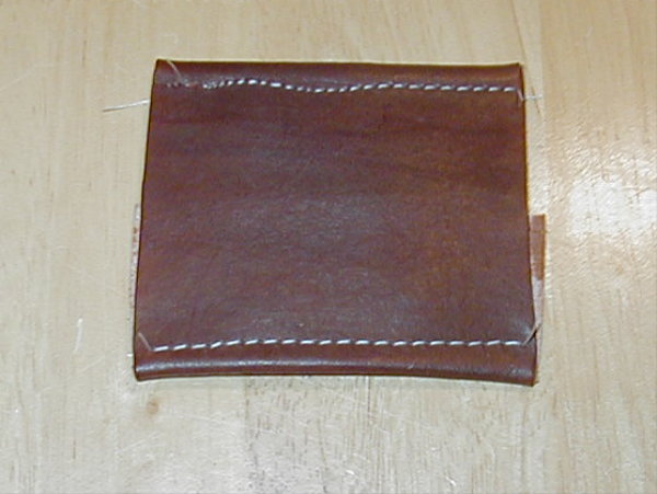

Anyway ... I finished attaching the leather to the 8 pouches, and have started on the flaps and the belt. Before I go any further, I made a sample piece and tested out the dye.
I am looking for some feedback on the color and the stitching. The top row of stitching got screwed up when I tried to use the foot pedel on my sewing maching. I did the lower row by hand, using the wheel on the side of the maching and turing the wheel one stitch at a time. What do you all think?

Hand stitching is superior to a machine, always has been always will, it takes ALOT longer but it looks so much better. That being said, the original belt isnt near perfect, that might be to good! :lol:
Looks like you're in the home stretch. The dye color looks nice to me, not sure if it's screen accurate (I'm no expert), but it looks sharp!

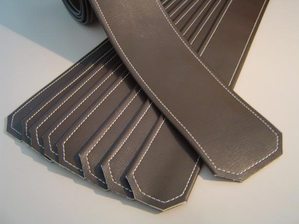

Have you tried using a Teflon presser foot when doing the stitching? I don't know if it'll help for leather, but it was great for vinyl:

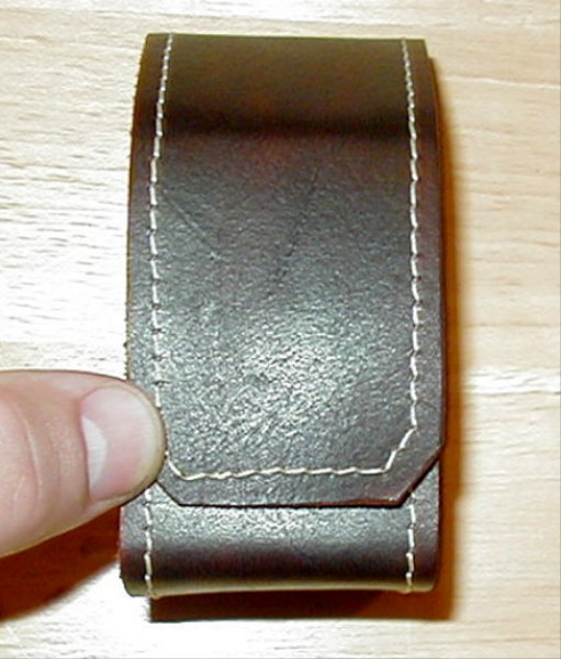

One pouch done ... 7 to go. The flap is not glued on yet, so if you think I should change something on the flap, let me know.
Gator
