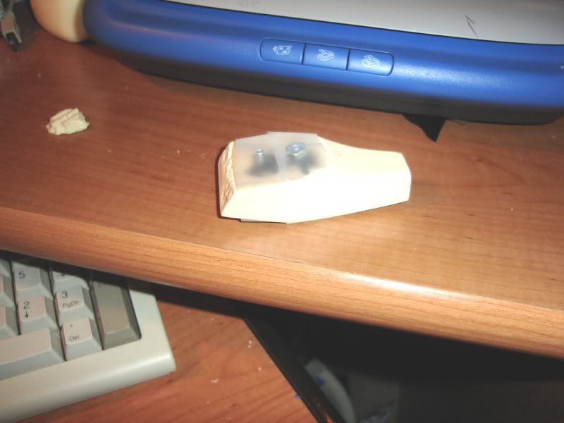

i drilled into the resin rocket and put 2 rivets in, one near each end. this is a sort of risky way to do it, since the rivet could, in theory, crack the rocket. i figured that i could always glue it back together if i needed to.

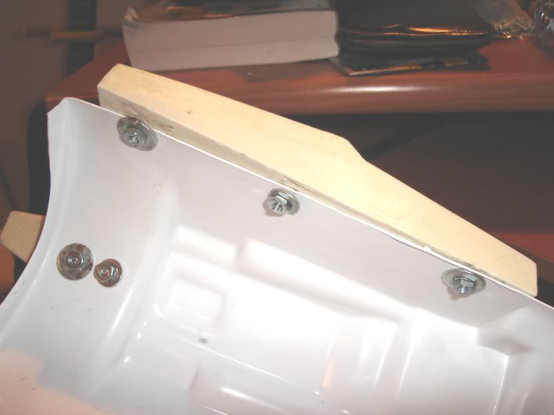

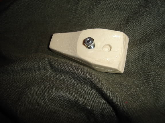

What I did was drill out two holes in my rocket and JB Weld in some screws so they were pointing down. Then I drill two holes in my gaunt to match and bolted them together.

I went with the nut/bolt idea (and araldite'd the nut into the rocket pod)
It worked so well I did the same for my flame thrower.
just screwed through the gaunt right into the rocket, with some kit inbetween.. aint going anywhere...
Here is the basic idea:
