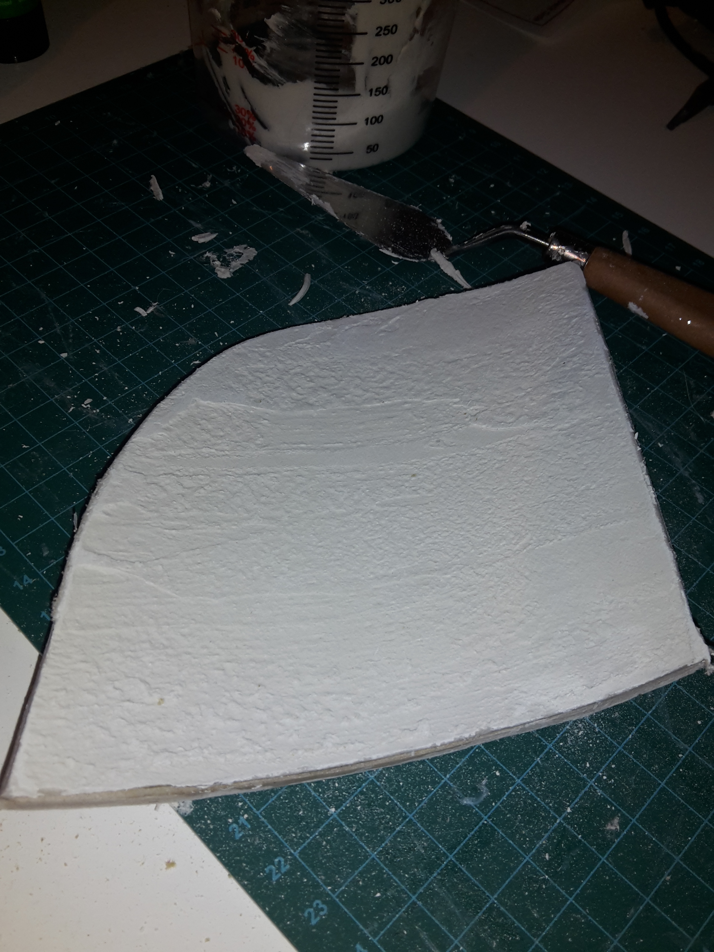

Done a little test of the 'bondo' on a piece if cardboard I had from making the helmet; one of the cheek cutouts I believe. Polyfilla mixed with Evo Stik wood glue as suggested to me earlier in this post. went on really easily. Nice and smooth, easy to work with. Dried rock hard. It's like concrete! P60 sandpaper didn't do much. Although wasn't putting much effort in. Seems very solid!

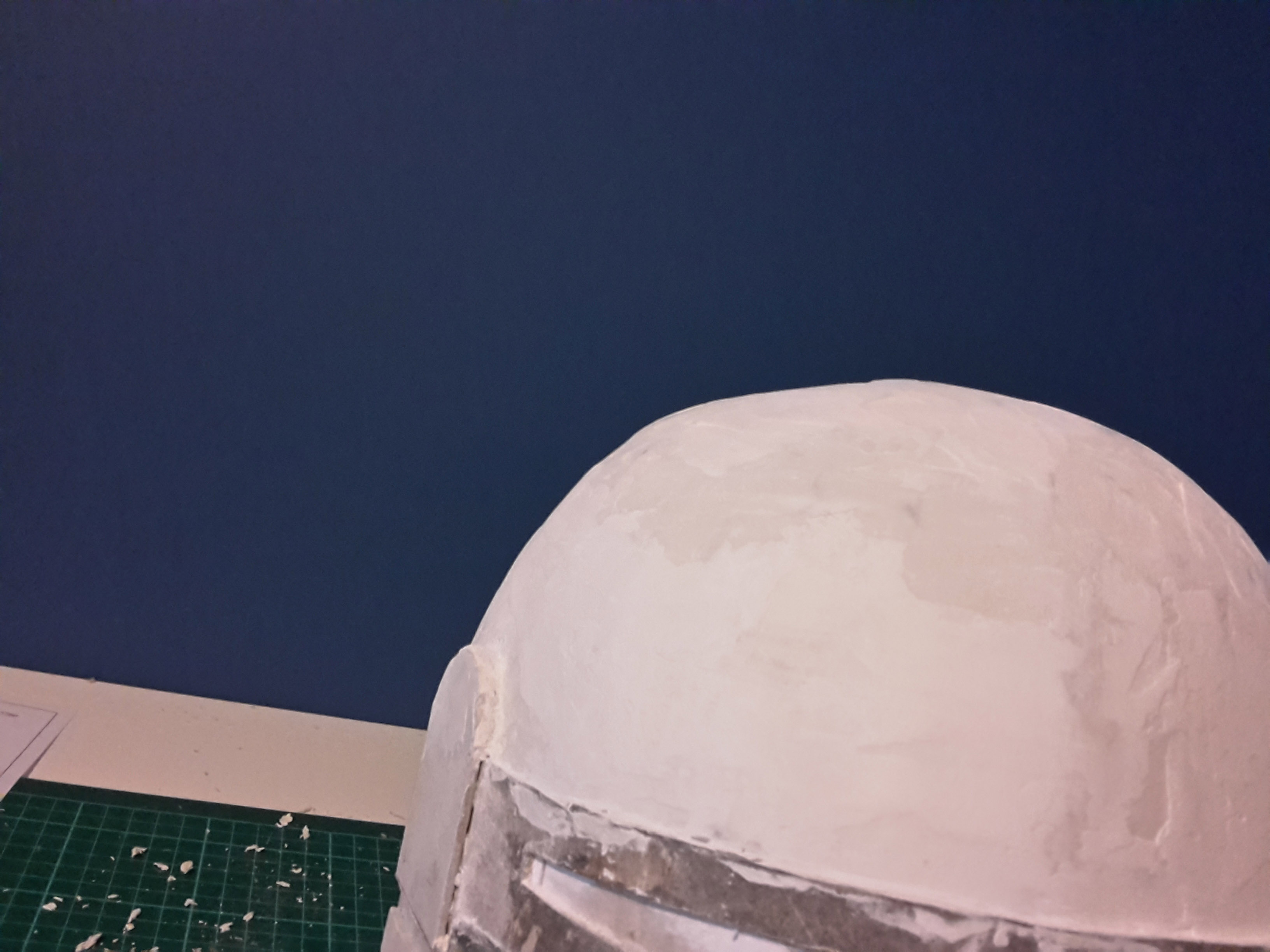

ooh boy! It's begun!
Didn't put quite as much PVA in this batch. First stage is just to get some on, and get a much clearer idea of where the highs and lows are in the dome. I've given this a good sand already, and you can see where the low spots are.
I'll slowly add more PVA into each batch as we go up for added strength, but it's pretty rigid, but sands nicely atm. The more coats we put on, the less rough sanding their will be. At what point do people normally start putting coats of primer on it?
But yeah, stage 1 of filling sanding complete. off and running :D

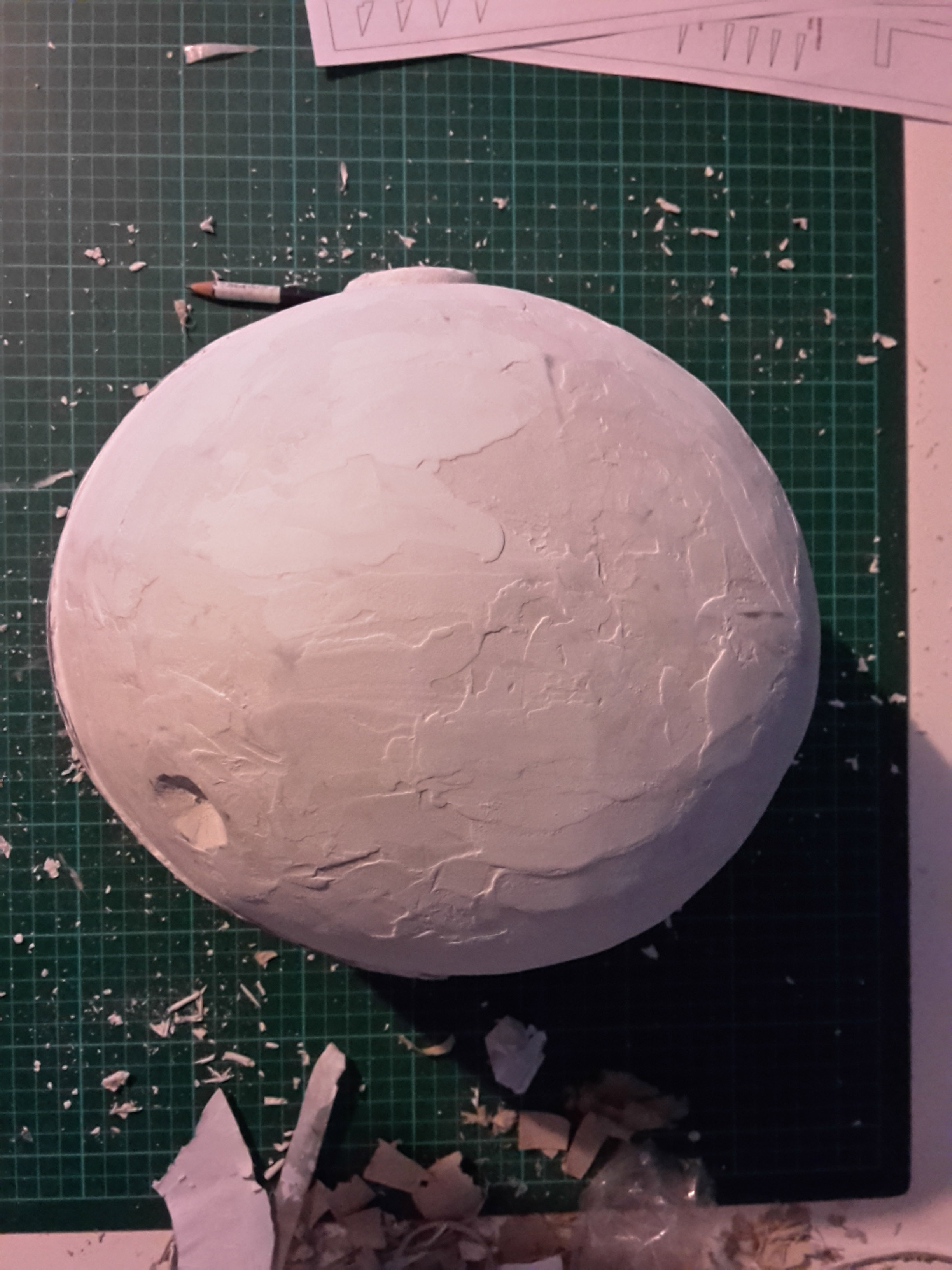

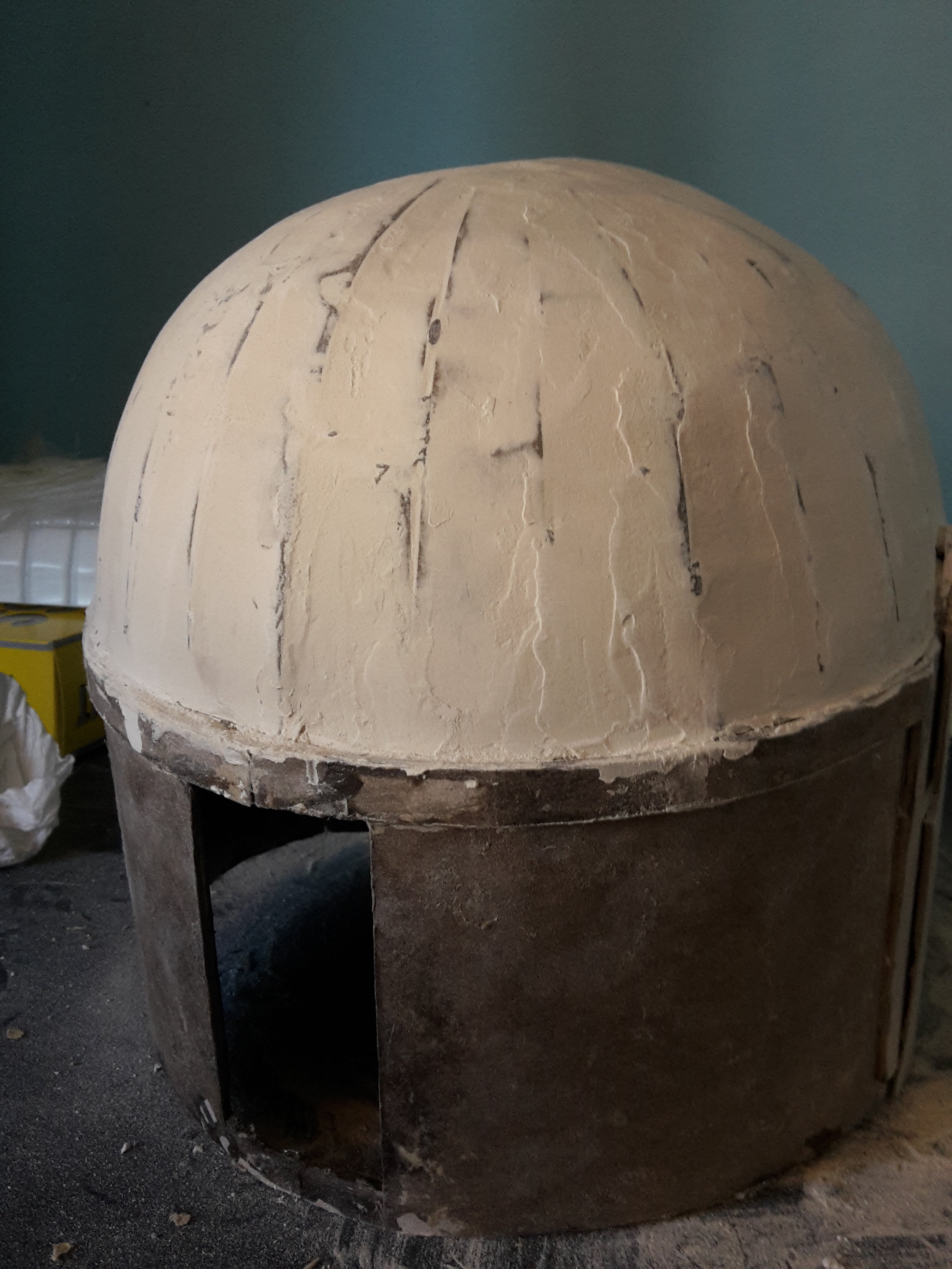

2nd coat on the dome. This is before sanding. Will post some more pics once sanding is done

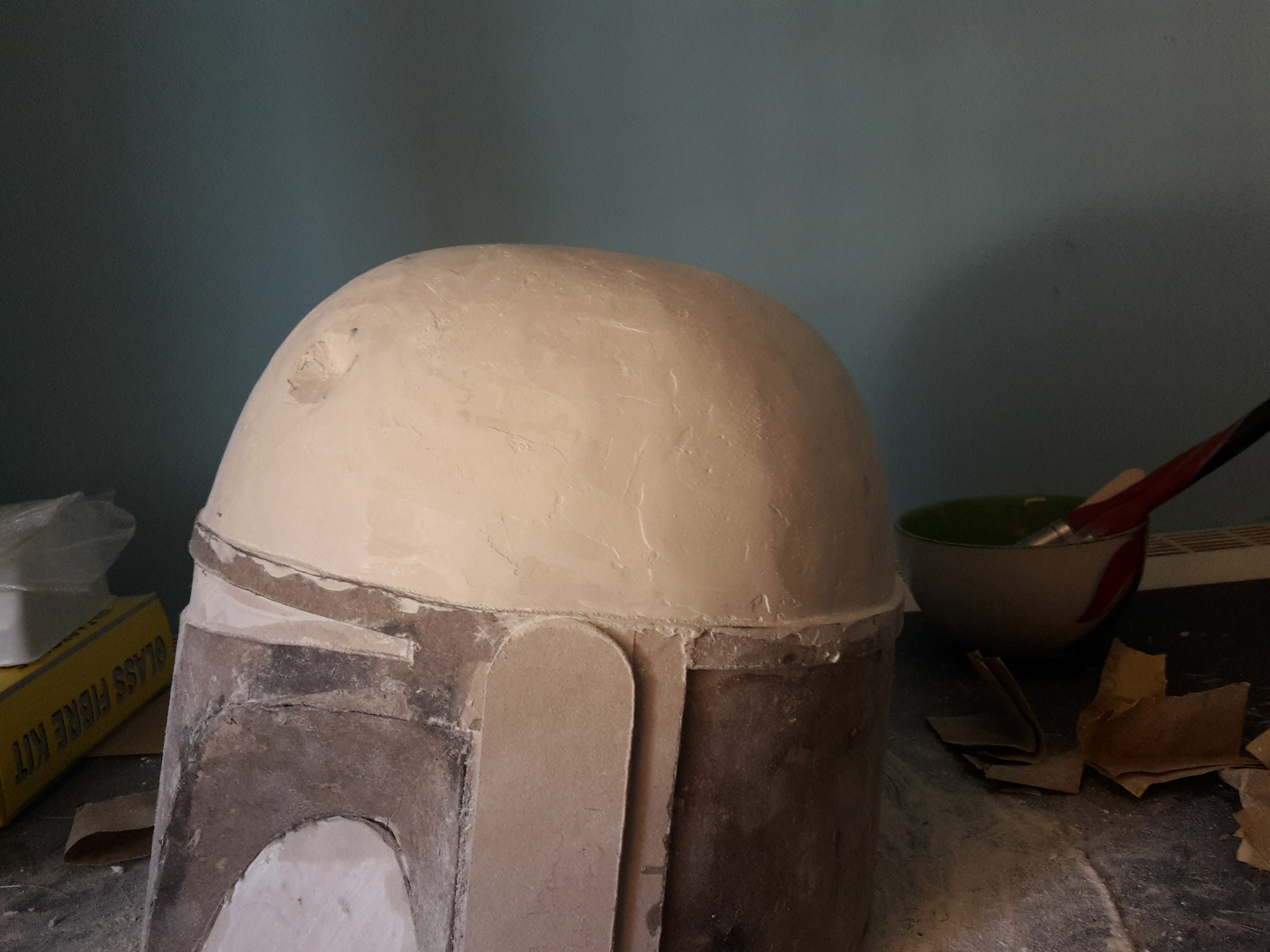

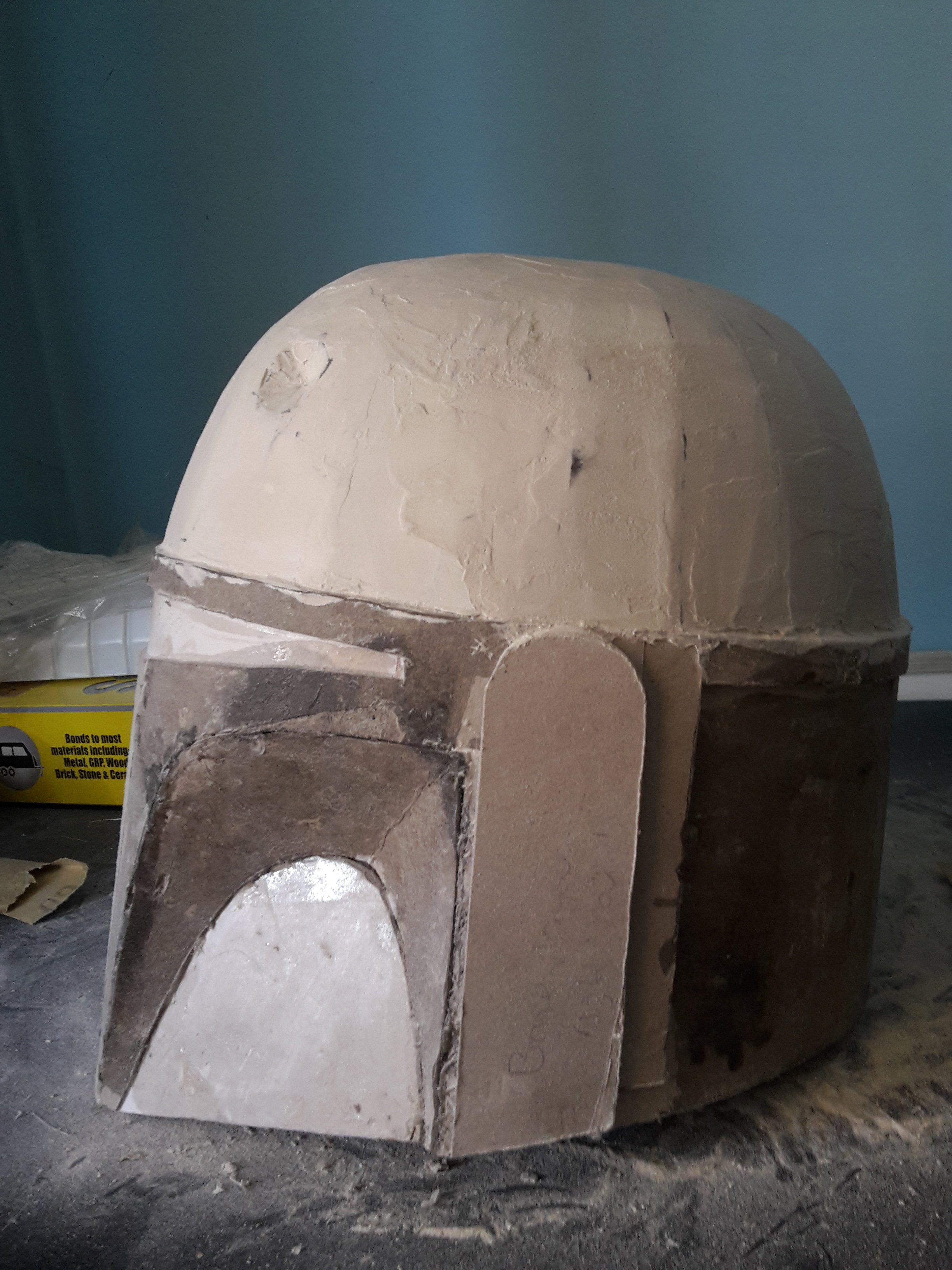

I've done a little more filling sanding since last post. A few areas just starting to resemble something smooth. But less and less of the cardboard structure underneath is now visible once sanded, which is good! It's a good job the dome ended up being so dark when I put the resin on, because it contrasts nicely with white of the filler. Getting there slowly. Want to take my time in this stage to get a good finish on it. I don't mind sanding though. This stuff is pretty easy to sand, so doing it by hand, comes off easily with rough paper.

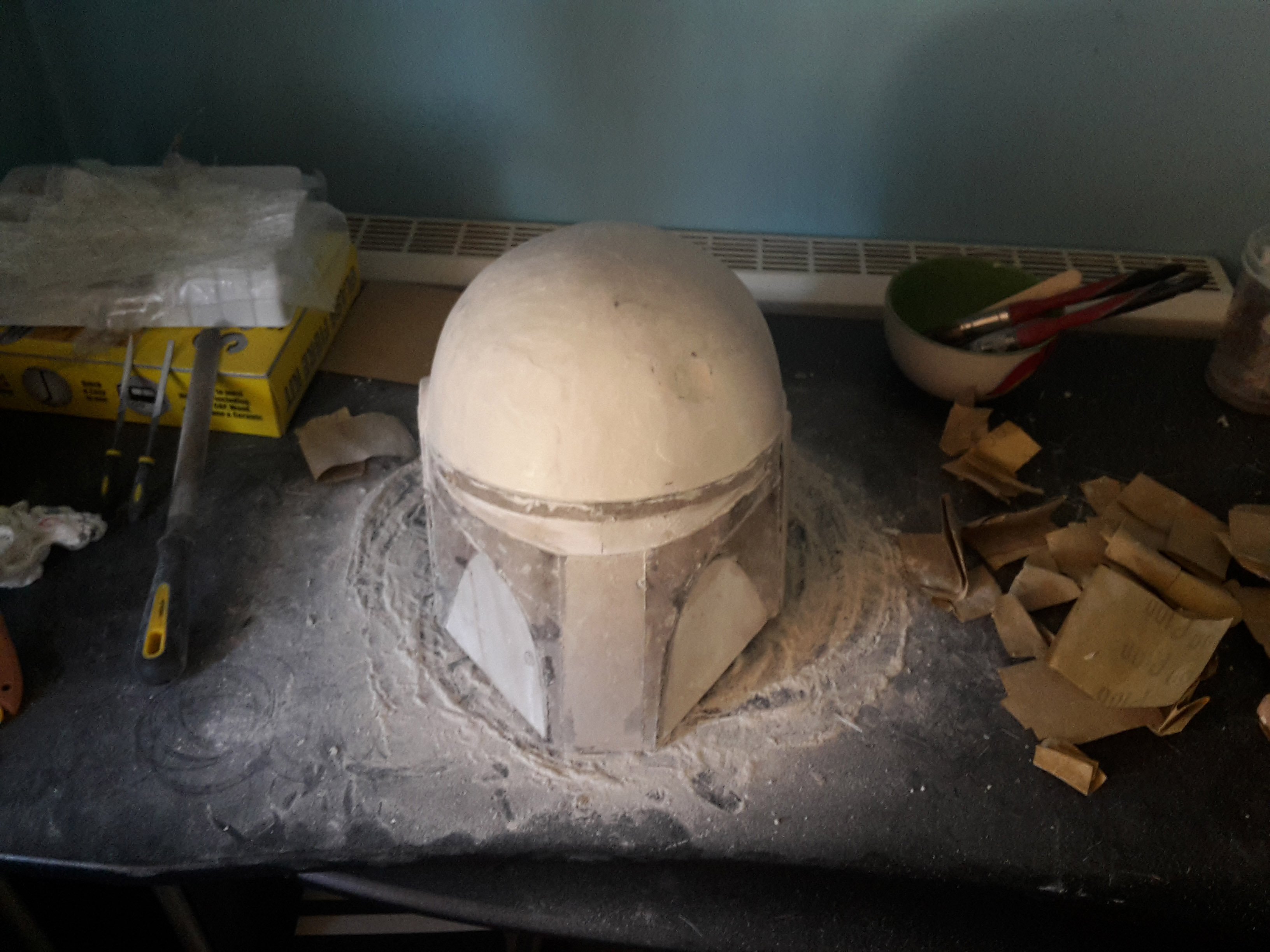

Some more filling/sanding done. The general shape is looking good now. Now just trying to remove bulges, particularly where support sections are.

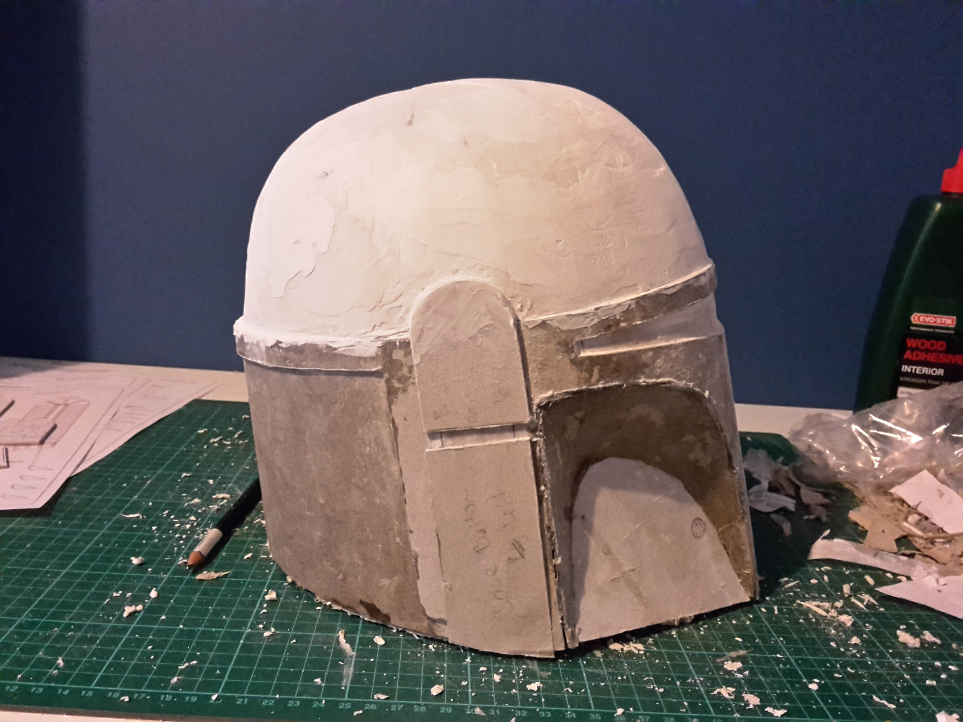

More sanding/filling was done yesterday. The bulges are starting to disappear now, which is good. Also reformed some parts of the overall shape. You can see in the pics at the end that there are still some noticeable bumps which need smoothing out, but I think I'm not too far off with the overall shape now, and can soon move onto smoothing area out. But enjoying this process. Not as frustrating as I expected it to be. Just have to take your time.

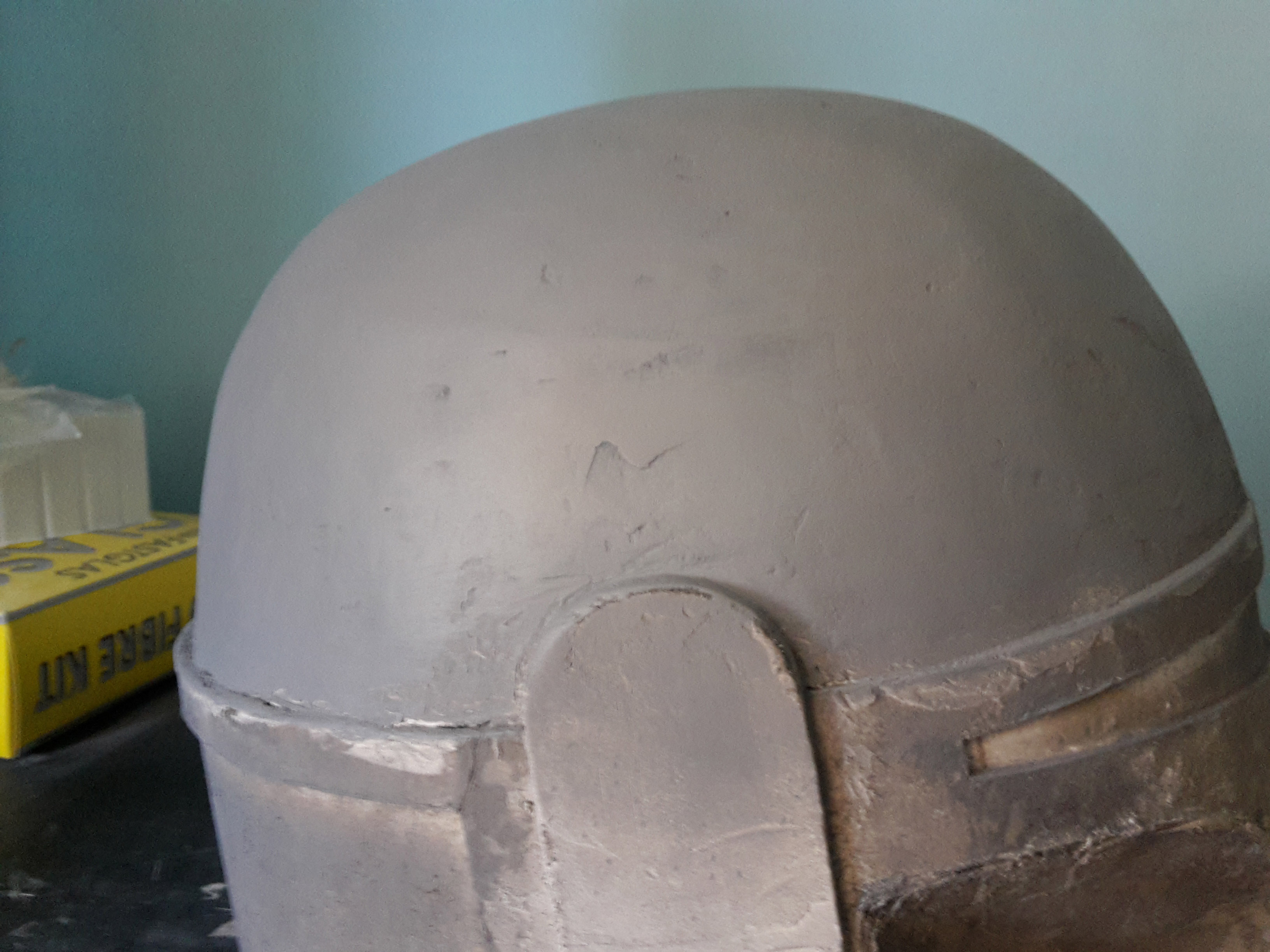

Bought a can of primer, which will be here tomorrow. So after some more filling/sanding today (maybe), I'll be able to put a coat of primer on tomorrow and get a better idea of where it's at.
haha...I done goofed! Never used spray paint before (primer). I knew you had to shake it, but didn't know how much. I shook it a little. Sprayed it a bit on the cardboard, and a bit came out, so I thought great! Started spraying away, not really much coming out tho. But then it started to come out. But It didn't really look very wet. Didn't bother checking, just carried on spraying until dome was all covered and nice. Just went back into the room to see if it was dry, and to my surprise, the grey brushed off in a powdered form! So I got my little paint brush, and started brushing the dome, and 60-70% of the primer just brushed off. it was the same story on the cardboard it was sitting on. Little blow, and off it all went. I then saw on the can (which I did read before hand...) Shake well for 2 minutes -_-
So yeah....I shook it a bit, and then lightly sanded dome to dislodge anything loose (also did my coin slot - same thing...) and then sprayed again. this time it was shiny and wet.
Always ready instructions kids...

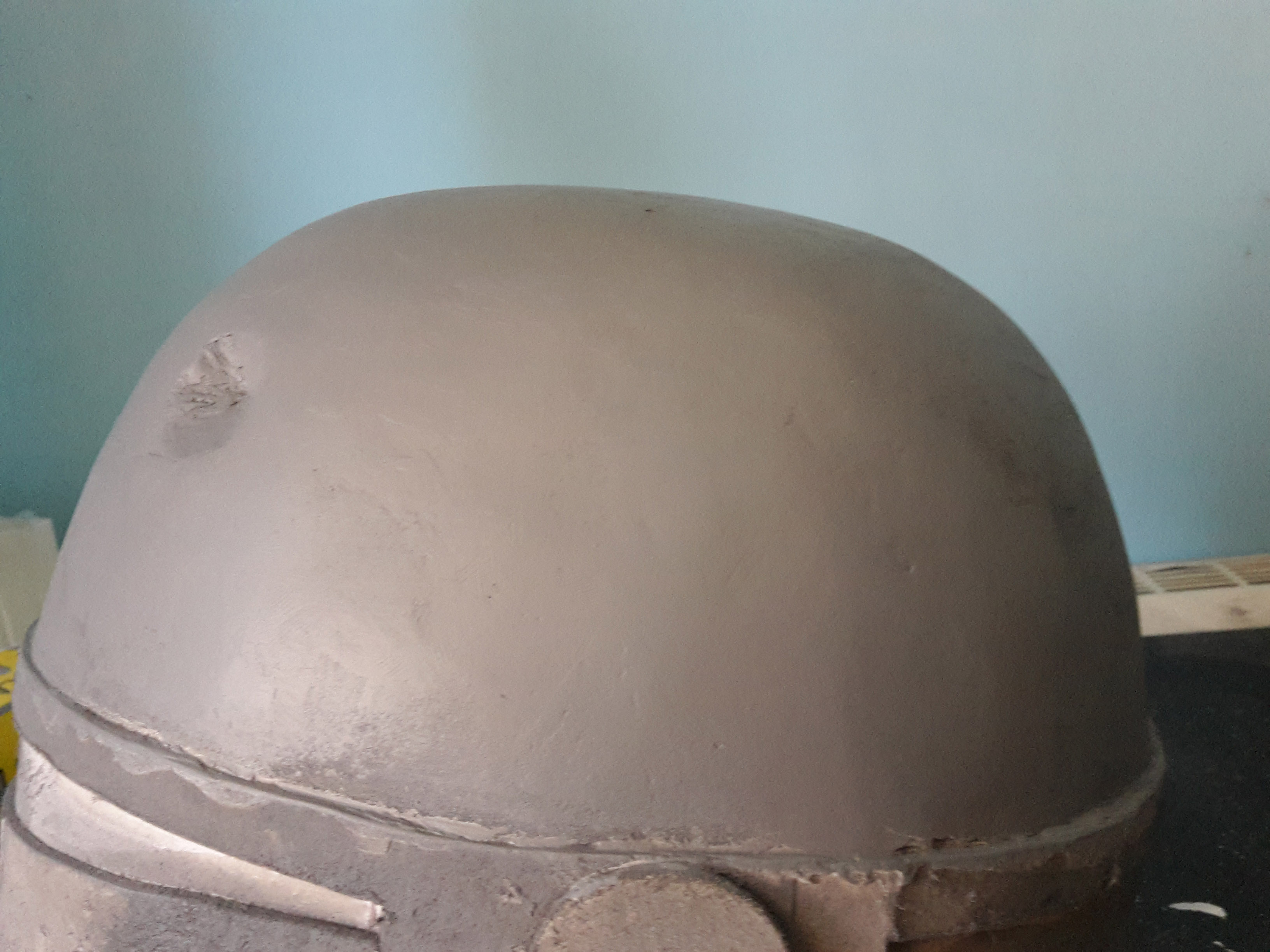

Primer on. And holy bumpy! Not as bad as I thought...but still a little more bumpy than I thought it was, if that makes sense..
