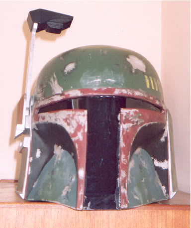

Hey guys...
This is my DP97 quick lid fix.
Cut the visor out(I used a hand saw) then replace with a home made one,cost be about two quid to make,sheet of 1mm clear plastic acrylic from the model shop and some car window tinting film,I stuck it in with Evo stick!!
I then just got some decent referance pics and went about applying the weathering using acrylic paints (better for a vinyl helmet as the paint doesnt flake or crack)...and that was that!!
OK it's not brilliant but it sure beats the way it originaly looked...
Getting a fibreglass bucket soon so will do it properly next time!!

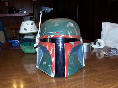

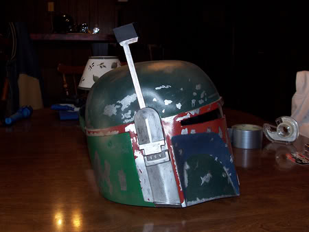

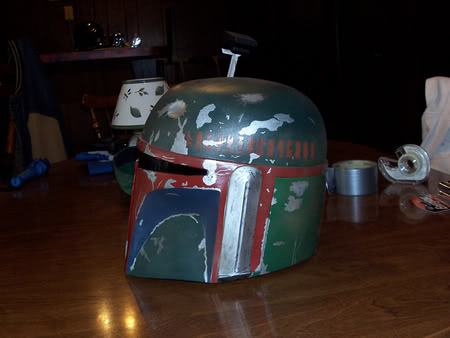

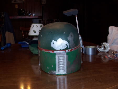

After a long absence (real life can be a pain sometimes!!!) Im back and finally finished my bucket! Tell me what you think or where i could improve!
