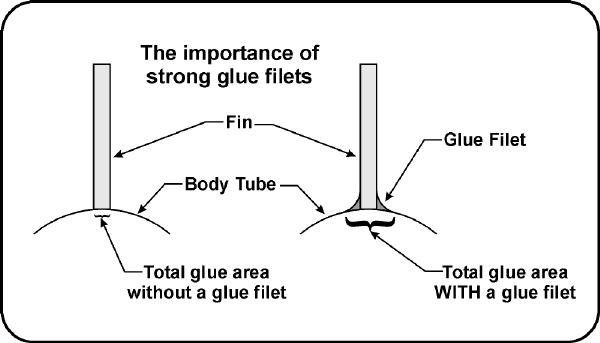

The pics show up now, looking great. I used plain old elmer's glue when I built mine. One trick that helps is to use glue to make a filet on the inside of a joint between two sections of board, when they join at some sort of angle. This is an old model rocketry tip.

Thanks Gregory, i have hot glue filleted every joint i can find, certainly works.

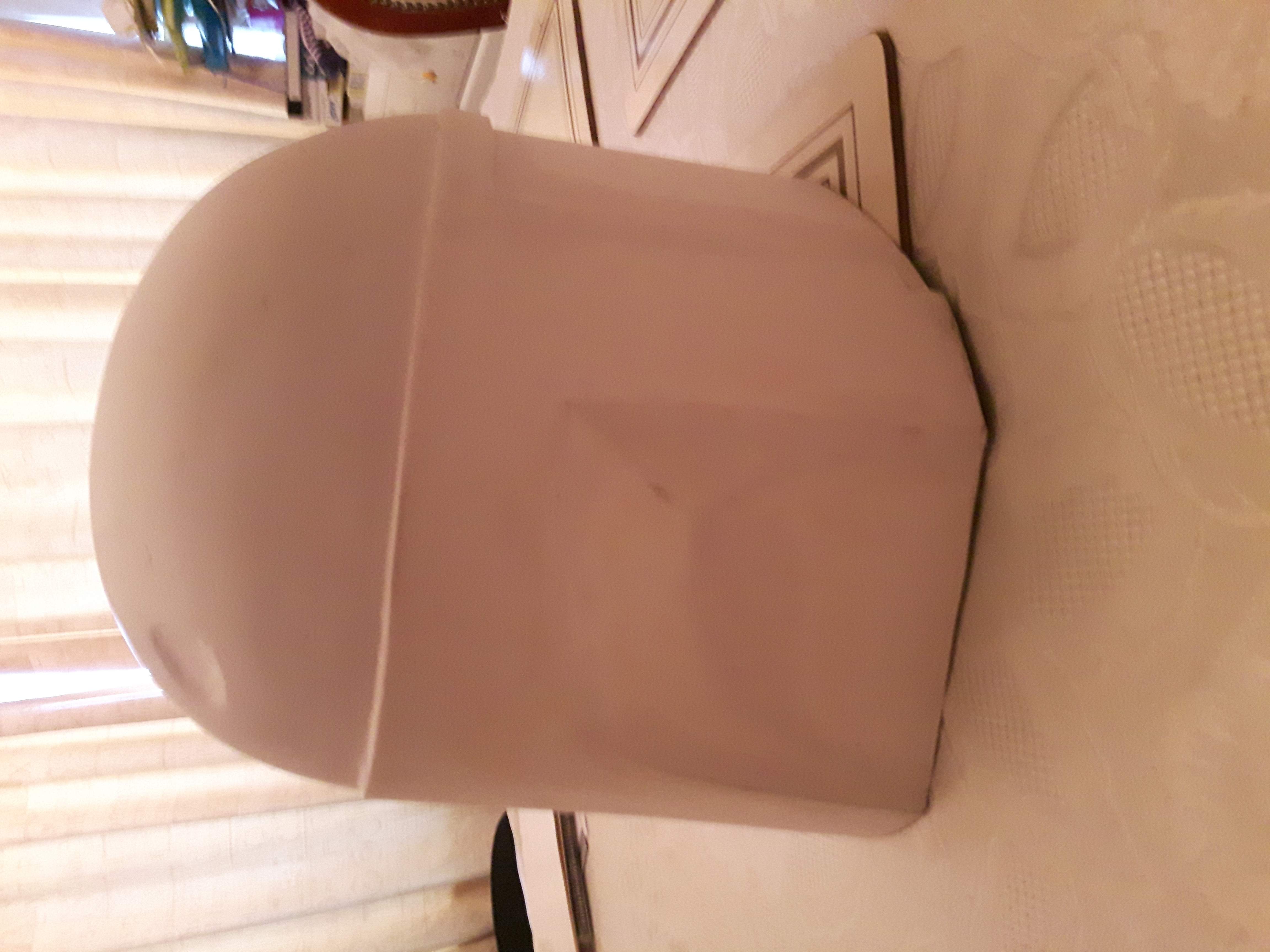

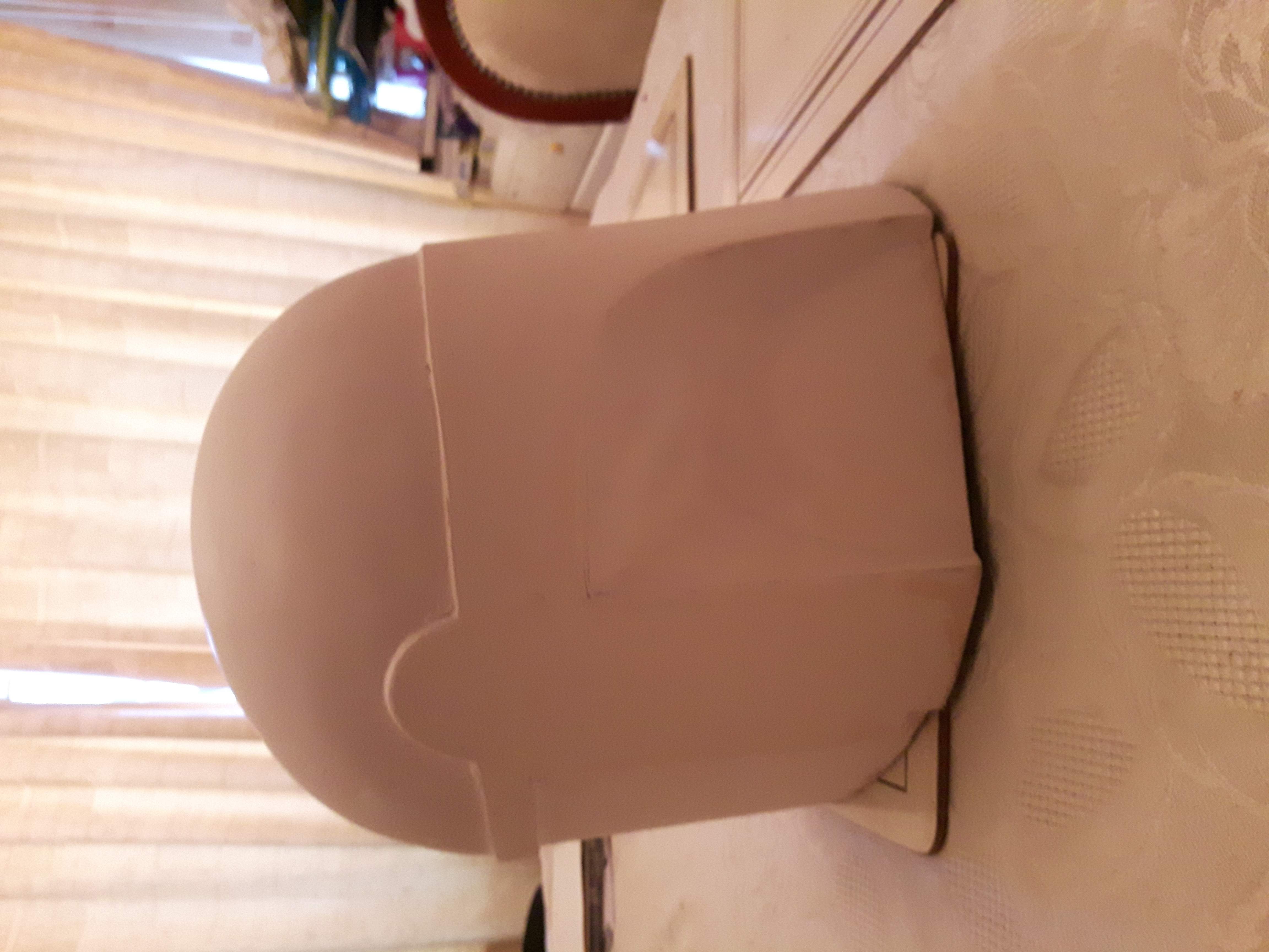

A few pics of my progress, dome needs one more coat of filler in places, painted inside with resin, filled and sanded cheek areas.
Slow progress but want to get it right!

I think my dent is slightly in the wrong place, I'm thinking it should be more to the right looking at the front of my bucket, what does everyone else think?
You might be right, it does seem a bit left-ish to me, but it's hard to tell though with the helmet whited out and the angles of the photos.
Best way to find out I found after a lot of fretting over dent placement myself is to find some reference shots of dead-on front and side angles, then try to replicate those shots yourself. Then view them all side by side and see how it looks.
