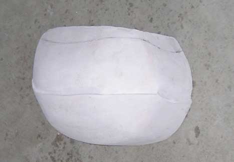

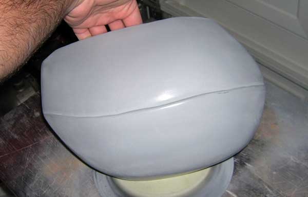

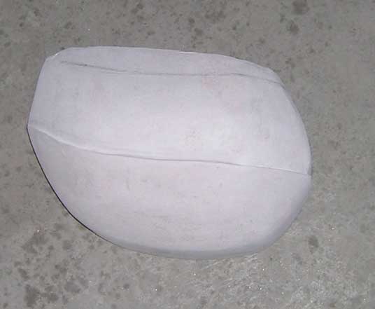

I have attached some pictures of the saddle bags, the first one is the concept drawing I started with. The next in order are a side view of the plug done in cardboard covered with bondo, and then in an oblique shot then from the front.
The bottom ridge I put in for some datail. and the upper line in pencil is where the bottom of the cover/lid would come to (I have not done that yet). Before I cast I need to do something with the bottom ridge to make it more flowing/smooth as it transitions from the side to the front.

OK got the plug filled, primed and wet sanded down to 600, now some techincal questions for the experts.
notice that the top is open (hand goint into hole, and I have almost finished the top lid not shown) and back side is flat (rt side of smaller picture), and will be attached to the bike on that side, so I wanted to cast it in all one piece. I was thinking of laying the flat side on melamine board, then making a mold urethane/silicon then a afiberglass mother mold.
then for the back side, can I just use a flat piece of metal or melamine, bolt it up to the mother mold from the front and make the cast through the hole in the top.
Does that sound like a plan which would work, or am I way off?:confused
