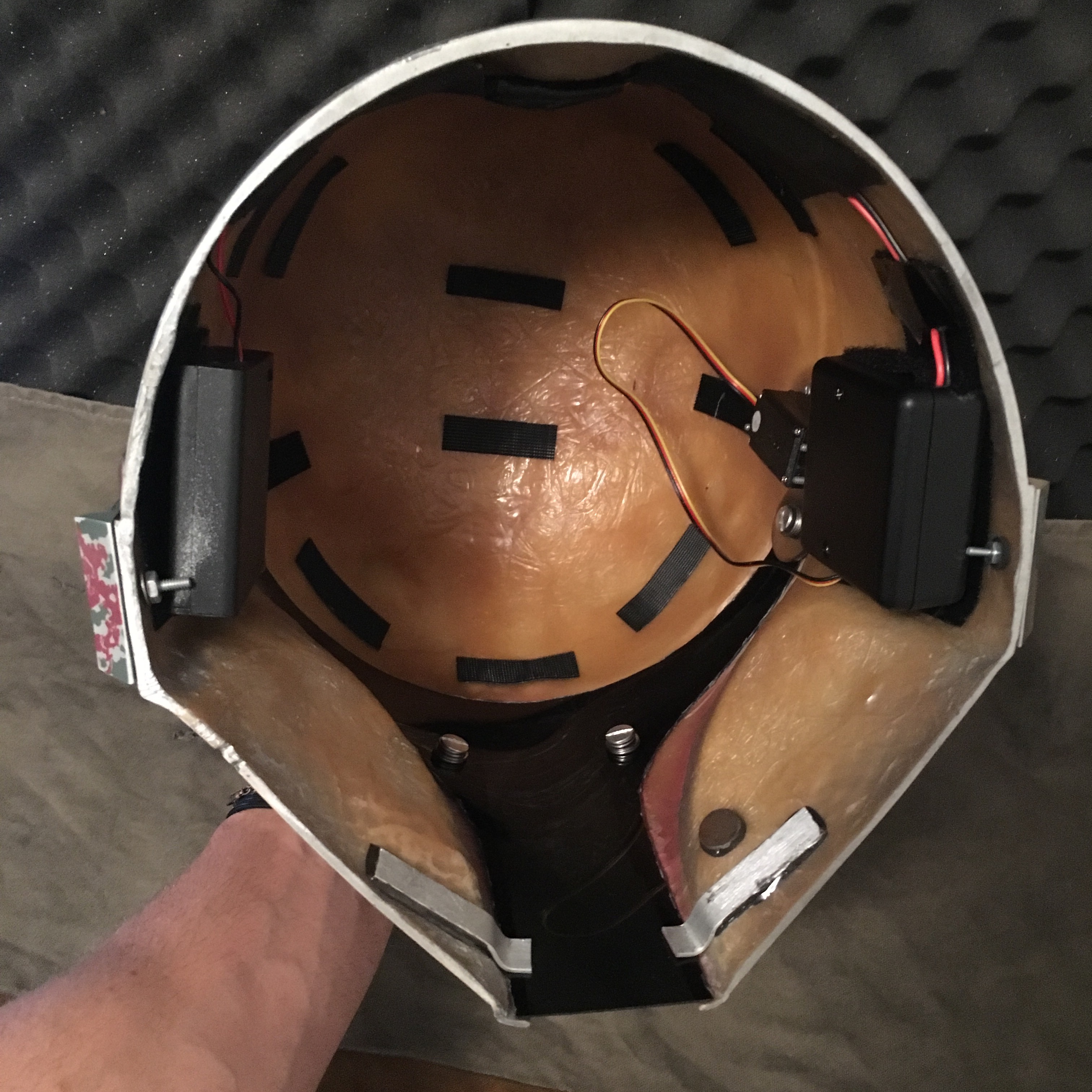

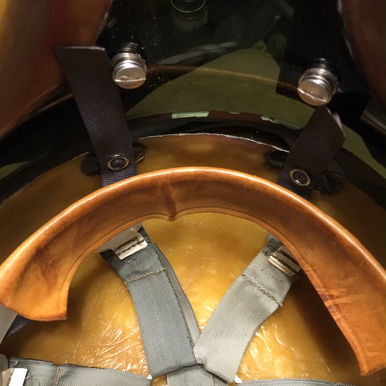

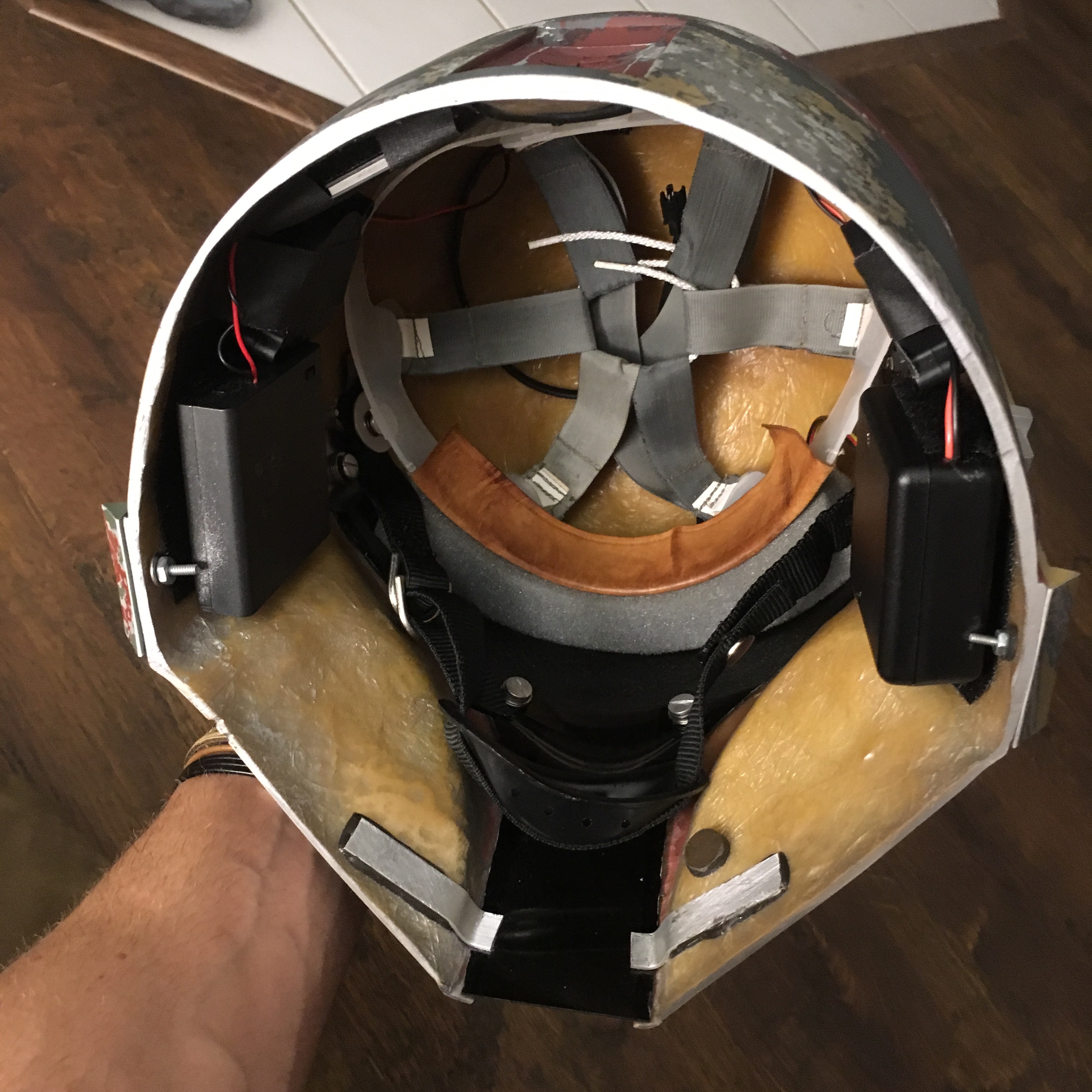

My helmet interior needs work and with the servo kit taking up a lot of room along with the fans I plan on later installing this is going to be a challenge. I've been using velcro and ZAP Team Wendy pads which have done the job but I want to do something a little more accurate, rugged, and cool. I have a pretty accurate helmet cradle that I'm working on attaching. So...it begins.

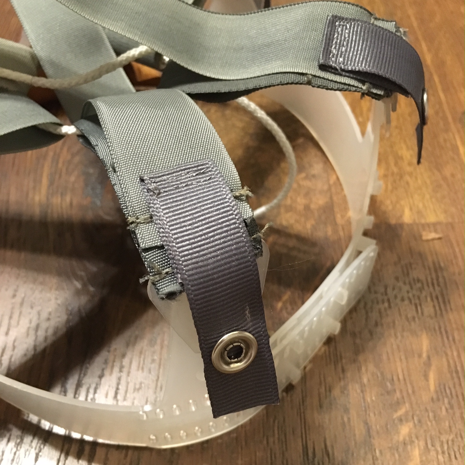

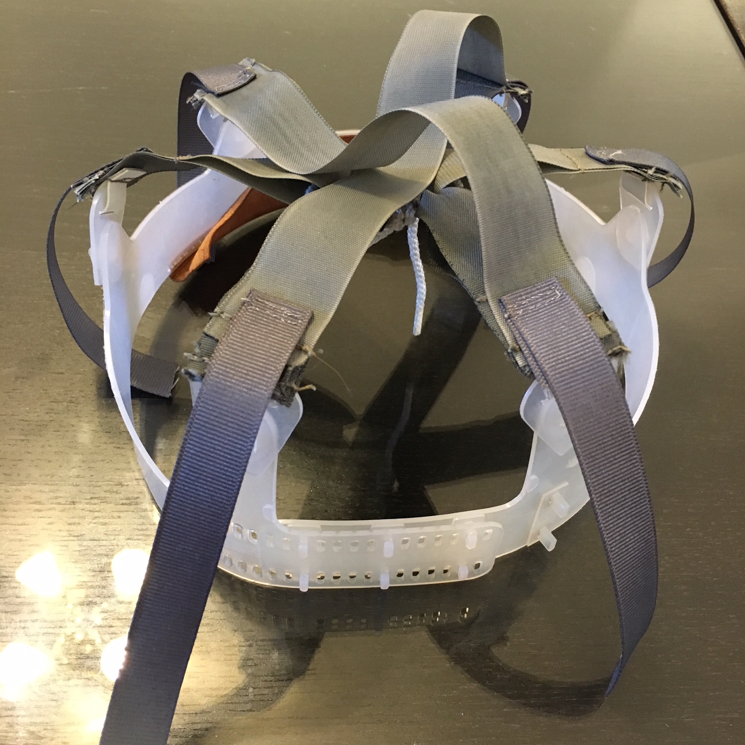

So I wanted the interior to somewhat resemble the original ESB interior. Obviously with all the added electronics it wouldn't be possible to be 100% accurate. As I stated earlier, I got a pretty accurate cradle from intwenothor a while back with plans to retro fit my interior. It had to be cut out of the existing helmet leaving very little material and in some cases virtually no material left to be re-attached to a new helmet. So I devised a method that may be useful to others who want to install a cradle similar to the original.
Only image I have seen of the original interior for the ESB Hero Helmet.

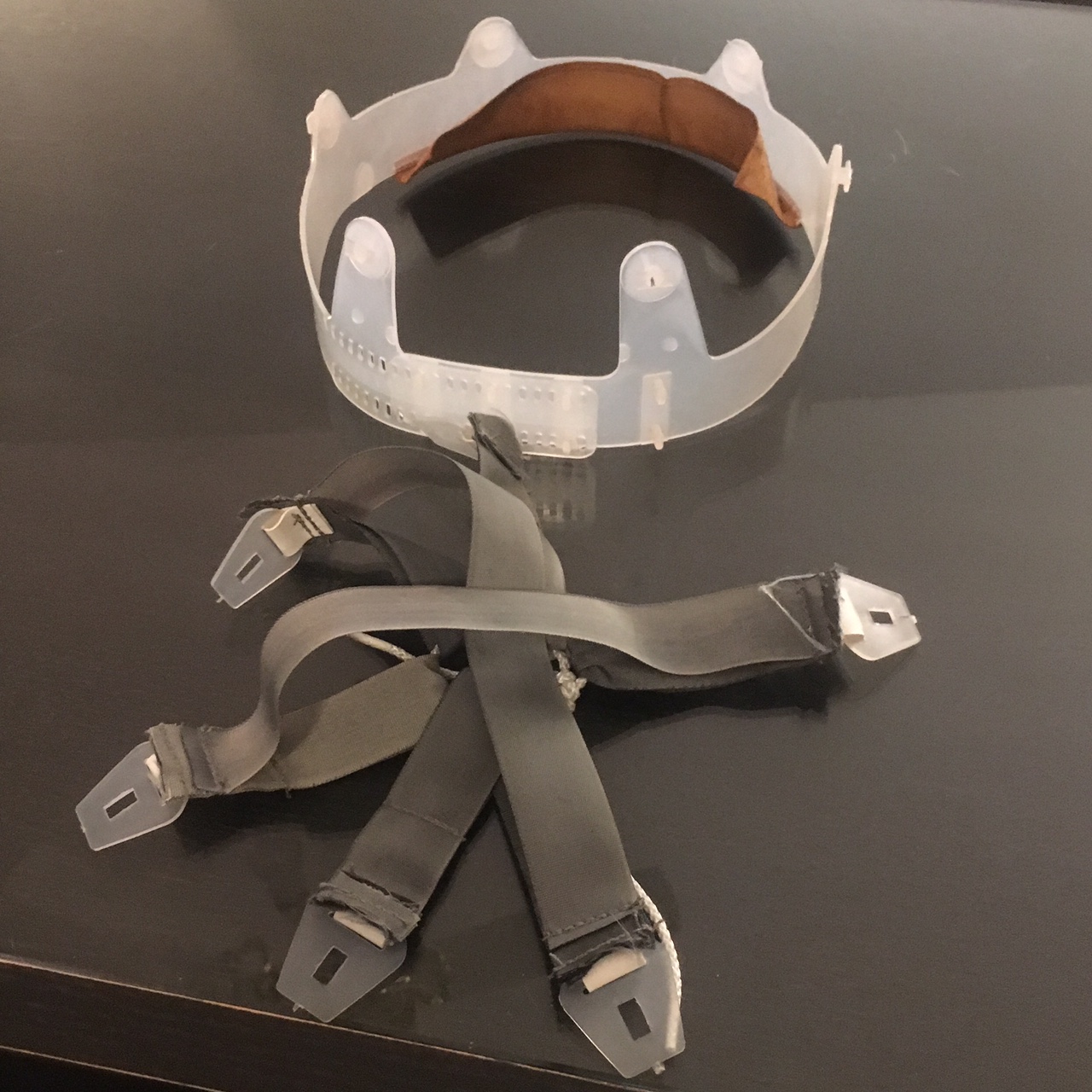

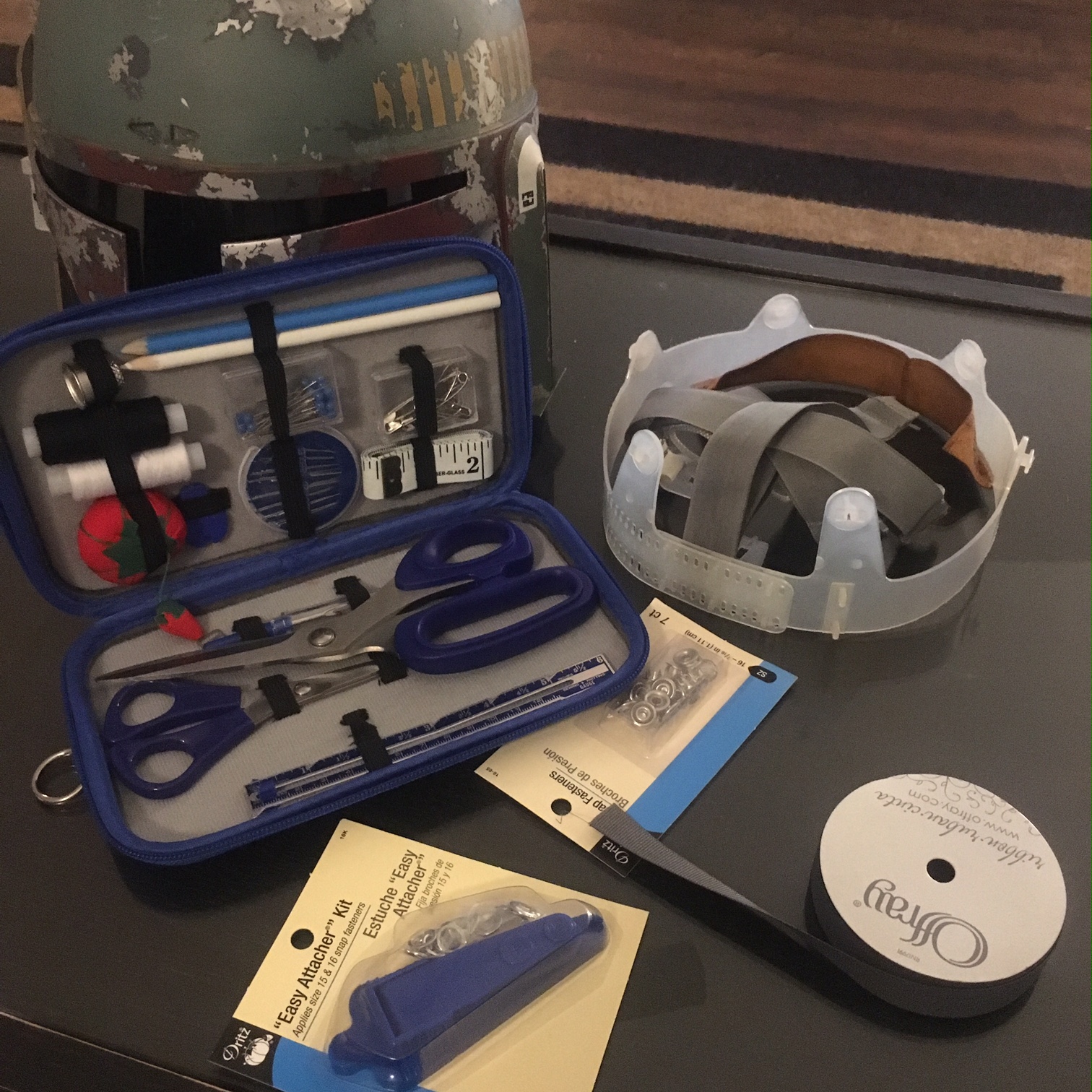

Semi Accurate Cradle as I received it...
I whipped out my sewing kit and purchased some material that was close to the same webbing used along with some button snaps and a nifty snap tool.
Time to work!
Sewed on some excess webbing in order to give me an area to attach my snaps to.
Attached my snaps...

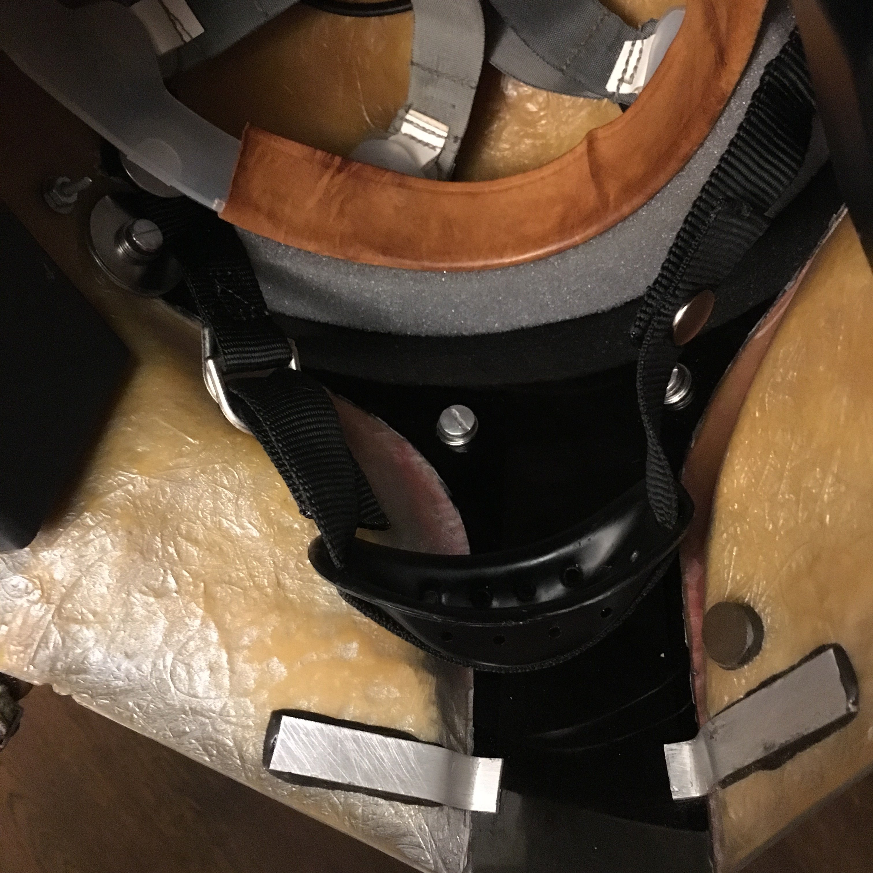

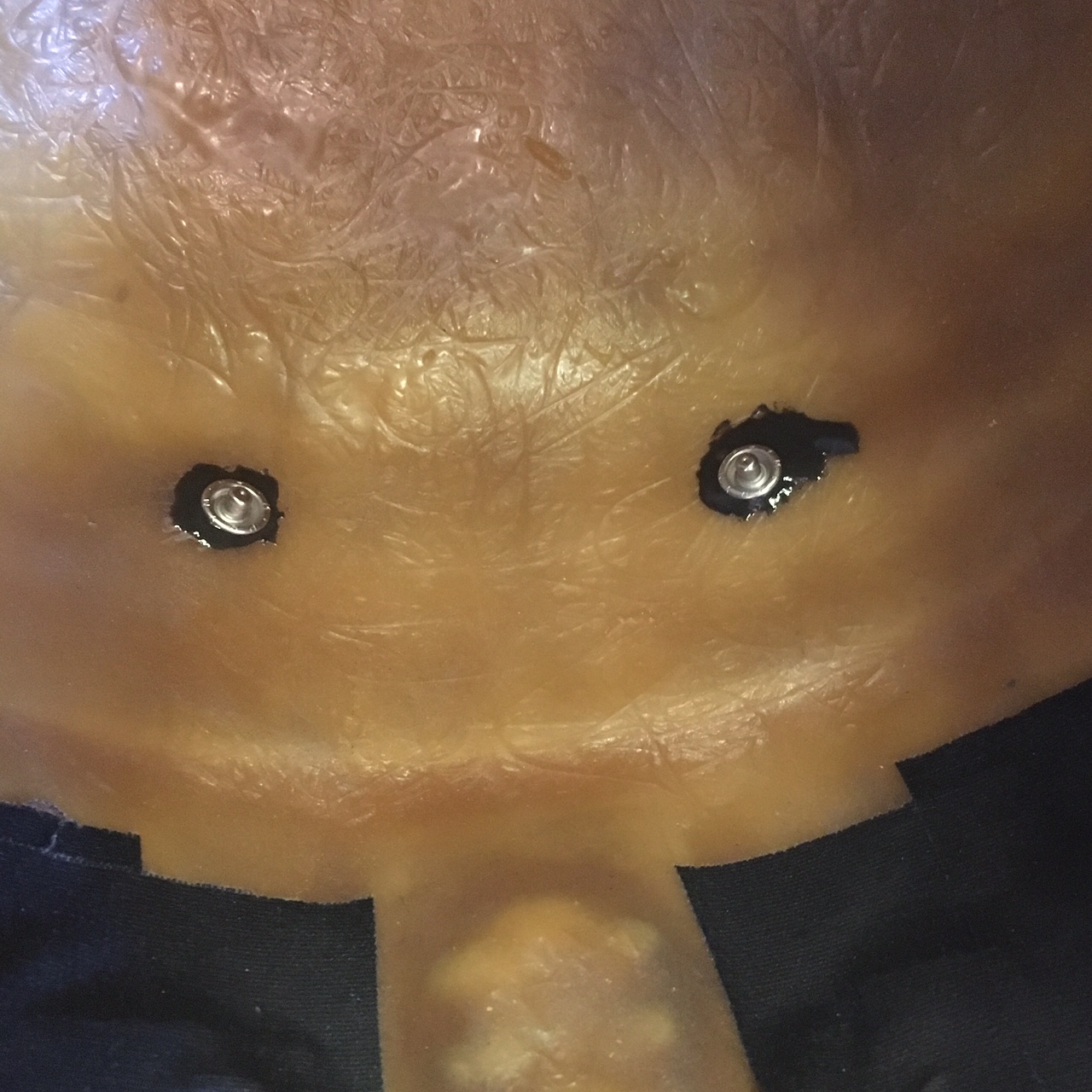

Laid out where the connecting part of the snaps should be by making a mark with a sharpie and JB Welded the snaps in place. Note that you will need to rough up the area you are going to glue or in my case JB weld the snaps to. I use a dremel to make deep grooves in the fiberglass and it has worked very well so far.

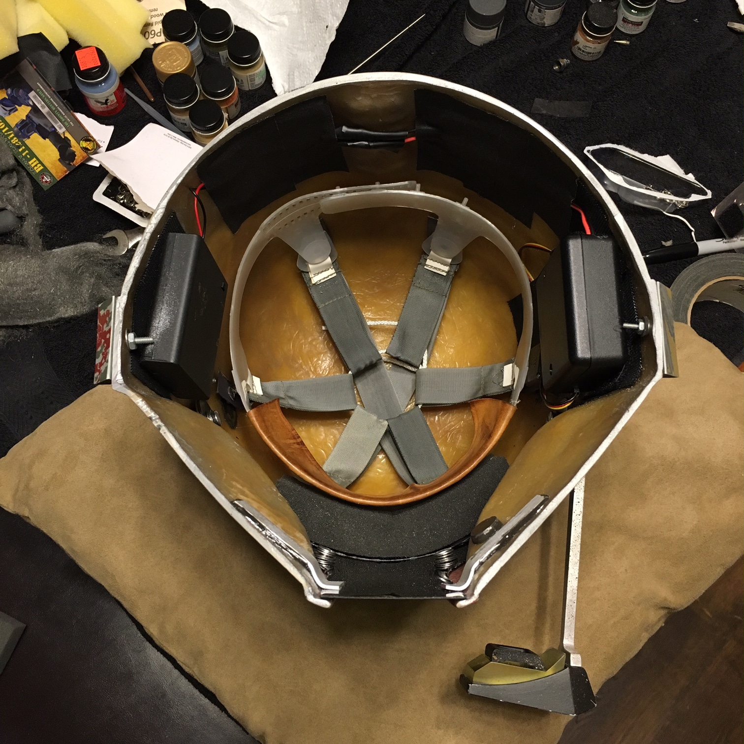

Attached the snaps to make sure everything was in the right place. Once I liked the position of the cradle in regard to the helmet, I cut off the excess webbing but left enough to be able to grab and unsnap if needed. Then I attached some velcro to the front of the helmet above the visor and attached some foam to give a little bit of padding for comfort. The foam sits over the snaps perfectly.
Now I have something that looks more like the original, fits great, is really adjustable, and can be detached and re-attached in seconds. I love it!

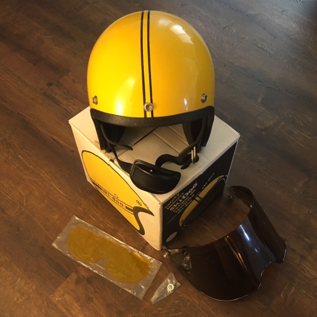

So a friend I know had this and gave it to me for a steel! It had all the original packaging, spare parts and accessories! From what I could tell this may have never been used. It's a shame there was only one thing I wanted it for...

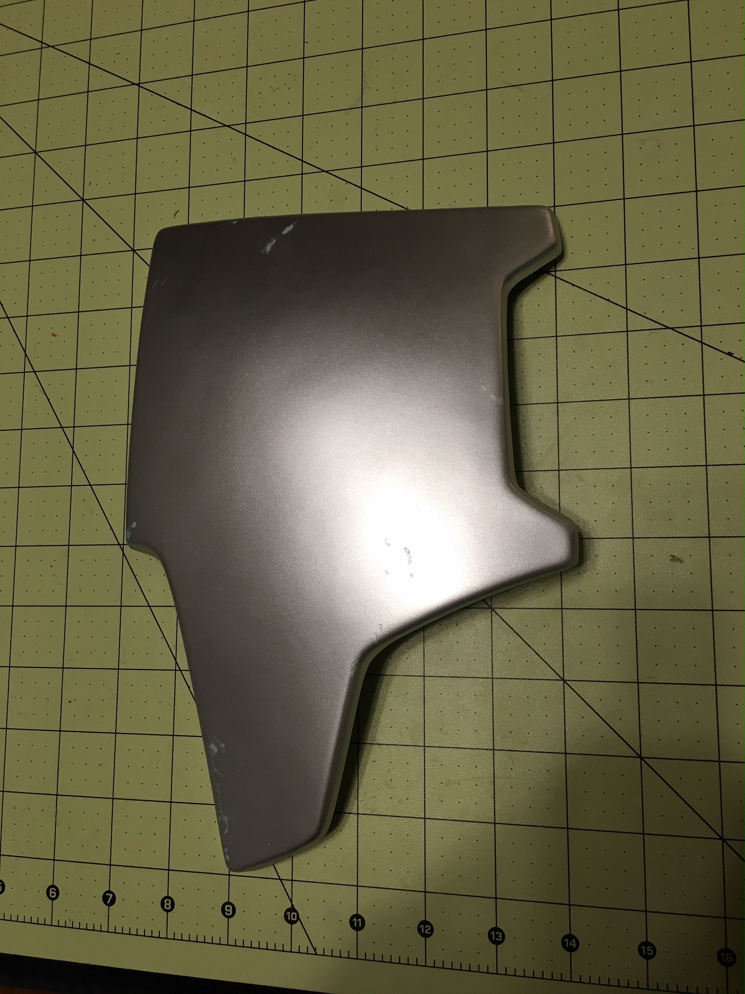

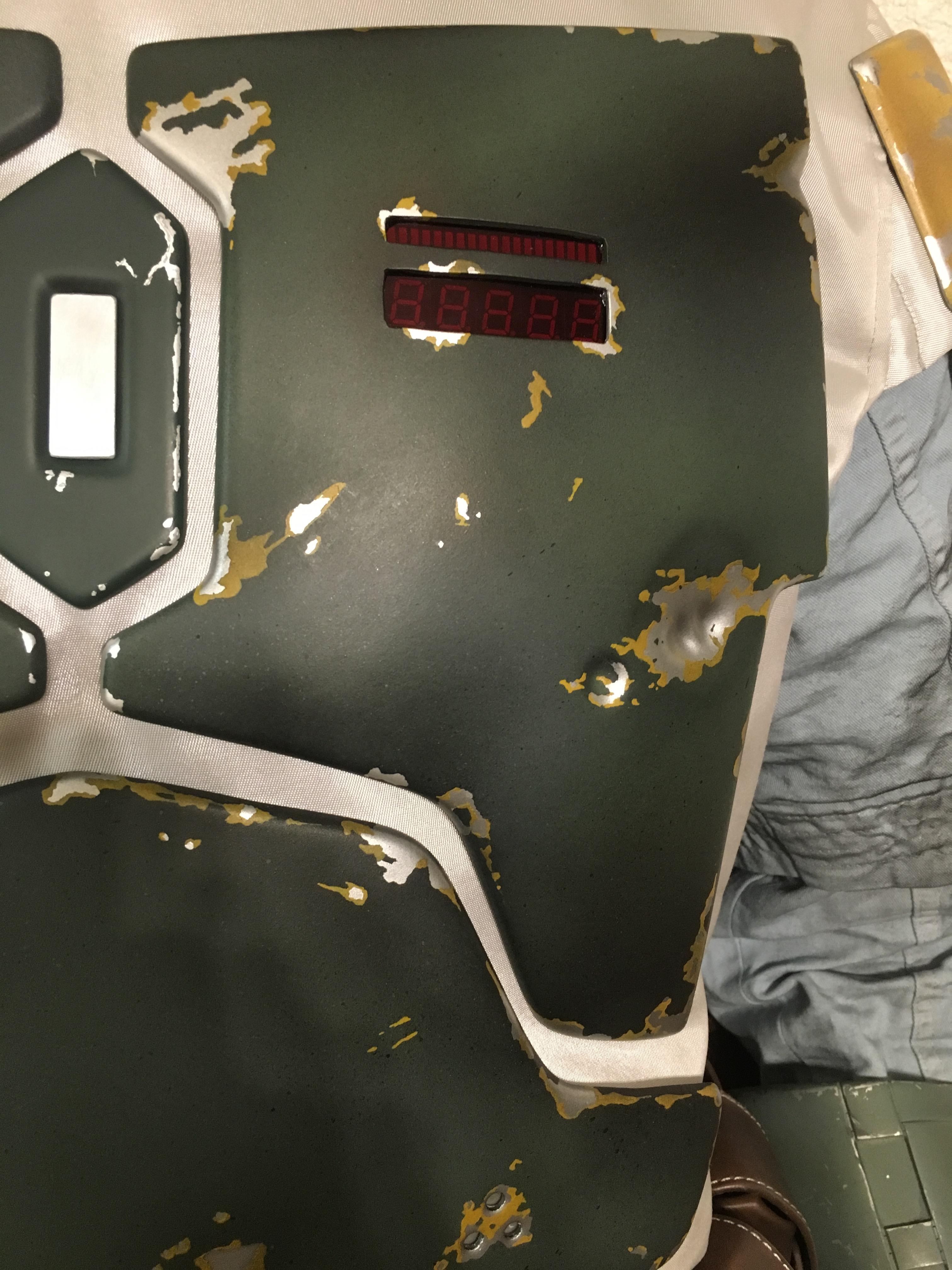

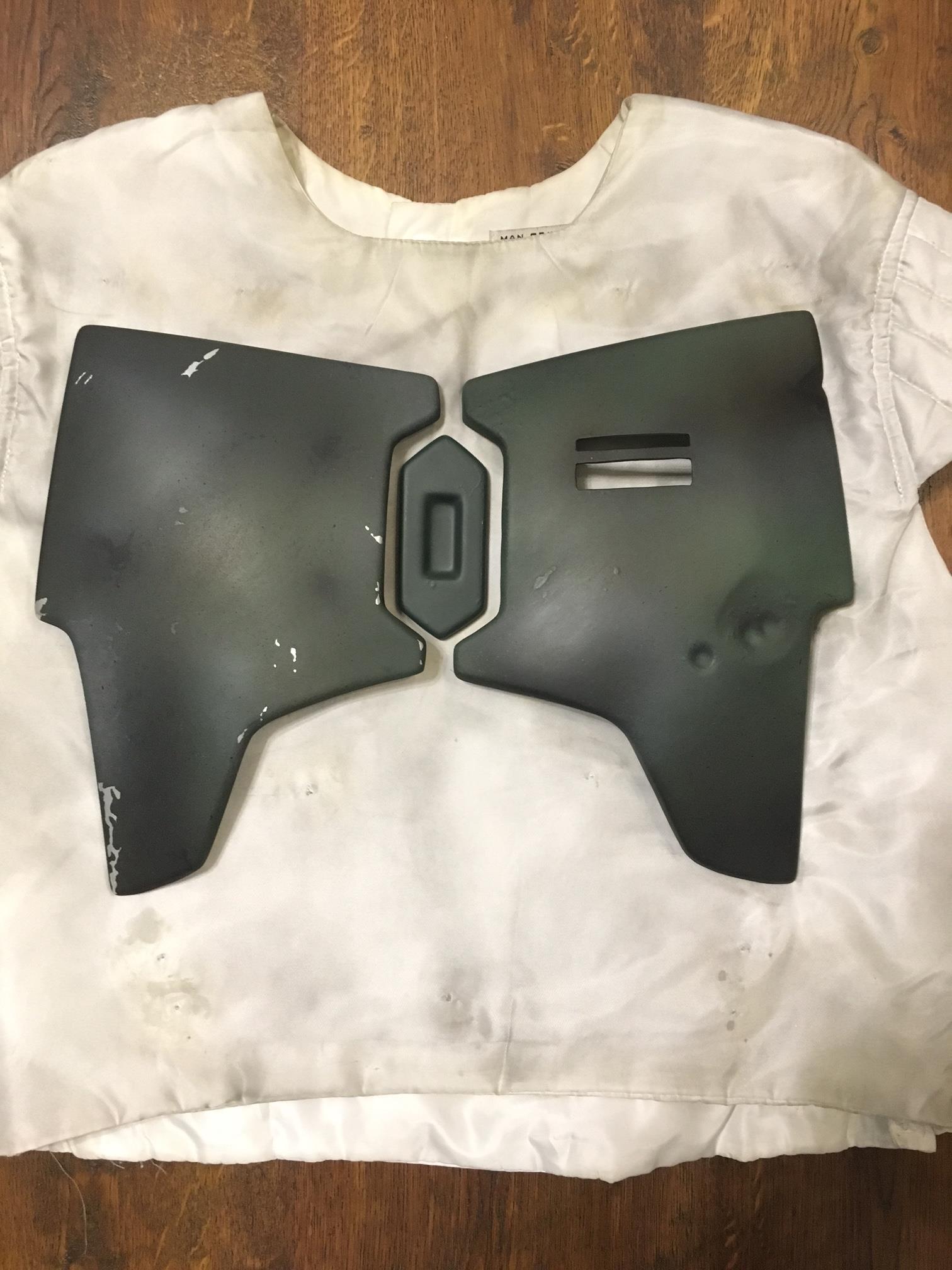

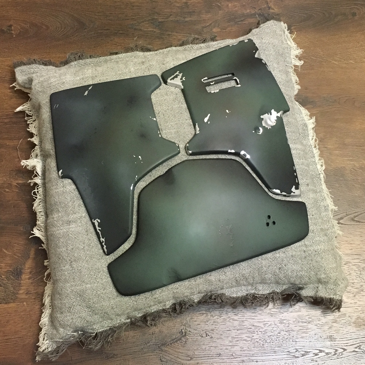

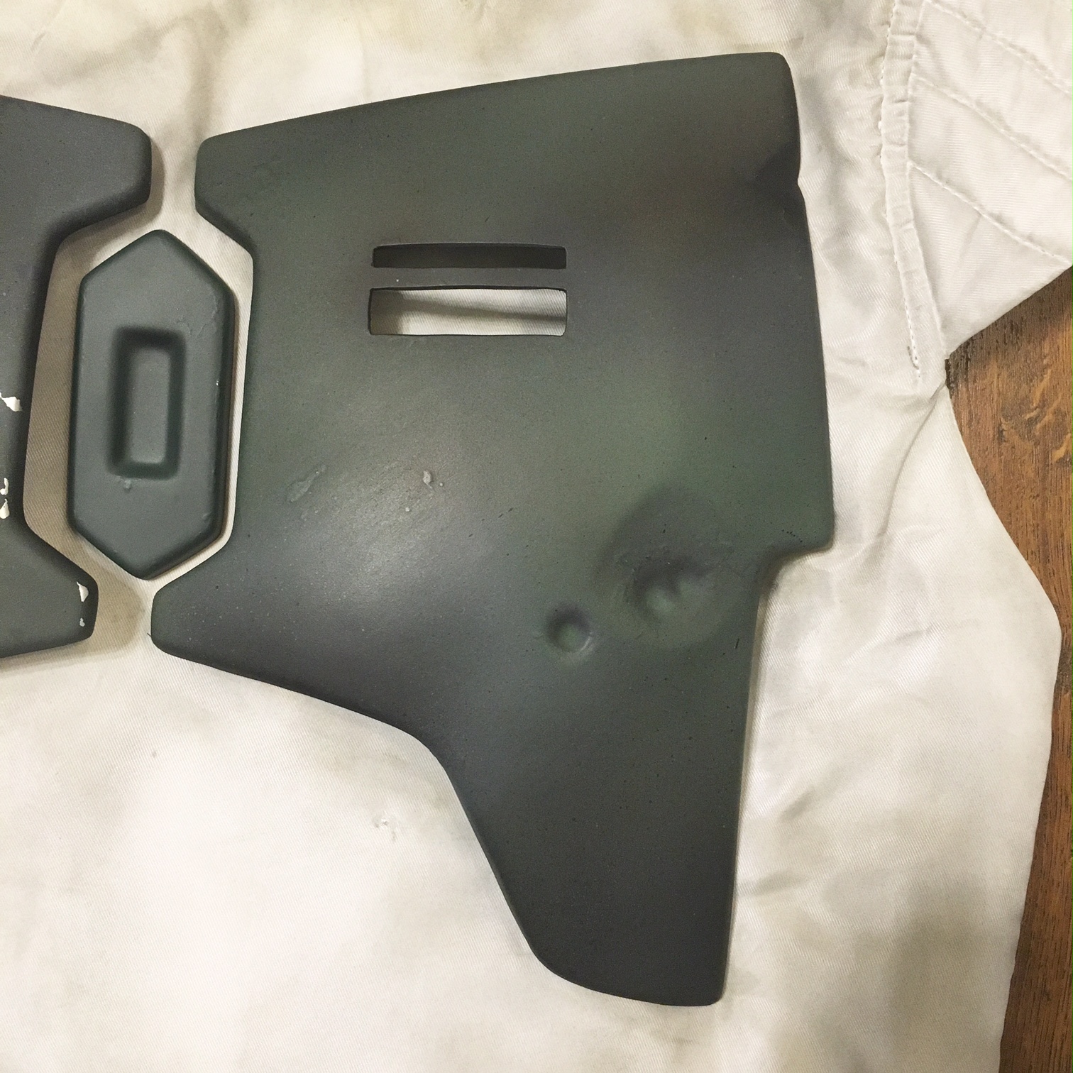

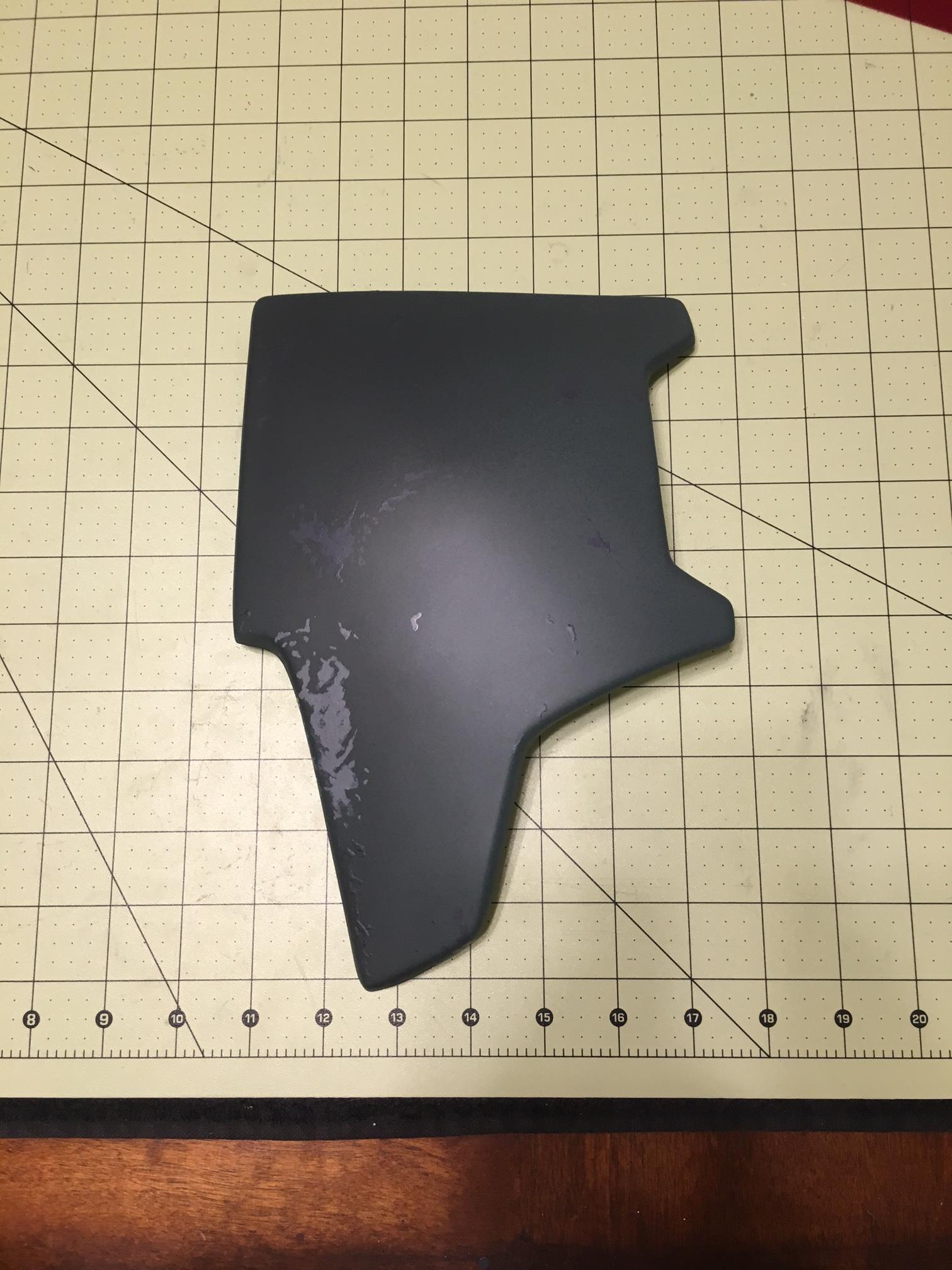

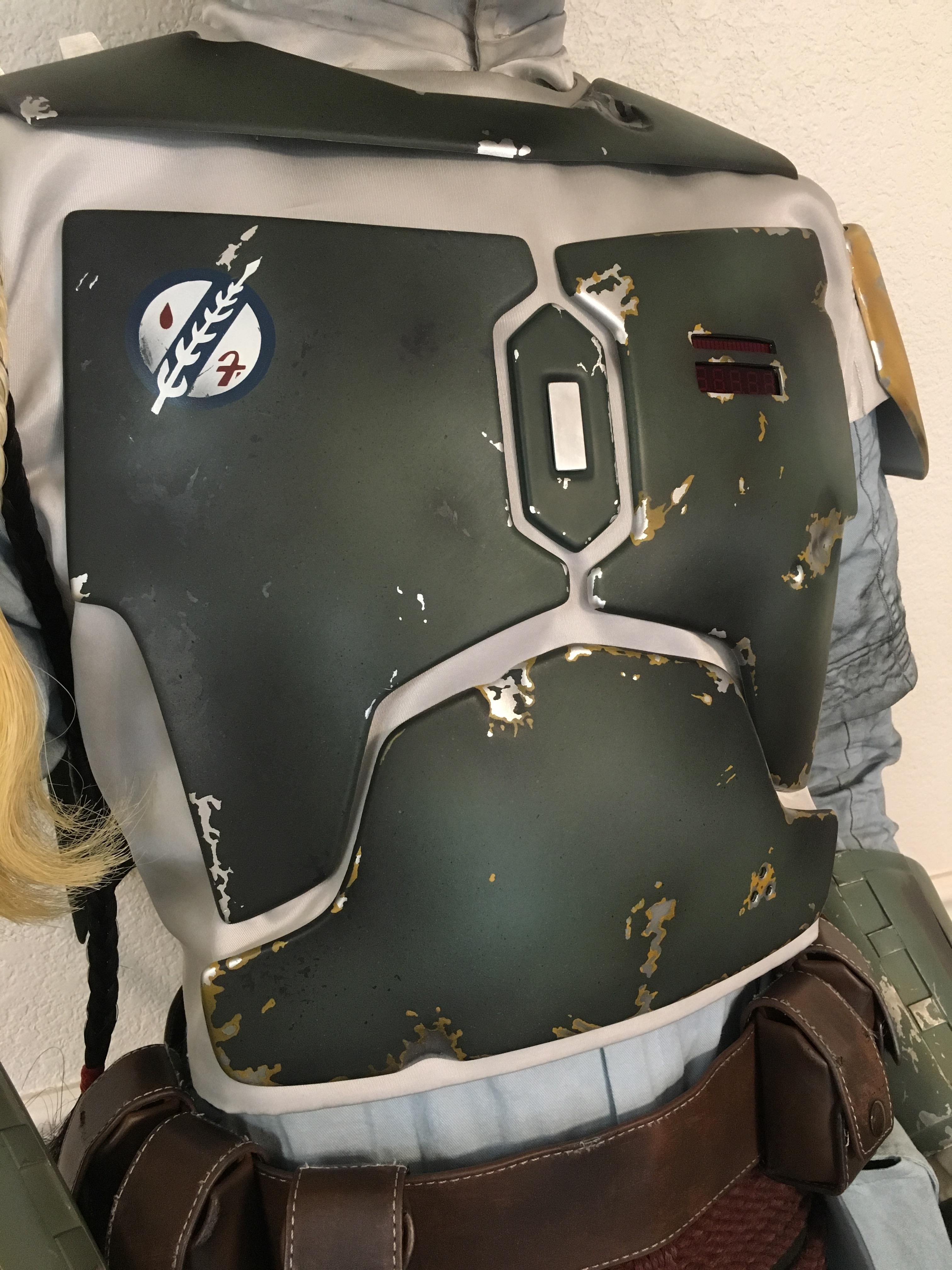

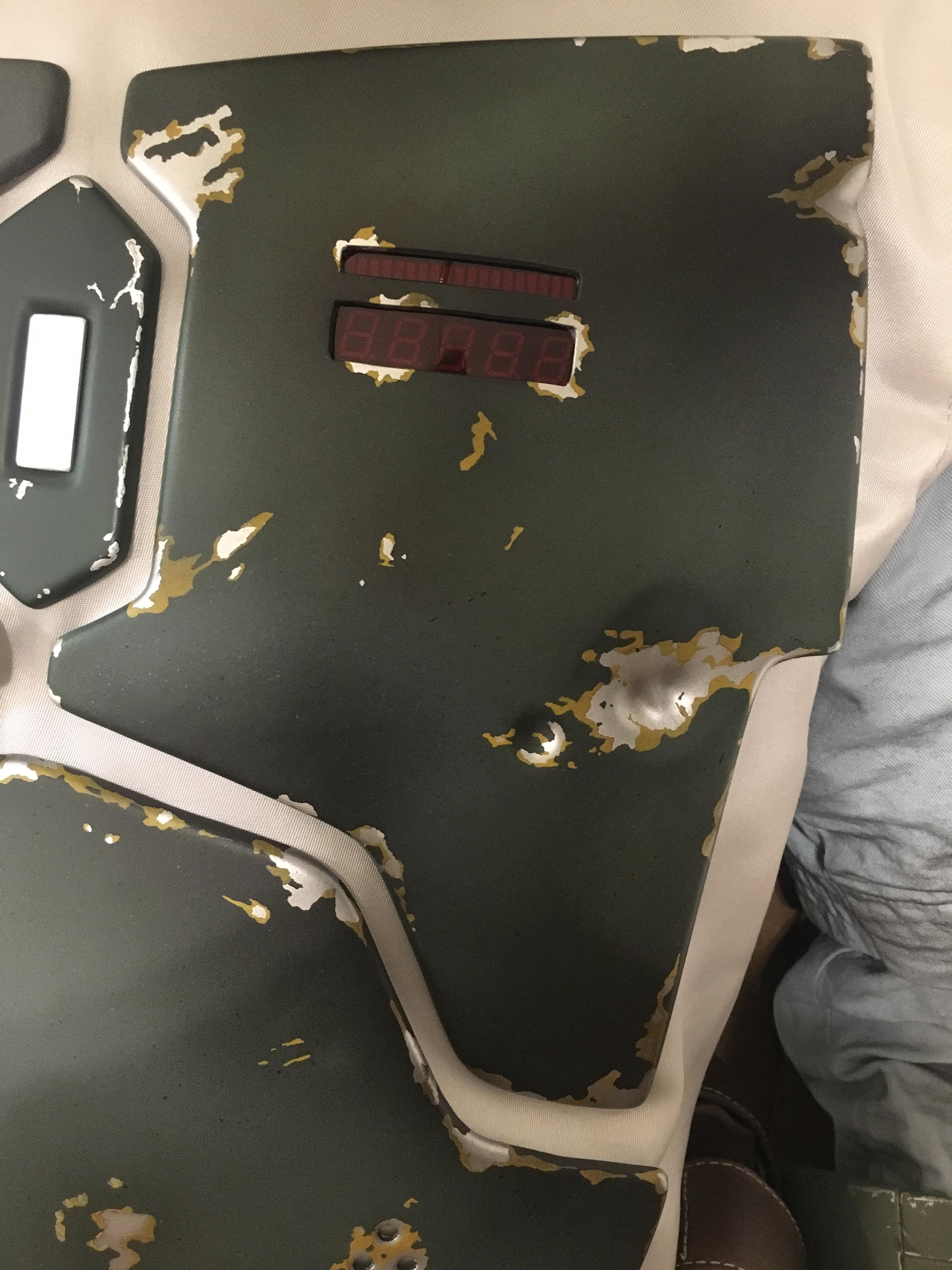

Another upgrade to my Empire Strikes Back Boba Fett that I've been wanting to do is the armor. I recently got the "HERO" armor supplied by Wastedfett on The Dented Helmet. The Hero armor is a bit longer and overall a little bigger than my previous Fettpride V3 armor. I think it fits my 6'1" frame a little better. I didn't fully document the paintup so I'll just post some in between stages for your viewing pleasure.
Right Chest HERO Armor 1.jpg Right Chest HERO Armor 2.jpg Right Chest HERO Armor 3.jpg Right Chest HERO Armor 4.jpg

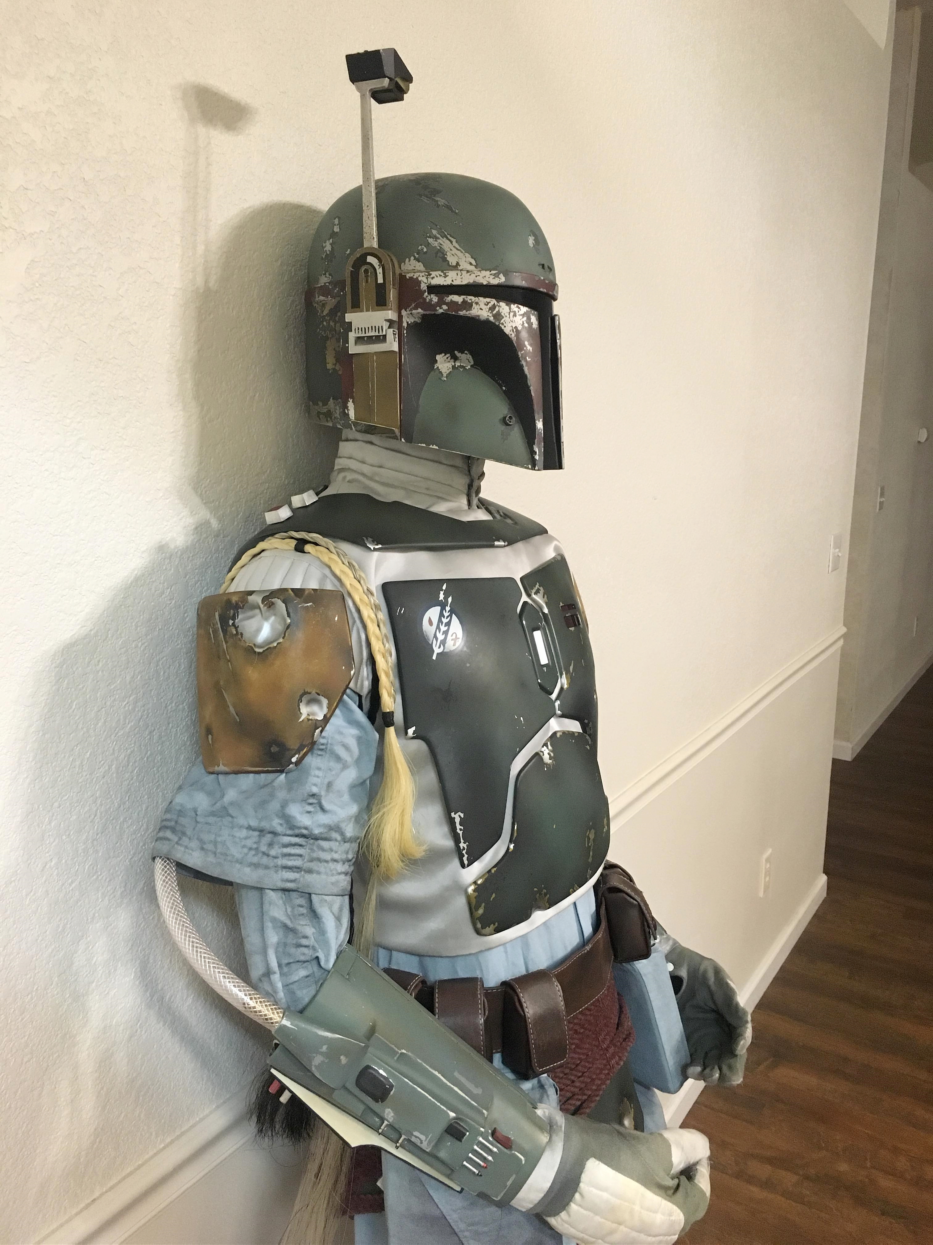

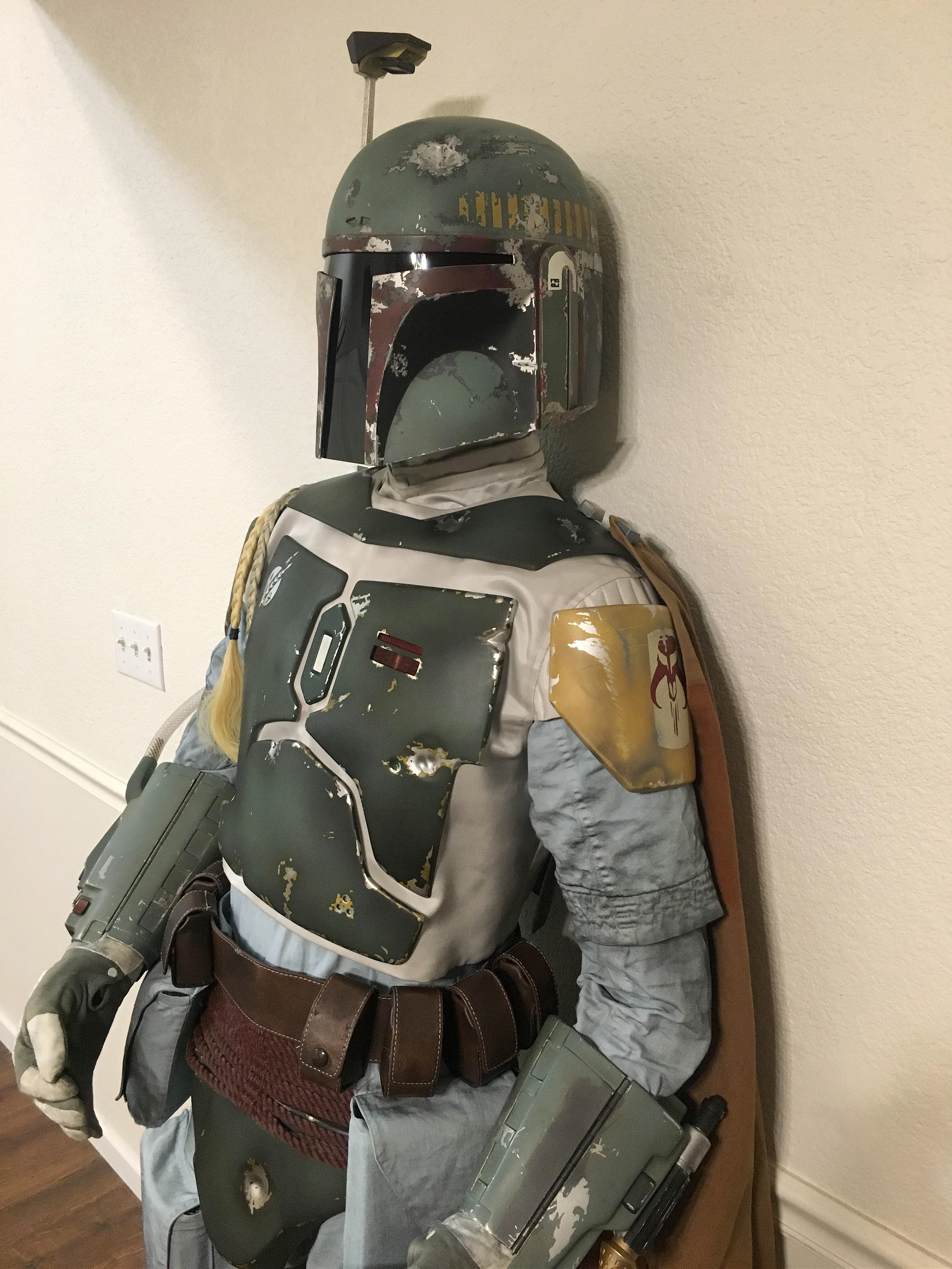

Here are some pictures with me adjusting the finished "Hero" armor on my mannequin.
Fettastic Boba Fett 3.JPG Fettastic Boba Fett 2.JPG Fettastic Boba Fett 1.JPG

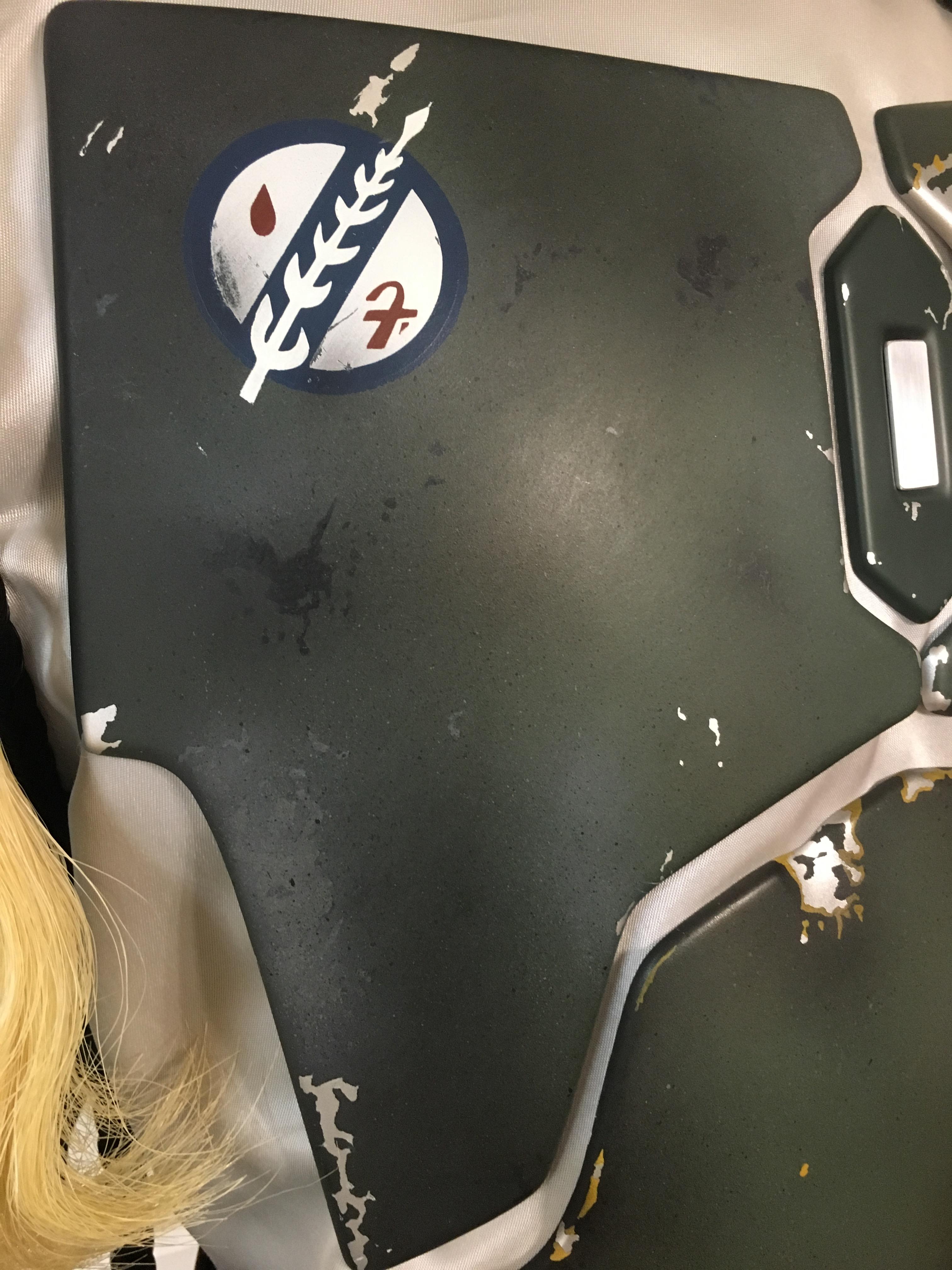

A couple other improvements I tried on this armor was actually painting on the Fett crest instead of using a decal. Honestly, other than being able to properly weather the crest in stages, I don't think anyone would be able to tell the difference between the decal and this crest that I painted on.
IMG_8978.JPG IMG_8976.JPG IMG_8974.JPG IMG_8964.JPG IMG_8944.JPG IMG_8943.JPG IMG_8942.JPG
Another improvement was using actual aluminum inside the diamond instead of using a silver painted piece of resin. It's a small detail but in person it really completes the feel of the center diamond piece. The devil is in the details
