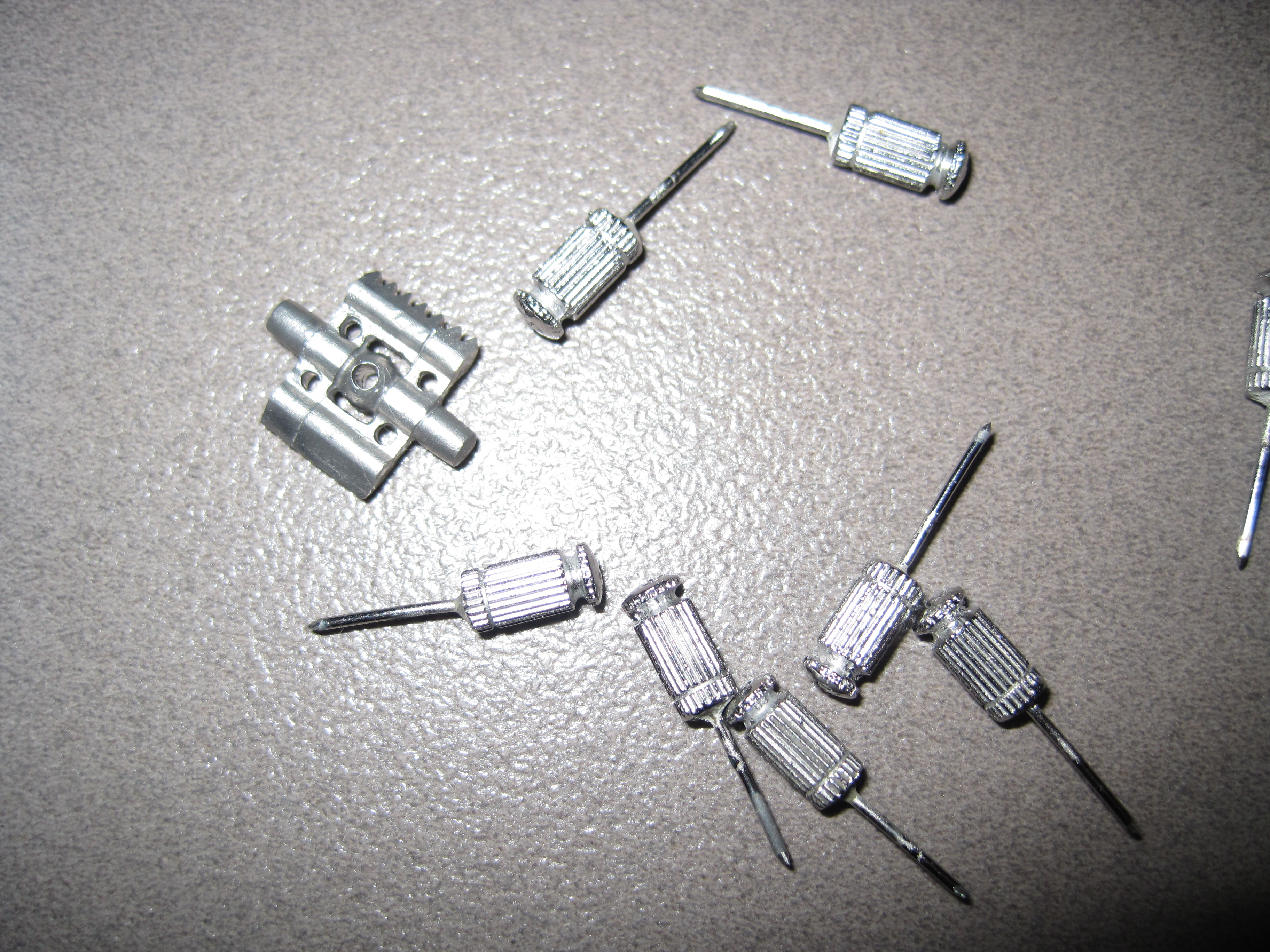

man would love to find a big fat cache of these (and 9000 webleys) and would be happy to, but as it stands originals are gonna be like a mq1 clac, glenross rare as rocking-horse poo, the best i can do is rattle these out best i can, ive taken moulds of my number 15 originals and then cast them, from what i have, so yep there is some details that have been picked up, from damage of the files laying around in the pkt ect, they have come out on the casts, some of the 15's that were stamped on the backs have not come out superclean on the originals and you can see the small sprue moulding on the tops around the 15's so the micro-mega manufacturing process wasnt flawless, this is only minute and in some way adds abit of character. i was really taken back with the pinkysil and the easycast at how accurate it was to get all that detail, it is really great stuff. Im still playing and i know you guys are hankering (itching) for some, im just seeing what looks good, what works best, ect and making in all important cost as low as possible and sourceing machining, i have 2 kids so time is a biggie for me, and i dont want to hand out rubbish when the standard is set so high on this abfab website of vendors.

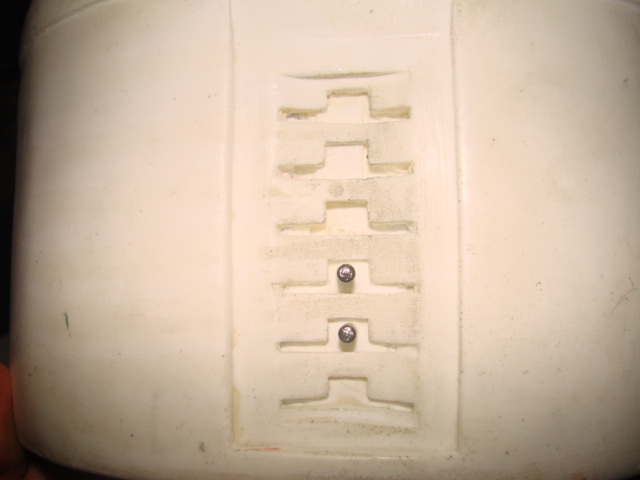

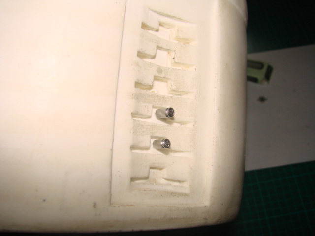

today i put a small recess in the bottom of the nub and phaser (Hybrid) welded, springhardned stainless wire to the bottom of nub end as to replicate the file end which i think was possibly used to heat and push place the files into the silicon of the mq1 half/backing plate, this sounds barbaric and rough as guts but to attain that slight tweak of the nubs on the helmet i thought with F4R's help that this could be a go'er, i was thinking screw or bolt but there would be no abilty to left or right tweak as to how to how you would want them set, i also then used an high heat silver solder to strengthen the weld over the top, so im hoping they should be strong enough for a tweak here or there, but as any metal work hardening will only break over time, and have left them unpainted as i know some have preference and would love to see if the other guys have different colours on offer for the red closer than what i have.

IMG_1718.JPG this is the length of wire added, i thought this was more than enough as the board + the backing plate + allow that half a mil that is stands off the board i only think this as there looks to be a shadow cast againts S1P's pics, collage and gallery pics and enought to give you some play wether you decide to crimp it and glue on the other end ect, but this is why im testing.

could you mold it with about an inch and a half length of solid wire, maybe an 18 or 20 guage. that way it would be long enough to be set in the nub and there's plenty to work with when attaching it to the helmet.

Well i was stoked to come home the other day and find a package from Evil E ,and in it were 2 metal nubs along with another little gem ,
All i can say is THESE ARE 100% ACURATE , if you get to hold one of these youl be shoked at how good they are ,and i hope he decides to make copys of these becouse they are amazing id seriously pay $50 for a set the casting methods he uses are proffesional dental tec methods , they are so good , that i now am ampt to put them on my GMH along with an acruate borden and some metal ears, and a real micro switch (found a great supplyer, and 2;) are in the post) ,And a real MQ1 board (not to mention the interior workings
I could seriously blow my horn about these for pages but i wont, I seriouslly hope E desides to do a run becouse they will be the perfect finishing peice for a PP2, rotj or sandy style helmetsDSC04418.JPGDSC04419.JPG
Been mucking around for the last few weeks playing with silicons, acrylics and resins, anyways made some moulds (pinkysil, great product by the way, silicon at work was way too light) of the red no 15 reamers (helmet Nub) and have cast some in easycast resin (another great product, picked up every detail)i then sprued them to a job at work and cast them up, got 10 out of the 12 that i was happy with.
Castings are coming out really nicely! I wonder if it might not be a good idea to try to cast a small screw into these so they could be bolted on to the helmet.
I think a bolt might make them be in too perfectly. I know it's probably just from having gotten beaten up over the years, but the shots where you can see them, they are crooked and uneven. The wire would lend itself nicely to that. :)
They come with ,like half the file still cast on to them all i did was heat the end up and pushed it through the plastic, and once i have a helmet worthy of these, ill do the same and then bend the end thats stiks out the other side down to holdem solid,

I think they are a bit to small to but a screw in there and for it to be workable,

was actually going to put a cut the bolt tip off and phaser weld it to the back half of the nub, i bought small bolts for this, but not being able to tweak the nubs as shown in S1P's collage and ref pics, Art im curious as to how these are attached if you could shed light, it looks as if the nub sits on the mq1/BP, looking at S1P's top pic on his thread u can see the transistor at the top of vent so this is half of the mq1-backing plate (i did say backing plate, what ever it is in the above posts).
I could seriously blow my horn about these for pages but i wont, I seriouslly hope E desides to do a run becouse they will be the perfect finishing peice for a PP2, rotj or sandy style helmetsView attachment 50885View attachment 50884
cheers mate dunno about that much, all though there is a bit of work in these, but its all about the community, i have all intentions off running these, just see what some of the other champions here have to say. the good thing about having casts over machined is that its a non sterile, you will actually have a cast of what i have, the right amount of parallel finger grips, the 15 the way it stamped on my originals, and the diameter, as the files increment is size as they go up, some small blemishes are inherited all thats missing is the paint but that is something i will persist with to test as discussed above. obviously with machining i would endeavour to take the originals to the manufaturer for 3d cad machining/lasercutting? to have them as close to possible ect.

thanks STG so far i only plan to do 2 versions metal as passed on to the other guys to trial and test and resin. 8mm stainless springhardned with a small loop for rentetion for the pure resin dipped as it sets, and so far as mentioned the stainless 8mm welded on the back of the CoCr castings, the other option was to maybe thread the casting sprue. i think the wire is the way to go as cheap as it sounds i reckon they would have heated the end pushed it through then either cut it or crimped,then glued or i dont think the file could have screwed in using the cutting part of it as its just to fine this number file the larger sizes the 70 and 90's sizes there would be no problem there, hoping Art can shed light here.
