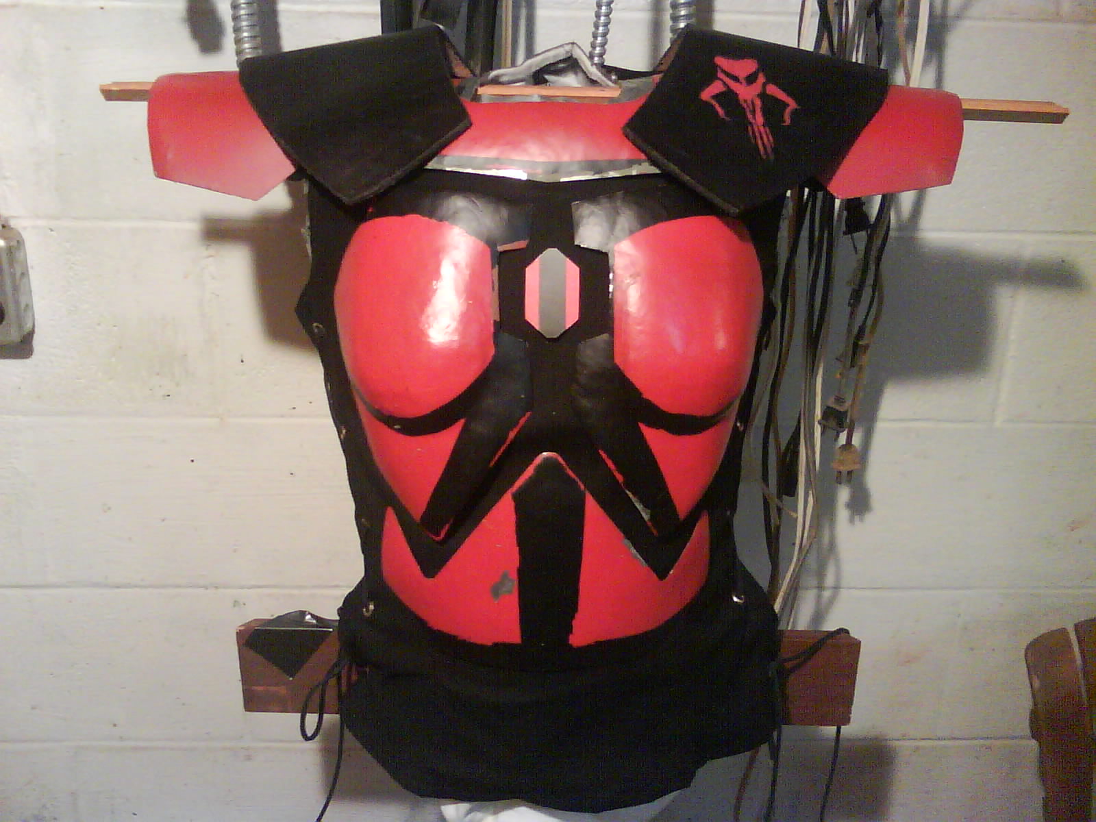

Been working on the blade spring housing and mechanism for the right gaunt. It's about half way done, but the pic shows you pretty much how it's gonna work.
On the top and bottom of the housing, a guide trench will be cut. The blades are one of a kind laser cut stainless with 2 thin shafts coming out either side of the tang (back of the blade) that fit up through the guide trenches. These will be threaded and a small metal button will be screwed on. By pulling the button back and pushing it over into a nook or U cut, you'll be able to cock the blades back. Flicking the button will result in the blades releasing and springing forward.
The spring is very strong, so I'm glad she's a very fit girl or she may have probs with it. The blade itself will be serrated but not sharp and slightly rounded on the point so not to get to many eyes from the guards.
I have an aluminum shaft that that will fit perfectly over the spring to direct it's energy. I only need to cut about a 3/16 of an inch gap on each side of it to allow the blade cocking shafts to slide back.
Feel free to use this on your own armor if you wish. This female set is a prototype for many fun "innovations" I'm designing for mando armor.
The springs are out of 2 Daisy pellet pistols. Basically they are the charging springs. Probably way to much force behind these for plastic to hold'em. I'd go with a weaker spring if you want to copy with sintra.
Right gaunt near completion. Just need to do some finish-off painting with the housing, hinge, and flash suppressor. Add some soft leather to the inside to keep it from cutting her arm, and install the high-intensity blinker circuitry for the blaster.
