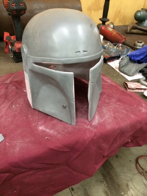

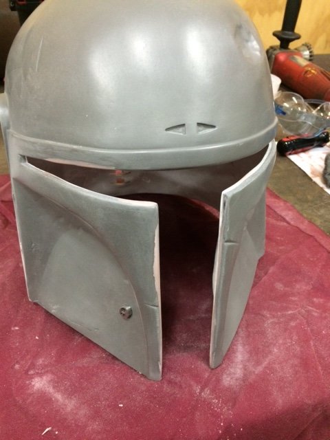

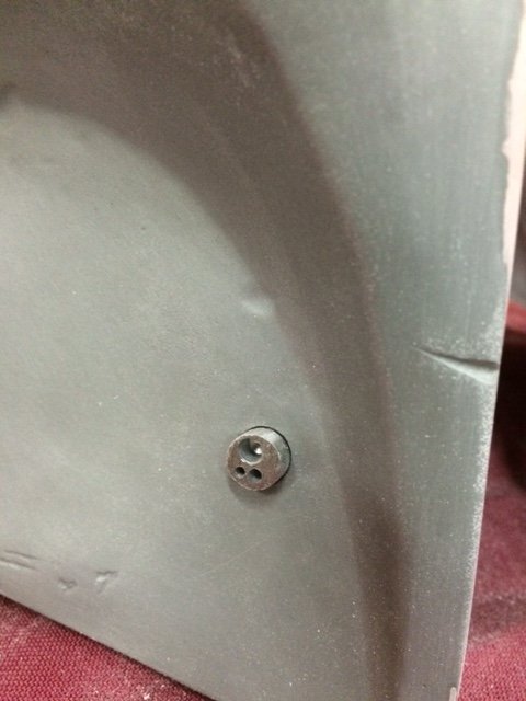

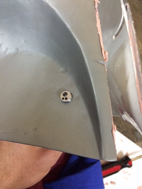

Hey Team,
Here's another DIY. I wanted to make my own steel borden connector so this is what I came up with for a quick cost effective way of making one. If you have the right tools this took me all of 30 minutes to make and cost $0.97. The tools I used were a 1/2" x 8" Steel Galvanized Anchor Bolt, an angle grinder or band saw, bench grinder, a drill, vise grip, and steel wool. I figured the diameter of the Borden by matching a 23/64 drill bit against the cast borden that was attached to my GMH. The drill bits I used to make the holes in the borden were 9/64 for the big hole, 5/64 for the medium hole, and 1/16 for the small hole. This was my first attemp. I may make a few more and choose the most accurate looking one.
Attached are pictures of the procedure.

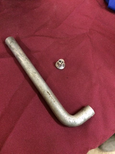

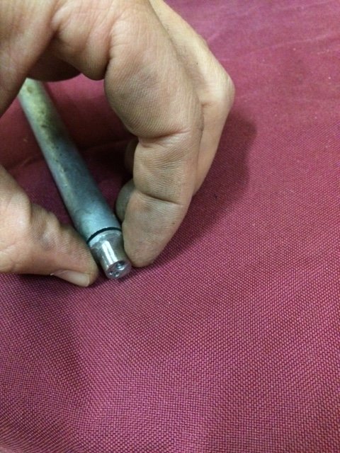

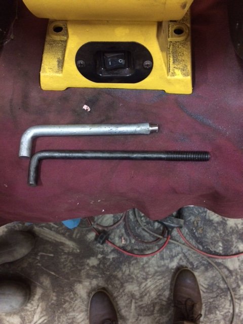

Sorry I missed the first photo shot of the Galvanized Anchor Bolt complete so here is an image of a smaller anchor bolt next to the galvanized 1/2" x 8" already cut.
Cut below the threads of the anchor bolt with an angle grinder or band saw if available.

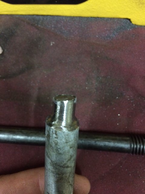

This is the tedious part. Using a bench grinder slowly and evenly spin the anchor bolt around and around frequently checking the diameter to your 23/64 drill bit. Try and maintain an even depth while grinding to create a nice shelf the 1/2 diameter of the anchor bolt. This will make for easy installation of the connector when finished.

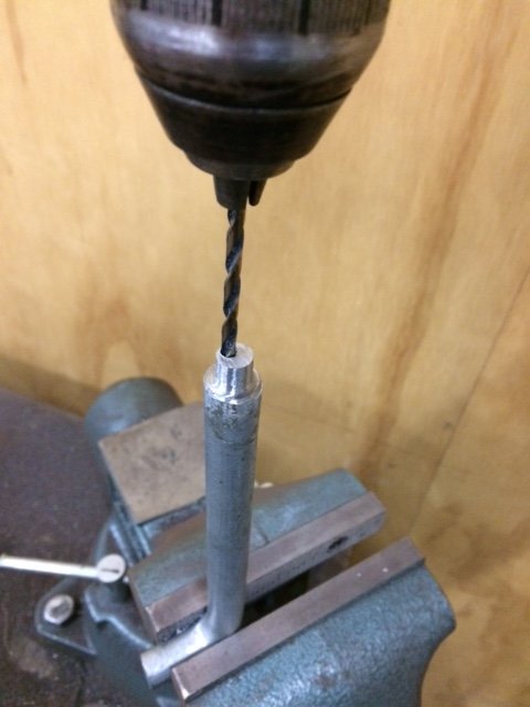

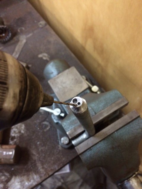

Drill your large hole as straight as possible the depth of the borden stopping just shy of the shelf. Use reference pictures.
Drill your other two holes as straight as possible the depth of the borden stopping just shy of the shelf. Use reference pictures.

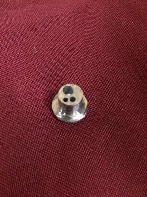

Cut just below the shelf with an angle grinder or band saw if available.
Use steel wool to polish and smooth out any imperfections.
The shelf helps keep the borden from falling out and makes for easy installment using JB weld.
Again, this was my first attempt but I think it came out pretty good.
I hope this helps some other doityourselfers :D

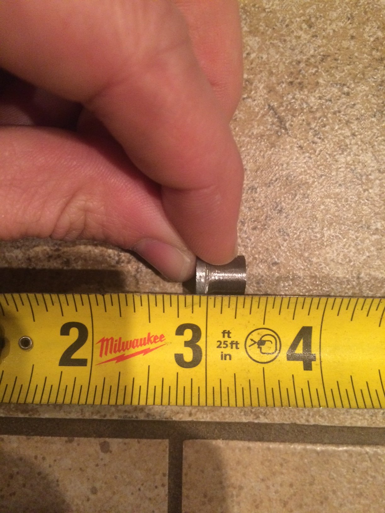

A couple questions. The Borden connector itself is 23/64? I'll have to pick that bit up. How thick is your Borden from the top face to the shelf? I'm having trouble eyeballing it from pics and yours looks spot on.

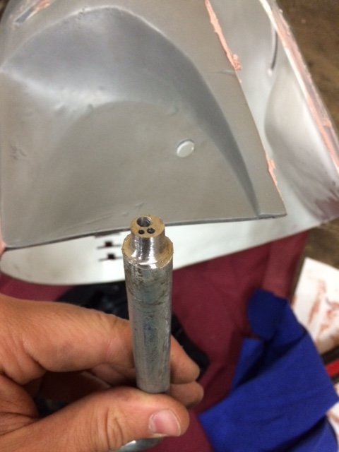

Sorry about the delayed response. I didn't see your post for some reason. Anyways I measured it right at 5/16 to the shelf. I haven't installed it yet since I'm still doing the paint job on my lid but I am probably going to use a washer on top of the shelf because from what I can tell, looking at reference pictures, at the size it is now it may stick out just a little too much.
Yes I matched the diameter of the borden to 23/64.
Yeah, I ended up grinding about an inch to the shelf, which was WAY too much. I cut it off then ground it way down from behind.
As it turns out, having too much of a connector, even after grinding, worked out okay as it is in there solid and the back piece that portrudes into the mask I just covered with hot glue. That thing isn't going anywhere.
I just eyeballed how much of the connector should stick out from the mask. I'm sure I left too much out, but it's good enough for me. And it's a HUGE improvement over the cardboard connector I did.

When I stuck it in the hole from the cast borden that came with the helmet for the first time it made it seem like a whole new helmet. It is such a small detail that makes such a big impact on the feel if you ask me. I should be actually installing it this week in my lid now that I'm so close to finishing the paint job. I can't wait to post Pictures :)
