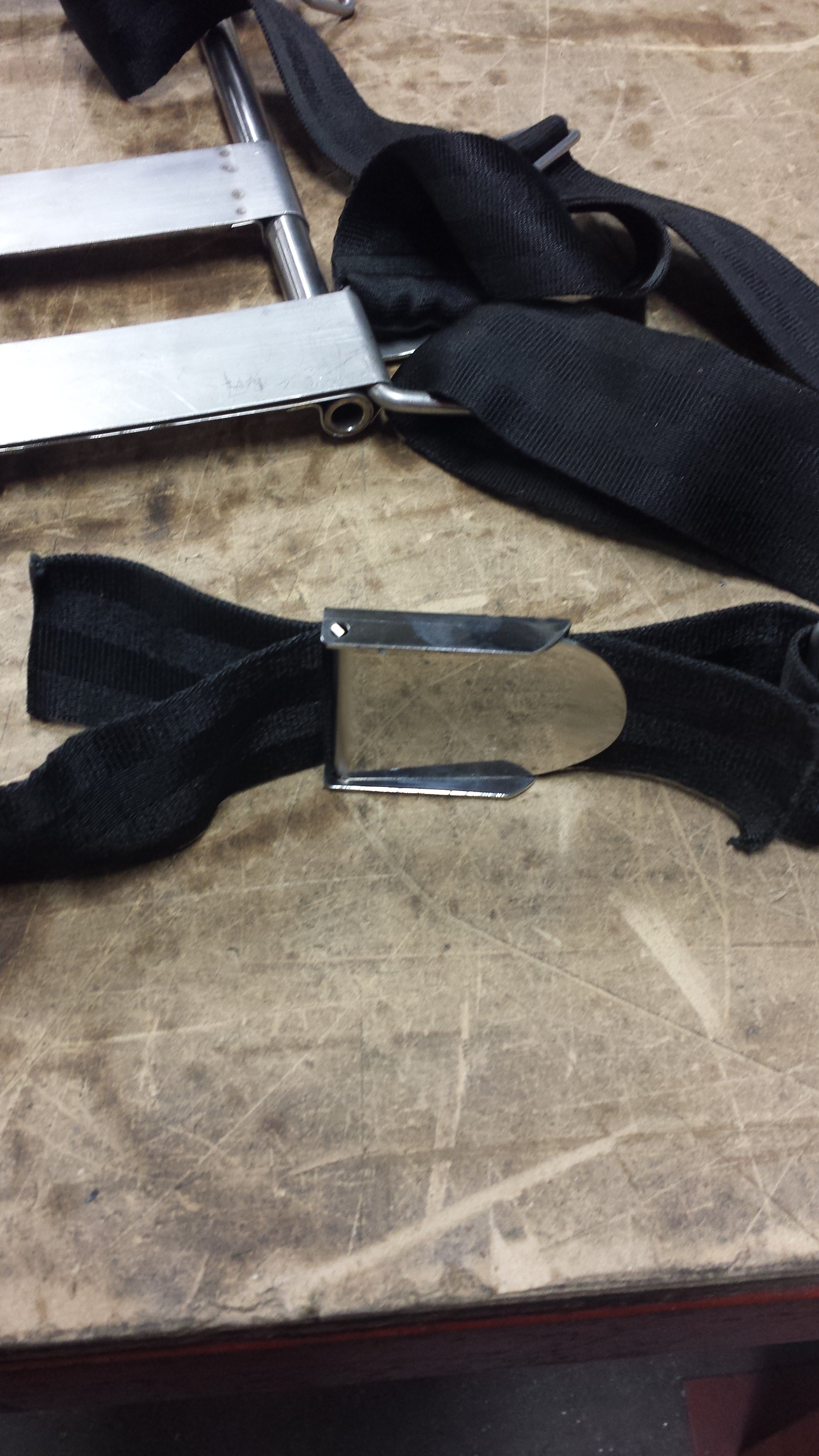

Real quick....How in gods name do you thread the seatbelt webbing into the diver belt buckle.
Every way I do it, It doesn't want to hold? Im going crazy over here. I don't understand how I can manage to build a complete Fett but am
unable to figure out a simple belt buckle
any help would be life saving, Thanks in advance.
-R-

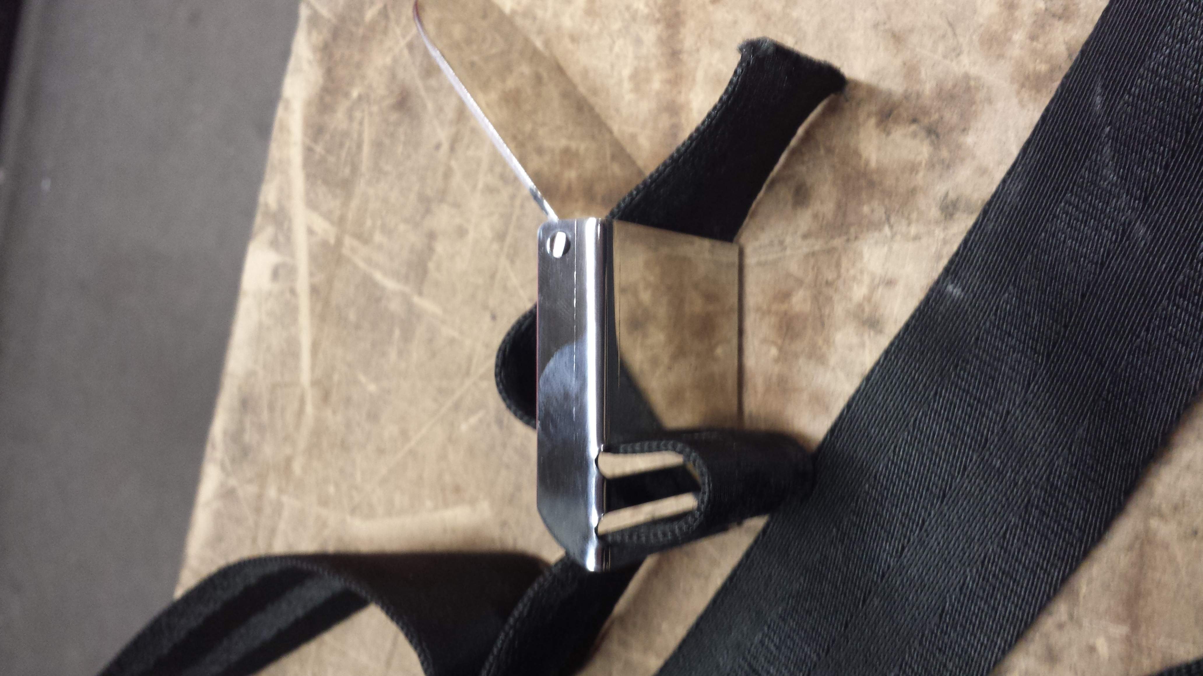

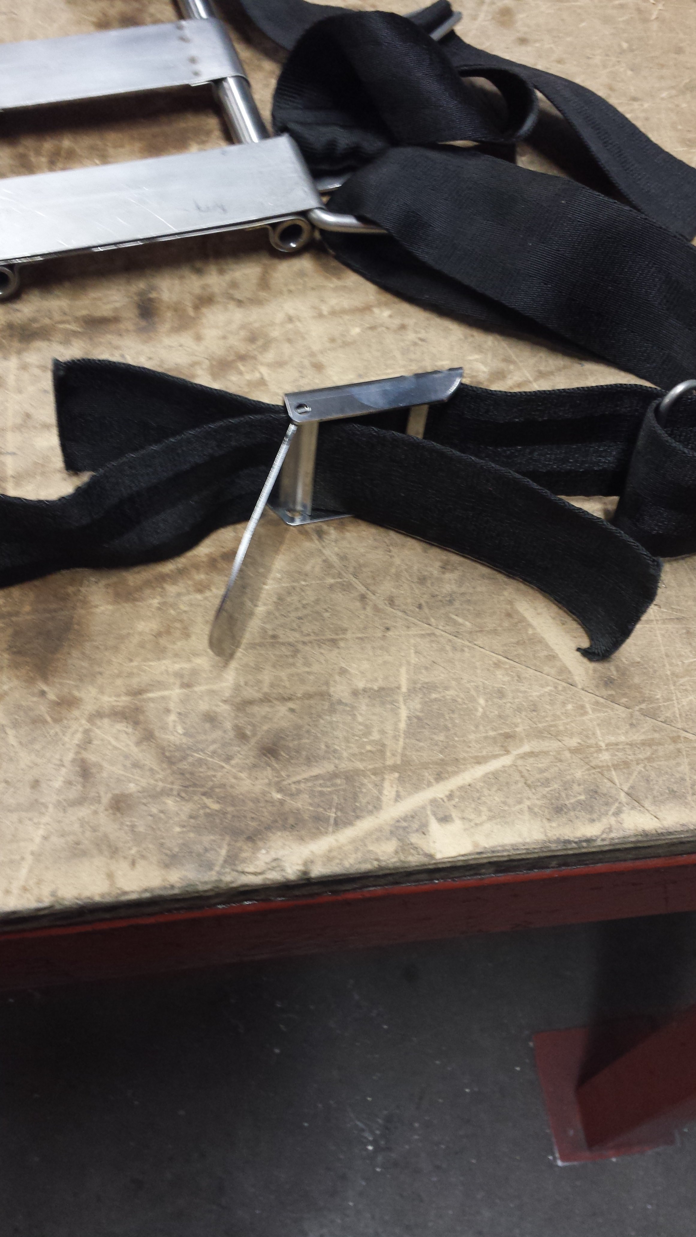

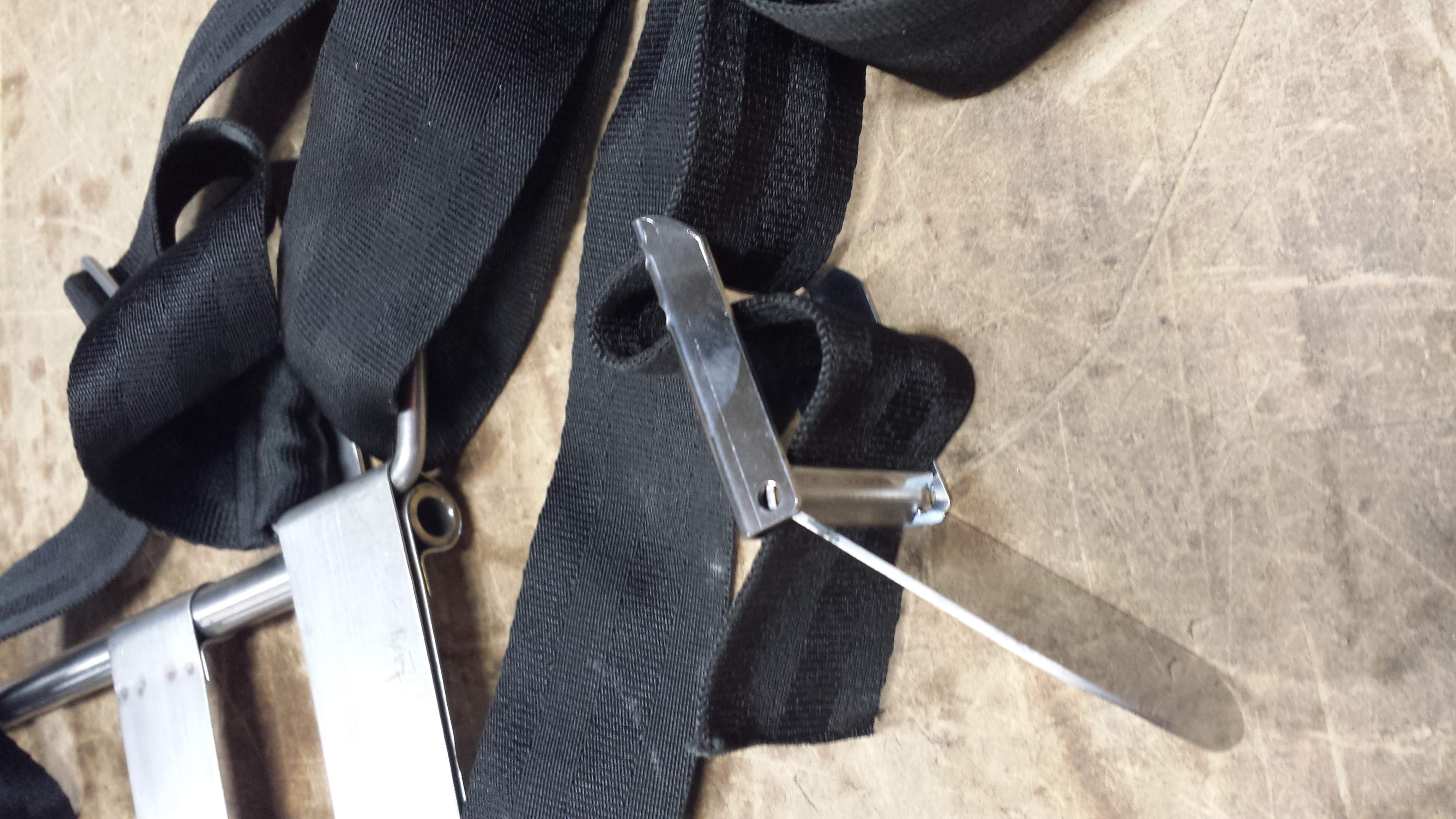

Here ya go.
Not a US Divers buckle, but same technique.
Us noobs gotta help each other out.
This first set of pictures showes how one end of the betl goes through the ladder lock on the buckle.
Shown front and back,with the webbing loose show you can see the path it takes. Then with all the slack taken up.

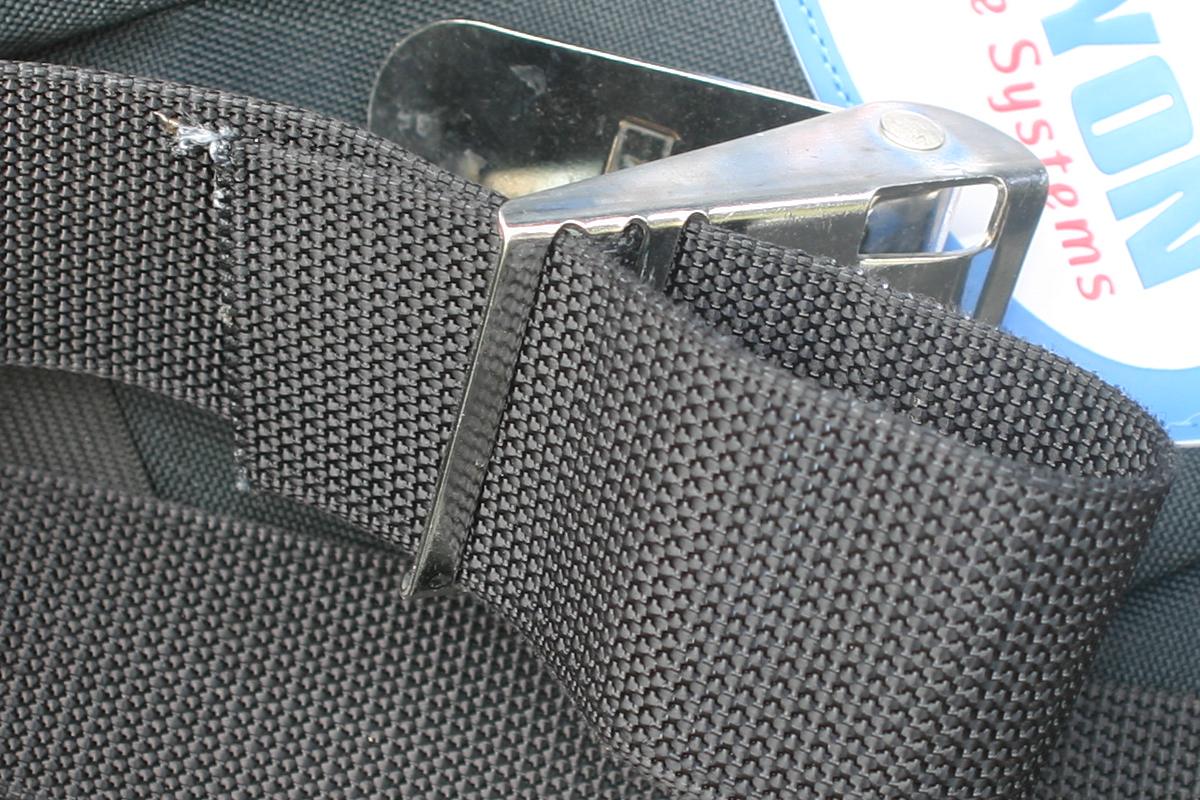

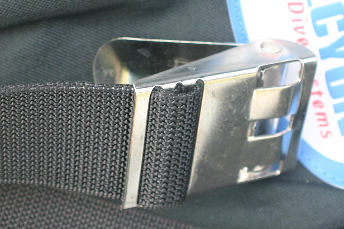

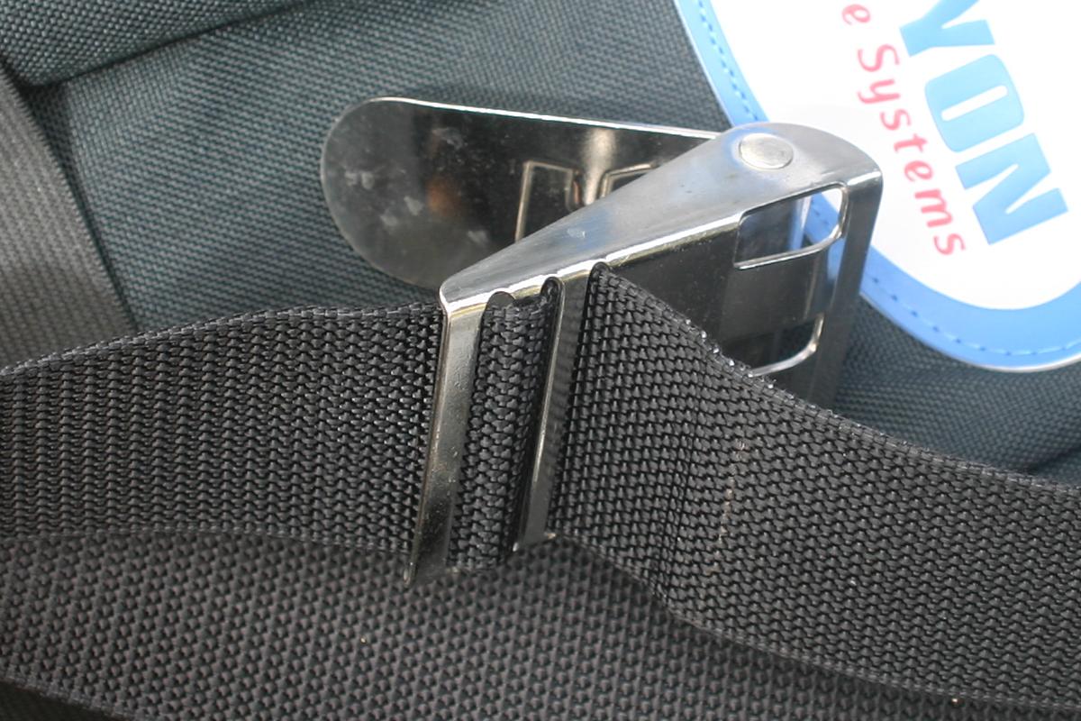

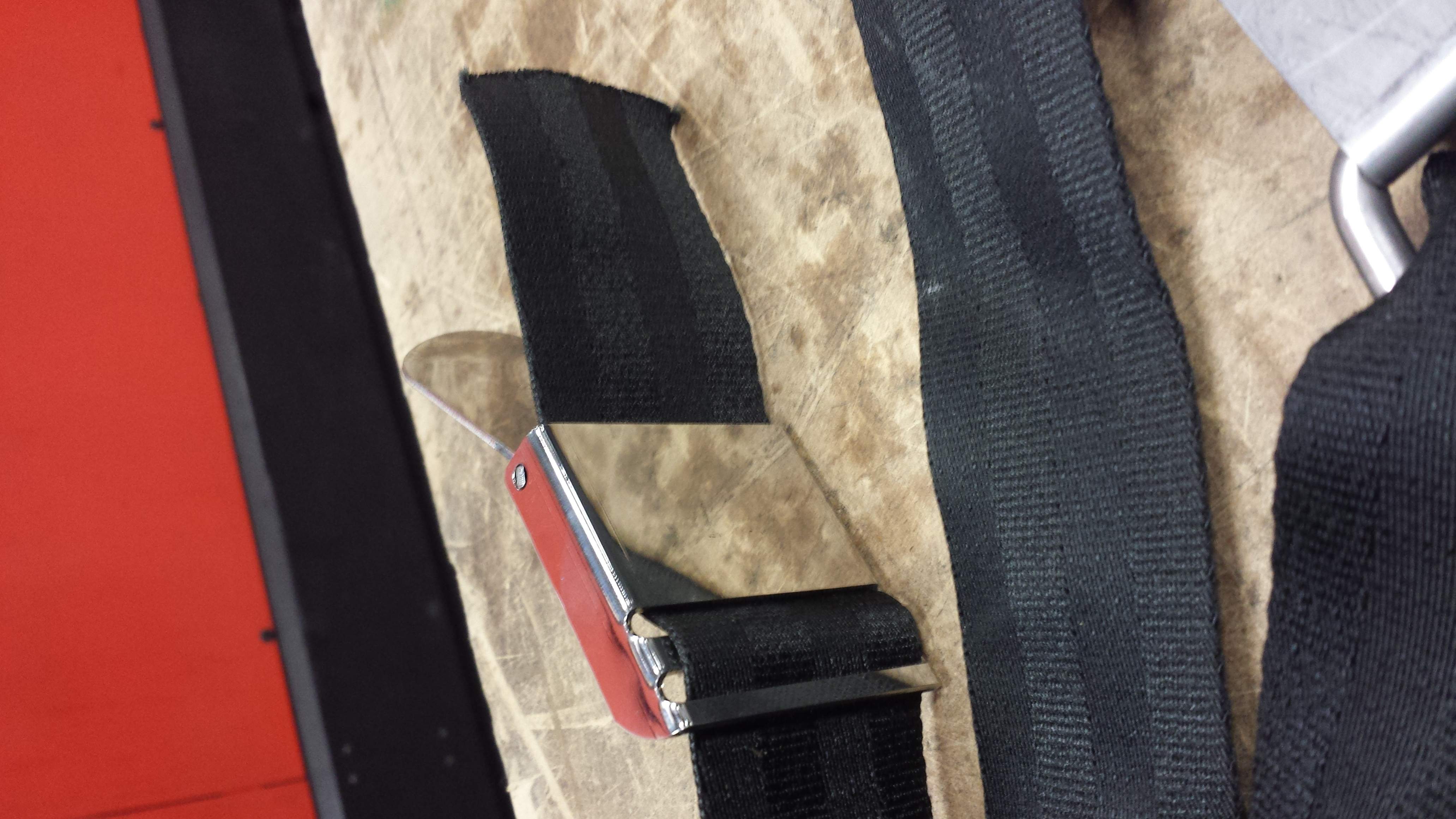

The next two pictures show how the other end of the belt passes through the buckle. Shown with the belt tab open and closed.
With the tab closed it should be clamping onto two layers of belt webbing
