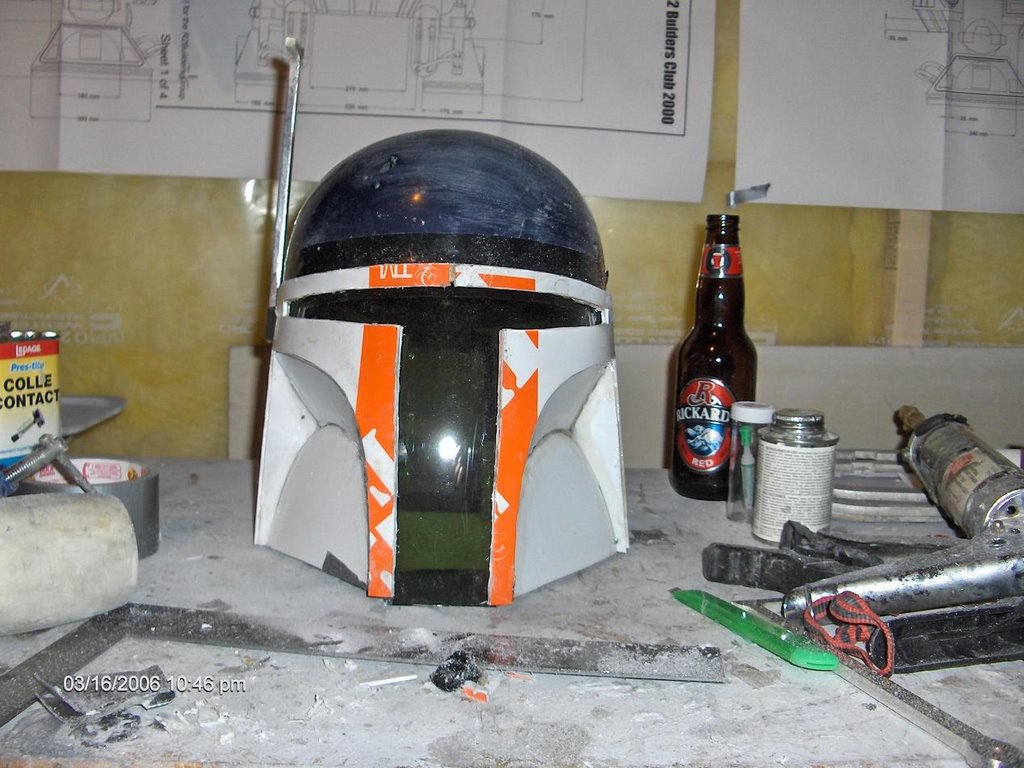

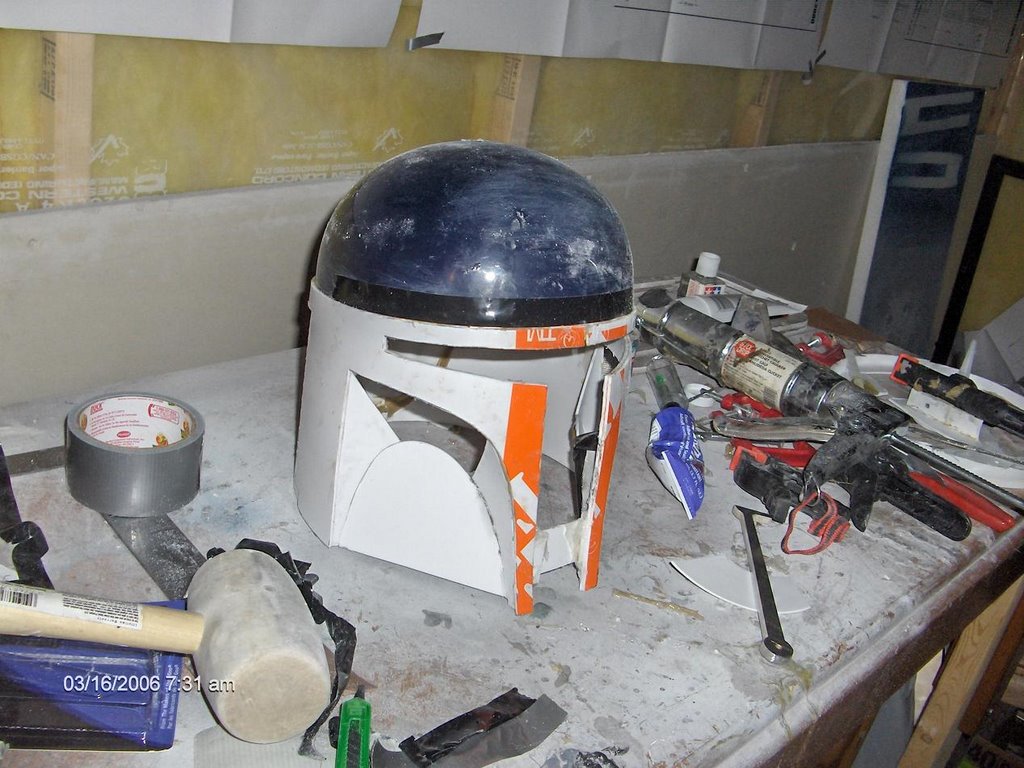

Hopefull Fett, It really is pretty easy...so far. I am just making it up as I go, but I found the buckets, printed out the templates, cut them out, traced them onto the buckets (around of course) and cut them out with a cut off attachment on my dremel. Then I took a batting helmet and tried my best to cut it straight (I eyeballed the height of it using the profile in the templates). I then just glued one layer of the mask to the helmet, then I glued the outer layer to that layer (after a day of glue drying). I am currently working on the cheekbone pieces which are tricky. I have cut them into a few pieces (each end of the cheekbone) and used them to fix it in place. The next step will be to fill it in. Once that is done and I have glued the crap out of it from the inside I will take body filler to all the bad parts, seams, etc. Then I can start working on some of the details.

I added the lower parts of the curved cheek pieces last night. IOt was a bit tricky....thank god I have lots of little clamps and tape on hand. Now that the face is held together I should be able to fill in the rest of the cheeks. If I need to I'll heat them up as suggested.

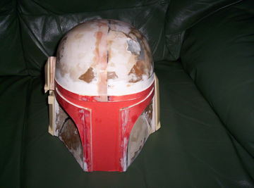

Hankey, man looking good! I may have to do that, it already looks better than my DP97 (although it was free, so I ain't gonna complain).
mine is rough rough rough, and whoever had this ripped off the right earcap. so I gotta rebuild that and build a rangefinder. I've been reading sss tutorial on that one...friggin awesome.

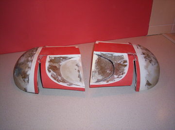

Hey man, altering them is all part of the fun. Look at what i had to do to mine recently :lol: , it was too thin so i widened it and then raised the lid
I thought i was going to cry.

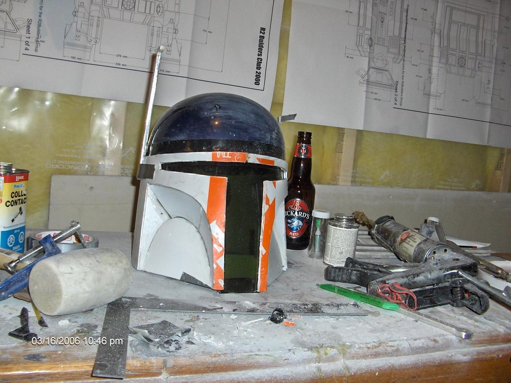

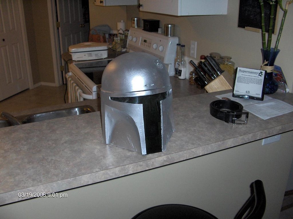

Here is what I did last night.
I got the cheek pieces filled in. They didn't fit very well....but bondo will fix that later.
I also cut away more of the pieces holding the chin together. I left a piece that is set just a bit back so the lens is able to slide overtop. This way it will hold it's shape, and the lens will still go in place.
MandoMan, The buckets were everywhere...almost every aisle had a stack of them at the end on the floor. Check your PM about the RF.
Both of those scratchbuilds are amazing! I just love the way you can spend all that time modelling, decide somethings not quite right and cut the whole thing in half!!! I found a quick method for the forhead arrows was to drill two round holes ruffly in the right position, put masking tape behind. cut the arrow shapes from 2mm plastic card, over fill the two holes with car body filler. Then while still wet, push your arrow shapes in, leave to dry. if you leave them slightly proud you can pop the arrows out with a knife, sand the surface flat with wet and dry....this also worked with the oval cheek slot.
I had to use body filler in the garage with a heater aimed right on the helmet cuz it's cold out there (the fumes smell up the house). I spent the day sanding, sanding, sanding.
I had troubles with some areas where the glue was since the one glue that worked (PLumbers Goop) is pretty elastic, so it can't be sanded. I tried to cover it with filler.
It really does look better in person, and once the final paint job is done I want it to look beat up anyways...so it will be fine.
I am happy with how the dent turned out (using filler). I have painted it silver, and will use latex masking liguid that I got at Michael's to paint on the paint chips and scratches..then when I paint over top and remove the latex...you will see the metal underneath. I found all this from these great forums! :)

just keep sanding and filling sanding and filling sanding and filling sanding and filling sanding and filling SPRAY SOME PAINT sanding and filling san.....i reckon it will look awsome once you add some grey primer... ( let us know what it looks like once you've joined it back together:) )

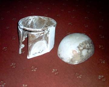

Terminal - The first pics i posted are what it looks like at the mo, soon take the the final cast and then pop a fibreglass bucket out.
