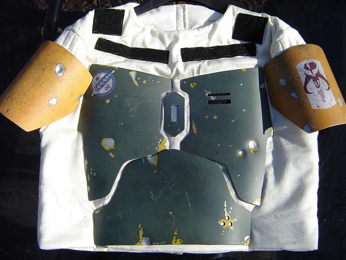

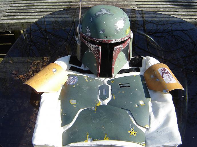

UPDATE: ok pics (finally lol) Krylon Italian Olive misted with Krylon Hunter Green, weathered with flat black spray and greens/grays/browns pastel chalks...sealed with Testors Dulcote then light coats of Krylon clear matte to get that little bit of "sheen". Shoulder bells are Krylon 1804 (Bright Yellow/John Deere yellow) weathered the same way.

thanks for the replies all...I went with Krylon Italian Olive satin 3522 (same color as non-rangefinder earpiece from AFFO$ list for the airbrushed challenged) misted with Krylon Hunter Green satin 3502 just because I like the drying time as opposed to the Rust-o Sage Green, and it is a bit darker. Have a little weathering left to do but will post some pics just for future reference! Ciao!

GCN no it is sewn on with green thread and big stitches...in that light they DO look like staples lol. I should note that I just repainted the armor when I realized that the ESB damage is different from the exhibit armor that I used as reference, and the color was off...it looks pretty good in that pic but in person it was way too olive drab for my taste, especially after watching ESB SE on DVD and noticing how the armor looked (at least to me) much closer to a forest/hunter green than olive drab, especially in the cloud city shots that are well lit. I went with straight Krylon Hunter Green and brightened it a bit with green pastel chalk...here's a bad pic (in a poorly lit room with flash) and it almost looks blue...still have a good bit of weathering to do as well.
