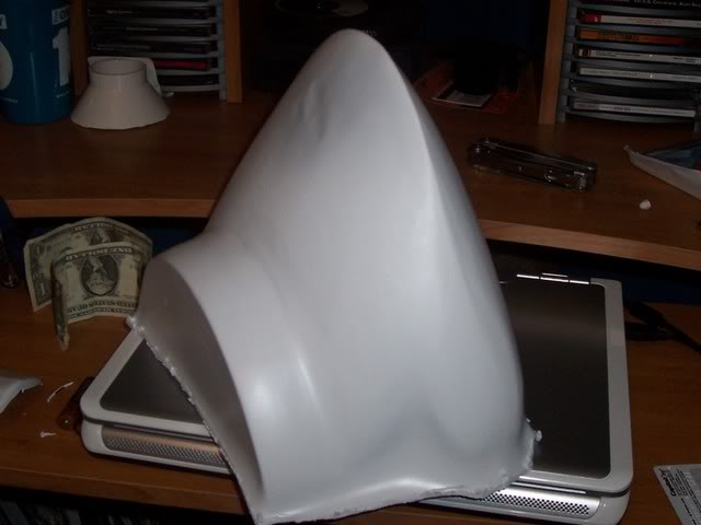

Some better results, but I need to improve. First off, the helmet mold. I have gotten better at learning when the plastic is hot enough, but Im still having issues getting these corners soft enough. For the helmet mold, the second time casting it, it came out more sturdy and the plastic stretched enough to allow the top to be thicker, but it cooled a bit before the bottom could form properly. Second time, it actually formed completly, and was the first time it has formed completly, but the plastic is just too thin. I know that the HIPS can stretch enought to keep it firm, but I need to get thicker plastic, because I cant keep wasting good sheets until I get it just right for one mold. Here is the first formed piece:

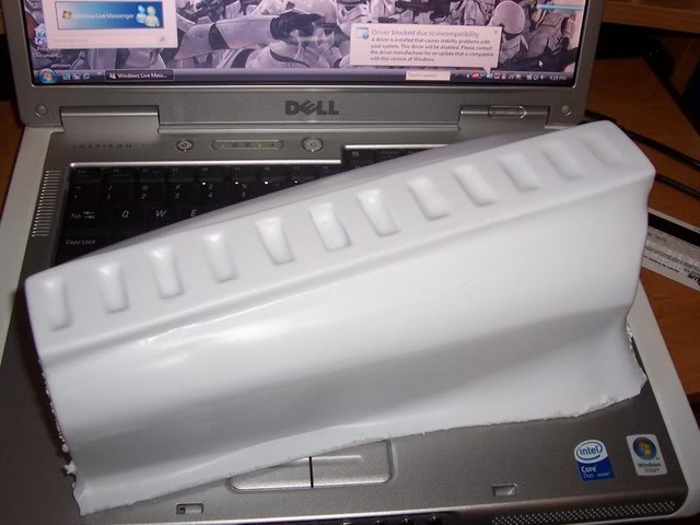

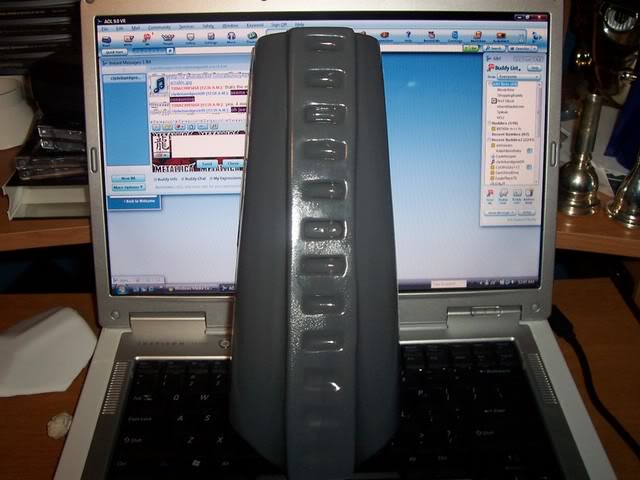

Next up, I decided to give the guant and hand guards a try. Im a bit happier this time, becuase it formed somewhat, and almost all the boxes formed great as well. Pictured below, is the better of the ones. This cast however, the end boxes didnt form completly due the plastic not stretching enough.

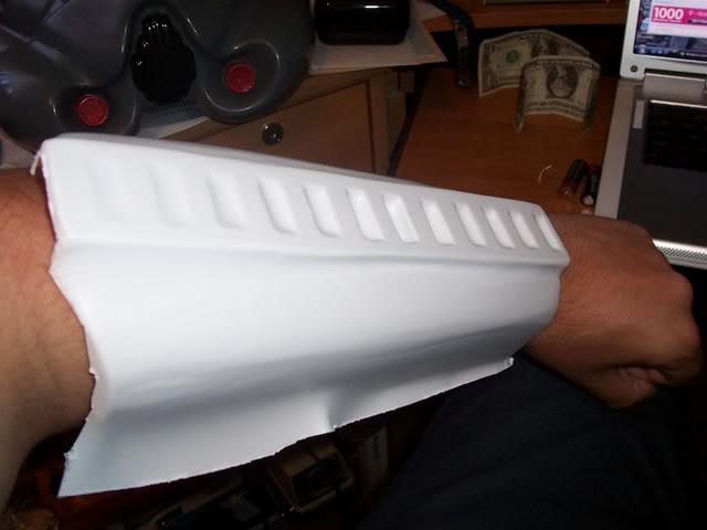

This is probly my first good cast, small, but Im happy about it. This is the left hand guard which formed with the guant above. The detail appeared and no defects. I just roughly cut it out, and I need to cut and sand the edges and its a keeper. Now I just need to do this with everything else.
Note, the detail on the surface, the line on the strip closer to my thumb is hard to make out in these pics, its there, just the flash makes it dissappear.
More practice needed, but I think I have improved a smidget.

Wow that looks great! I'm surprised you don't have that many replies since you posted your work. For the helmet, maybe you need to cut the mold in half going down so you have 2 symmetrical halves. I think since it's so tall, the plastic has to stretch so much, but if you cut it, you could lay the pieces down with the fresh cut to the table, and have two halves to the helmet back. Just my 2 cents. Those look like some good smores.

I had actualy thought about possibly cutting the helmet mold in two, but Im afraid of how it would look having seam running down the center of it. Im just going to use thicker plastic, maybe even try to use ABS so that it will match the rest of the helmet pieces. Jus to throw out this question, does anyone know the type of ABS or even what source they use for the FX TK suits? Thanks guys!

If you cut it in two, can't you re attach the pieces then use a filler? I'm not sure how much bondo likes plastic, so you'd have to ask someone else about that.

I guess I could try it, but I wouldnt want to risk it. I took the better formed cast (although thin) and cut some of it and just wanted to test fit it. Im gonna have to make a few adjustments to the mold. I also took the guant half and the hand guard, and cleaned them up and I may even keep the guant half until I cast the bottom half. The hand guard is definatly a keeper, so Im just gonna have to cast the right hand now.

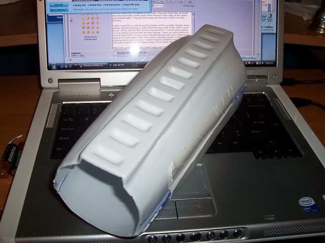

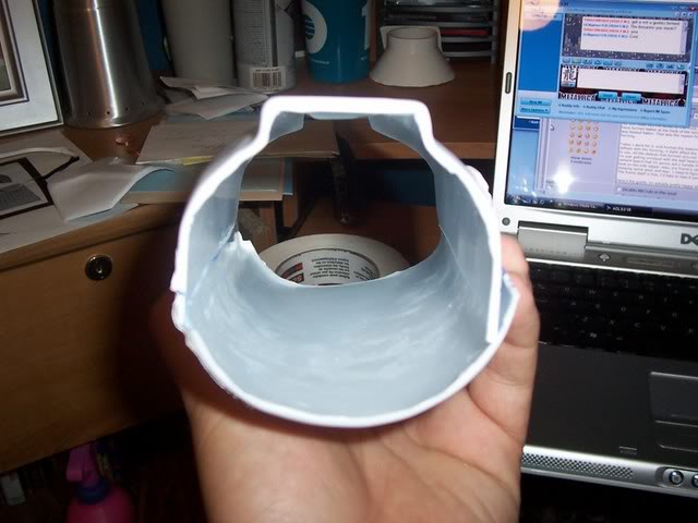

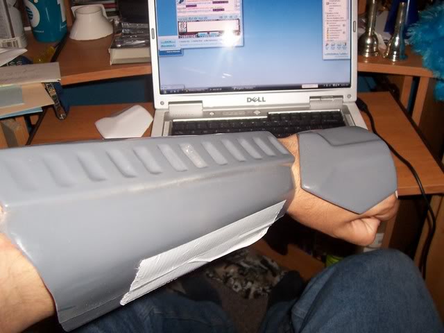

I decided to use the last sheet today, Im gonna order more on thursday, so I formed the other half of the forearms. I think it came out well. I just need to do some more cleaning and fitting, and im gonna paint them up, and it will be the first piece of the armor!

Since you are painting it bondo is a great idea. Just rough it up then bondo and sand away. Once it is pretty smooth wet sand it with either 400 or 600 grit and it should look great then when you paint it.
