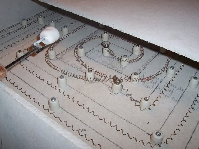

Anyways, Im sooooooo close, the only thing thats keeping me from finishing this oven is an extension cord, I cant reach the proper outlet yet lol. As soon as its up and running, Im casting that sucker!!
Also, Im gonna try to get some more work done on the jet pack as well.
-tubachris
AH HA! IT WORKS!!!!
Its actually working, all the coils getting hot, but not glowing, or over heating. I did some voltage readings, and power is going through everything.
Im in shock really, lol, its hard to believe I can actually move on now
-tubachris
Well, today was a very good day. The oven works after all this trial and error. I really appreciate everyones help and most of all, being patient after all this time.

Something I was concerned with though, is that the center coils were glowing a bit, cant see in the pic. Not all of the coil in the center segment were glowing however. One thing I noticed is that the sections of the coil that were glowing, were not "flashing," but it would glow semi-bright orange, cool down to regular color, and glow again. I was worried because last time, the coils that lit bright orange melted lol. But this seems to stay steady. The trial run lasted about an hour or a little over and reamained constant. It got VERY hot, and the extra cement board cover helped contain it.

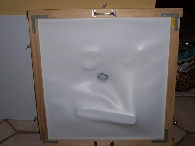

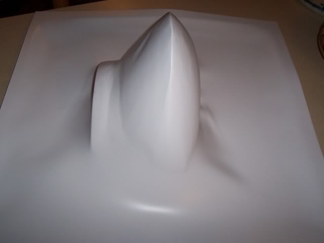

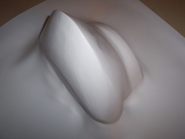

Bah, so I tested it out tonight, and the machine and everything works great. The only problem is that its my first time doing this EVER. I tried the helmet mold first, but the plastic wasnt evenly heated enough, but got most of the shape. The bottom areas are not formed. Another thing for this mold, im gonna have to use ABS or thicker HIPS. The top of the formed piece was thin enough to squeeze and even crush. So i decided to hold off of the helmet mold until I can figure what to use for it. I put in another sheet, and this time, I learned how to heat the plastic better, by rotating it over a period of time, until the sides and such were soft. This time I wanted to try out the Guant top half and the two hand pieces. BUT due to my stupidity, I never put the larger mold over the vaccum hole, resulting in the center of the plastic to be sucked right into it.
My brother and his friends from college decided to watch me do all this, they thought it was pretty cool, despite the bad casts. lmao, they had a field day with the two bad casts. They thought the helmet cast looked likes Big Foot's head, and wore it. Pics to follow.
I know that people dont like to show their "faliures," but I have to so that everyone knows im workin to get better then before.
-tubachris
Here they are. I apologize that I wasnt able to produce something quality enough the first time. I just need to keep practicing until I get it right.
