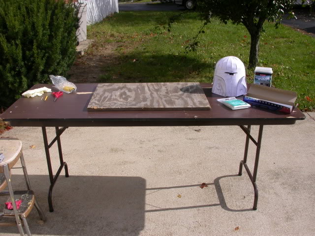

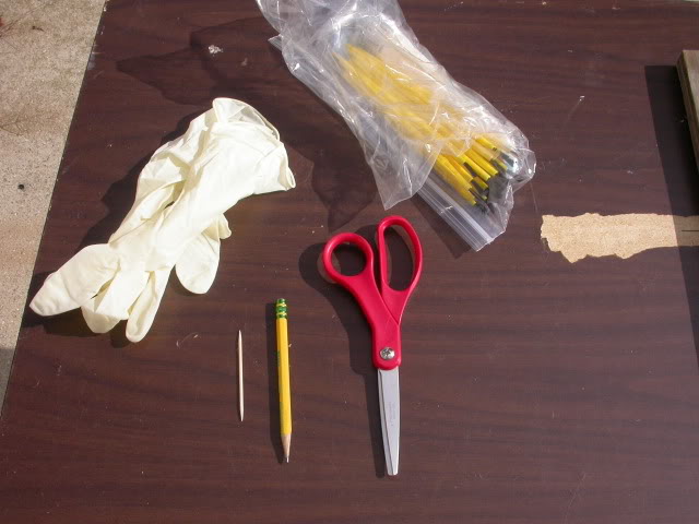

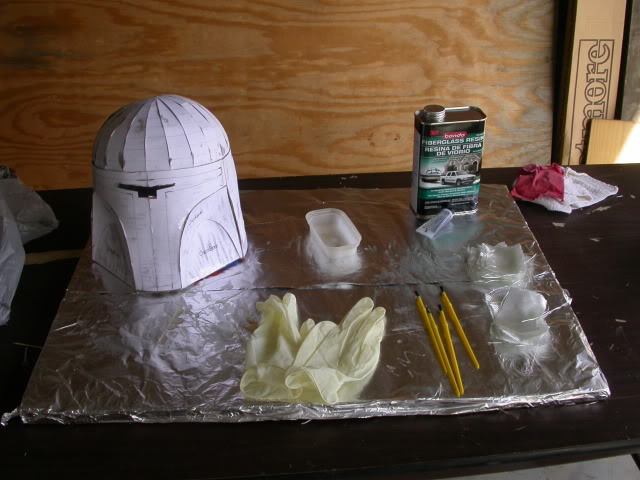

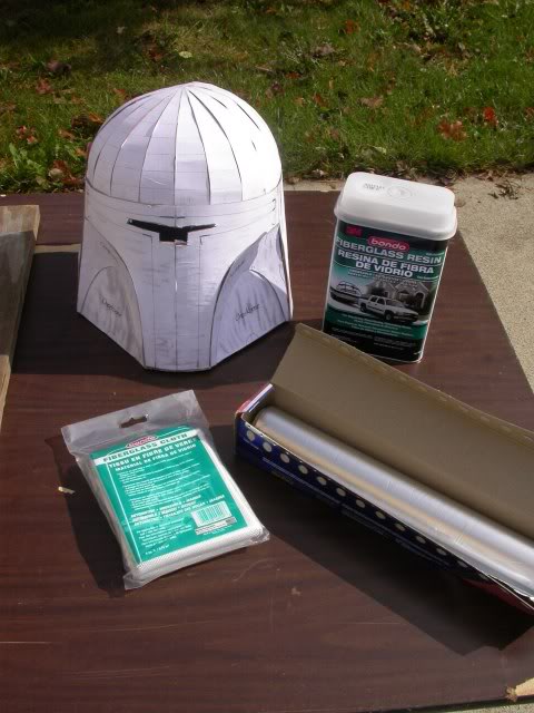

Okay, well to start with I got everything I needed. Then I went outside to a table I had set up.

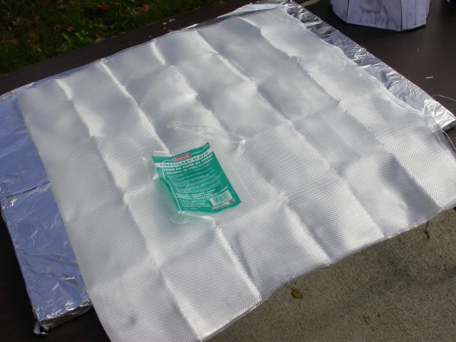

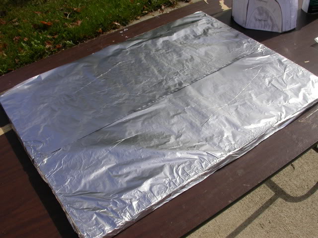

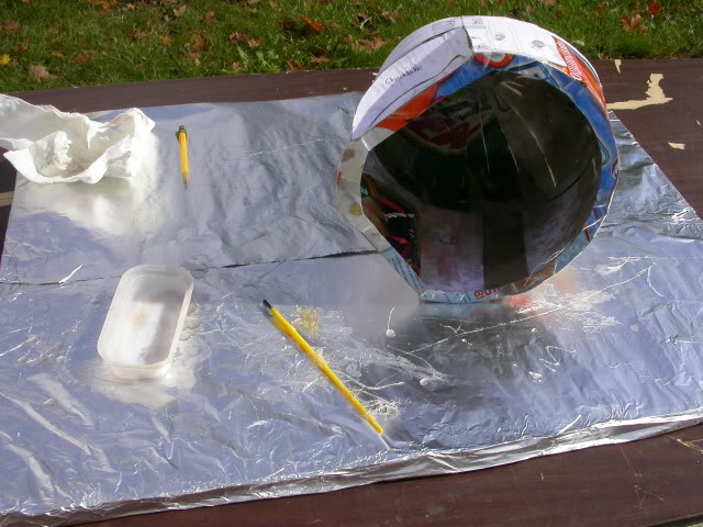

After that, I cover a board with tinfoil as my resin workspace.

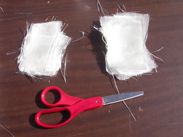

Next, I cut up the fiberglass cloth. You will get little FG cloth strands all over the place. They like to unravel from the crosshatching.

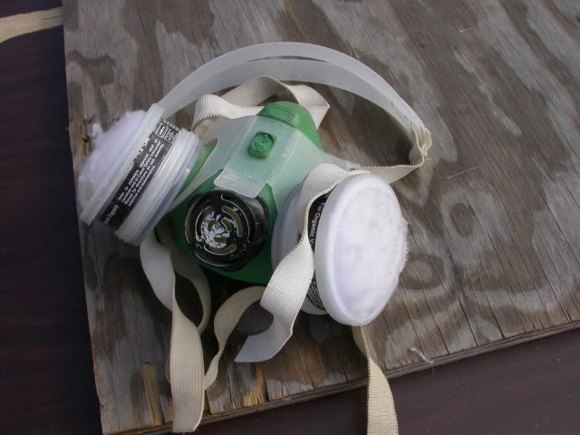

Now is the time to put on the respirator, gloves and make sure your hair is secure. (I got some resin in my hair. Not cool

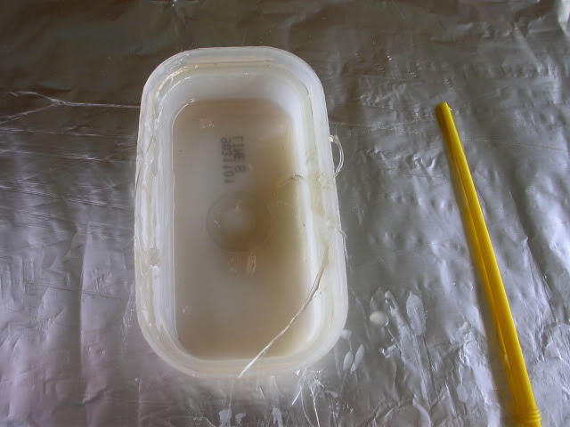

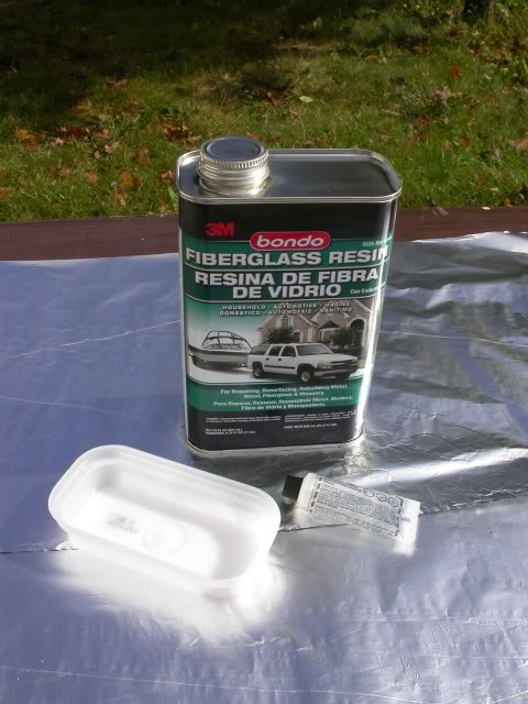

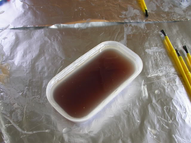

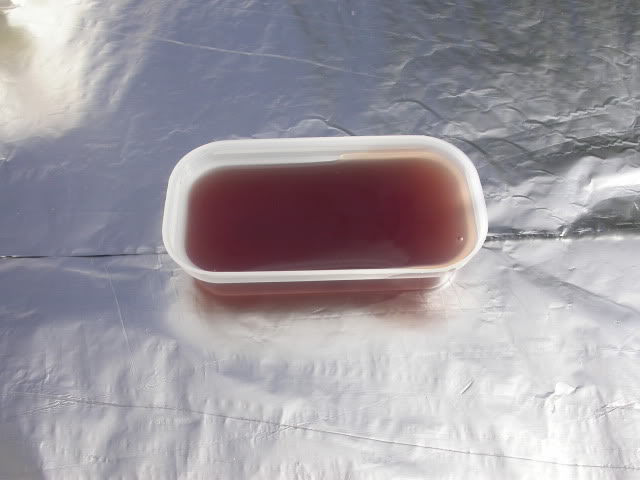

Then I got the resin, hardener, and used the resin can cover as my container. Poking a hole in the hardener is harder than you think. (haha hard hardener...) I had to get a nail to puncture the plastic.
Oh, and its a good idea to wipe off the resin spout with paper towel so you don't accidentally glue it shut.

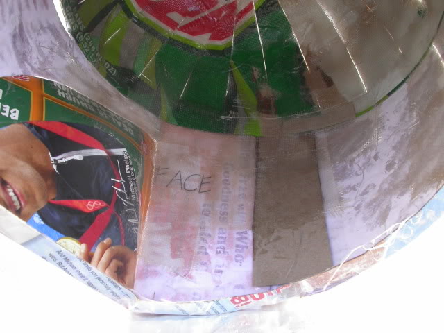

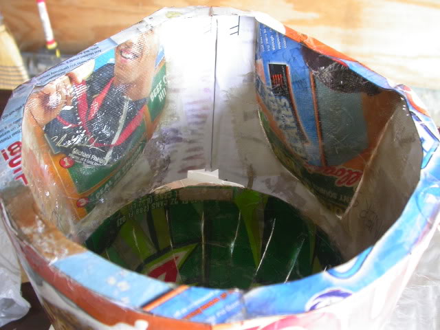

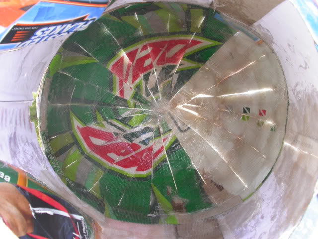

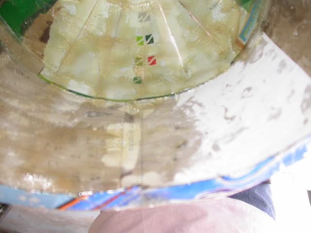

I didn't get very many pics of putting the cloth in the helmet cos my hands were covered in resin and FG cloth. But when you put the stuff in, make sure its flat in there and touching the helmet as much as possible. Also, don't forget to overlap the pieces.

I started out using a brush to get the resin on the cloth, but it was taking too long so I just dipped the cloth in the resin (like the guy from the video A'den posted) It worked well.

I stuck the helmet in my basement to dry. It stank up the whole house, so unless you LOVE the smell of resin then I suggest just leaving the bucket in the garage.
Then I waited a day, poking at the resin to see if it was hard the whole time, and did the whole thing again:
I just used the lid container over again. No problems there.
I still have some face to do, but most of it is done!
