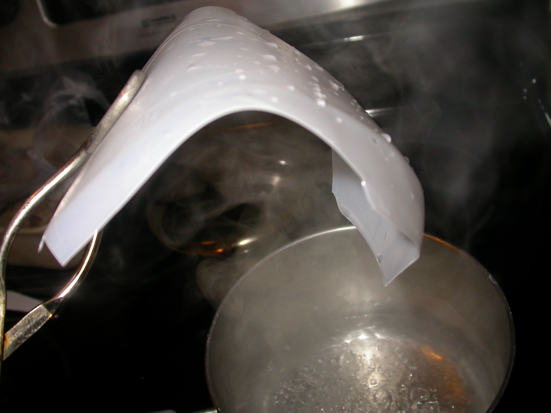

Okay, I kinda sorta have an update. I just completed my experiments with trash can and milk jug scraps. I'm pretty happy with the results and I think I'll just boil my armor cos it's easiest for me atm.

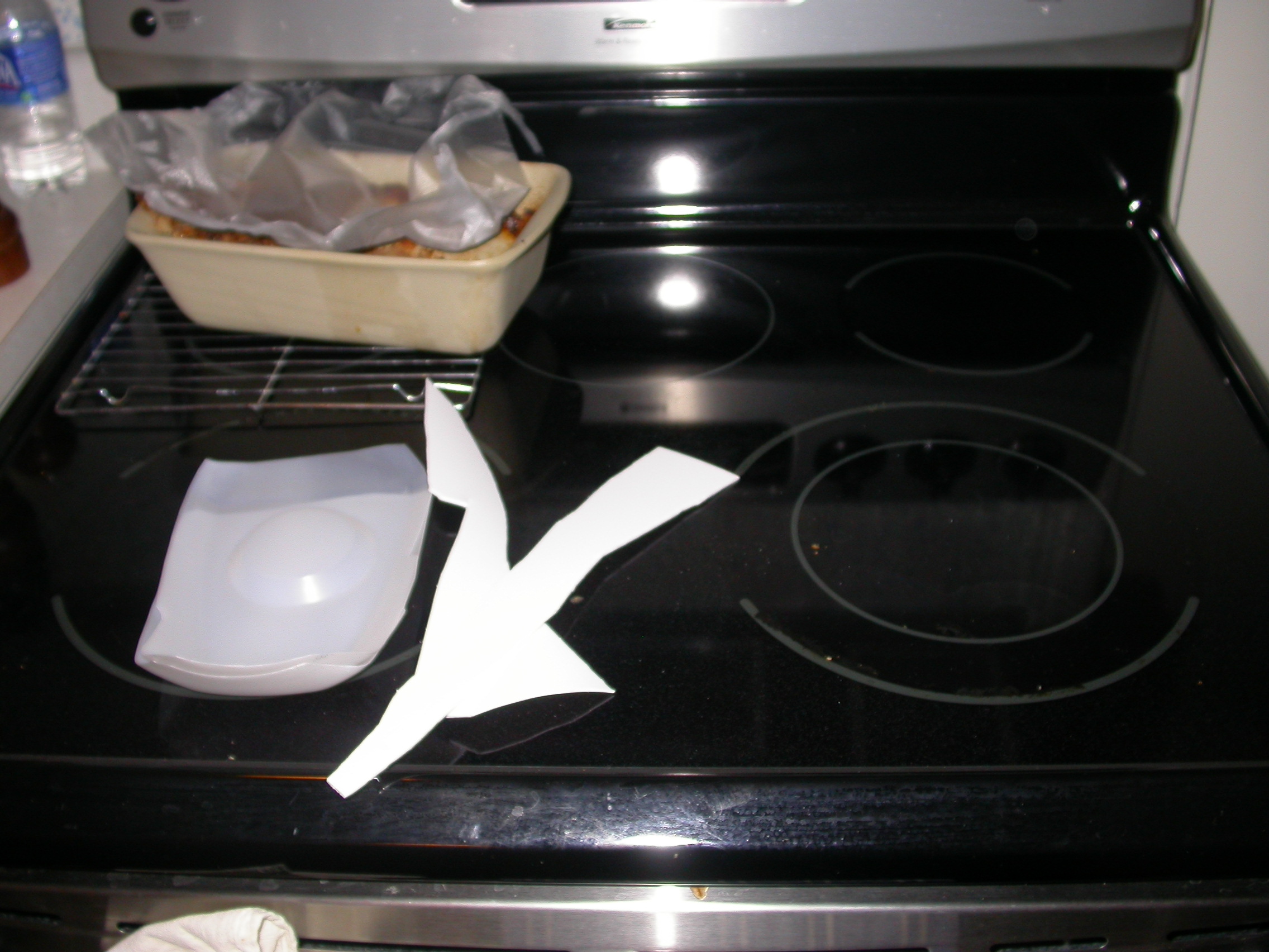

1st pic: the pieces, stove, and meatloaf there in the corner that my brother managed to drop in the sink :confused Quite skillful.

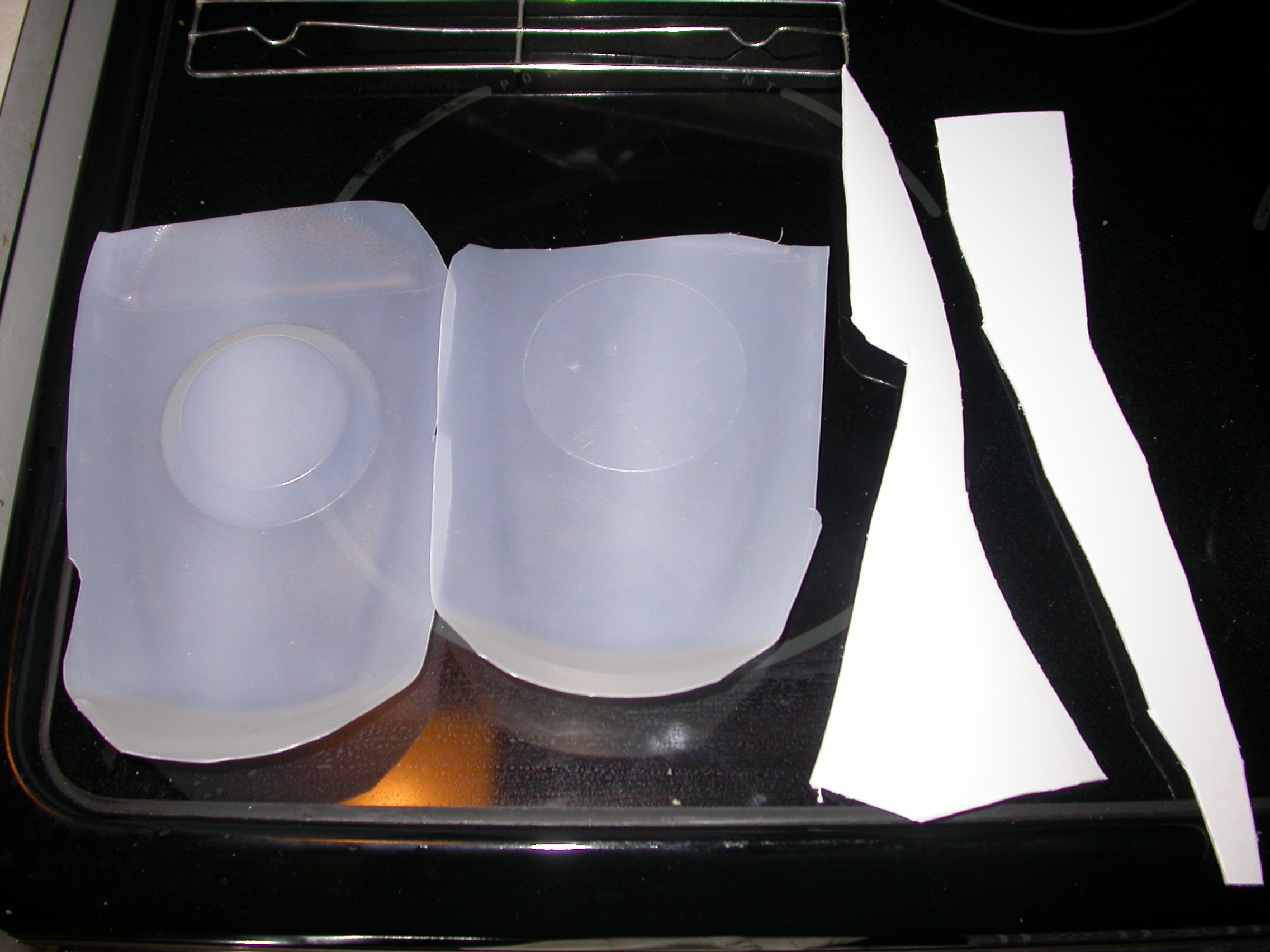

2nd pic: better shot of scaps.

5th pic: boiling water and first test on trash can scrap. That one was in for 5 min.
6th pic: the 5 min scrap.
