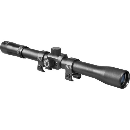

FettDad's suggestion of taking the Dr. Frankenstein route intrigued me...basically take a couple of different scopes and combine the details you like best. So I started searching on Amazon to see what that kind of project would cost me. Then I found something that thought I would present to everyone to see what they thought might make a suitable substitute for a scope.
Barska has some cheap 4x15 ($6.99 AC10000) and 4x20 ($9.99 AC10730) rimfire scopes. The dimensional specs come in very close to the resin blaster I have...tube diameter matches on all three at 3/4". The overall scope length on my blaster is 10 9/16" or 10.5625". The AC10000 is 10.63" long, while the AC10730 is 10.55"...so the cheaper one is just slightly larger, while the $9.99 one is almost exact. Both look almost exactly the same...check the attached image and the links (the shopbarska.com links give many more details and specs than the Amazon ones).
The pros are that they are cheap. The dimensions are almost exact. And for the most part, they look a lot like the EE-3 scope, right out of the box. Because of that, it doesn't seem like there would need to be a whole lot of cutting it apart and reassembling.
The cons I can see right away are
- The rings don't match the ASI one at all. You could either use them as is (would that be that big of a deal?), or modify them, or take them off and use another solution. Plus the rings would need to be moved closer to each end.
- The dials look to be a little bigger and not beveled...though that probably wouldn't be that difficult of a modification. And removing the graphic on the one dial.
- The dial box isn't in the right configuration, but I would imagine all you'd need to do is just rotate it so the dials are in a V.
- The dial box looks to be more central while the one on my resin blaster is slightly forward of center...again...does it really matter?
So my question for all of you, do you guys think this would be a suitable substitute to trying to locate an ASI one? What are your thoughts on the ring situation? What do you think about the dials and box?

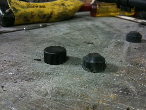

The other thing is to replace the windage knobs (the dials you mentioned). A board member here gave me a set of ASI knobs that I molded / cast. I used waste silicone to make the molds (leftover that I didn't need) and I pour waste resin into them when I have it (overfull molds). I've got enough kicking around for half a dozen rifles or so. They aren't all black like the one shown below... they range somewhere from white-grey-black depending on what I was pouring at the time.
Tasco/generic vs. ASI cast:
I haven't posted a sale thread because I am TERRIBLE about getting out and shipping things. But, if anyone wants a pair, paypal me $5 to cover a padded envelope and shipping and they are yours... just know that it could be a few weeks before I get them out of the house.
You have to cut off the ones that are there... they screw on to threads, and mine are solid. So it's a bit of a fuss, but it looks good in the end!
