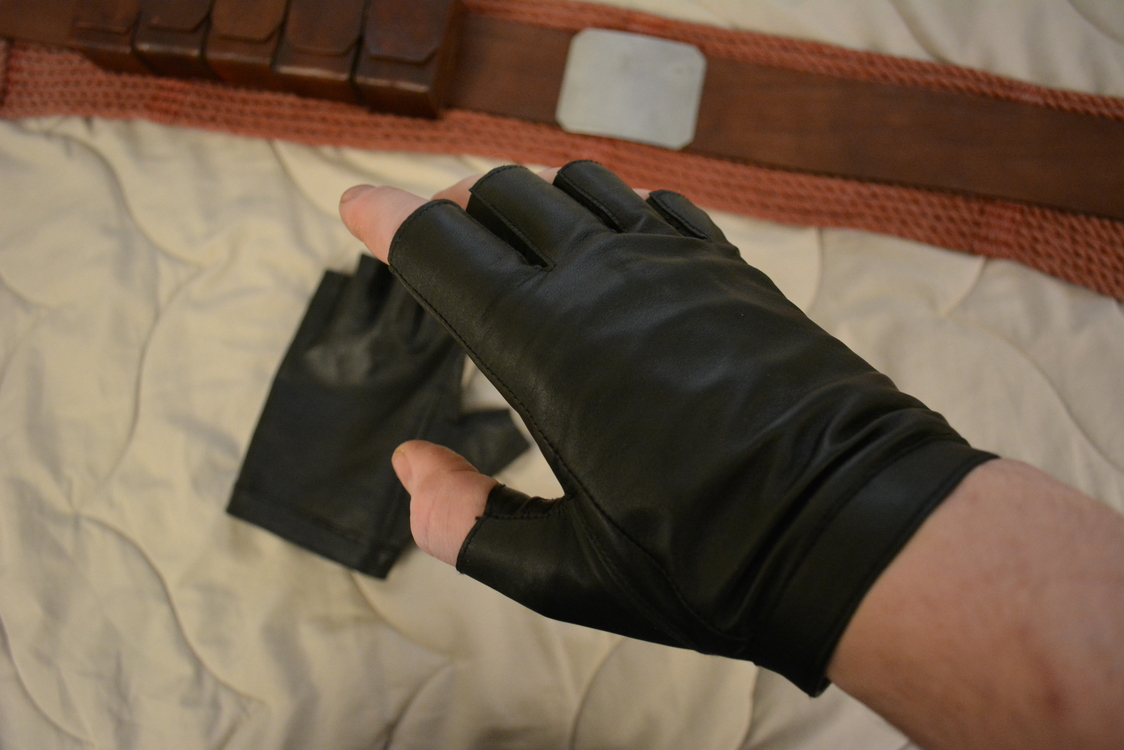

Fingerless gloves. Got them on ebay from a company called Kursheuel. Still have to weather the hell out of them, but they should do just fine.

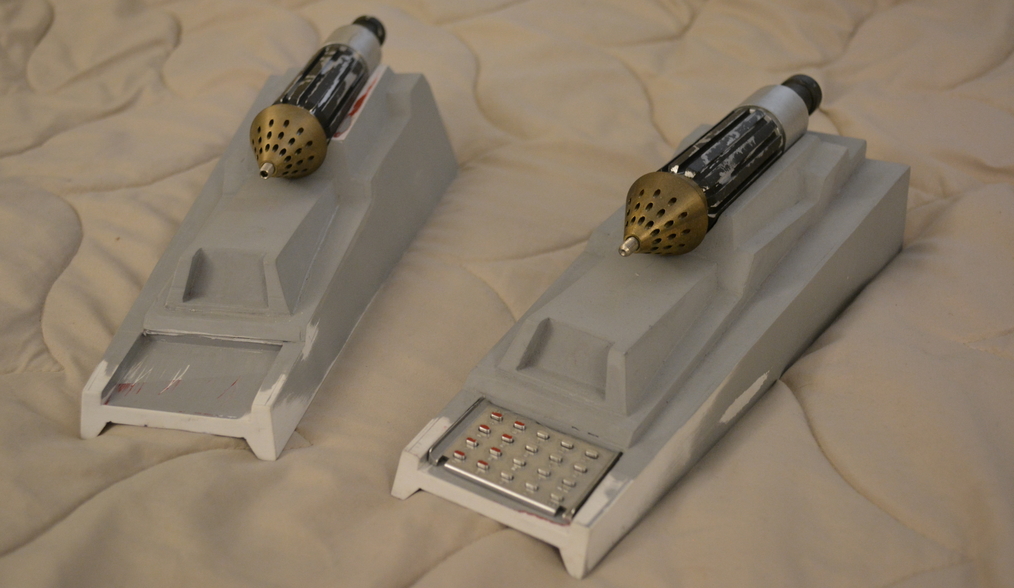

Here's where the gauntlets stand atm. The tops are more or less done. Just have to build the bottom shells and then I can start work on the flame thrower units. The rockets are about 80% done and were made out of bronze and ABS plastic. When the shells are complete, I plan to make fiberglass copys so they are more solid.

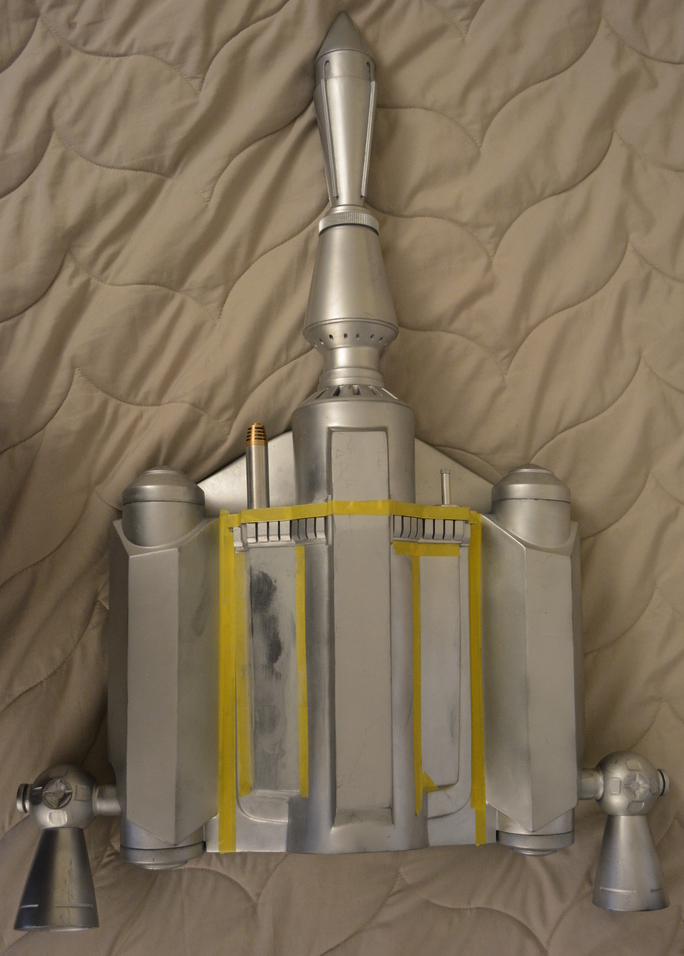

FettSeven Jetpack also came in. I'm really torn on what paintjob to go with on this thing. I could do Jango, Rotj, ESB or even a custom job, but I just cant make up my mind. The Jango/ROTJ paintjobs do kind of go better with what armor colors are on the suit, but I personally have never been a fan of the ROTJ pack, and yet and undamaged Jango pack wouldn't fit with the rest of the heavily weathered armor. lol. Any votes for the paintob?

As for as the jetpack colors I would personally do it in Jango's scheme but weather it more in line with the 1313 concept art like the helm. I would also do the rocket in ROTJ colors weathered but not as much. Looking forward to seeing more of this build.
So I've been doing a lot of thinking on this jet pack paint job, and I'm starting to lean towards a totally custom paint job. I'm thinking a mostly blue pack (think ESB but blue) with lvl 1313 painted on one of the tank walls would be pretty cool looking. I may still go with a less damaged ROTJ paint job like the one seen in the archive though. We'll see what happens.

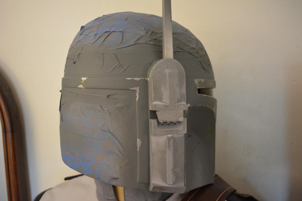

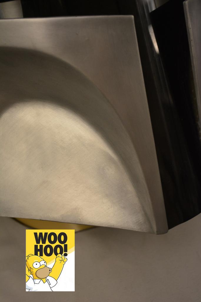

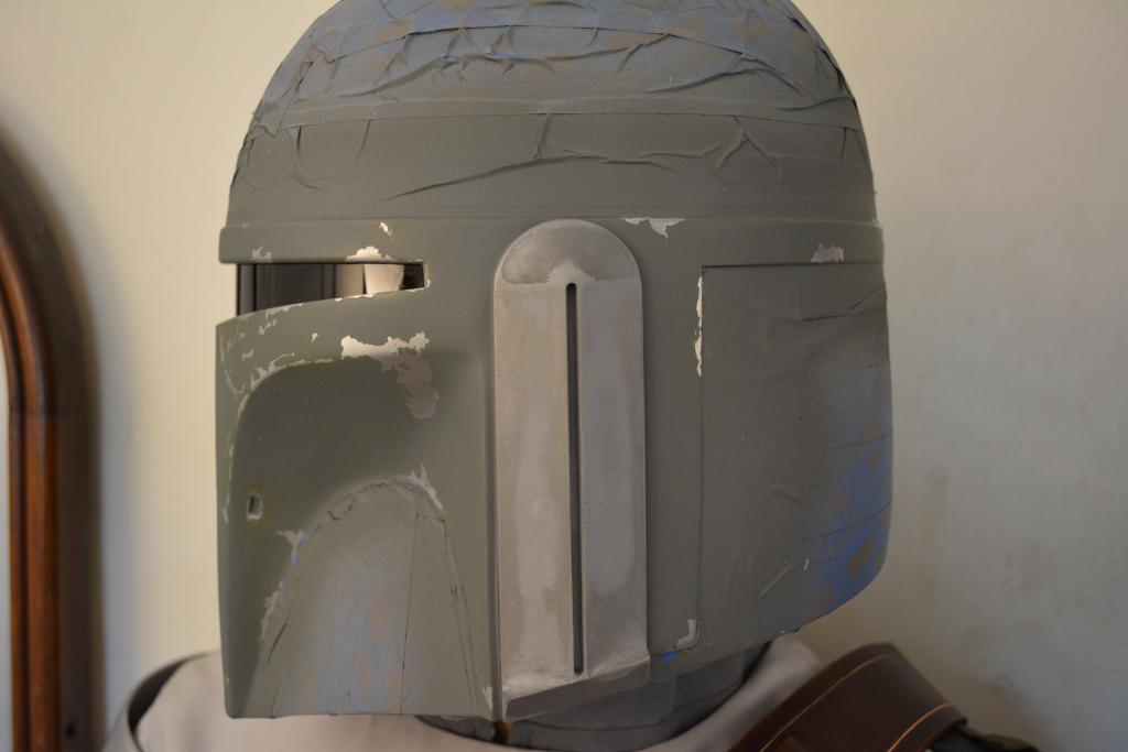

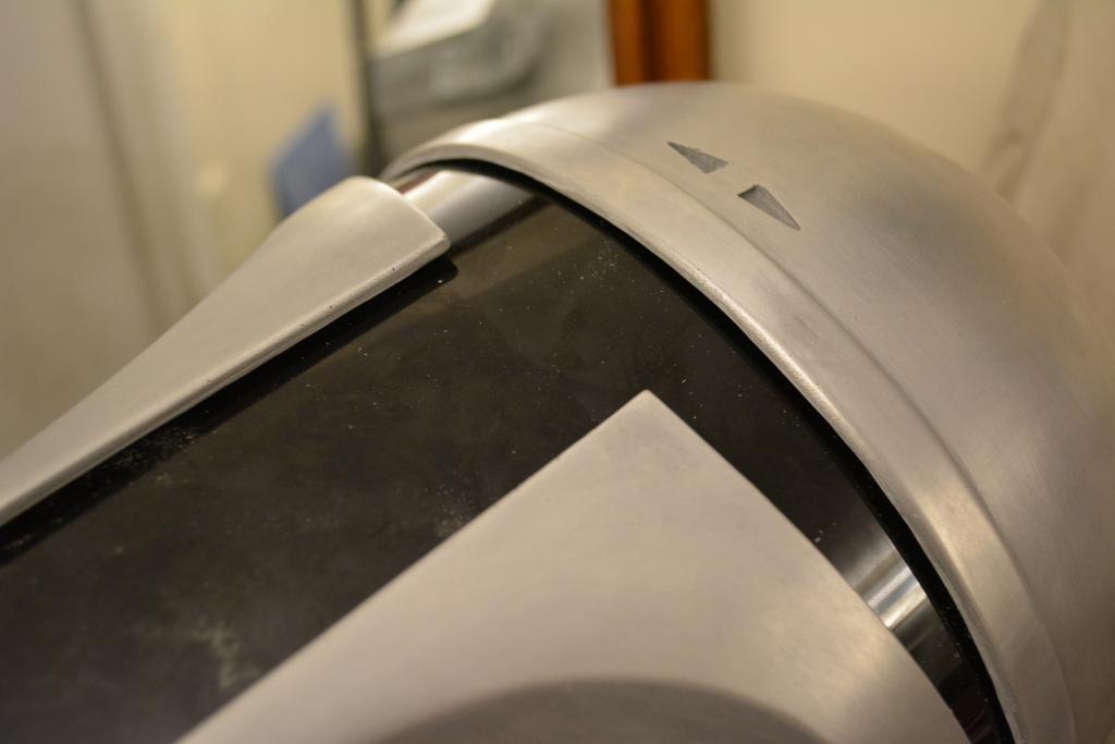

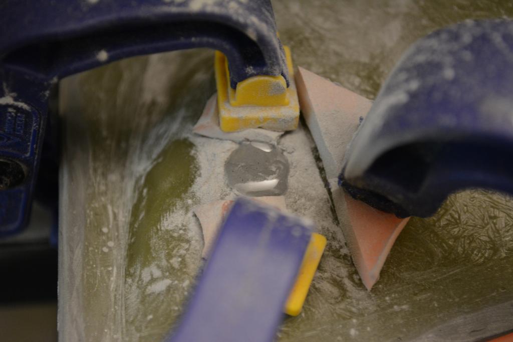

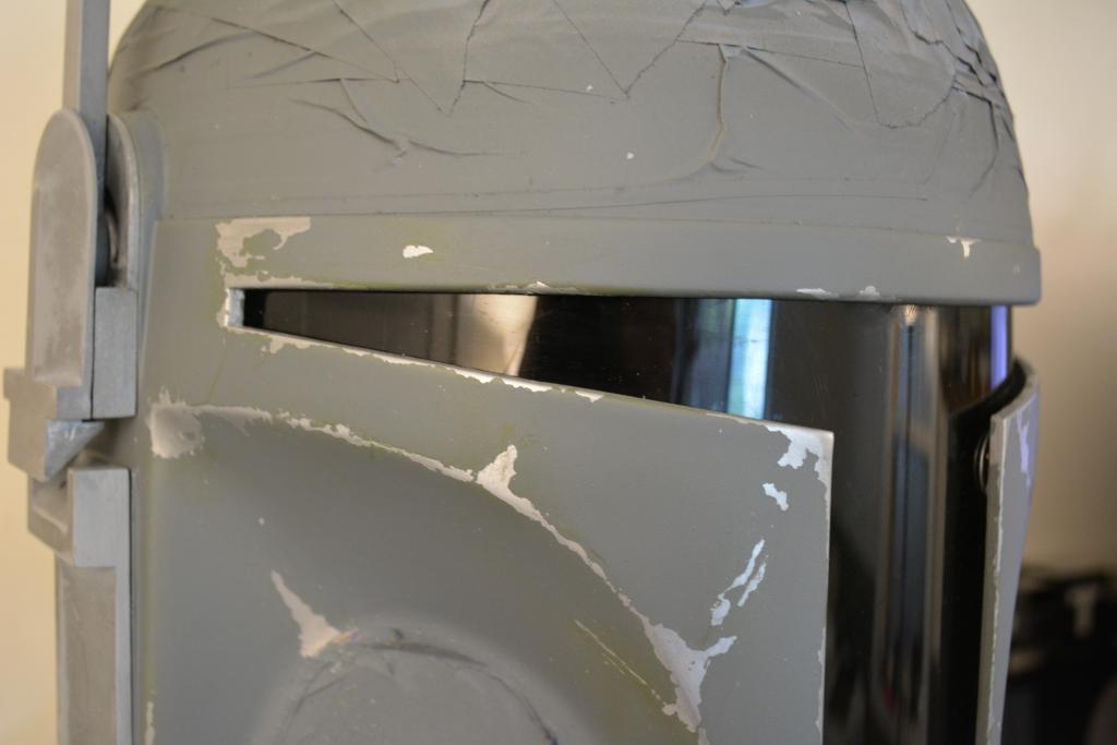

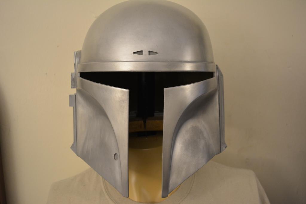

So Animefan's awesome helmet came in. This thing it truly beautiful and I couldn't be happier; Ryan makes an amazing product. Got it all trimmed and the visor rough fit. Now I'm attempting to fill in the Borden connector hole. To do this I drilled out the Borden hole and made a silicon sheet to press up against the outside of the helmet and make a nice flush seal against the hole. Then dusted with aluminum powder I got from Ryan, and back filled with epoxy resin mixed with more powder. Should be dry by tomorrow morning, fingers crossed.

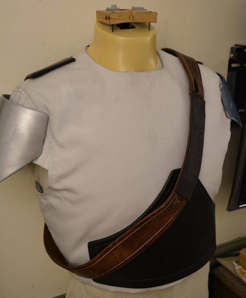

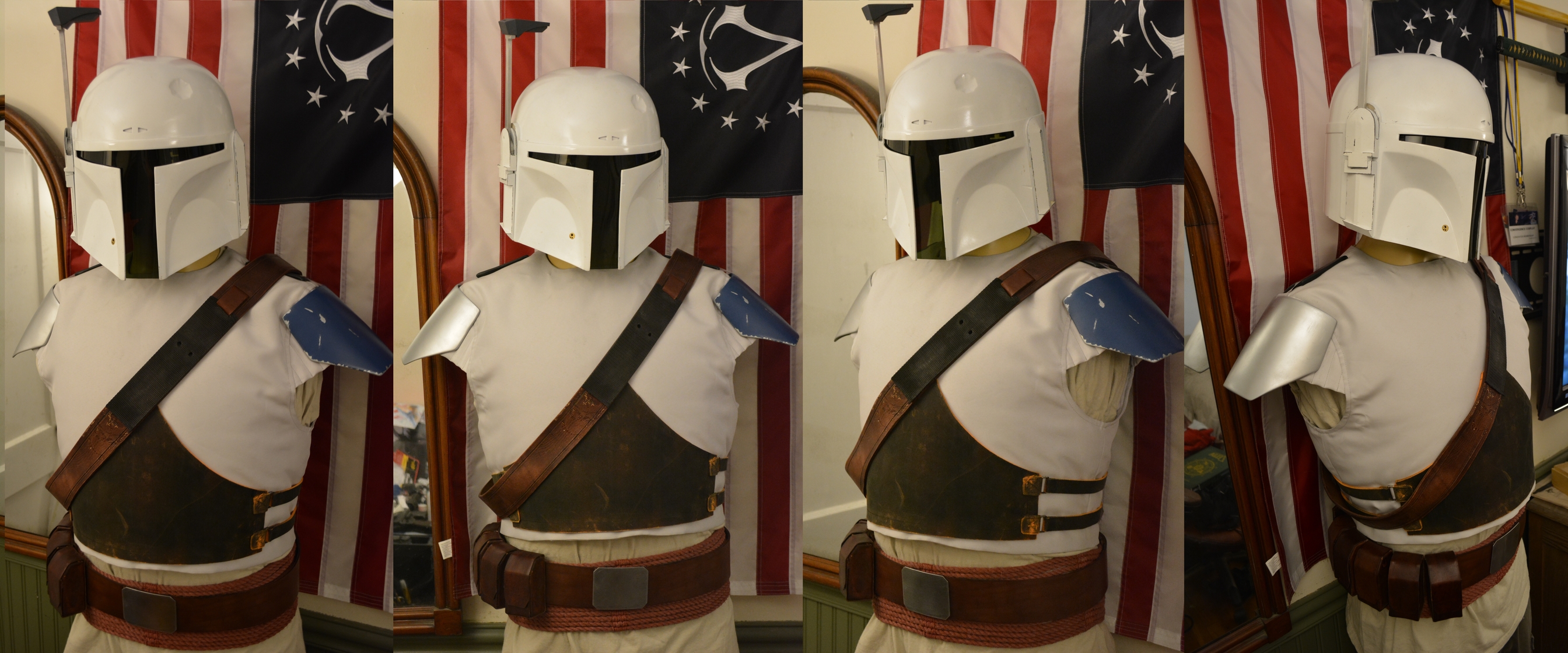

I also got the belly armor mostly done, it's leather stretched over a Sintra core and then hand sewn. It still need to make the straps, and of course everything still needs to be weathered, but I'll do that once construction is done. LMK what ya think about it's shape and size. I know its a little hard to tell without the collar section, but it's just a little larger than the V3 armor belly plate.

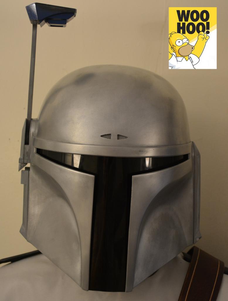

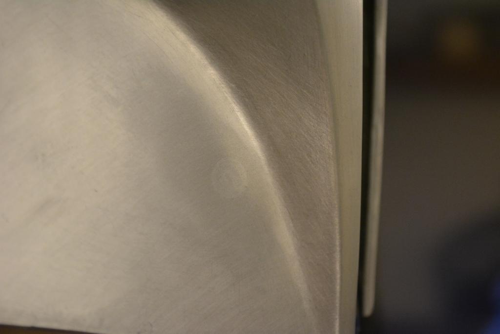

Actually, because it was such a thick layered application, Its already dry. WooHoo!!! It came out (cursword thats not allowed here) Awesome!!! Just some minor sanding and it almost blends in perfectly.
Also, in case you're curious, I used West Systems epoxy resin for this. Awesome stuff!

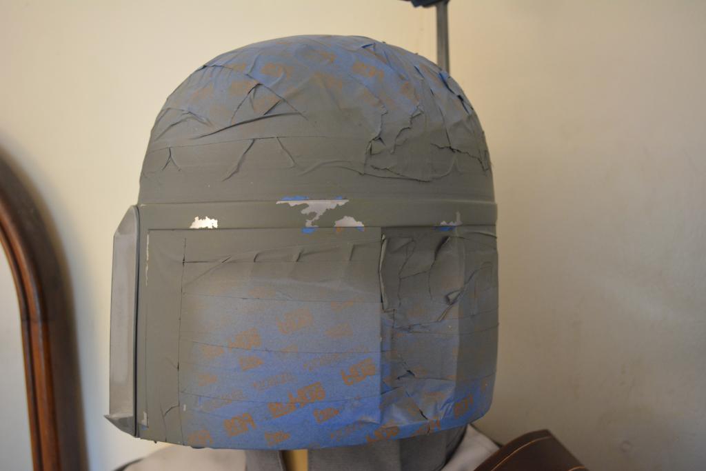

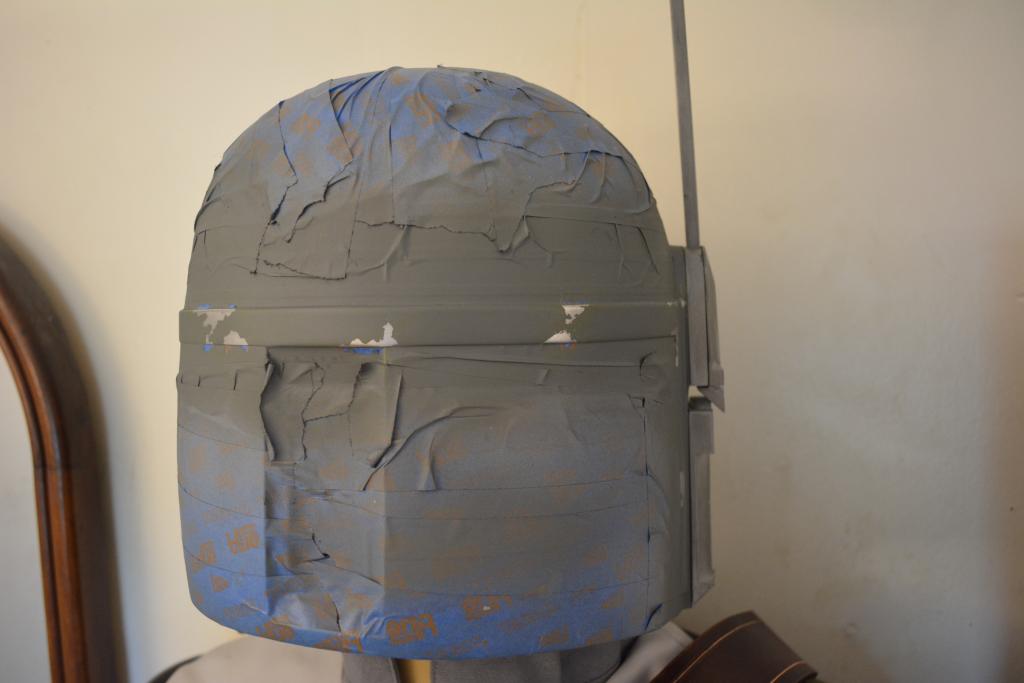

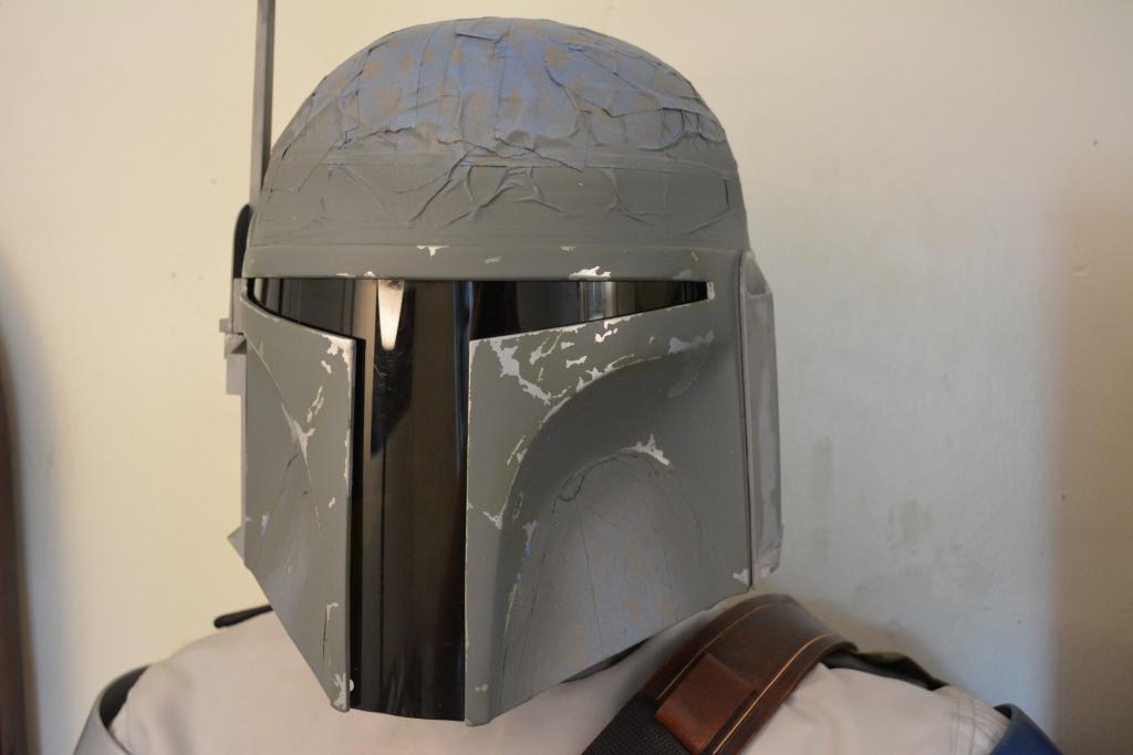

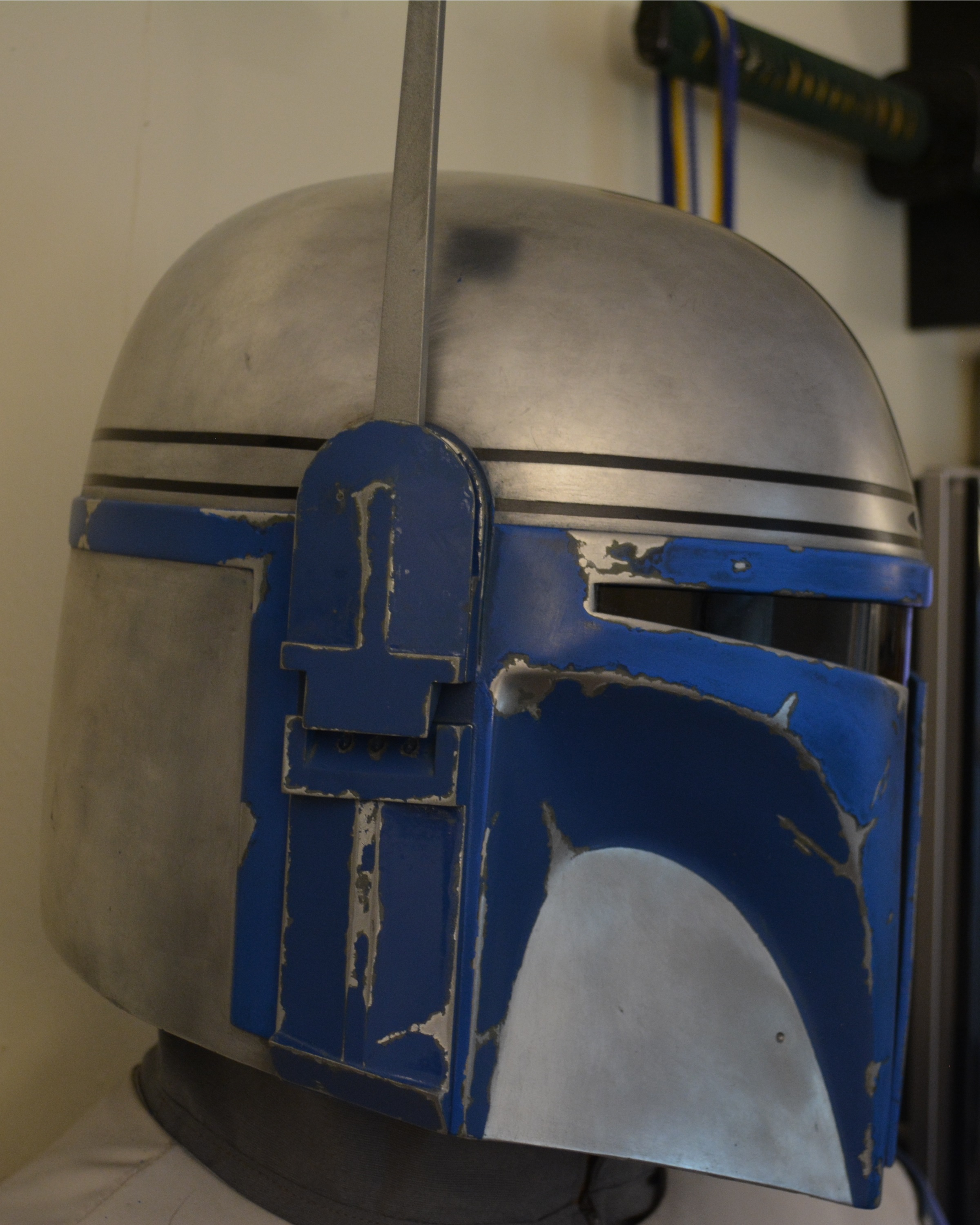

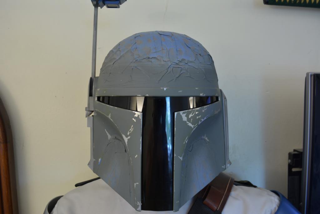

Started work on the paint job. Seeing as every concept art looks vastly different I picked two photos that, to me, looked most alike and used them as reference. But there is still a lot of imagination in what I did end up masking off. This first layer is Floquil Reefer Grey. I'll remask off what I want to keep and then the blues will be going on next.

so, is his armor (in the "standalone" ref pic) just belly armor and a bare vest...? Looks really cool, but I can't figure out what all he's got going on with his getup. Also, doesn't the stock for his slung rifle (the REALLY long one) look strikingly similar to his EE-3 (I could see why he'd saw it down!!)?

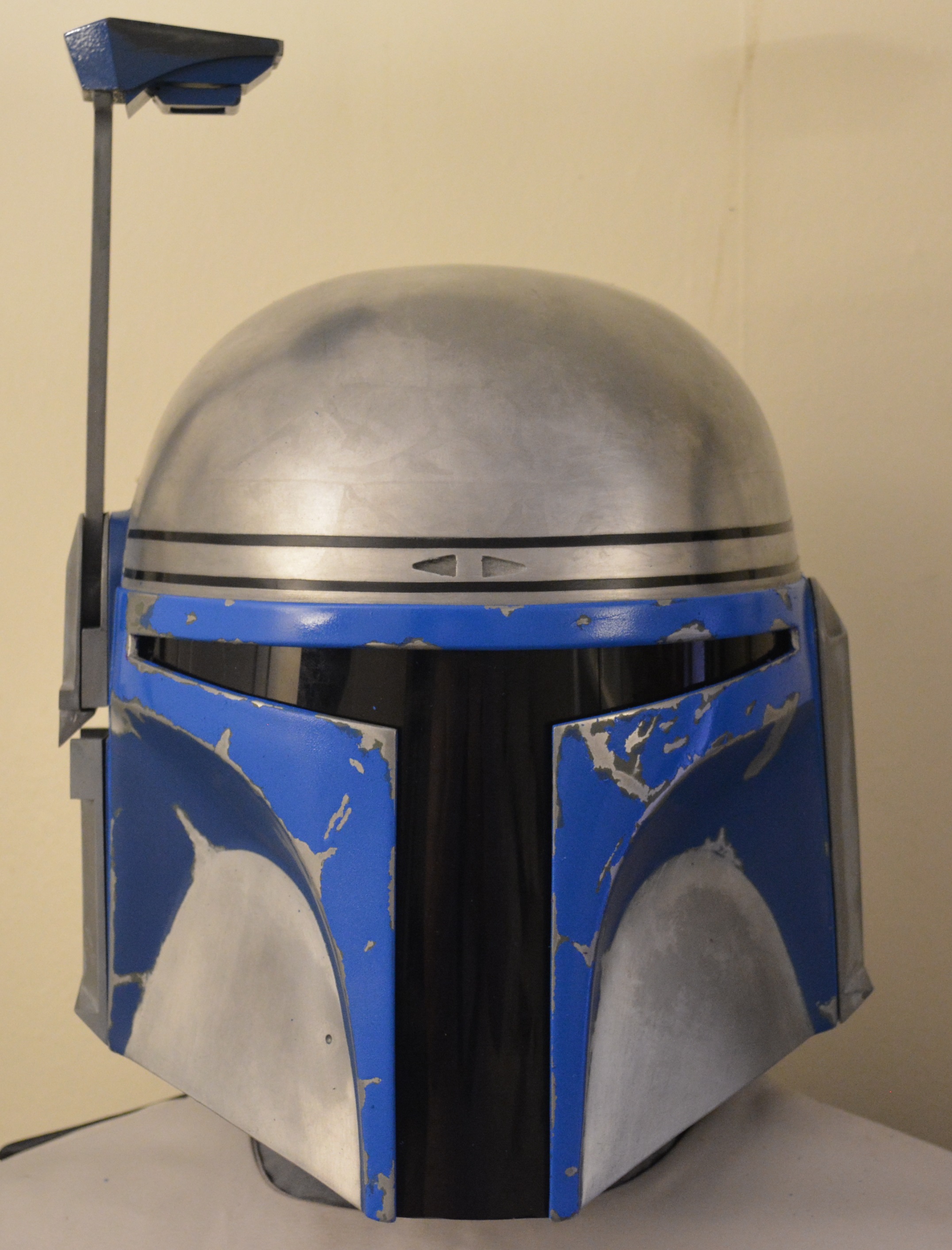

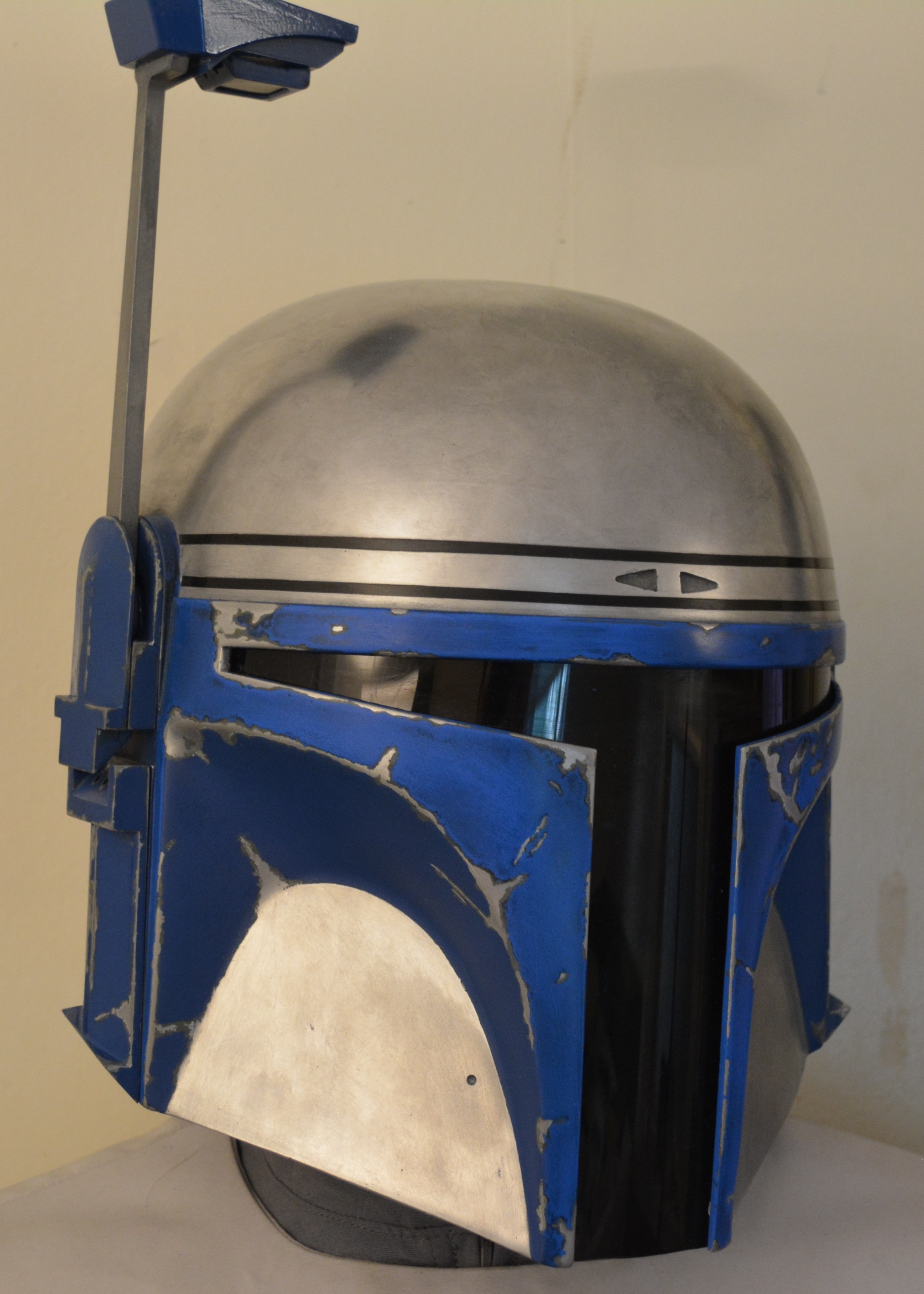

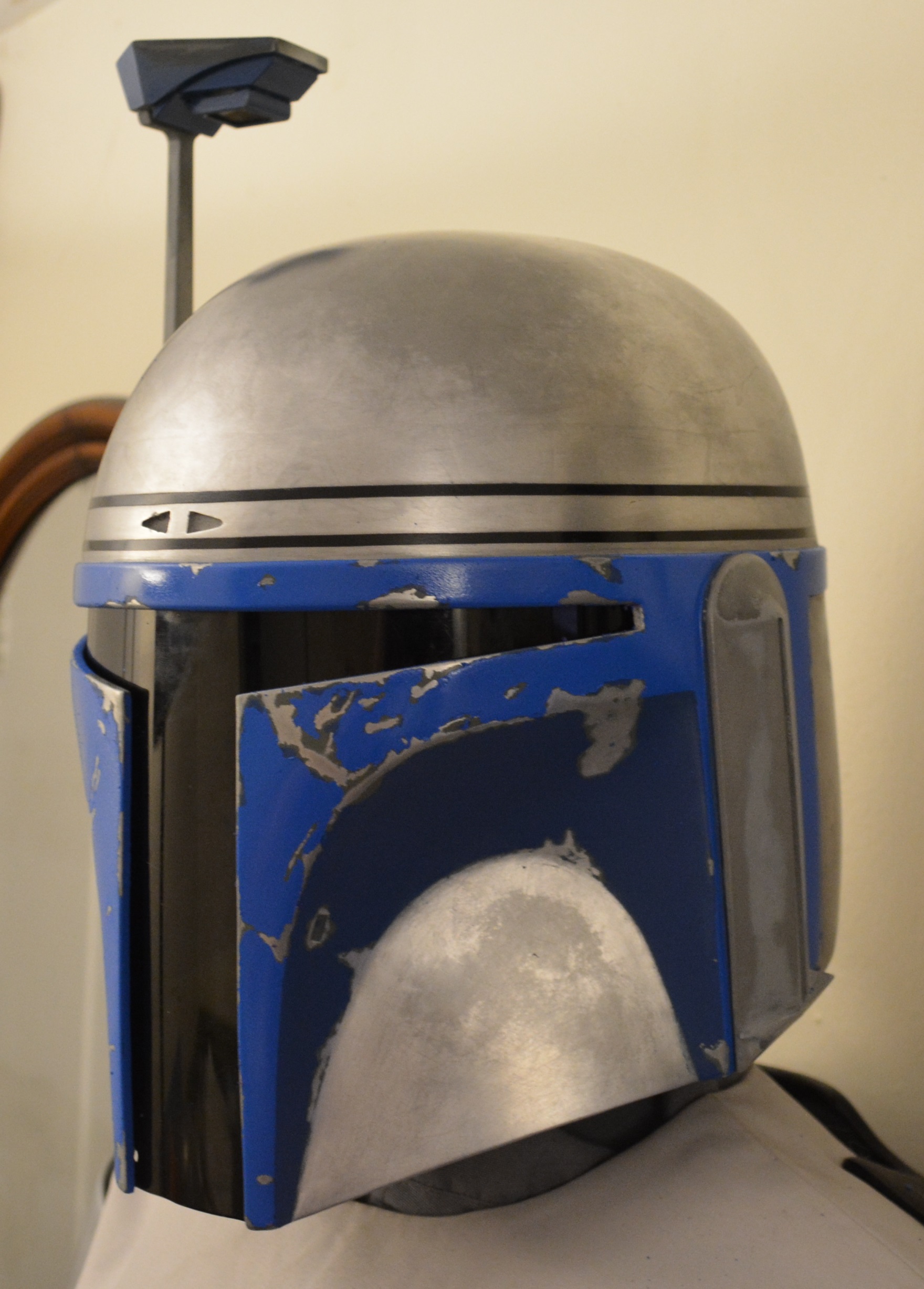

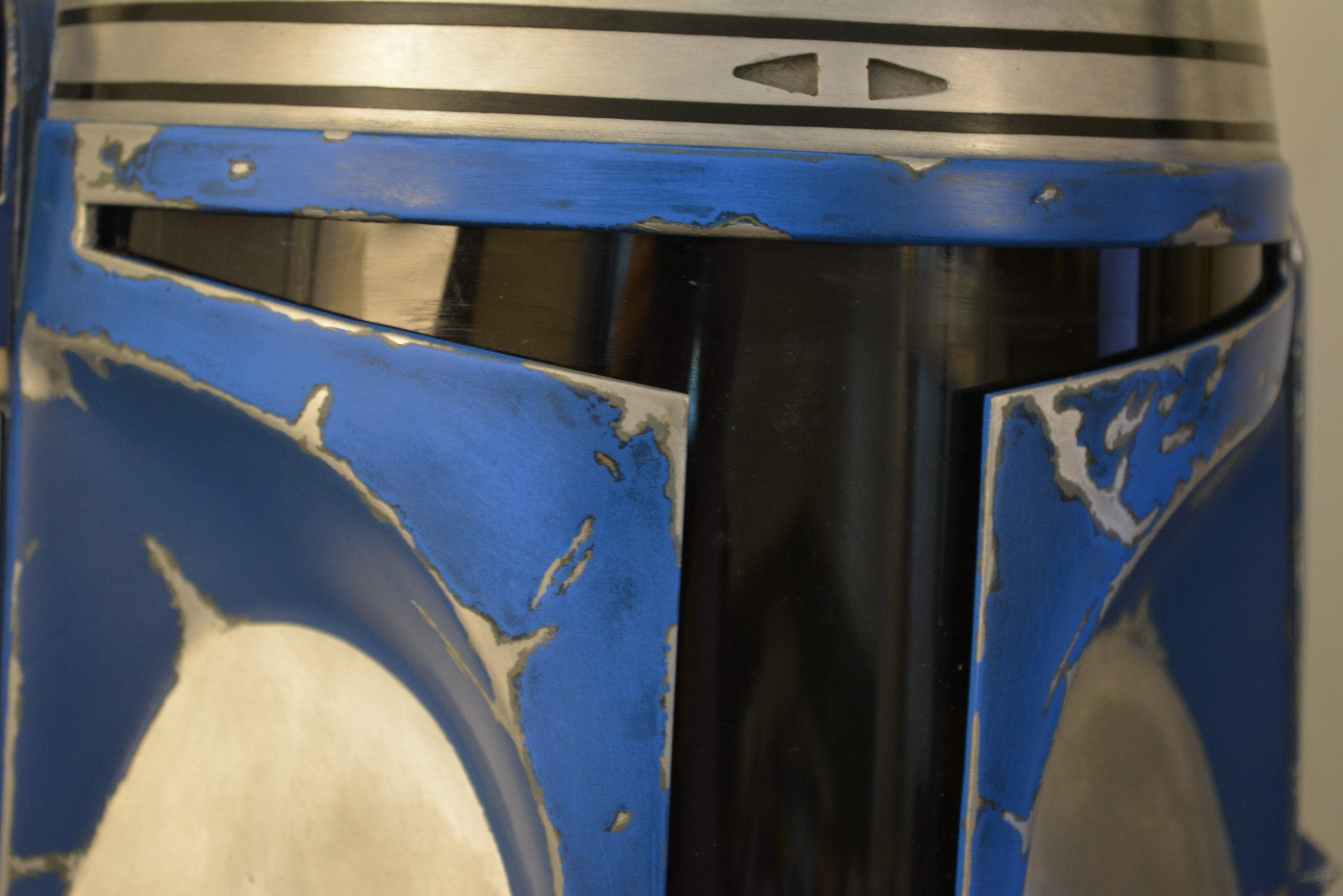

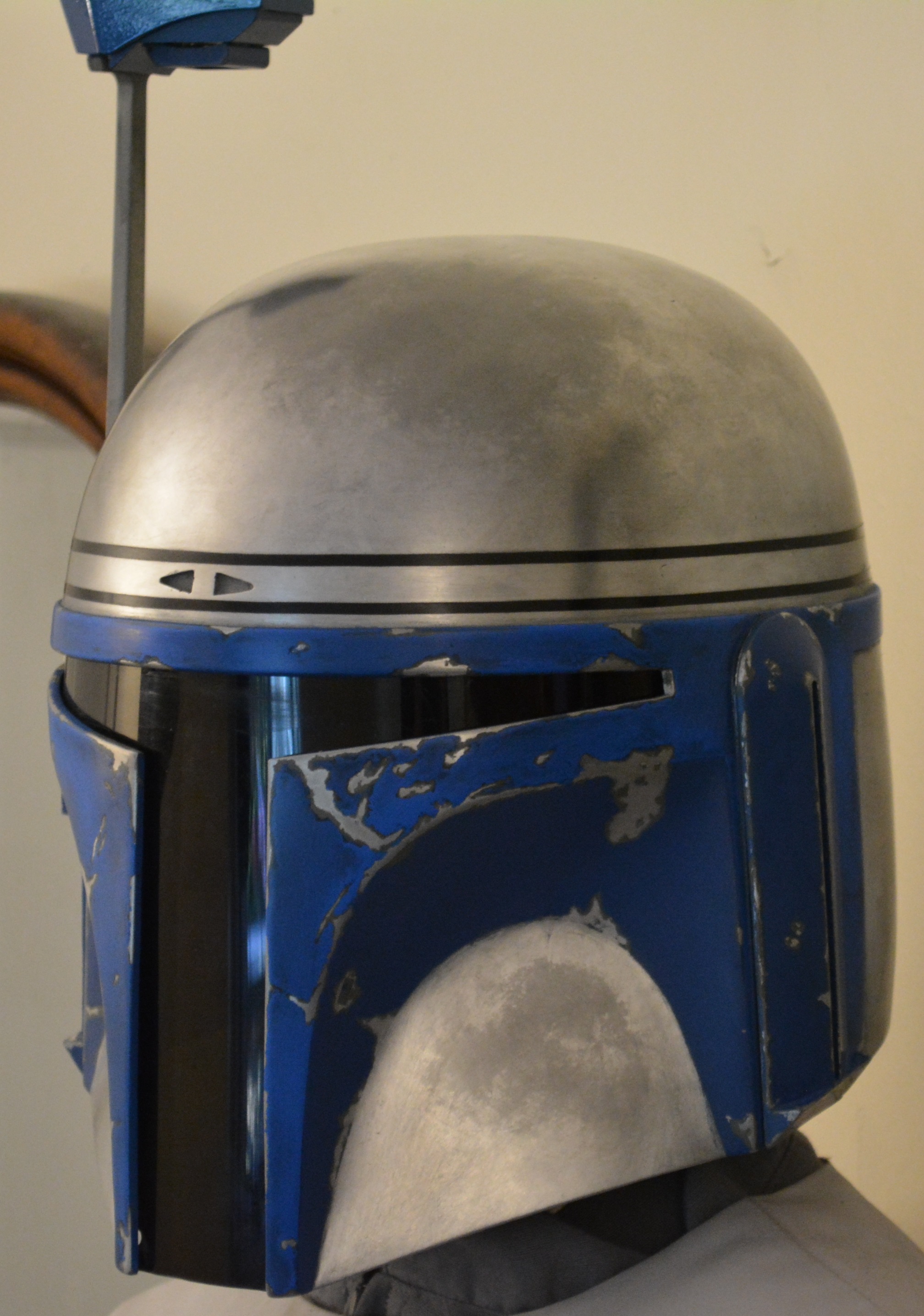

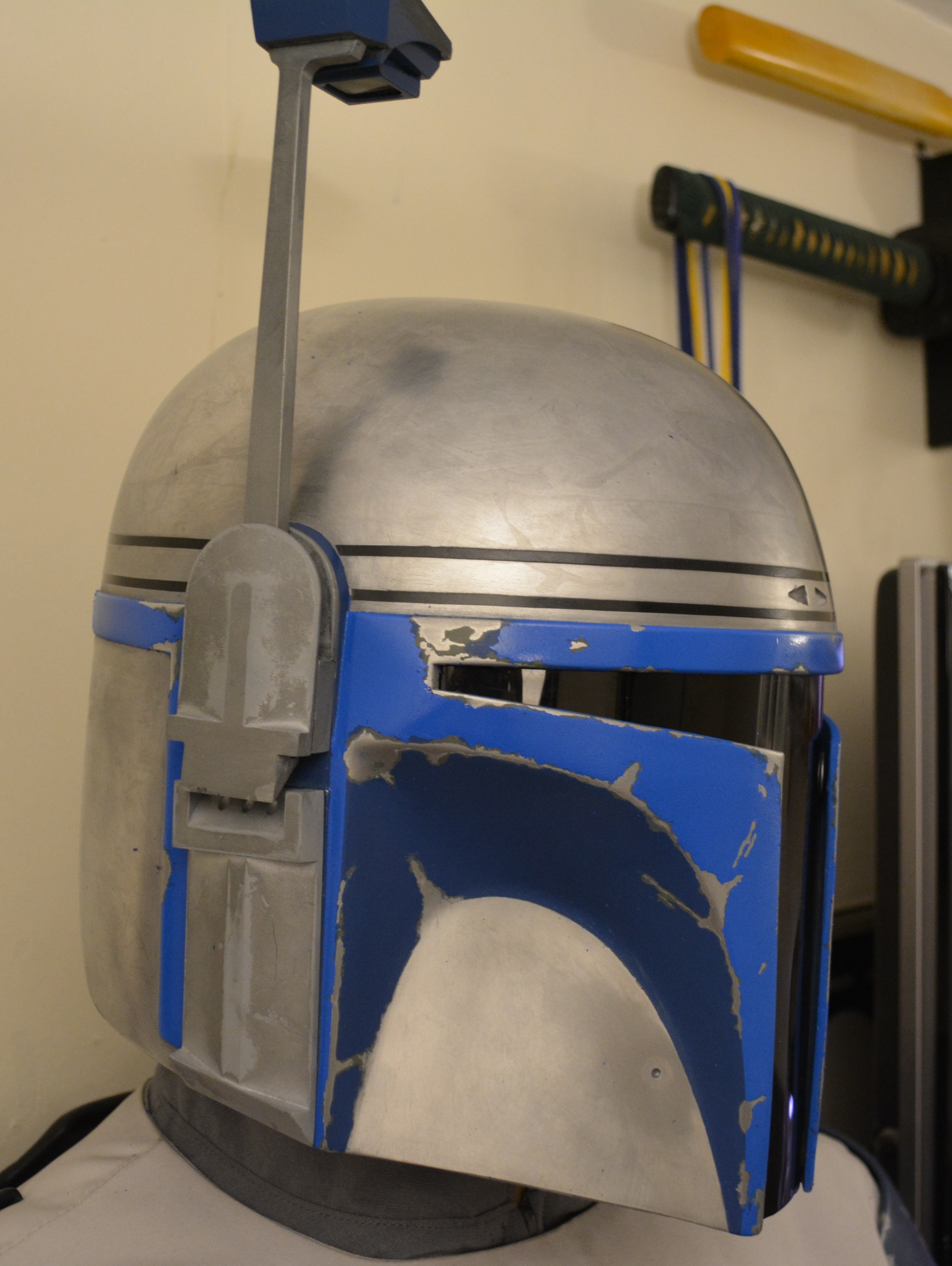

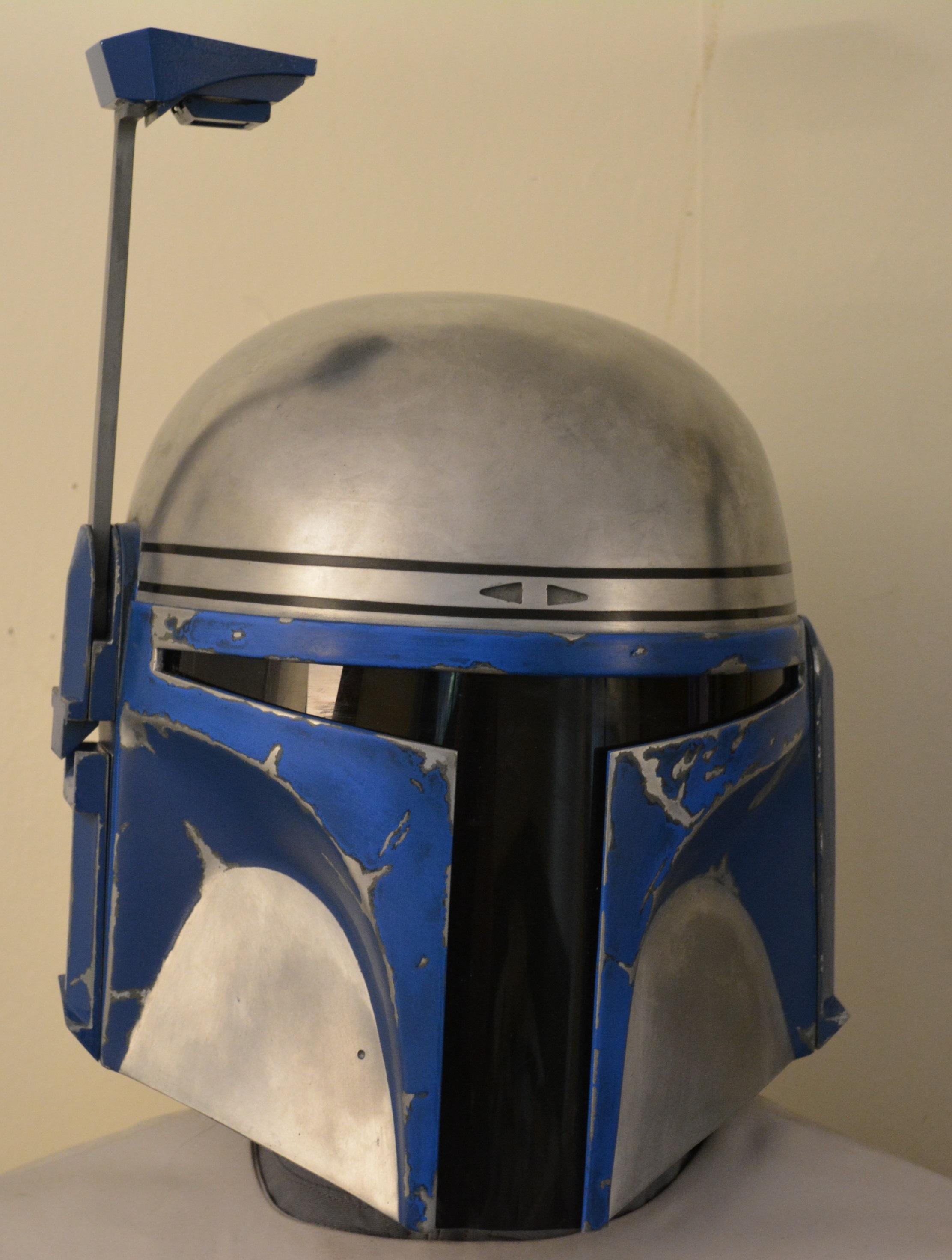

I ended up using the conventional Jango paints (ocean blue and royal blue) because I couldn't come up with a mix I liked more. Just need to do the ears, a little clean-up, fine tuning and a black-wash to better blend the two blues and I think she'll be where I want her.

Yeah, it looks to be just a backplate, collar, belly and whatever connects the belly to the collar. I really love it cause its such a unique take on the character early in his bounty hunting carrier.
And you're right on the EE-3, it looks very much like the ROTJ version. I actually think there's two rifles back there (kinda like the Mythos Fett) and they just didn't have the 2nd stock sticking out for whatever reason. You can actually see the EE-3 in the photo where he's walking away from Slave 1 and the barrel tip is sticking out just a little bit.
And we're DONE!
I finished the ears up, and went back over the Ocean blue with Tamiya "Smoke" to darken it up a bit, then went over the whole thing with 0000 steel wool wot give it a more worn look.

also, I just wondered if you'd noticed the leather strap that connects the belly armor to his "shoulder pads" that his shoulder armor is attached to? Looking excellent so far, I love this concept and am deeply disappointed that the game was cancelled!
