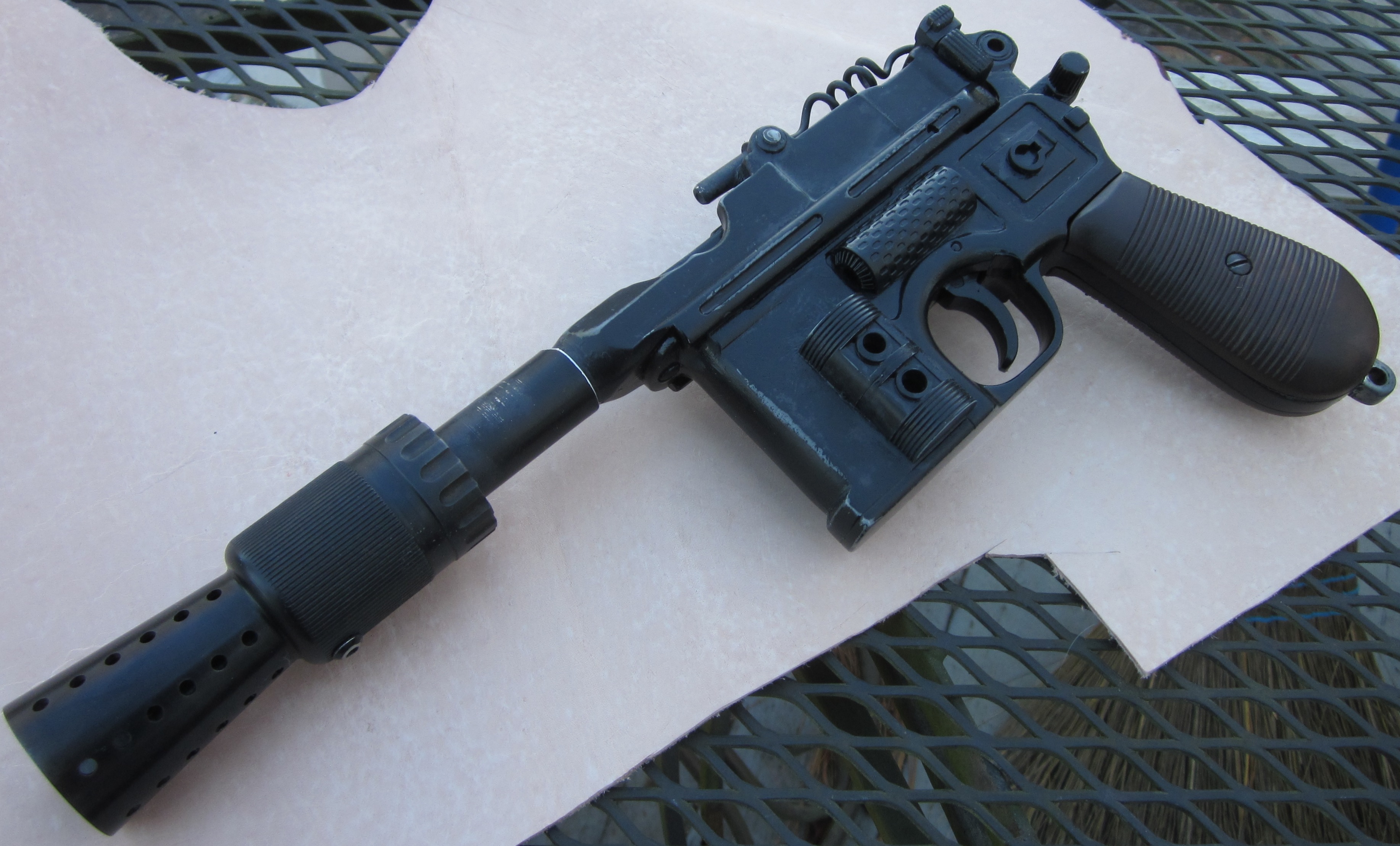

I've already done a lot of work on the DL44 blaster. It was built on a Denix C96. Flash hider is a 2nd from DEC's run that I cold blued. Bull barrel was machined on the lathe by me. Rear sight was removed for the wire. The rest of the parts are all extras from a Revell visible V8 that I had lying around. Whole thing was then painted a semi gloss black and weathered with Floquil. I'm pretty happy with how its come out, though I still want to add the grill on the front. Just gotta figure out the best way to do it. This sucka already weighs around 3lbs lol.

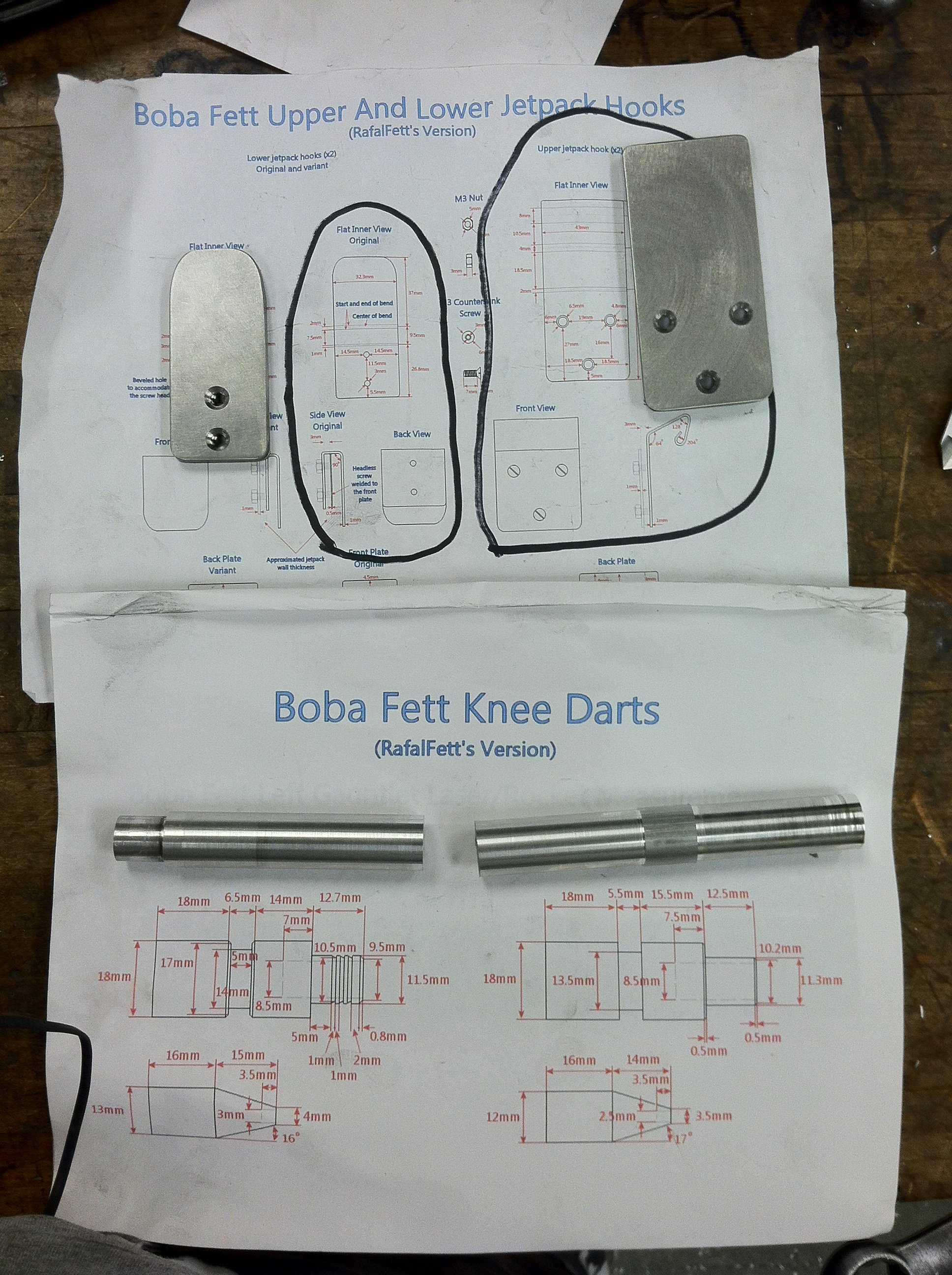

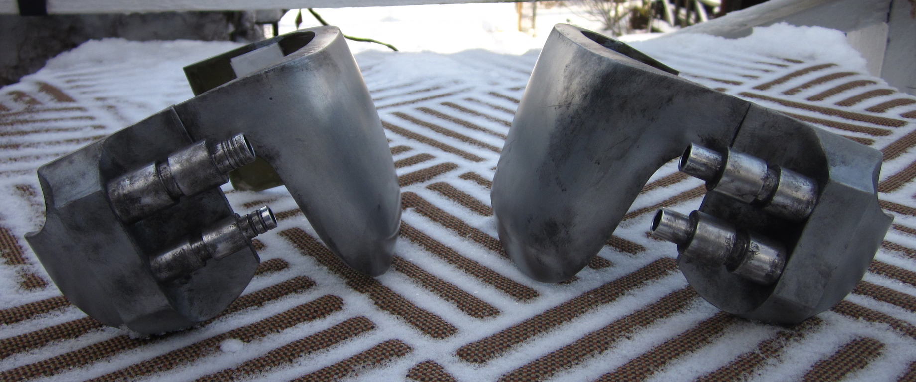

Started on the metal parts while I'm waiting for other things to show up. Jetpack hooks are all set for the sheet metal guy to bend up, and the knee darts are roughed to the outer most diameter. Using RafalFett's awesome plans for all these parts. There will be three different style knee darts for this build. Two like the one on the upper right for the left knee, one like the upper left, and another like the one on the upper left but half the size.
I was going to machine the two gauntlet rockets out of Aluminum and a Brass or Bronze alloy with a high copper content for the nice orange color, but I found a rod of Black ABS stock I forgot I had stashed away that's the right size, so for now they are going to be either entirely or mostly machined from that to save cash. I can always make a nice metal set as an upgrade at a later date.

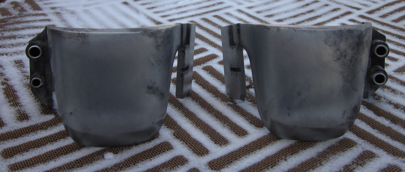

Chugging along on the metal parts. Knee darts are done. Jetpack stabilizer is about 90% done. Next will be the beacon and then the rockets.

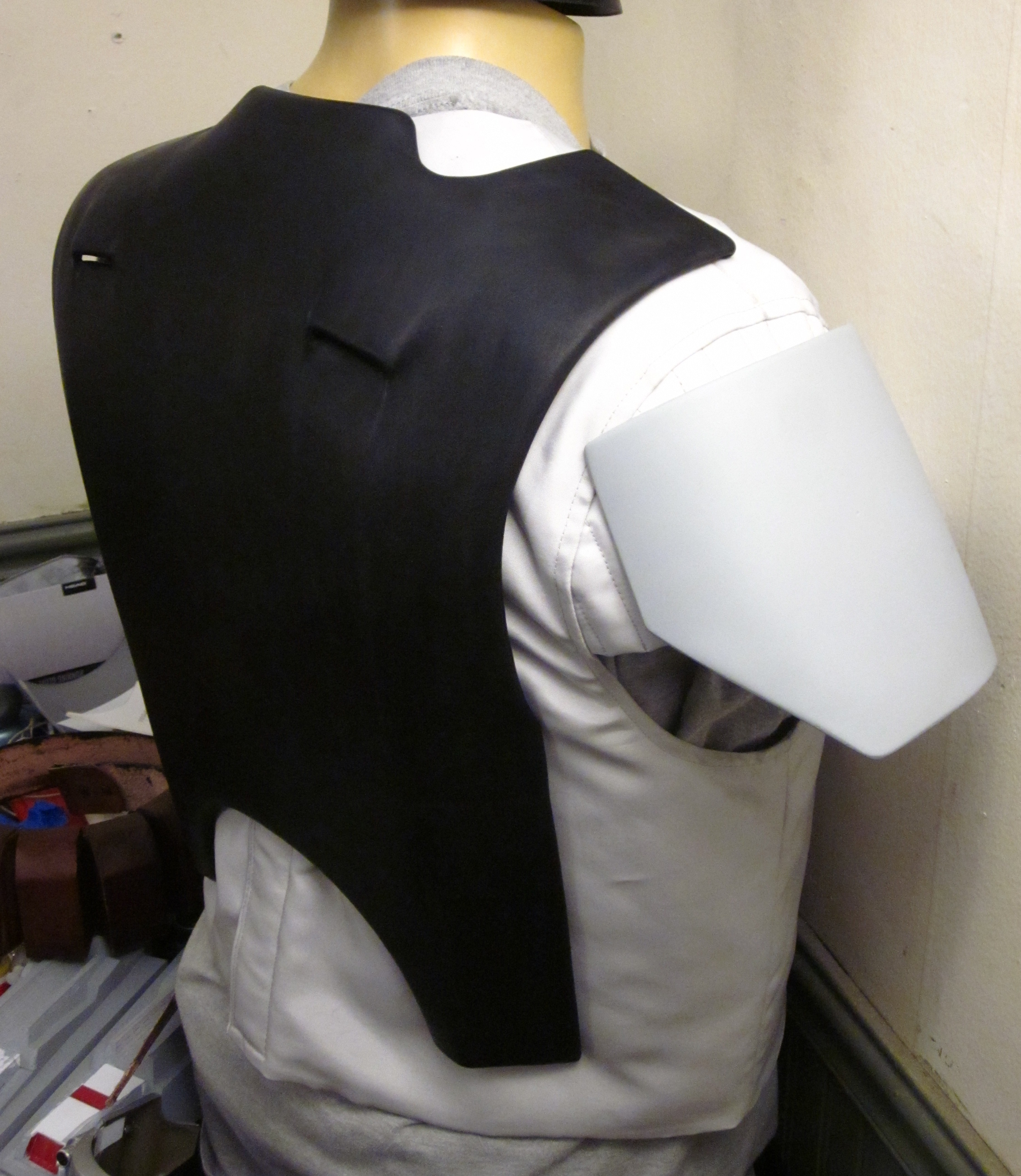

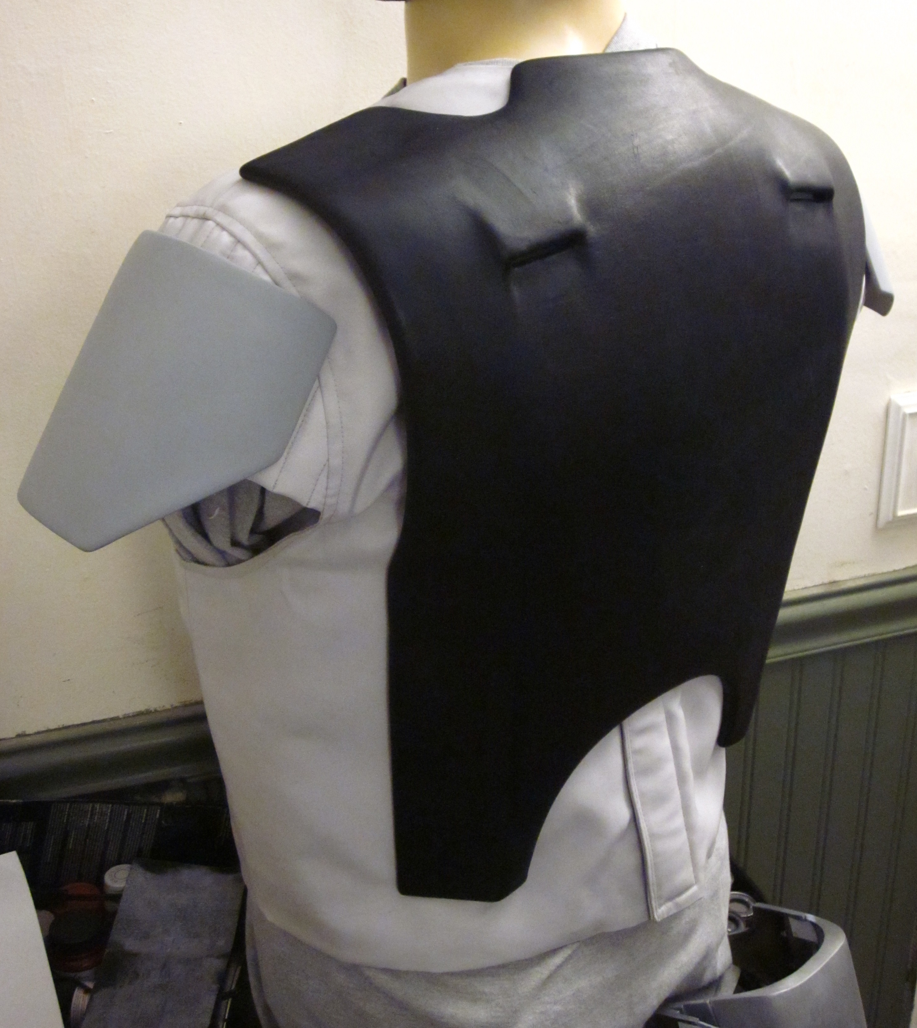

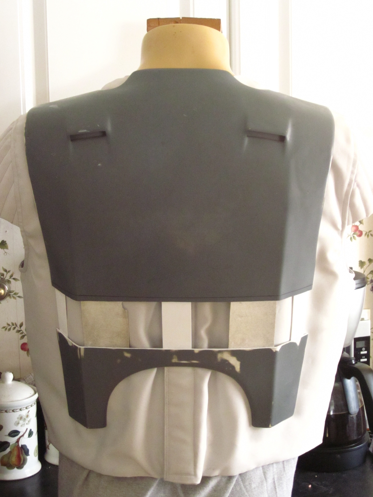

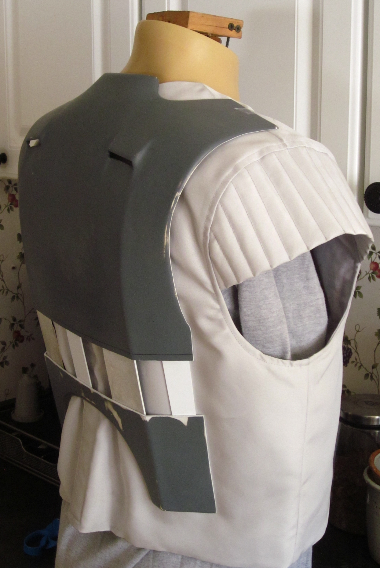

The Batninja vest came in, and so I've begun working on the armor, starting with the backplate. I originally was going to use WOF's template for the backplate, but decided instead to alter a damaged FPv3 backplate for my purposes.
Based on the ref photos, the vest itself appears to be longer than the standard vest we are used to. As such I had the vest made a couple inches longer to reflect this, in addition to me standing at 6'2. The backplate needed to be extended to accommodate for the longer vest so I cut it along a line I drew and have extended it by about 2.25". I need to order some 3mm styrene to fill in the gap and once thats done it will be covered with a black leather.

Got the backplate more or less done and covered with leather. Just gotta add the mounts for the straps.. Shoulder bells were made using Sintra

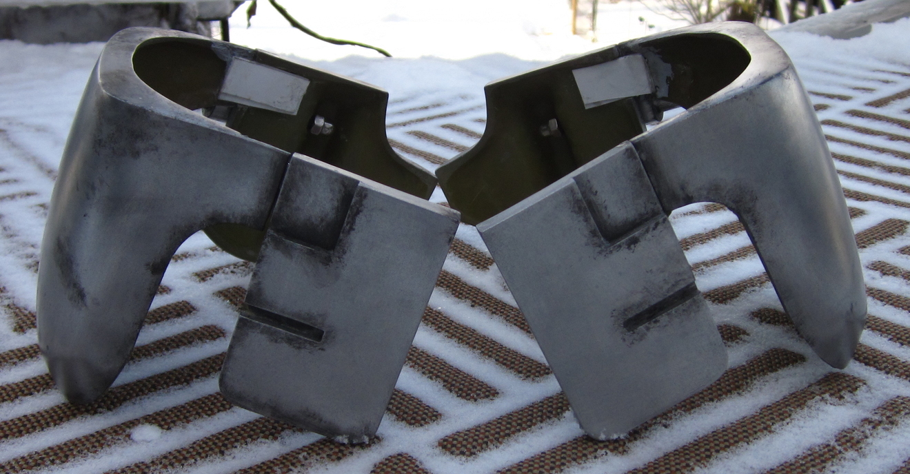

Cruzers stuff also came in. Worked on the knees during the Snowpocalypse we had last night.. Had to heat them up with a heat gun in order to get them to warp enough to fit me. Weathering is done with Floquil "Weathered Black"
