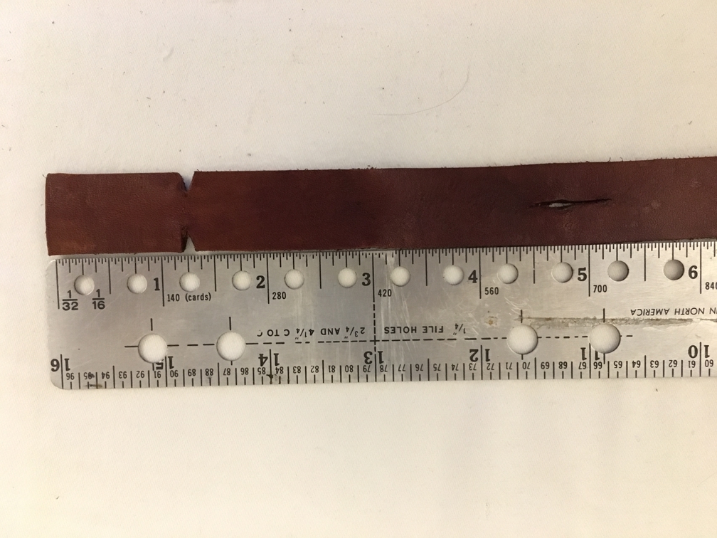

1) Starting at the front of the sling, make two perpendicular "V" shaped cuts about 1/4" deep on each side of the sling about 1 1/4" from the end of the sling
2) Next make a slit in the center of the sling starting about 4 1/2" inches back from the end, long enough to be just shy of the full width of the sling. (For mine it was at the 5 1/4 mark)

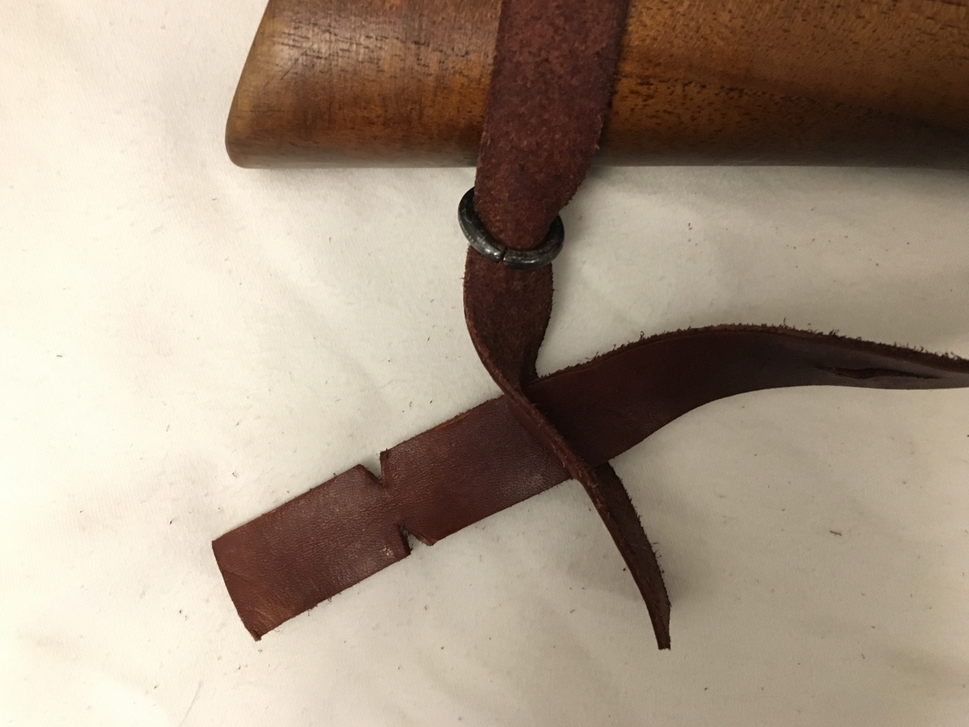

3) Now, moving to the back end of the sling, make a single slit in the center starting about 1 1/4" from the end, and long enough for the full width of your sling to pass through.
Tying the Sling

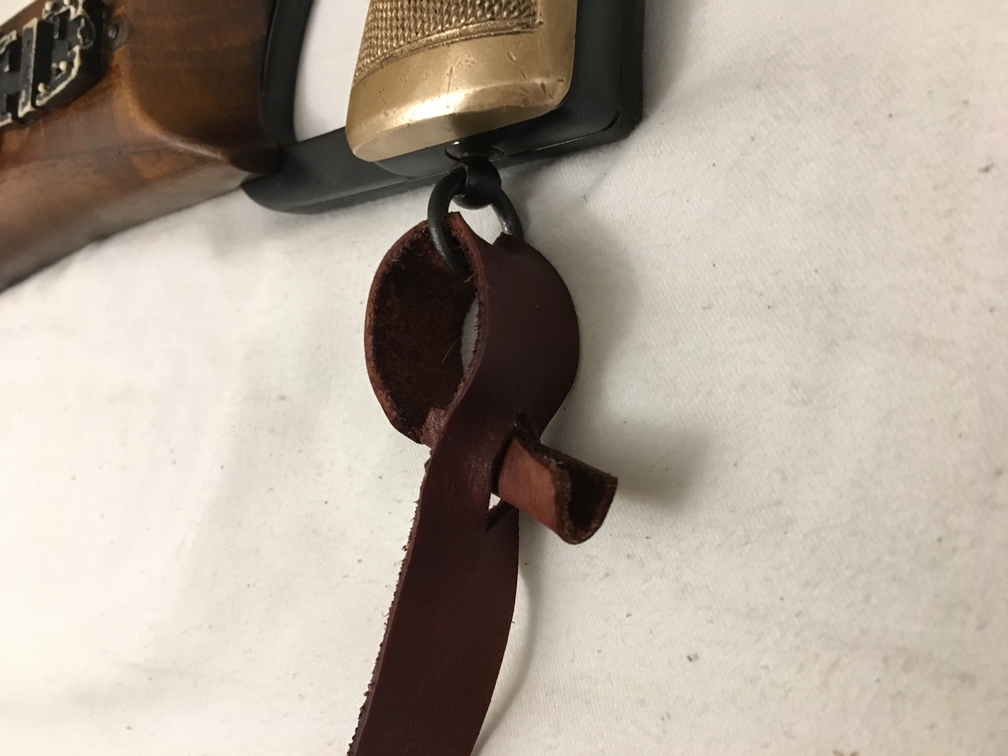

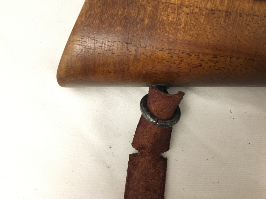

4) Feed the full length of the sling through the back ring with the fleshy side facing out towards you, making sure the sling follows the inside contour of the ring, stopping at the start of the slit you cut at the end
5) Now pass the front of the sling down through the slit and pull until taught. This will lock the end portion of the sling on. Tighten the knot as necessary

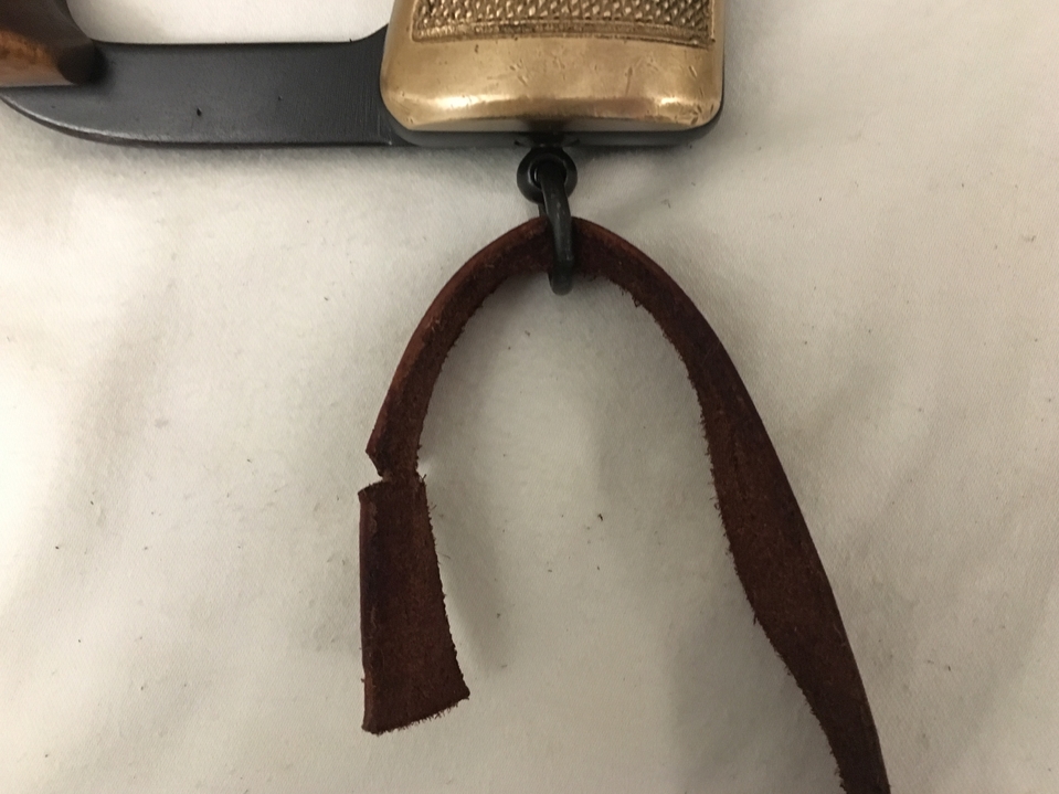

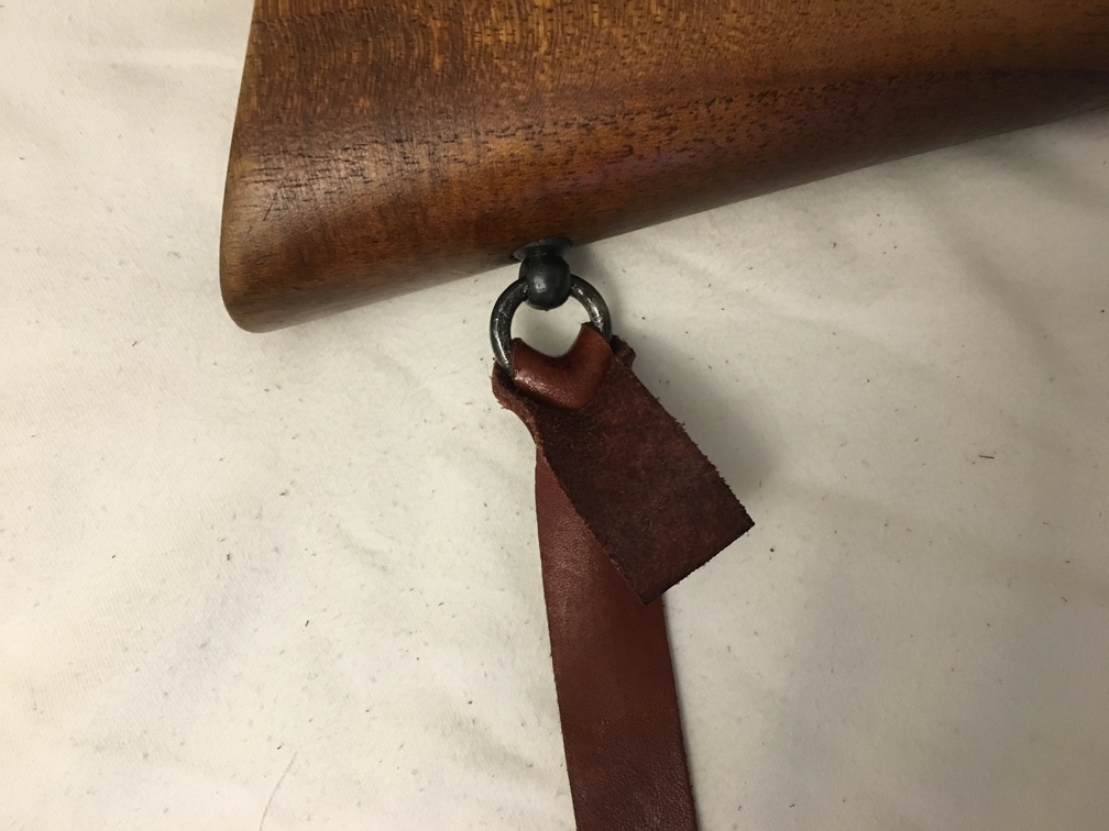

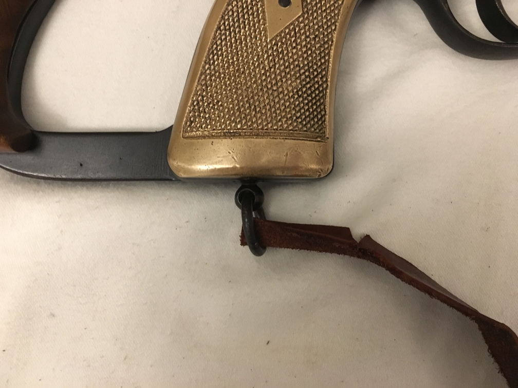

6) Now, moving to the front ring, pass the front of the sling through the front of the ring going towards the end of the stock, again making sure its going with the inside contour of the ring. Stop about half way between the "V" cuts and the slit cut further back
7) Now fold the tabs at the "V" cut over and pass through the small slit you cut, the tabs will then unfold and essentially "lock" itself on. Pull taught making sure it's secure,
And you're finished! :)

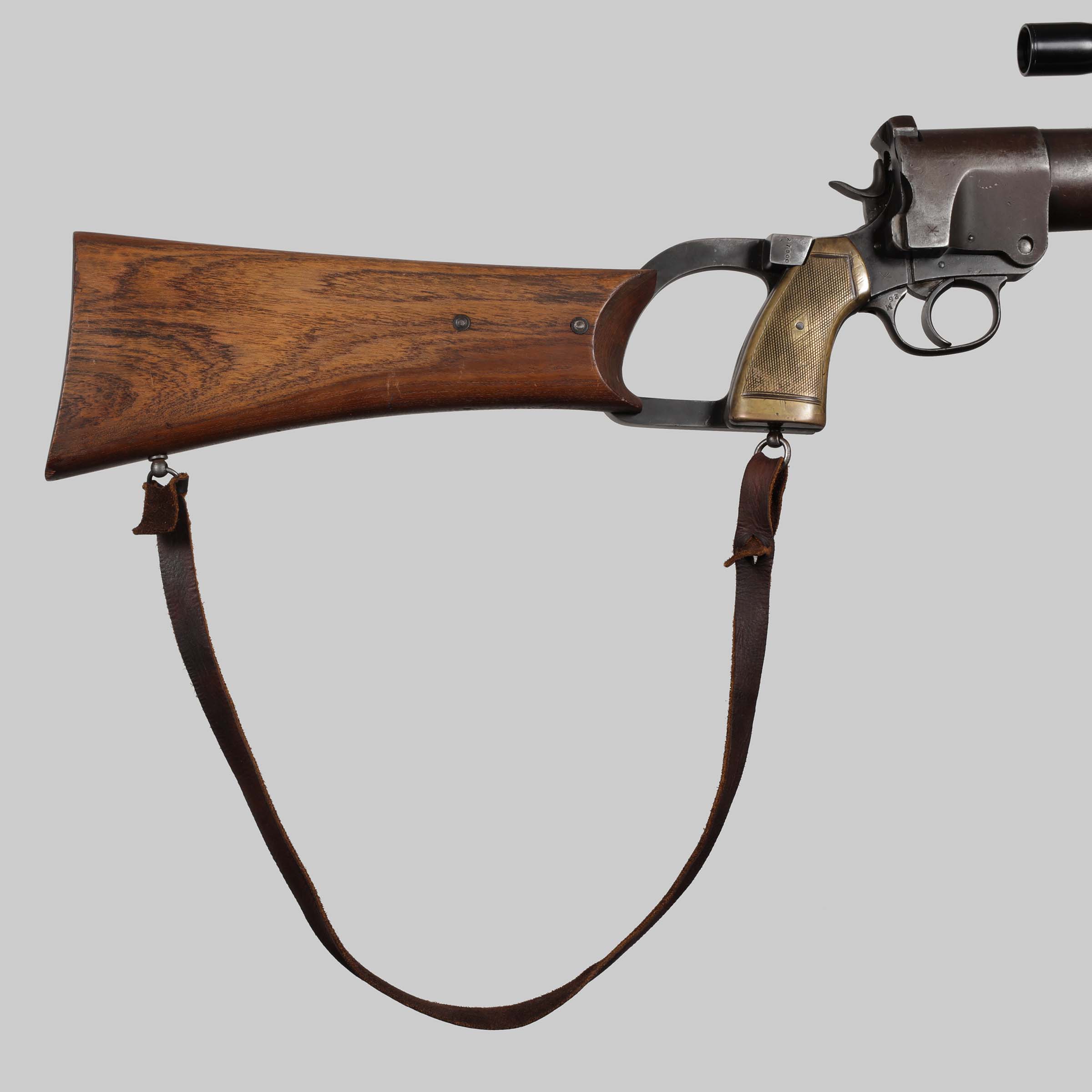

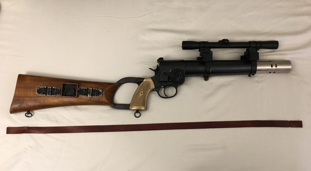

After studying the photos as carefully as I could and doing some scaled measurements (these were far from precise, but gave me a starting point), I cut my strap to 30.5." Let me just say right away, this is going to seem obscenely short. While I am not saying I am dead-on in regard to length, that is in the ballpark. Fett's strap is short... it isn't like he uses it...

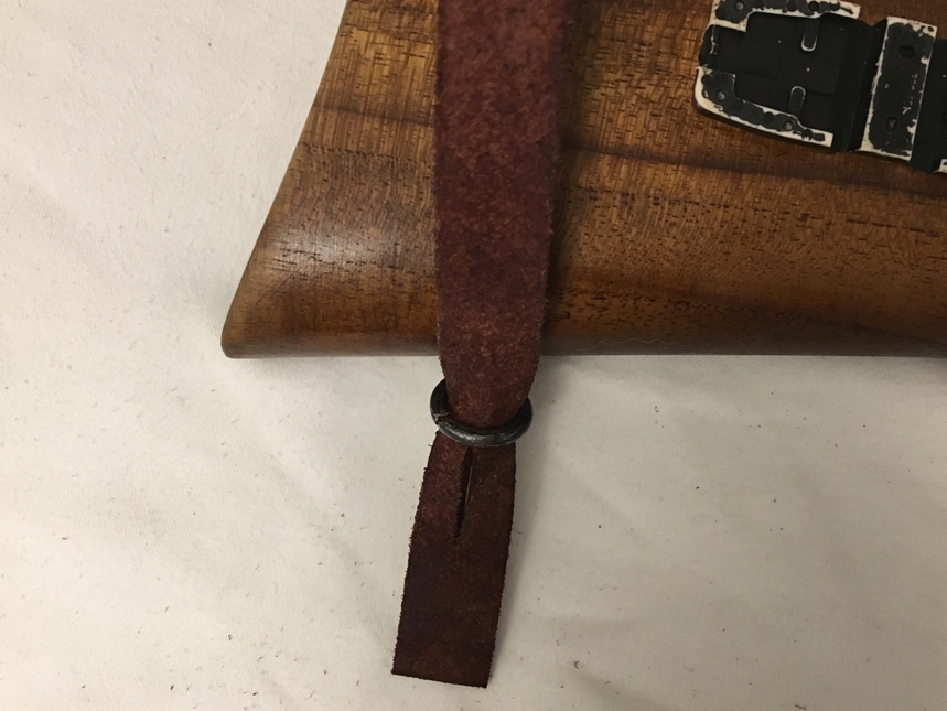

I followed Ken's guide and cut the back slit starting 1 1/4" from the end and 3/4" long.
On the front, I deviated just a bit. I don't feel like the tail at the front is as long as the one on the back. I cut the two notches at 1" (as opposed to 1 1/4") and I only cut two small slits, not actual V shaped notches. I also cut them at 3/16" instead of 1/4".
I cut the pass-through slit starting at 4 1/2" and initially cut it 1/2" long. However, folding up the leather and trying to pass it through didn't work, so I had to widen the slit to 5/8."

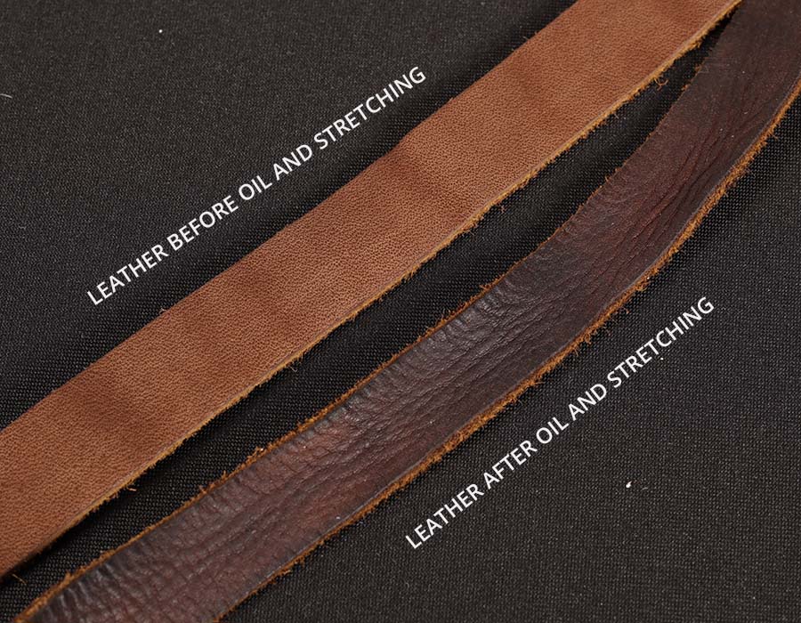

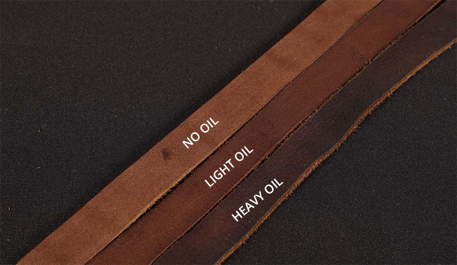

I used Red Wing Shoes - All Natural Boot Oil to soften/darken the leather and then folded into quarters and twisted it into knots are hard as I could for about 10 minutes. This process increased the overall length by 1."
Here is the leather, before and after oiling:

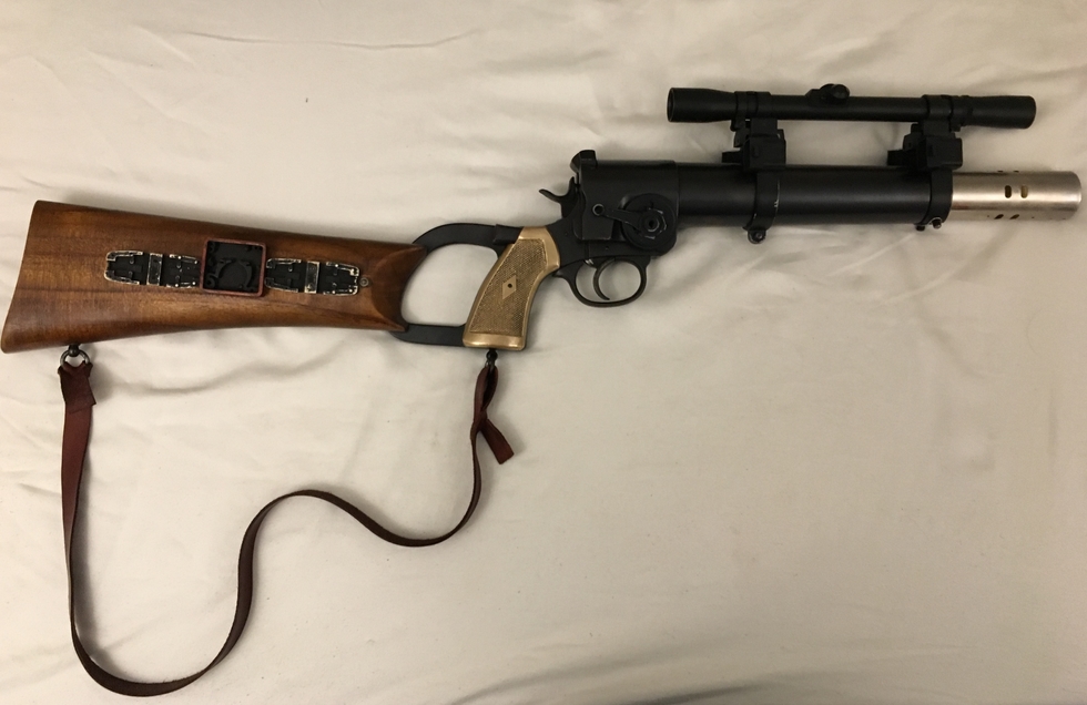

Overall I am pretty happy, although I believe my strap is still a bit too long when compared to the original (I was not anticipating the stretch from the oil). I may try this again with about 3 fewer inches.

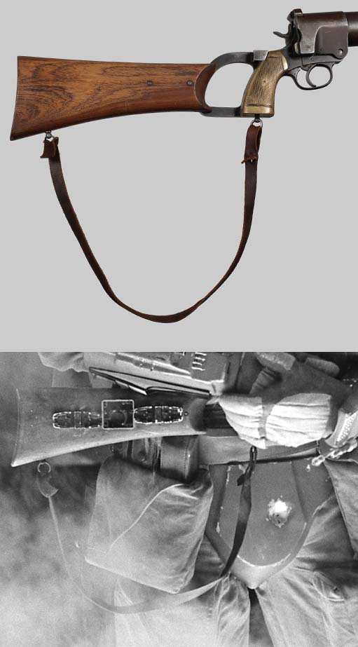

On the first attempt, I really laid the oil on this... so thick that I feel like it might be a little dark. Not much... and it will dry some, but still. I had applied it with a brush. This time, I put the oil on a napkin and very lightly hit the leather, only making it slightly darker. Sadly, this also means it doesn't look quite as weathered and beaten, but I'll just have to live with that.
Overall, I think this is much closer... although I still think the front tab MIGHT be a bit shorter and the back tab MIGHT be a bit longer. Still... not bad.
