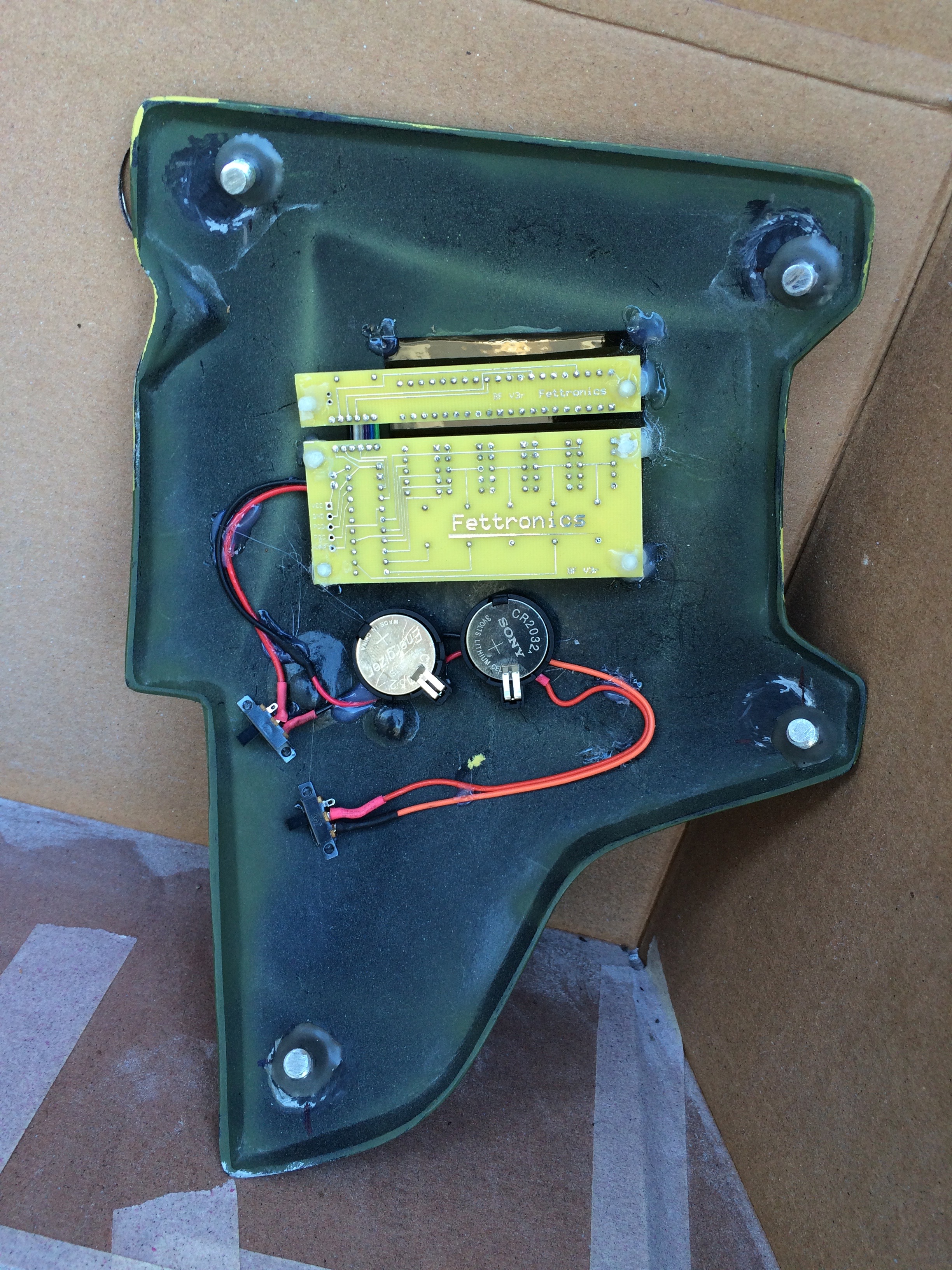

I like DentedGent's (GF's) idea using elastic, but I'd be afraid that would slip and not line up with the cutouts while wearing. I've seen many using just duct tape, but I went for a more permanent mount using hot glue. I also rewired mine (a Fettronics board) to use 3V lithium cells to avoid the larger battery pack:
Just be careful to place and measure your cutouts accurately, and wedge your "translucent screen" between the back of the cutouts and your light board.

Nice touch with the rewiring! I could do without the big battery too, but thankfully I just stick it on a magnet on the inside and it stays in place well. Your concerns with the board shifting during troops is a good point. You have to make the elastic tight enough not to damage the board yet maintain it in place, so it has a bit of a sweet spot. It held up really well during two consecutive 8 hour filming sessions including full running and going prone and it only shifted once.
