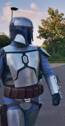

JangoUri, I used R&B on my painted Rubies helmet and armor below and I didn't even have to mask off the blue areas on the helmet. The fact that the silver areas were already painted silver helped, and I would just rub off the R&B when I did get it on the blue areas by accident. I did sand the silver painted areas though with fine grit sandpaper before using R&B.

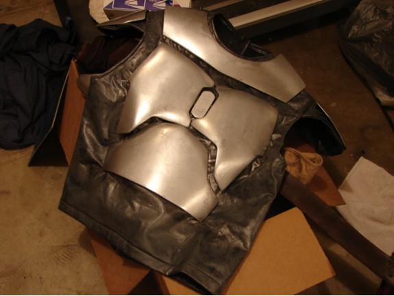

You should R&B everything. With applying it correctly and as time goes by the finish will harden and stop rubbing off on other things as much. I applied R&B to all my armor after I had painted it all with Rustoleum Metallic Silver and I think it turned out good because the paint helped to create a smooth surface after fine sanding it to prep for R&B. Plus if the R&B ever rubs off or scratches, you have a silver undercoating of paint to maintain the silver color.
Oh buddy, that armor and helmet are super nice. Yes, I should have told you I was looking Rub & buff, then you could have included them on the package. (by the way, the package is about arriving, I know is has already passed the customers)
