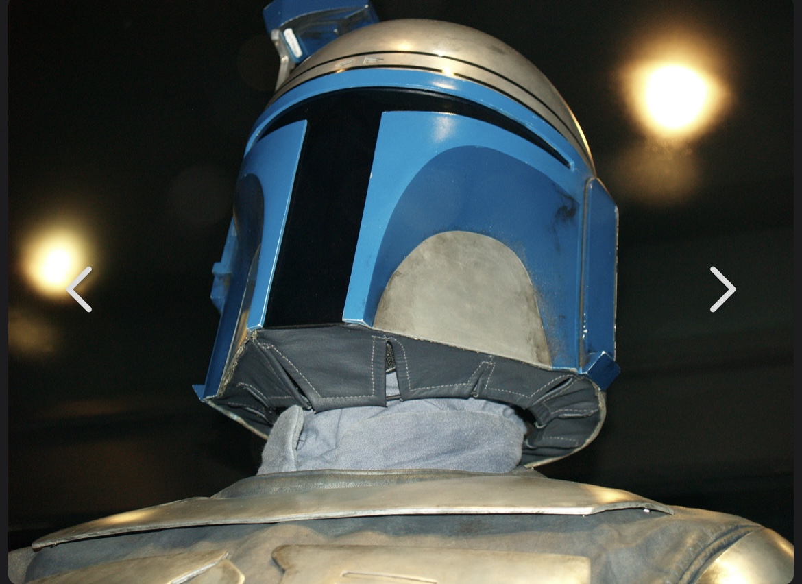

Hey everyone! I’m going through a local leatherworks to get a batch of helmet skirts commissioned. It’s been a long time since anyone’s made these, and this is currently my only route to get them done. To be clear, I have the previous created 1:1 scale file on here and will make sure these are as accurate as possible.

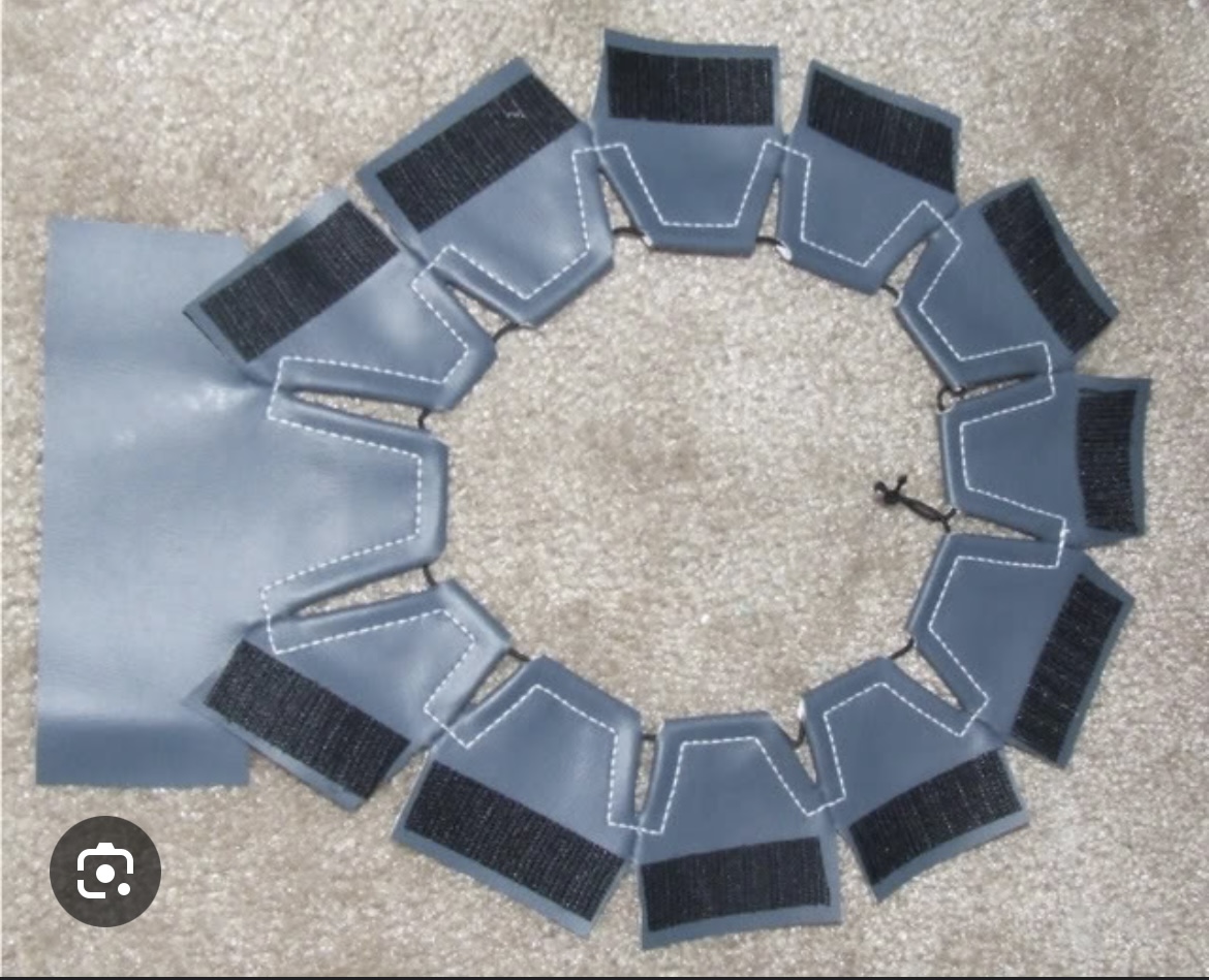

I had him follow this plan with the Velcro on the inside (where you will add some strips to your helmet so you can attach or take off when ever you like)
So we can expect it to look largely like this example before.

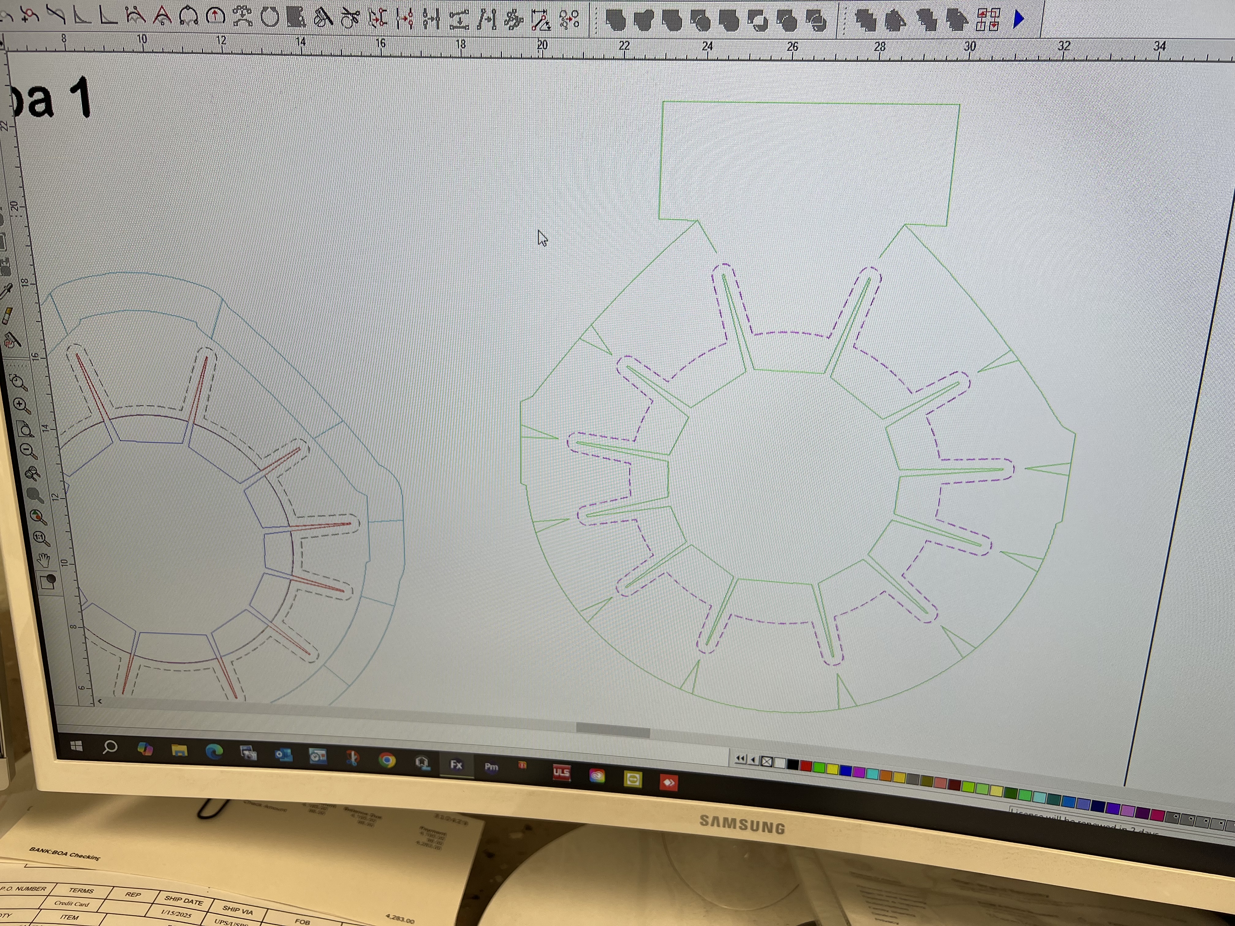

This is their first sketch with my critiques.
This will all be laser cut. The triangles you see at the borders, are for the added inch of extra material which have the Velcro. We need this because of the angles will be attaching the Velcro on the helmet. We decided to stitch the Velcro on. Unlike the previous skirt made on here. You guys will have to add your own Velcro on the inside of your helmet.
One thing they will address is the circular stitching on the bottom. I will make sure they square it off.

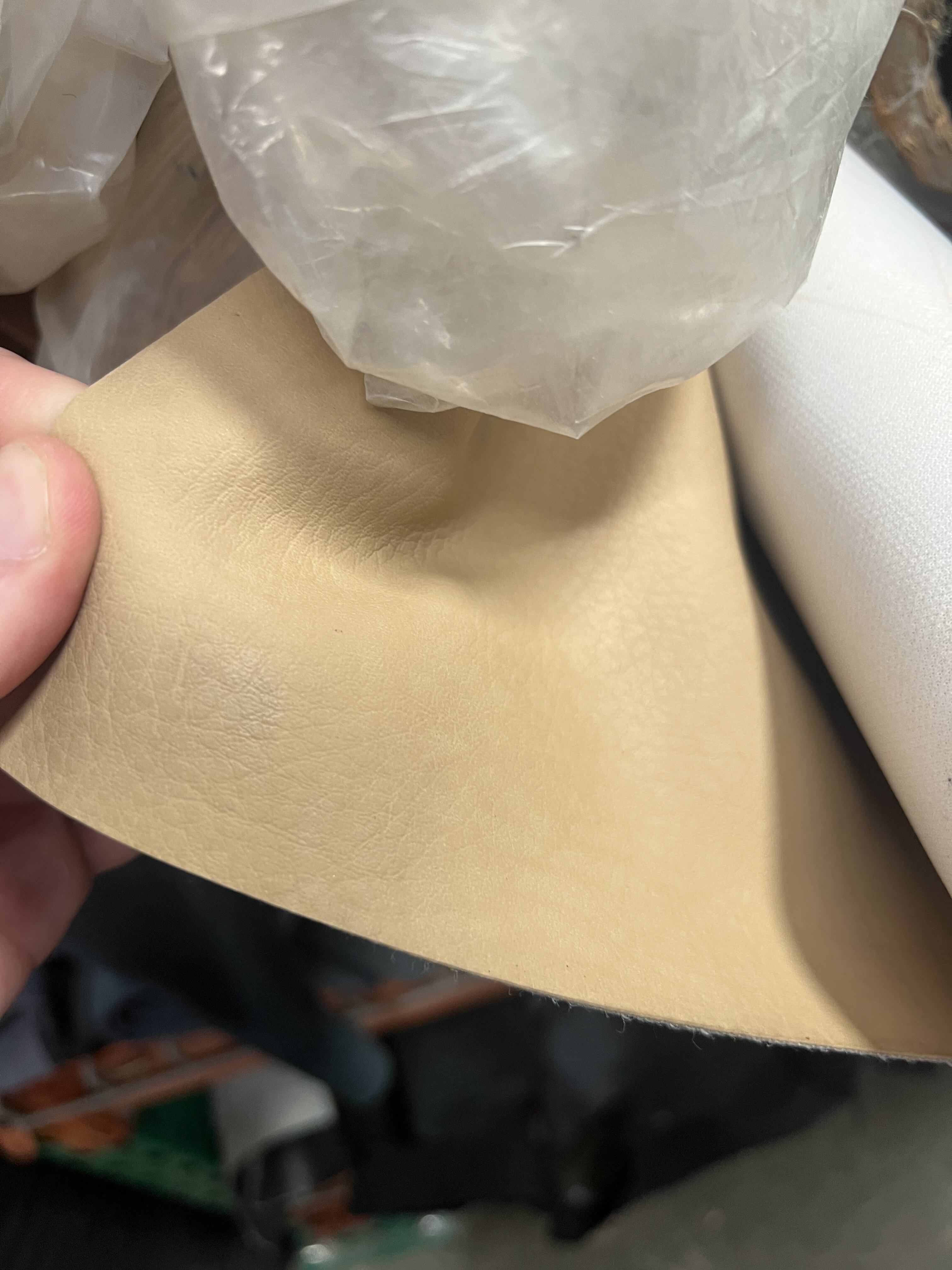

I think we’re gonna go with this type of vinyl (obviously, not this color ) that looks like leather. Leather, would just be ungodly too hot and substantially more expensive. I’ll get a sample of the navy/dark blue as it gets closer.
