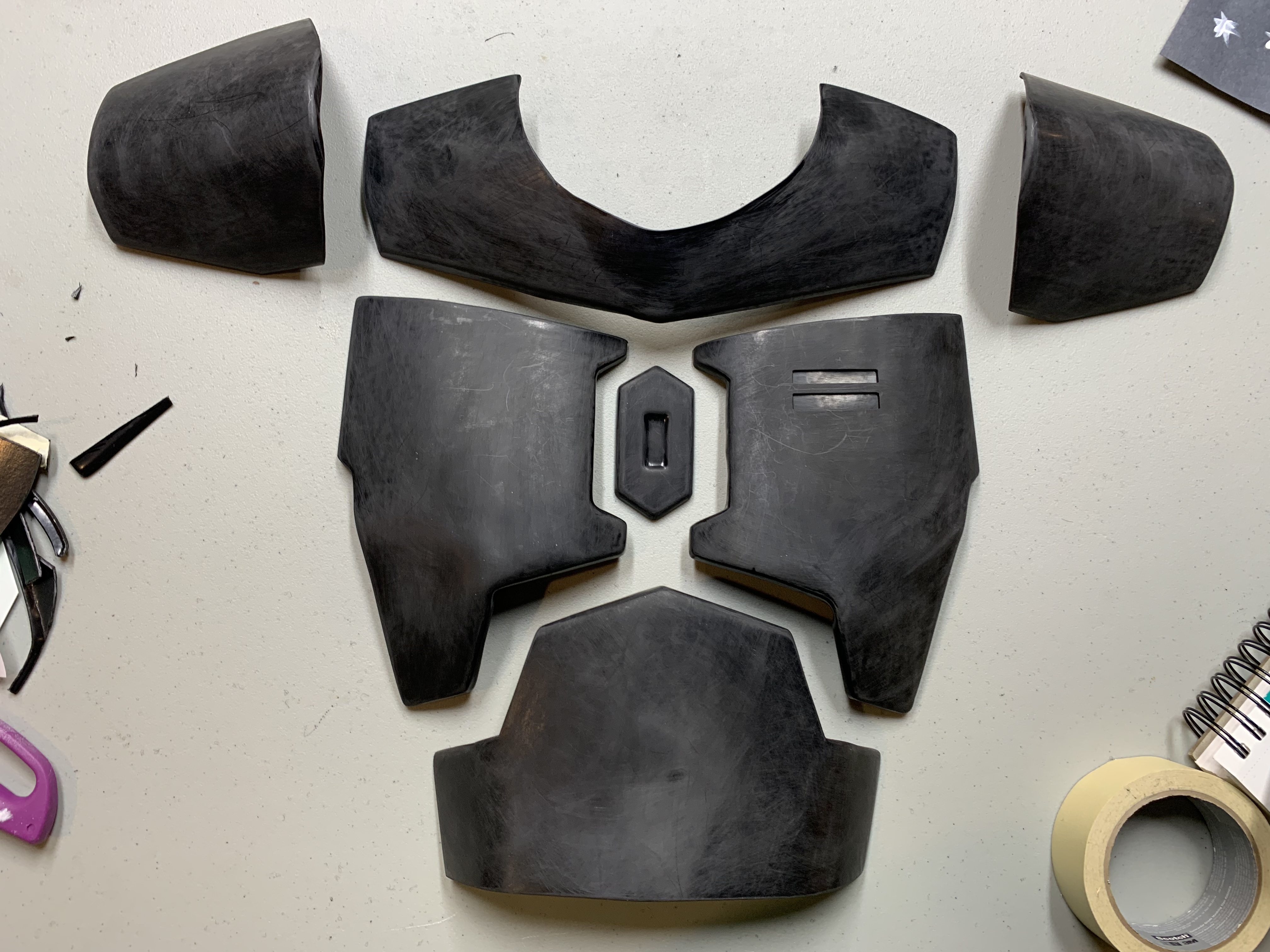

I started trimming and heat shaping the chest armor.
Stock armor, before trimming
Rough marks where to cut with sharpie and masking tape.
After trimming. I tried to make the armor shape match Jango’s better, as well as make it a little smaller to fit me.

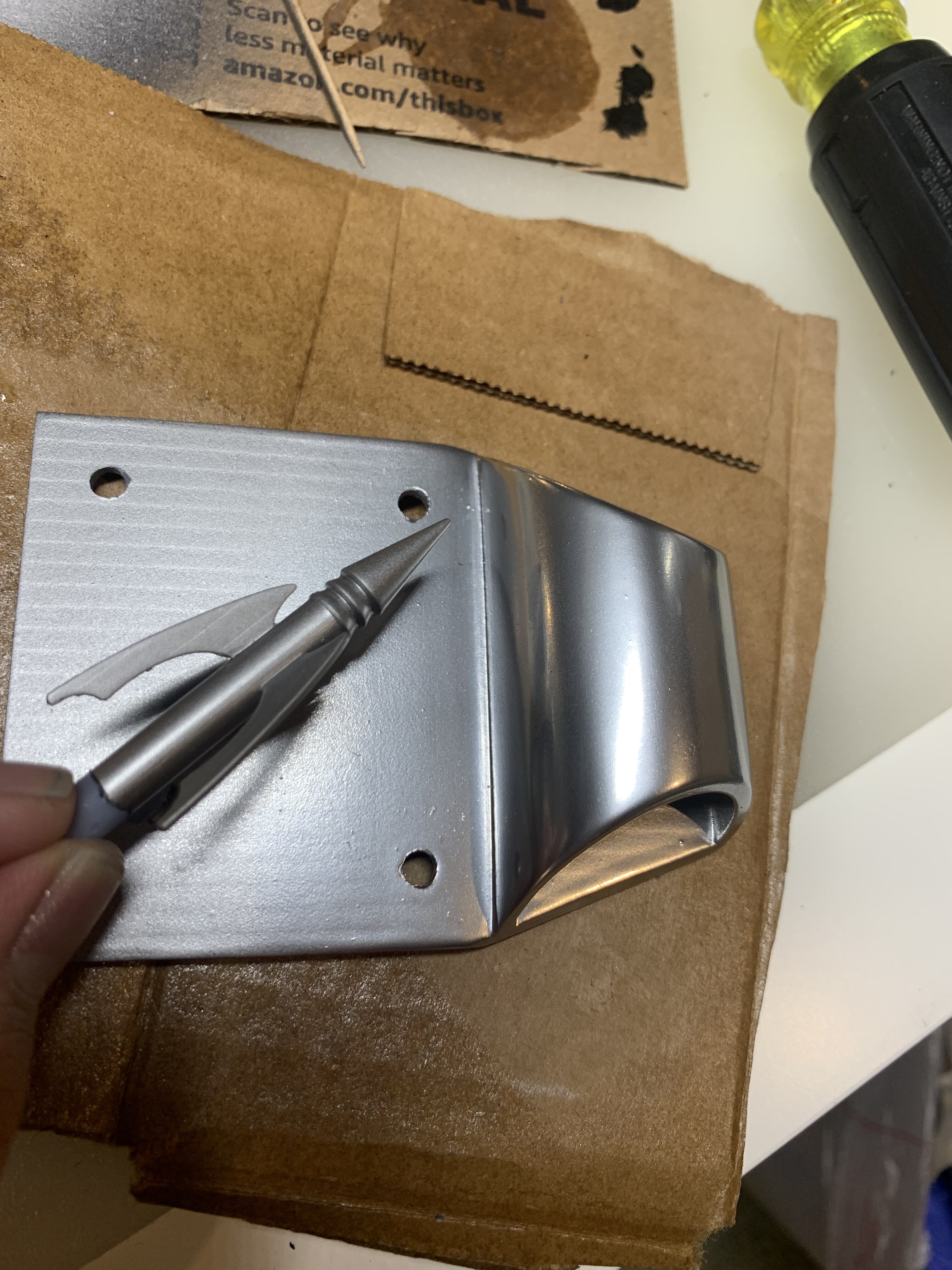

So, big setback. I tried the Minwax polycrylic clear coat on the rub n buff, and it looked fine and no more silver rubbing off.
However, with the slightest scratch the clear coat would come off. This would not do for me. And then I tested some Rust-Oleum bright coat metallic finish on some scrap pieces, and it looked even shinier than the rub n buffed pieces.
The cod loop is sprayed with rust oleum in this pic.
So I decided to entirely redo the rub n buffed armor pieces. At this point I had already clear coated the gauntlets too, so I had to sand through that as well. Annoying, but nessecary.

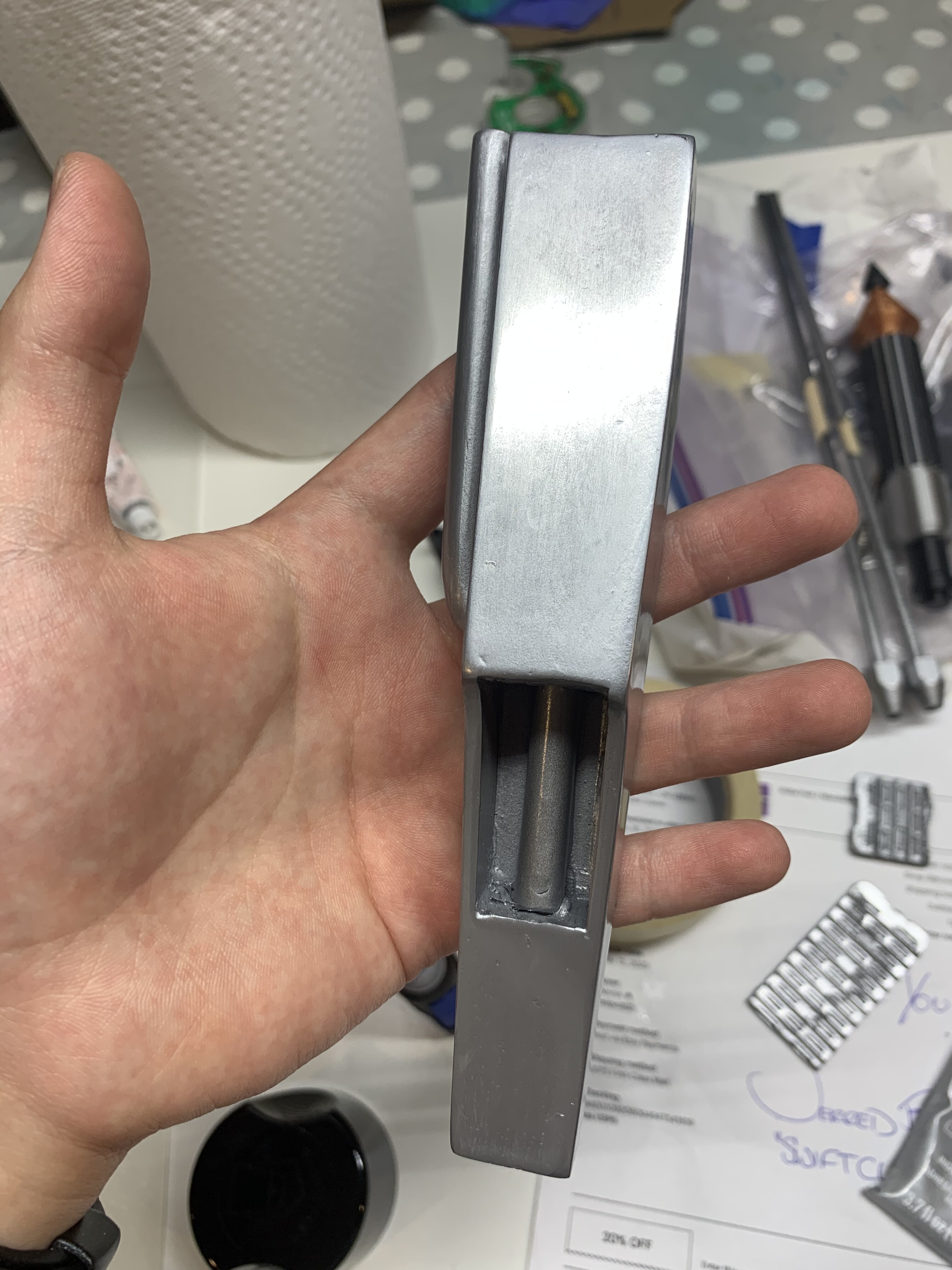

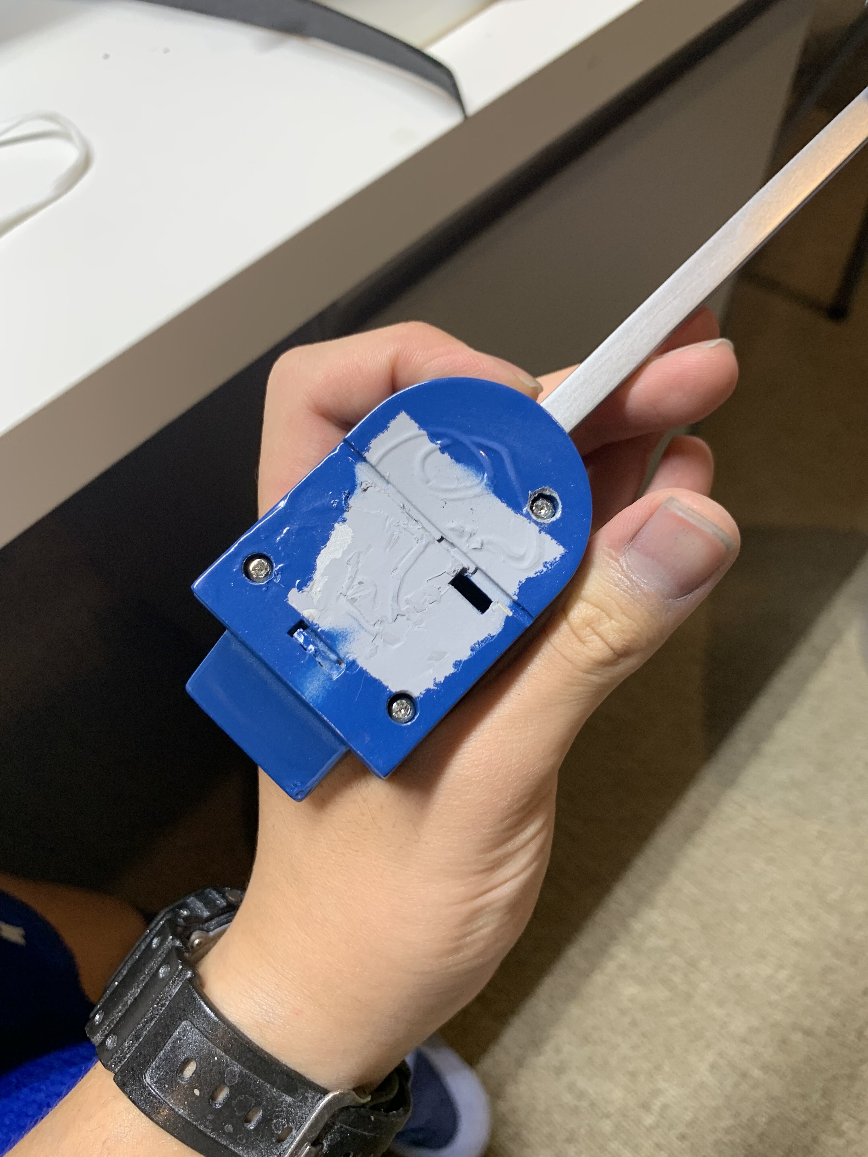

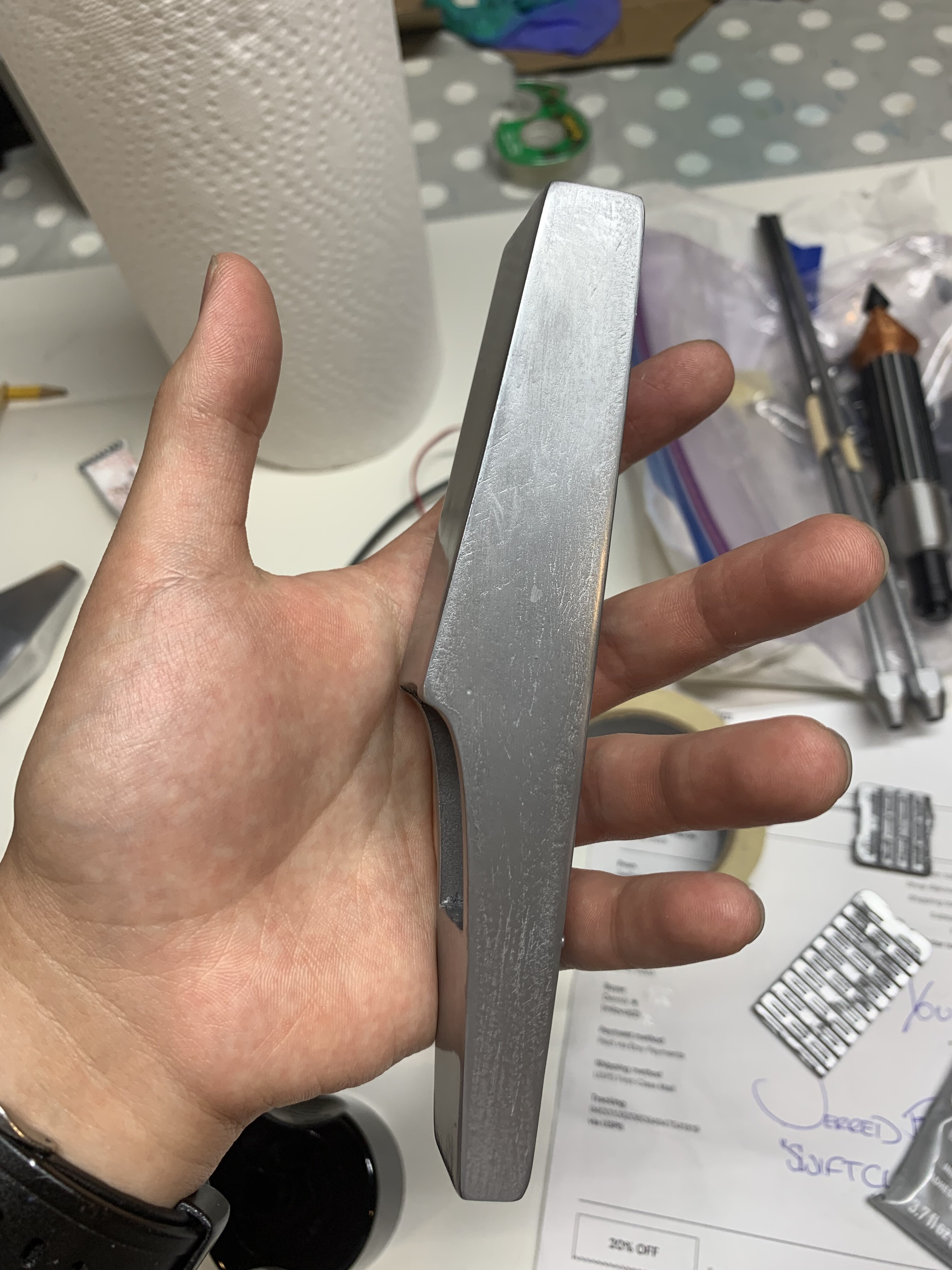

On a positive note, I finished putting the rangefinder together. I painted the little view screen black and used the original rubies screws to put it back together. The stalk, and gauntlet greeblies use rust-oleum custom premium chrome paint, and is a bit duller compared to rust oleum bright coat metallic finish but I think the contrast between silvers might be more visually interesting (translation: I don’t feel like spraying them again).

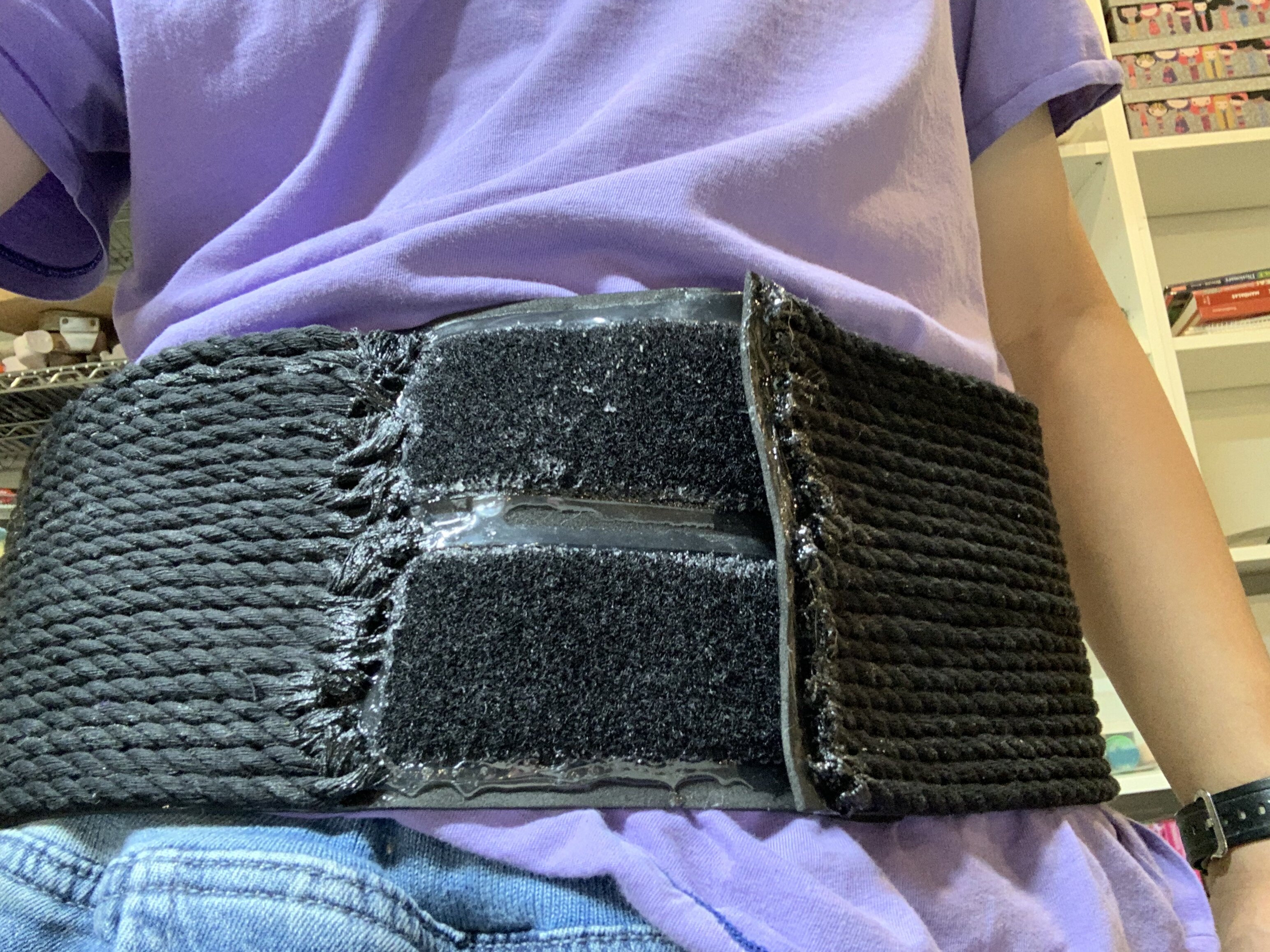

Added ropes to the girth belt.
Really happy with it, but I made it a little too short. A lot of velcro shows. I’ll extend it a little, and maybe make some strips to cover the loose ends of rope. The leather loop that covers the closure will have to be a little wider than it’s supposed to but no biggie.

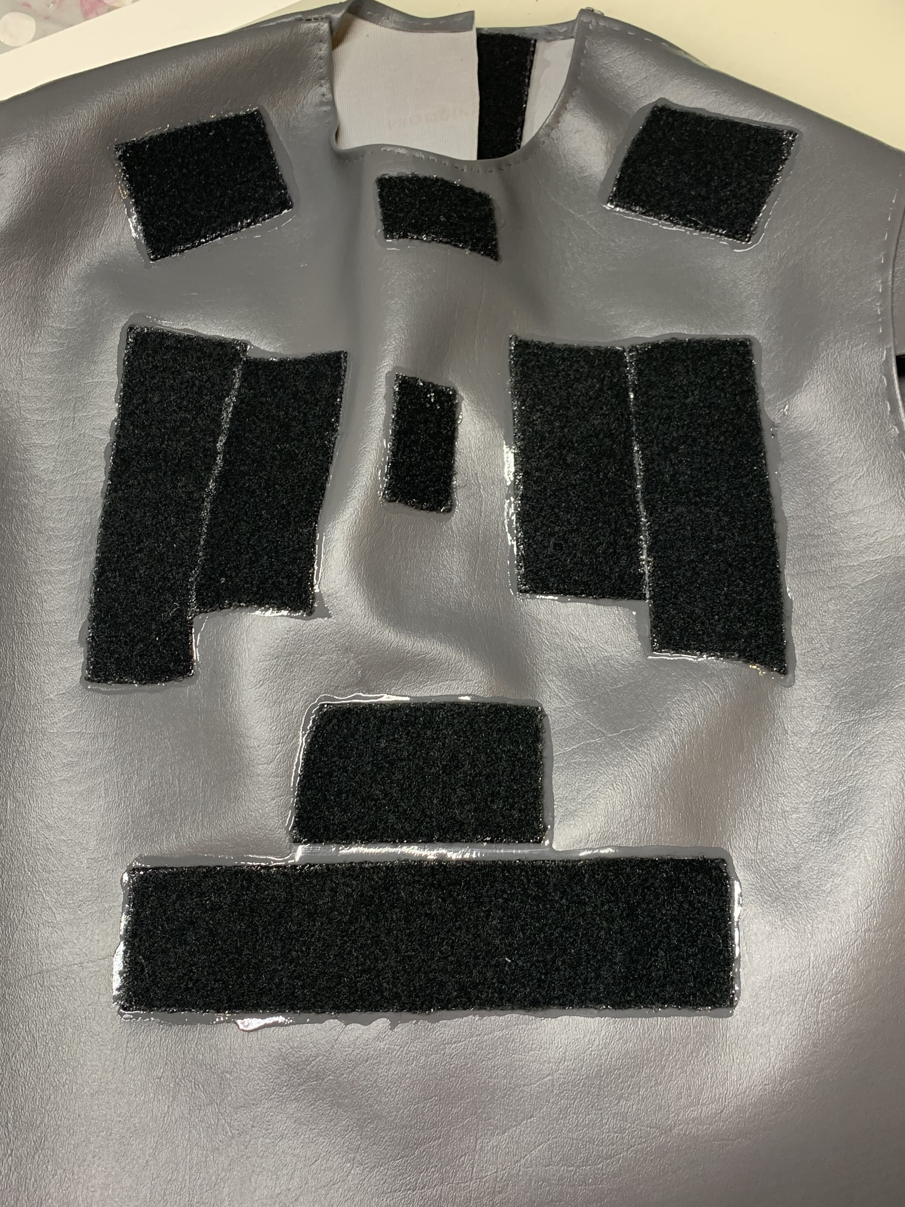

I decided to use adhesive Velcro. I didn’t expect it to stick that well to the vest but it actually feels pretty strong.

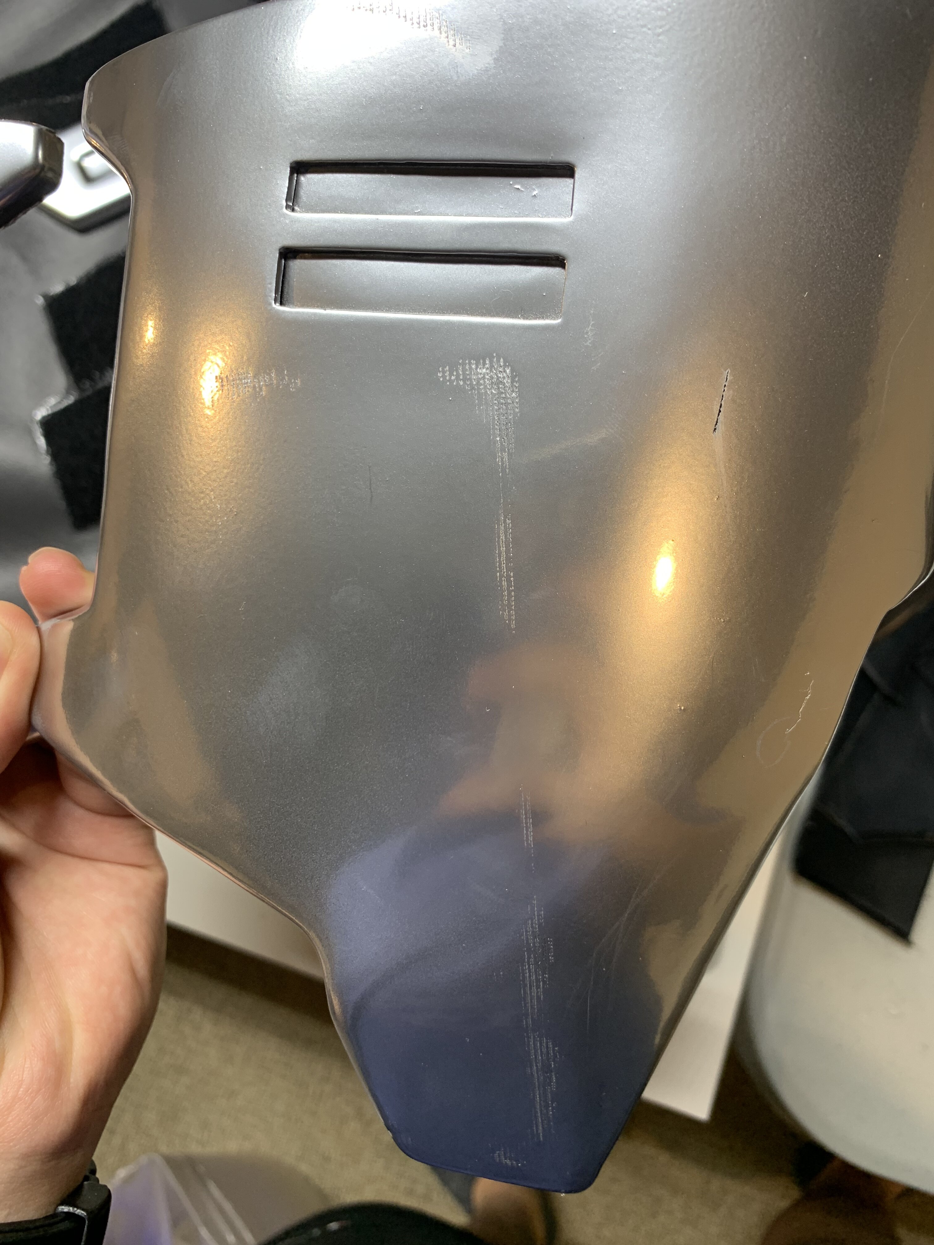

For the chest slots, I cleaned them up with a file then heat-shaped and superglued a scrap piece of plastic behind it. Used e-6000 on the edges, that thing isn’t going anywhere. I filed the top slot a little too much and it looks the same size as the bottom one, but no big deal.
To heat shape it to fit behind the armor perfectly I heated it up while magnets were holding it to the armor so it would sorta settle in to place as it softened. I adjusted the edges with my fingers while it was still soft. I think this worked really well to make it sit flat.

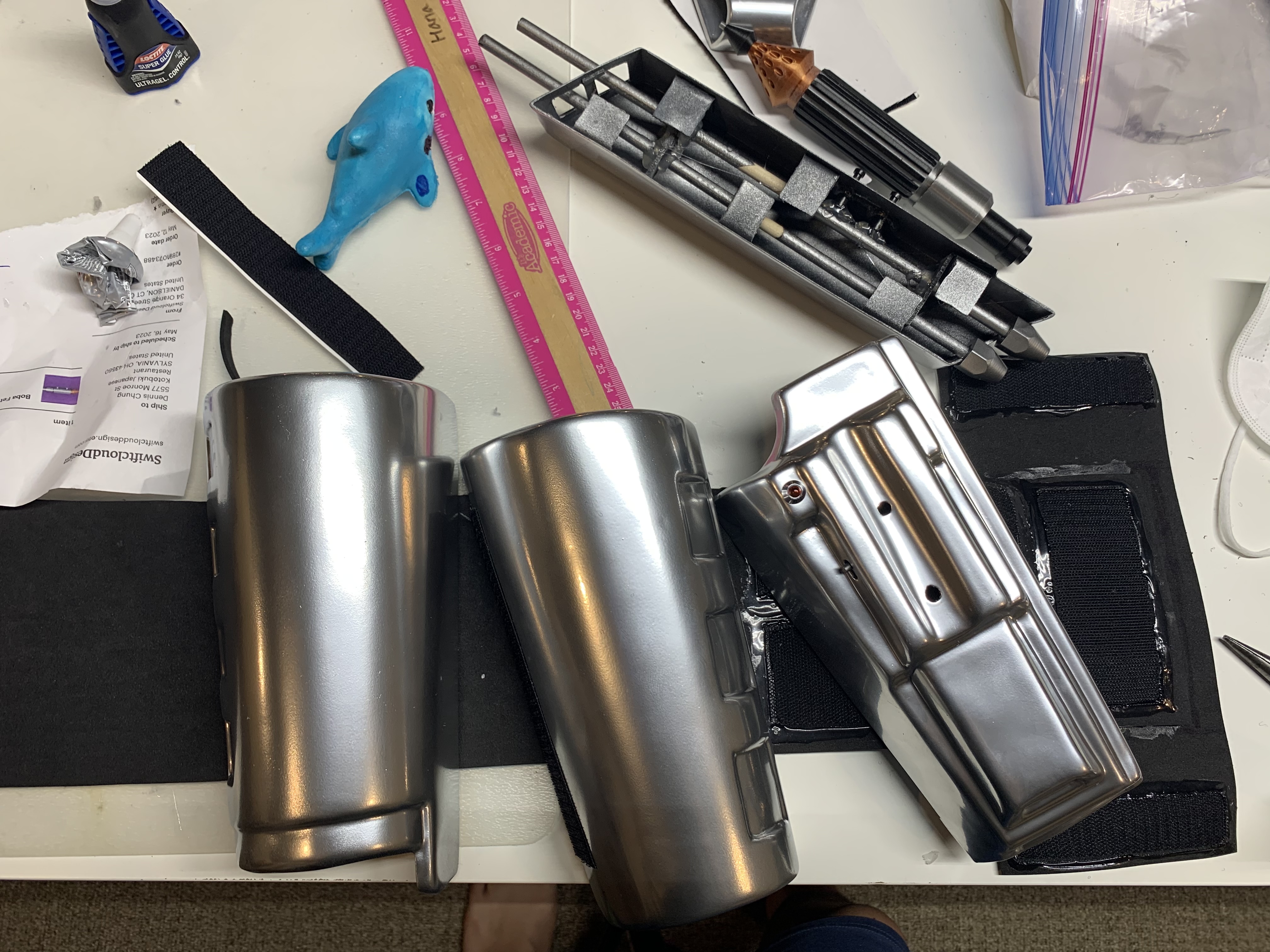

Gauntlets have been primed, wet sanded, gloss blacked, and sprayed with rust oleum bright coat metallic finish. I started assembling them too, coming along nicely. Some parts I messed up and had some runs and mistakes, repainting those. Had to do that multiple times.

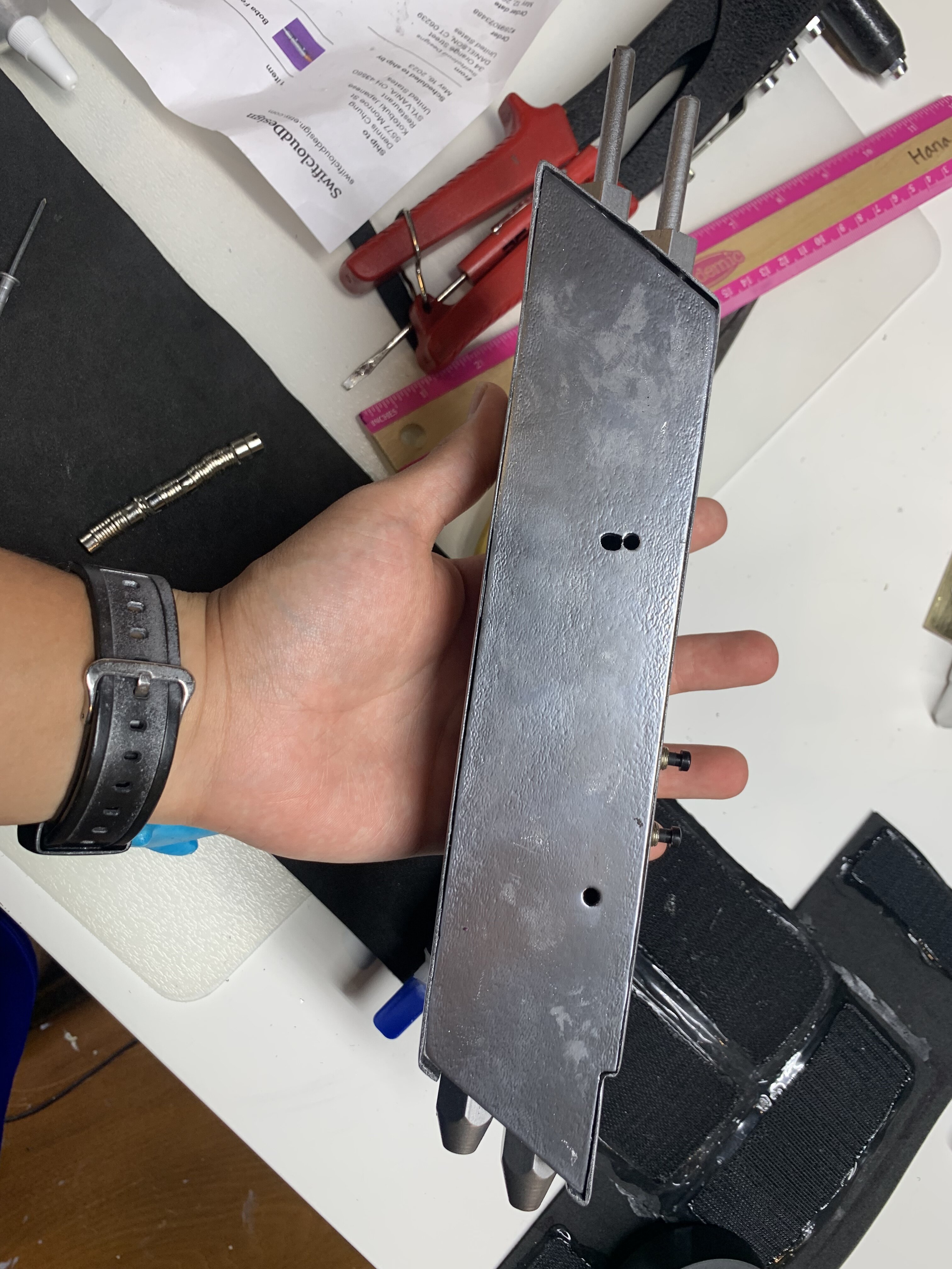

Flamethrower box. Wooden rods hot glued in. Buttons also glued for extra support.

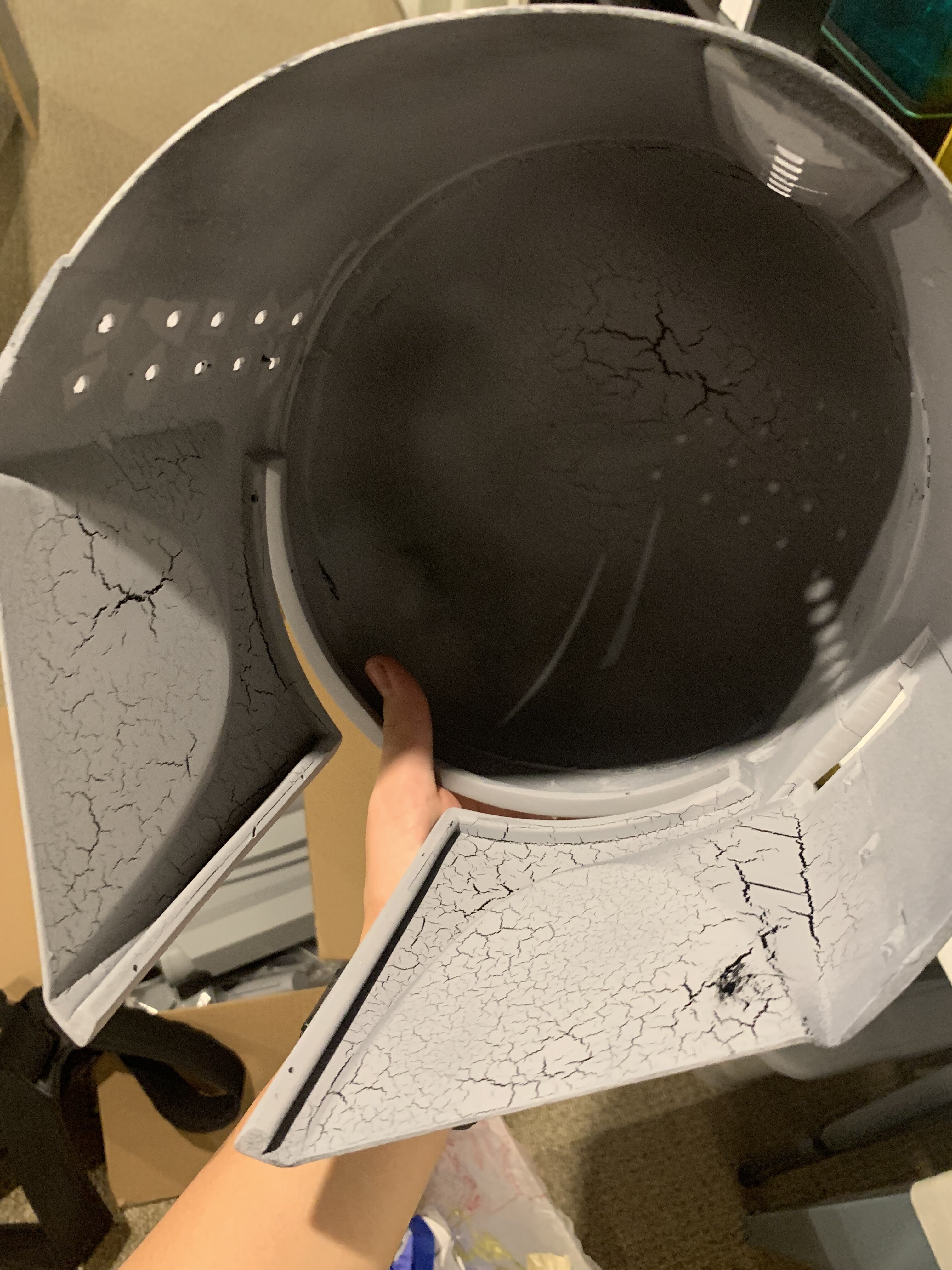

Repainting the interior of the helmet, since a ton of rub n buff smudged off on the inside. I first tried to prime it again without sanding but the coat got all wrinkled. So I used paint thinner and sanded then primed again, all good now.

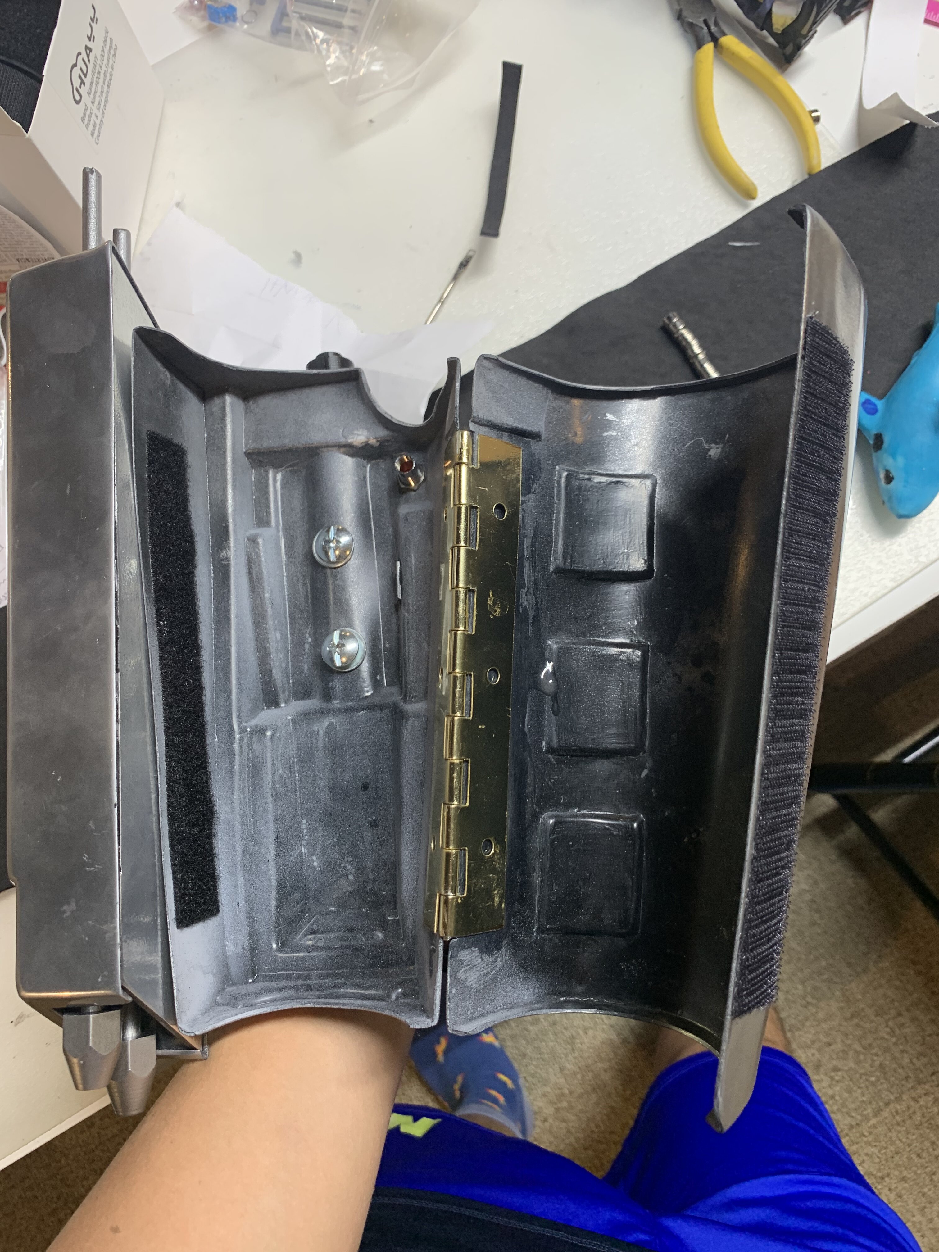

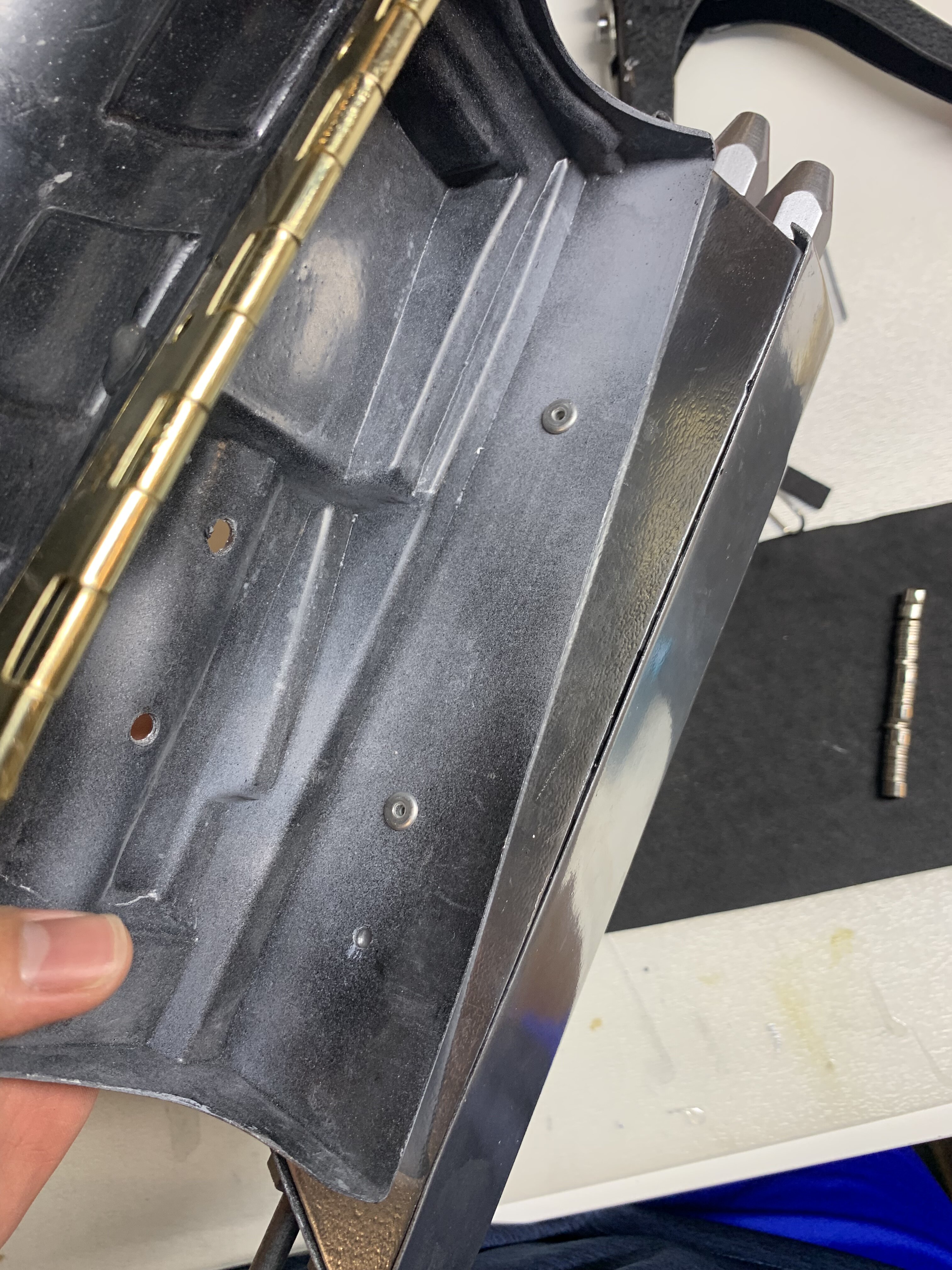

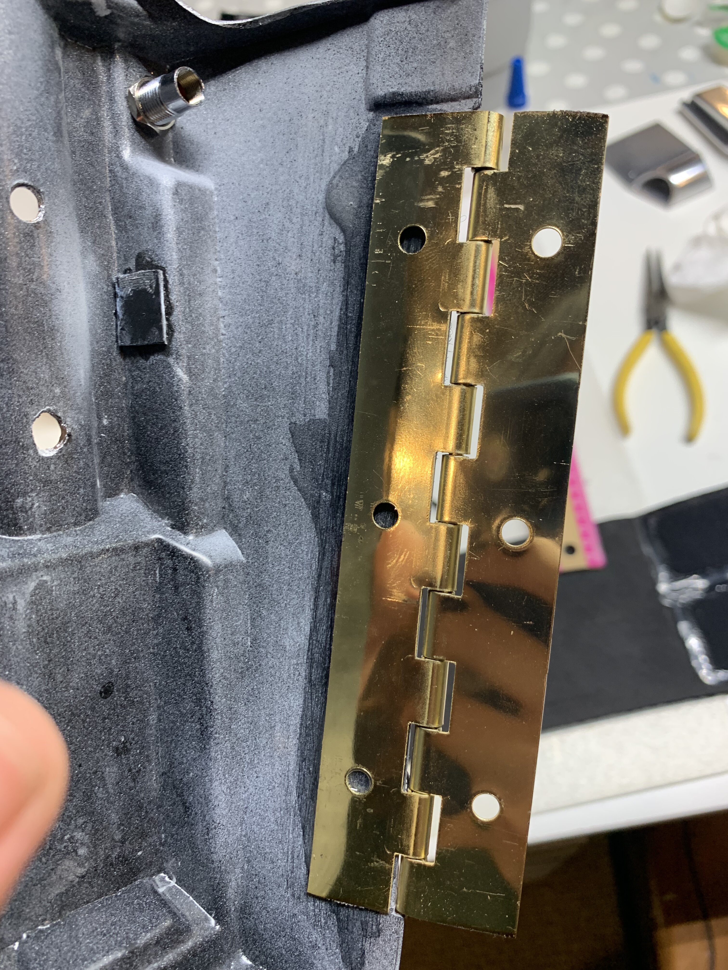

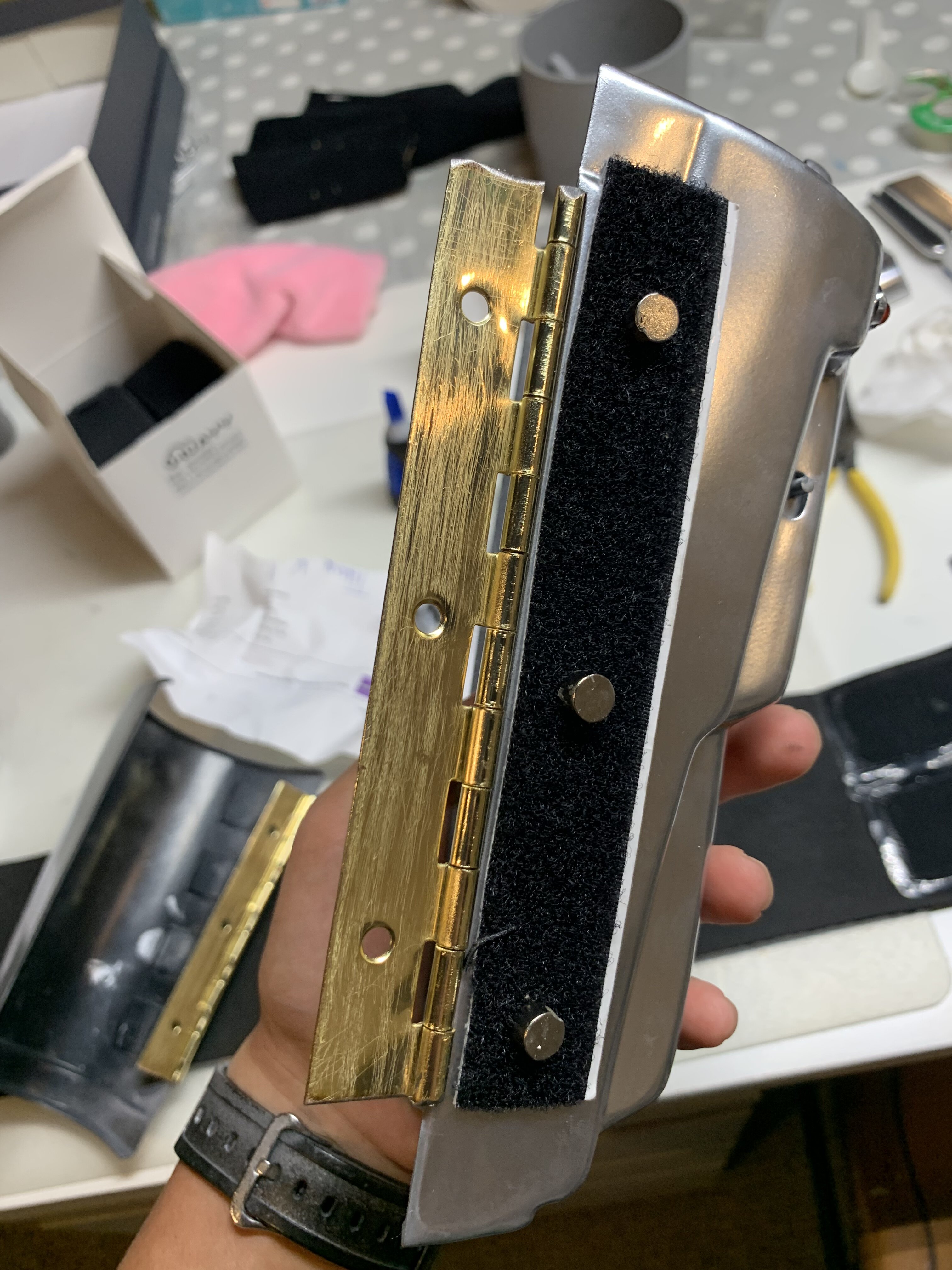

Epoxied the hinges on the gauntlets. Used a piece of soft Velcro to cushion the magnets I was using to hold the hinges in place. The magnets still left marks on the paint though.
Did the same for the opposite half of the left gauntlet, and epoxied the flamethrower box cover, then riveted the left gauntlet and flamethrower.
Installed everything else on the left gauntlet. Super happy with how this came out. Adhesive Velcro to close the gauntlet.

Finished the girth belt too. I incorporated the leather loop cover as part of the belt for simplicity. I think it worked pretty well.

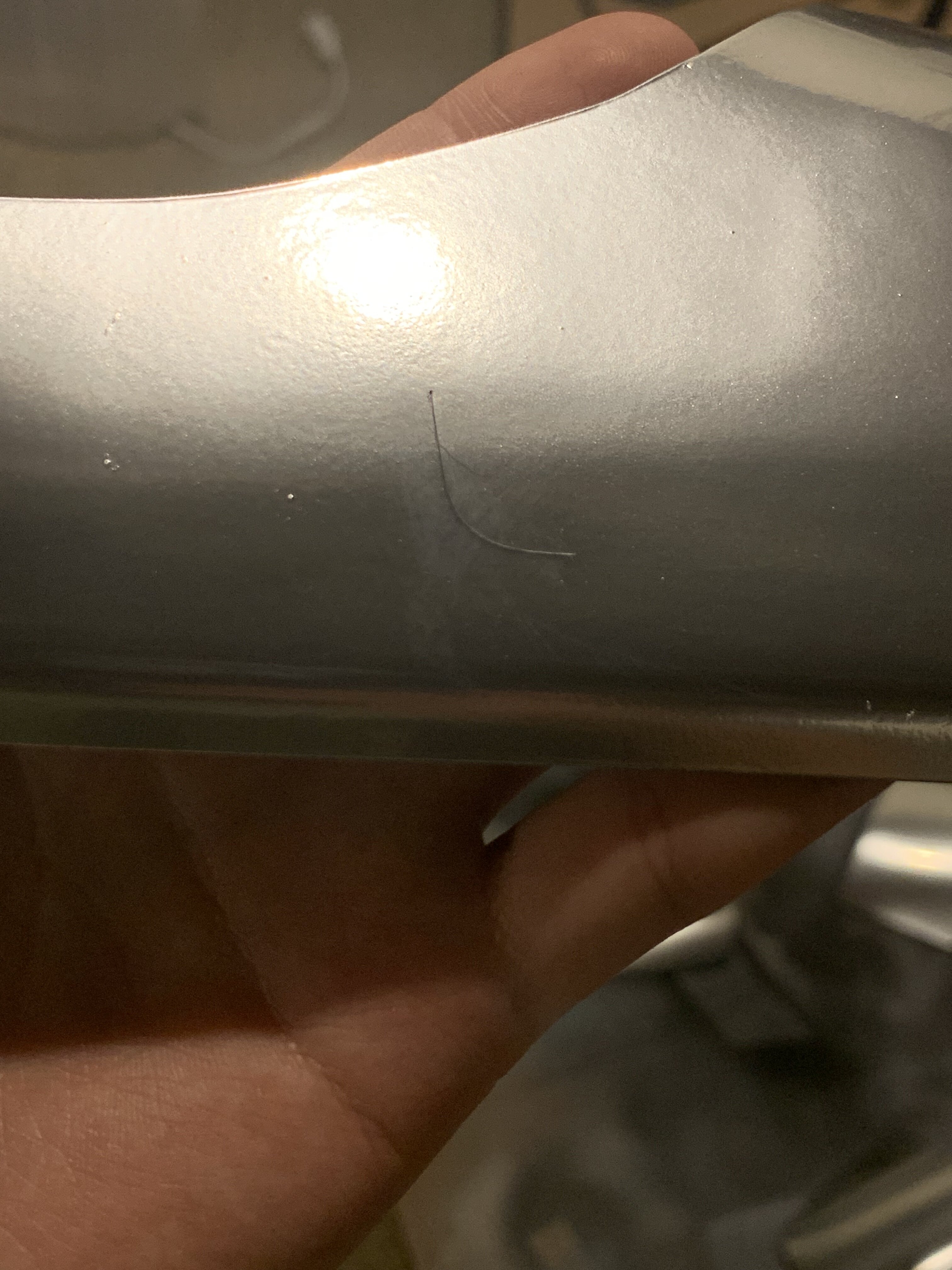

Had a few more big oopsies. A piece of hair got into the collar armor while I was spraying the silver paint.
So I sanded the piece down, and reprimed it.
However, when I reprimed it, the primer cracked still, just like on the gauntlet even though I cleaned it. I then realized it must be a paint reaction between the primer and silver paint.
Glued down the edges of the adhesive Velcro on the vest with e-6000 for more stability cause I noticed the Velcro would start peeling off when the armor was on it for an extended period of time. While doing this, I put the armor behind the vest to keep the vest flatter. However, the e-6000 bled through the vest and make marks on the armor.
