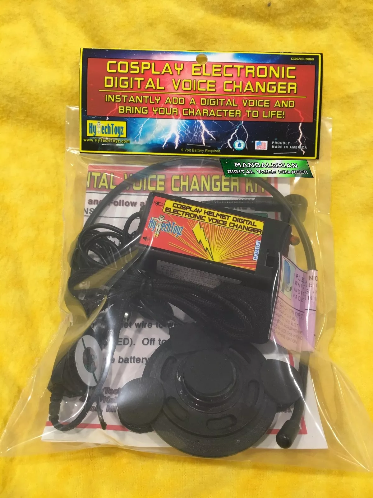

I just bought the Hytech Toyz "MANDALORIAN BOBA FETT HELMET VOICE CHANGER COSPLAY SET WITH SPEAKER & MICROPHONE" and it is very quiet. Do you guys have any tips for making this work for my Jango build? Is there anything I can get that might enhance sound? Pictures for reference.

Try testing other microphones to see if that's the issue. If it doesn't help then look to swap out the speaker for an amplifier. There are plenty of options on amazon, get something that is at least 10 watts.
I prefer higher but 10 will work. Jango unfortunately does not have large enough pockets to hide an amplifier well, so I attach mine to my jetpack harness under my flak vest.
Another thing that you can do is swap the speaker out for an exciter. An exciter is much smaller and can produce a lot of volume when used correctly. The face of it should be against a hard flat surface (like behind an armor plate or in the helmet) to resonate the sound. These work very well but will require some work to get it hooked up.

Thank you, I just assumed (what does assuming get anyone?) since it legit said it was for a Mandalorian helmet. Shame too because I can tell it was comfortable.
Thank you! I will investigate some of these, that's awesome that you have so much insight!
