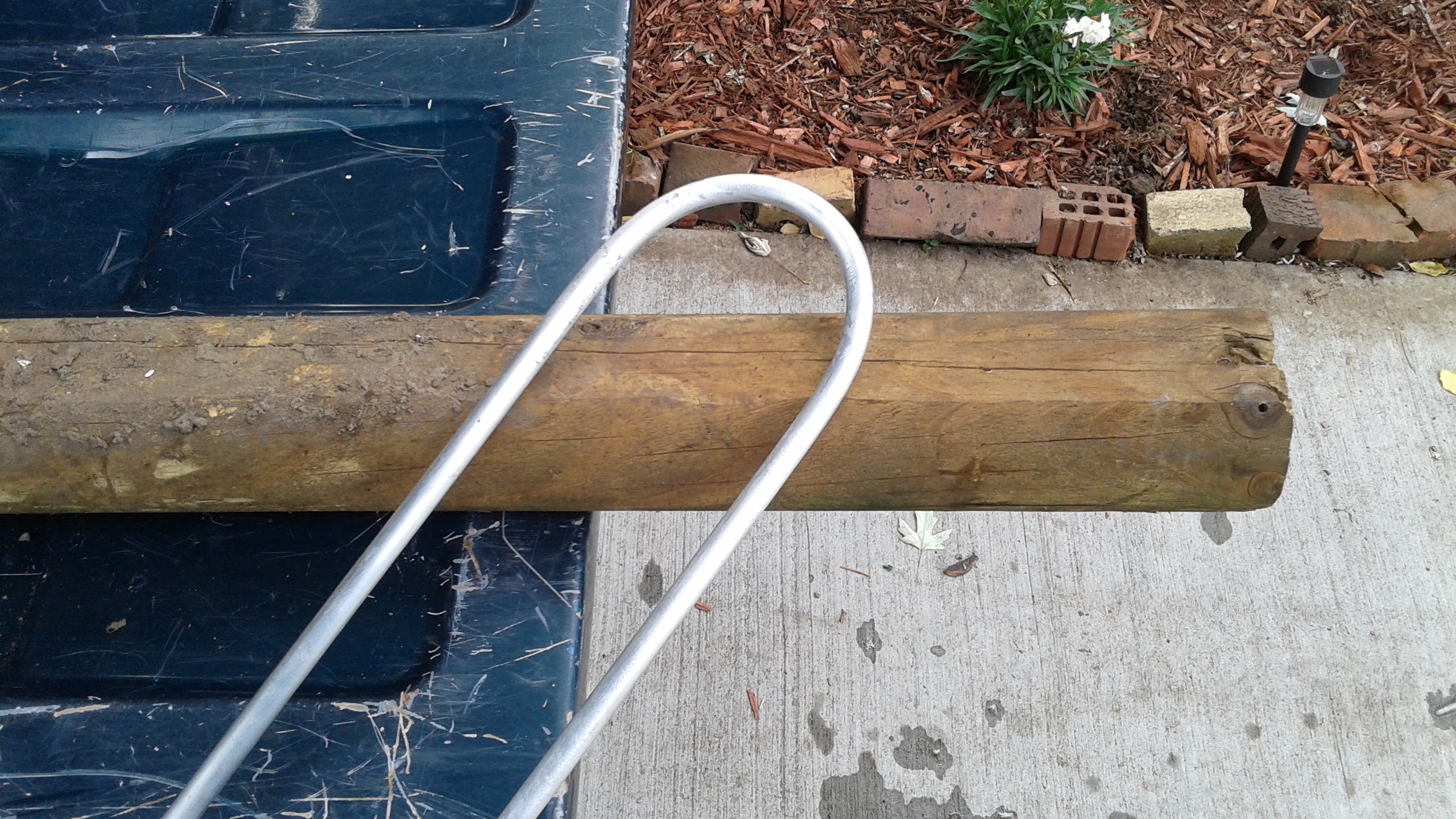

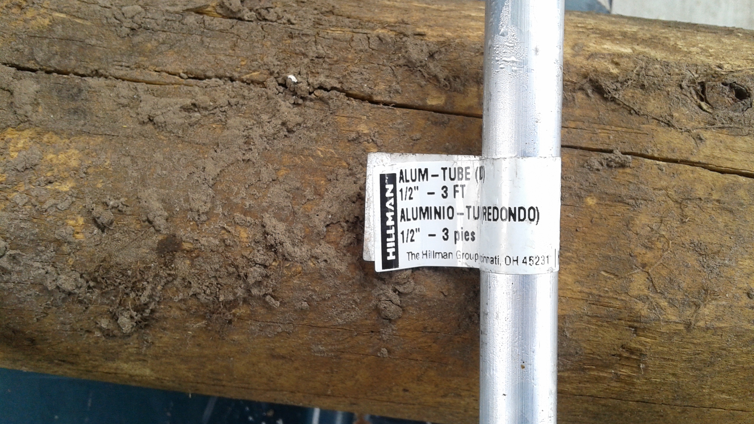

Purchase one Half inch 3' aluminum tube.

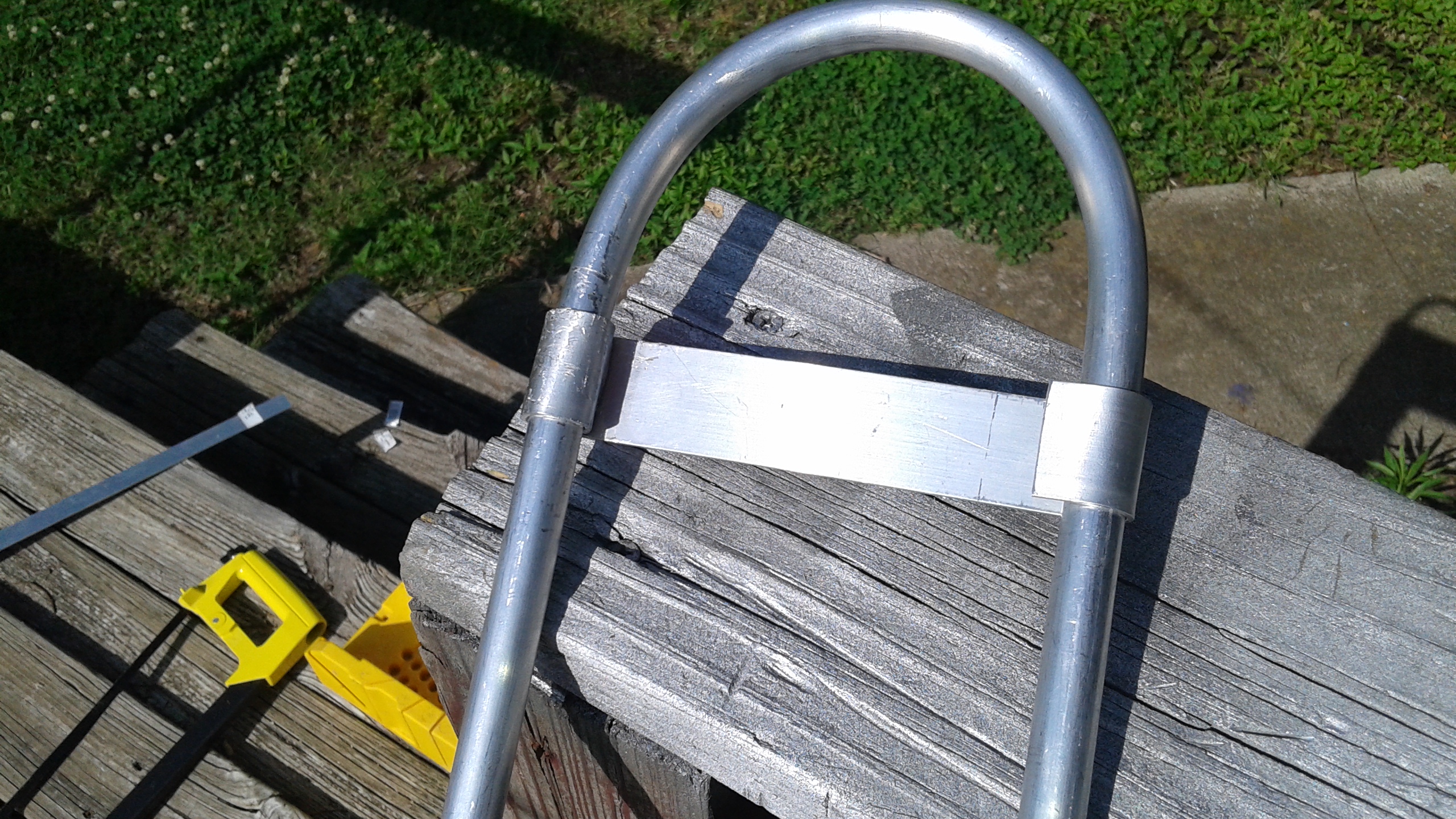

Plug one end and fill tube with water. Place in deep freeze until frozen. Next, bend around something, I uses a landscape timber. You need something that has the appropriate size for the harness bend, approx. 4".

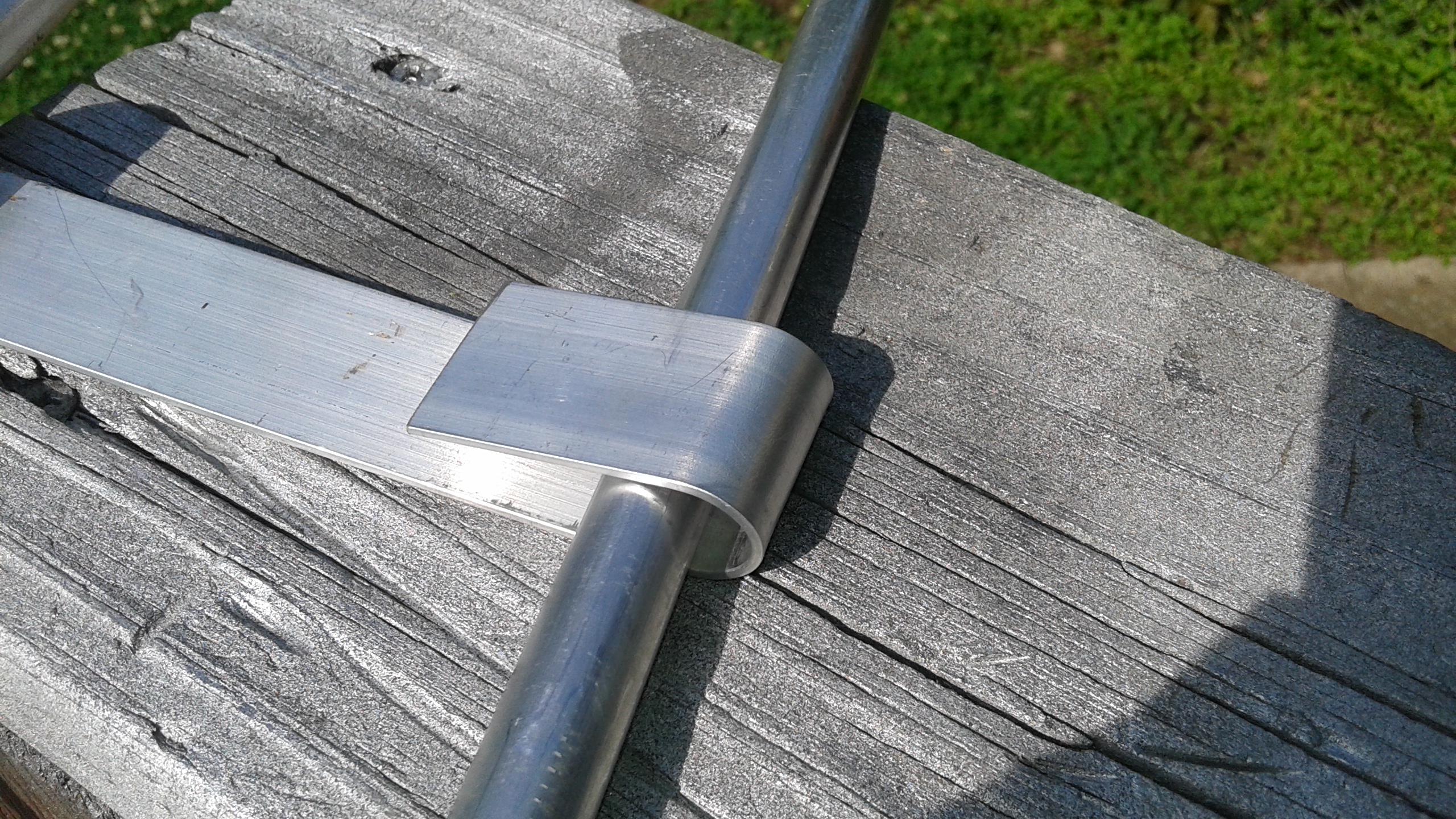

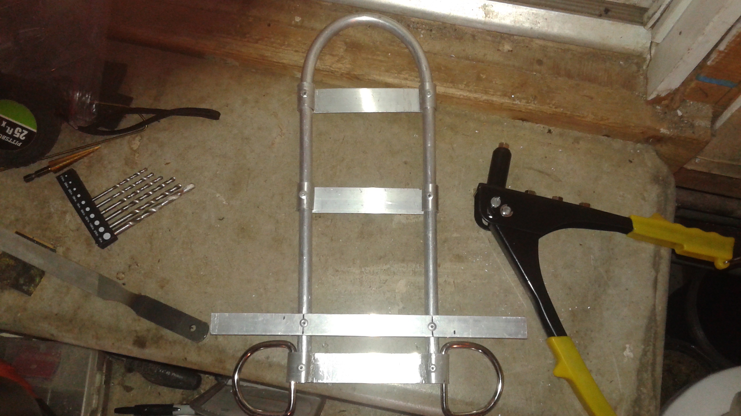

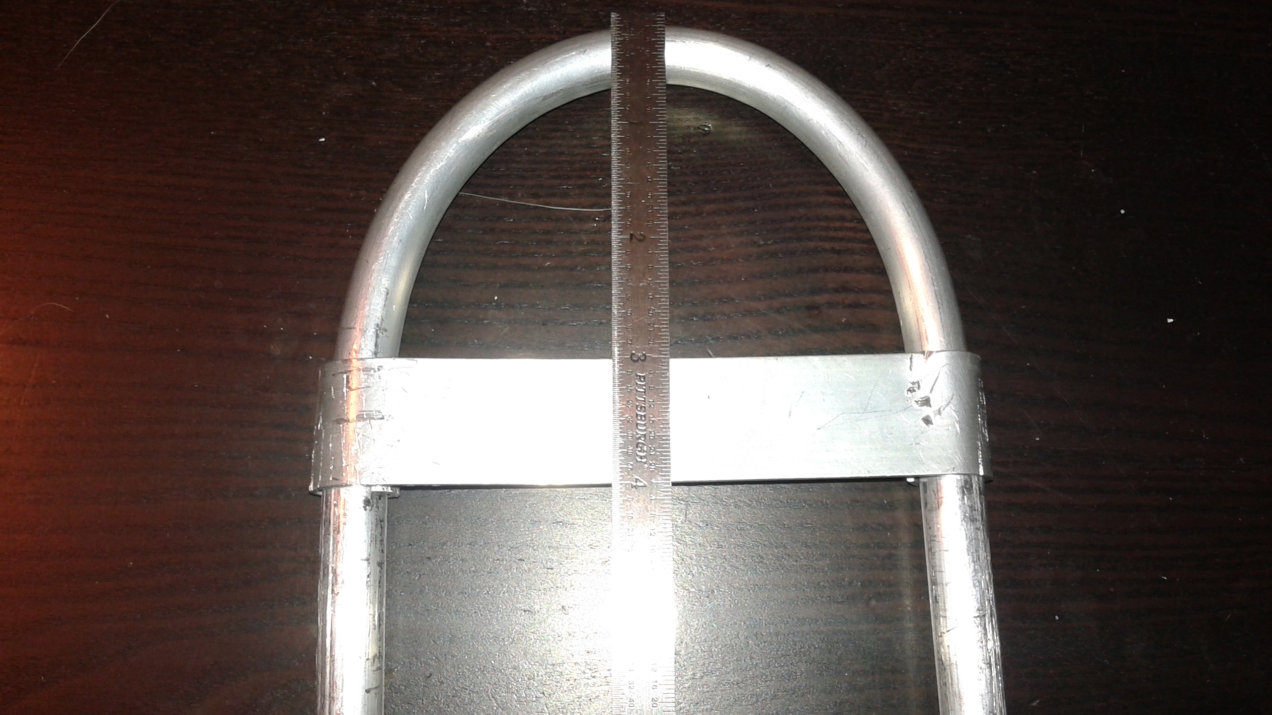

Now onto the cross bars. I know a couple of the cross bars are two inches, but I will worry about that later. I plan to use another set of 1" cross bars later to get 2". The aluminum used was a three foot section of 1" by 1/16". I chose 1/16" for ease of use and workability.
I went at this by making a bend on the "short side" first, leaving a bit extra to trim, and then bending the "long side" and cutting of the long end. No clue if this is how it should be done, but it worked.
I repeated this three times, crimping down the excess after trimming back toward the cross bars.

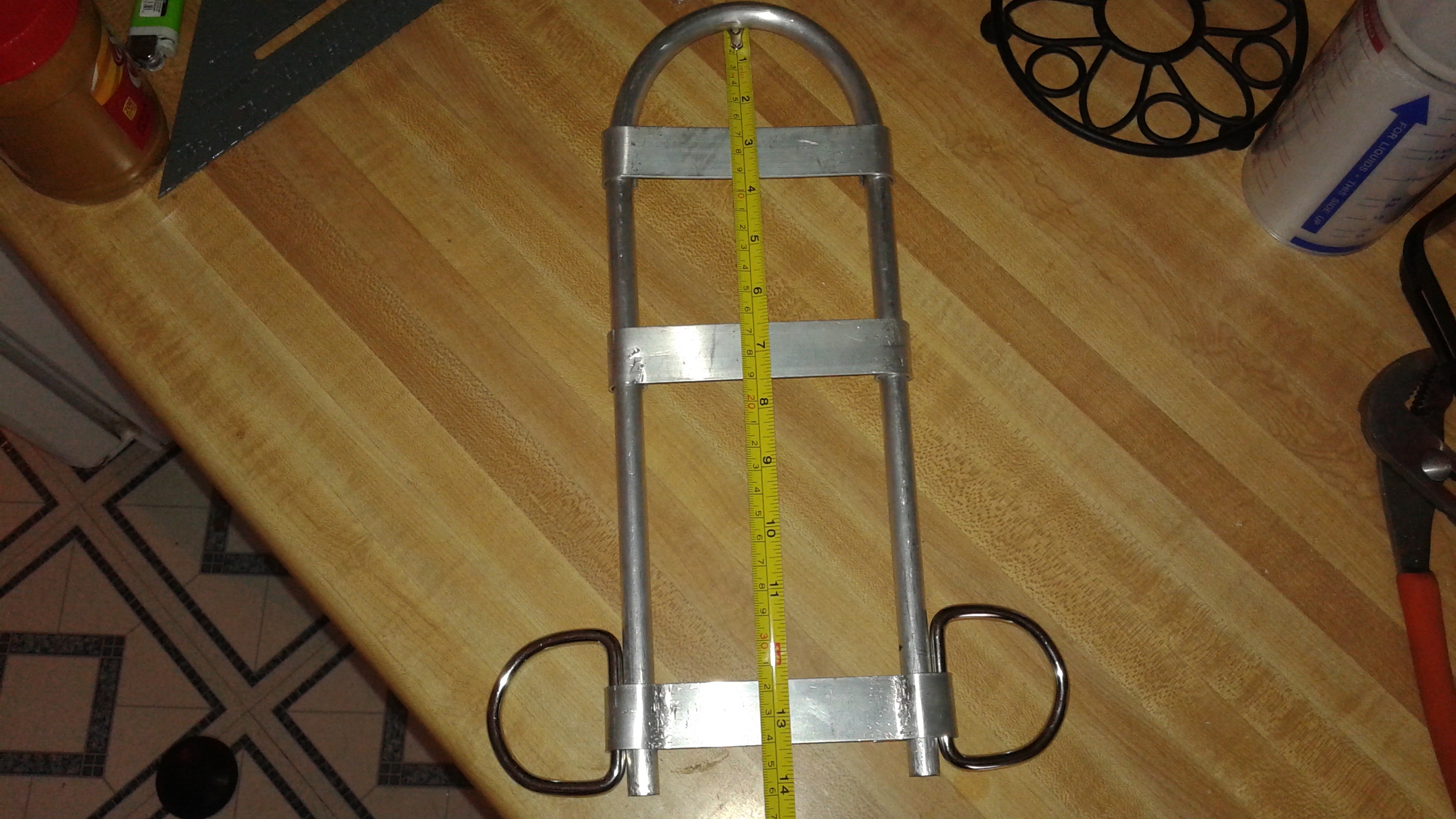

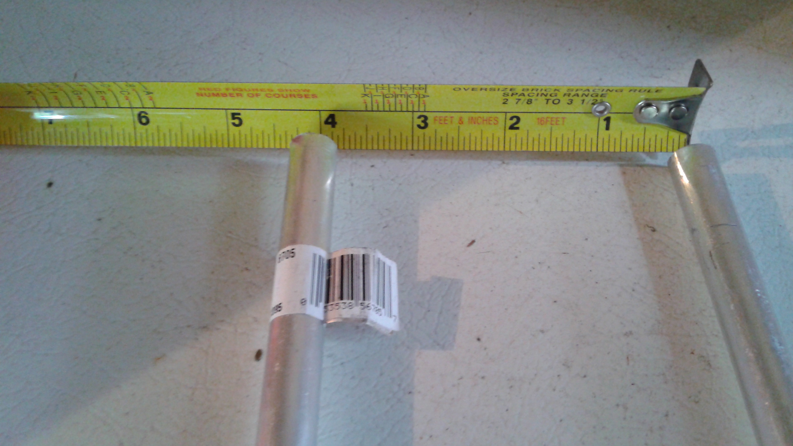

After placing the top and middle cross bars, I trimmed down to 14" in total length.

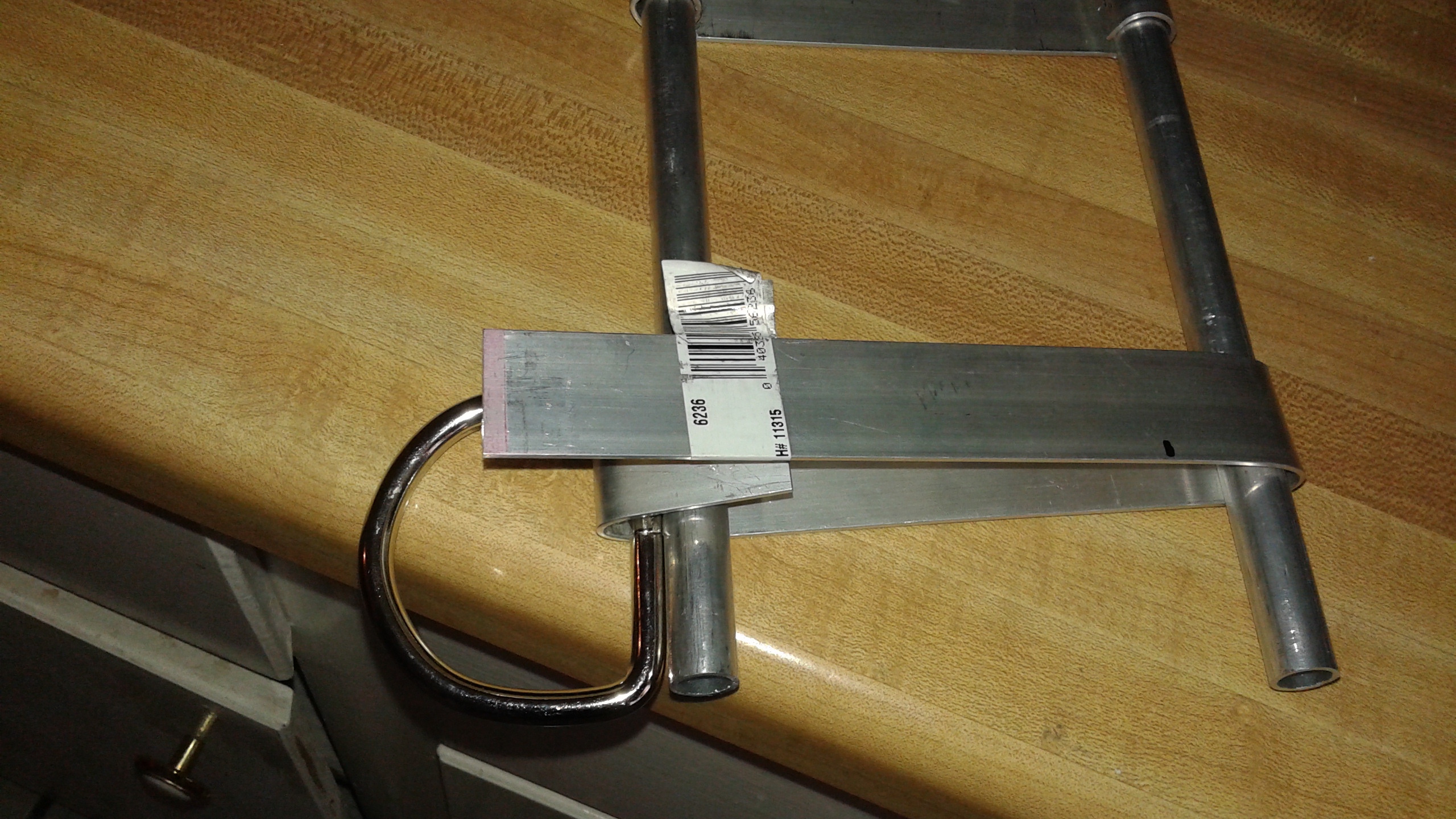

The bottom cross bar, I added in 2" D rings, which I had on hand already.

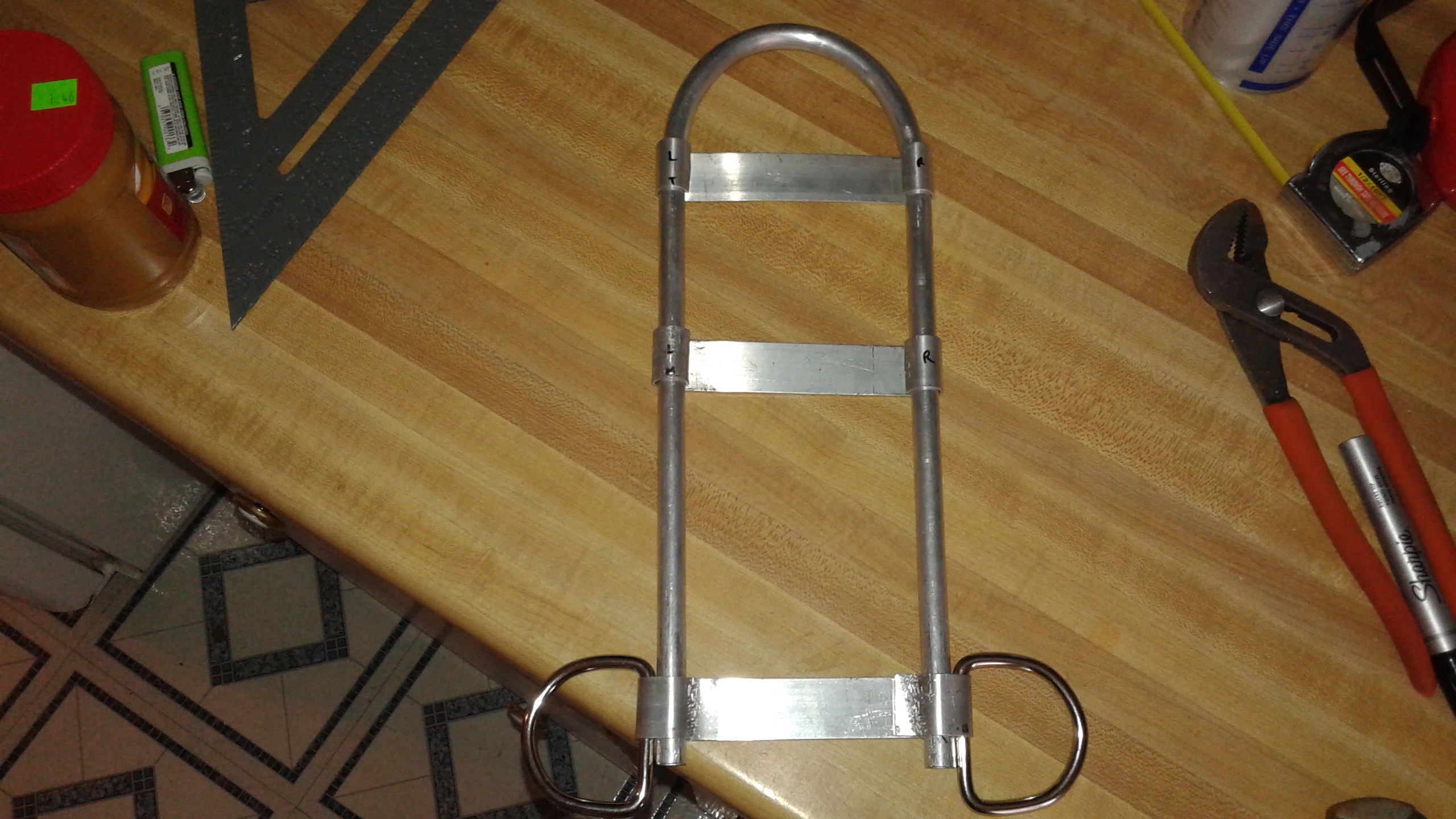

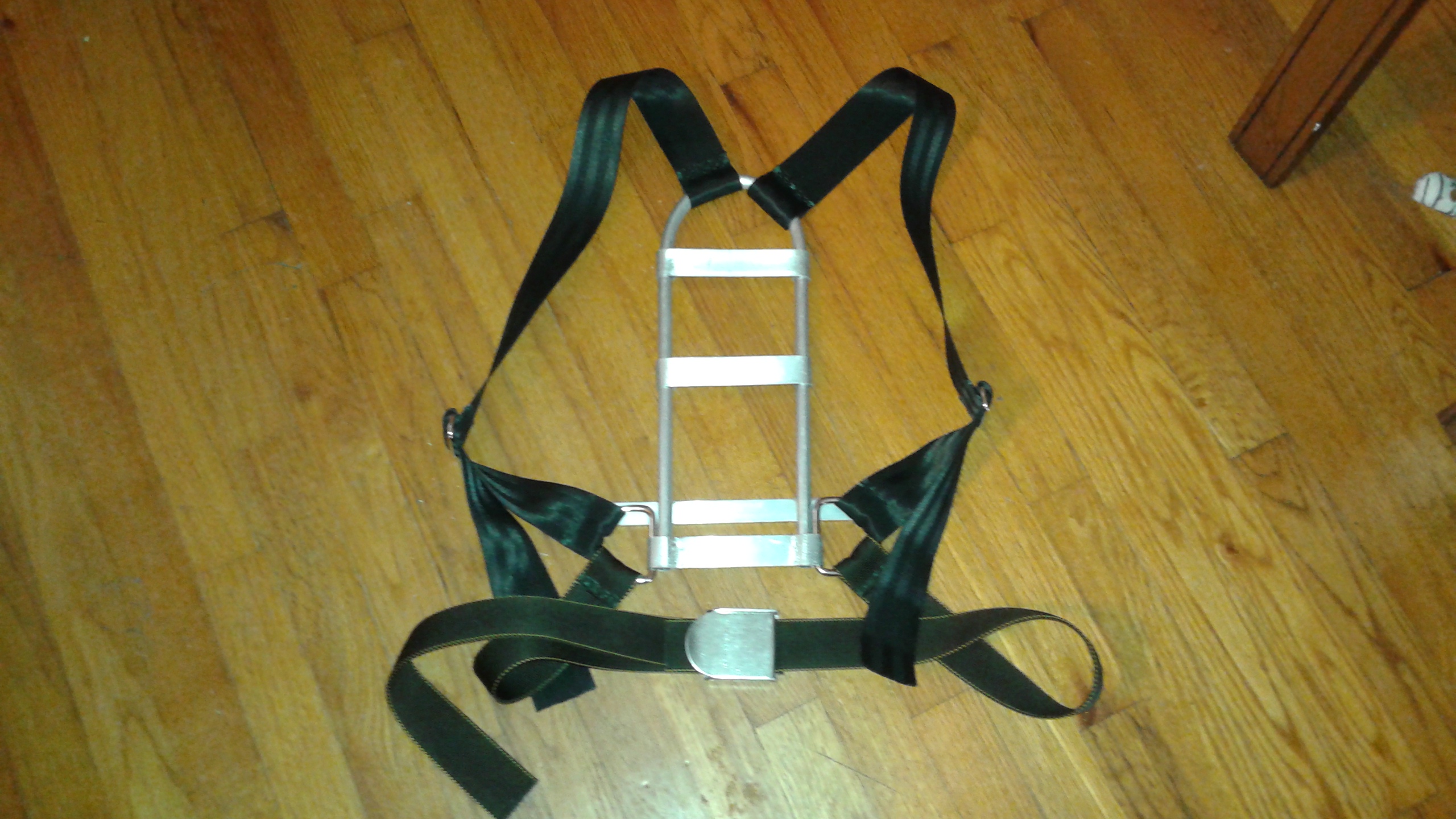

And here is what I came up with, less the 3/4" aluminum bar (purchased and included in $20 spent) for connecting to jet pack clips.
I would say it's a bit phallic without the offset rectangular D rings.
This can certainly be improved, specifically with 2" cross bars among other things... Still, I wanted to see what could be done on the cheap.
