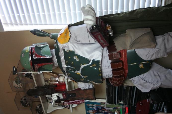

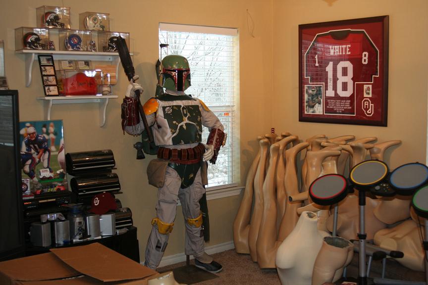

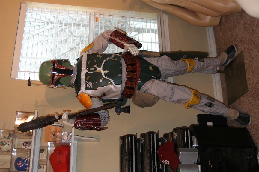

I am diggin all the poses you are getting out of these. Great work buddy. I can't wait to get to work on mine. Hopefully the end of next month I will get started.

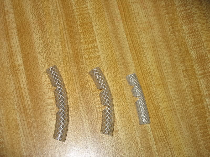

Here is a little preview on the hands I am working on. First I cut the hose into finger lengths and cut the "v's" for joints-

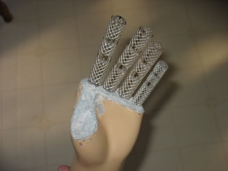

Next, cut the fingers off the hand and fiberglass filled the hand. Then drilled holes for the coathanger wires-
Then, put the fingers on the wires.-
I am actually a little farther now. I have the thumb on and glued all the fingers at the base and tips with Goop. I am going to shape where the fingers meet the hands a little, and round the tips of the fingers, so they look natural in the glove. I can get quite a bit of dexterity with the fingers because of the joints. I will have more pics up soon, as soon as I get the hand finished up-
