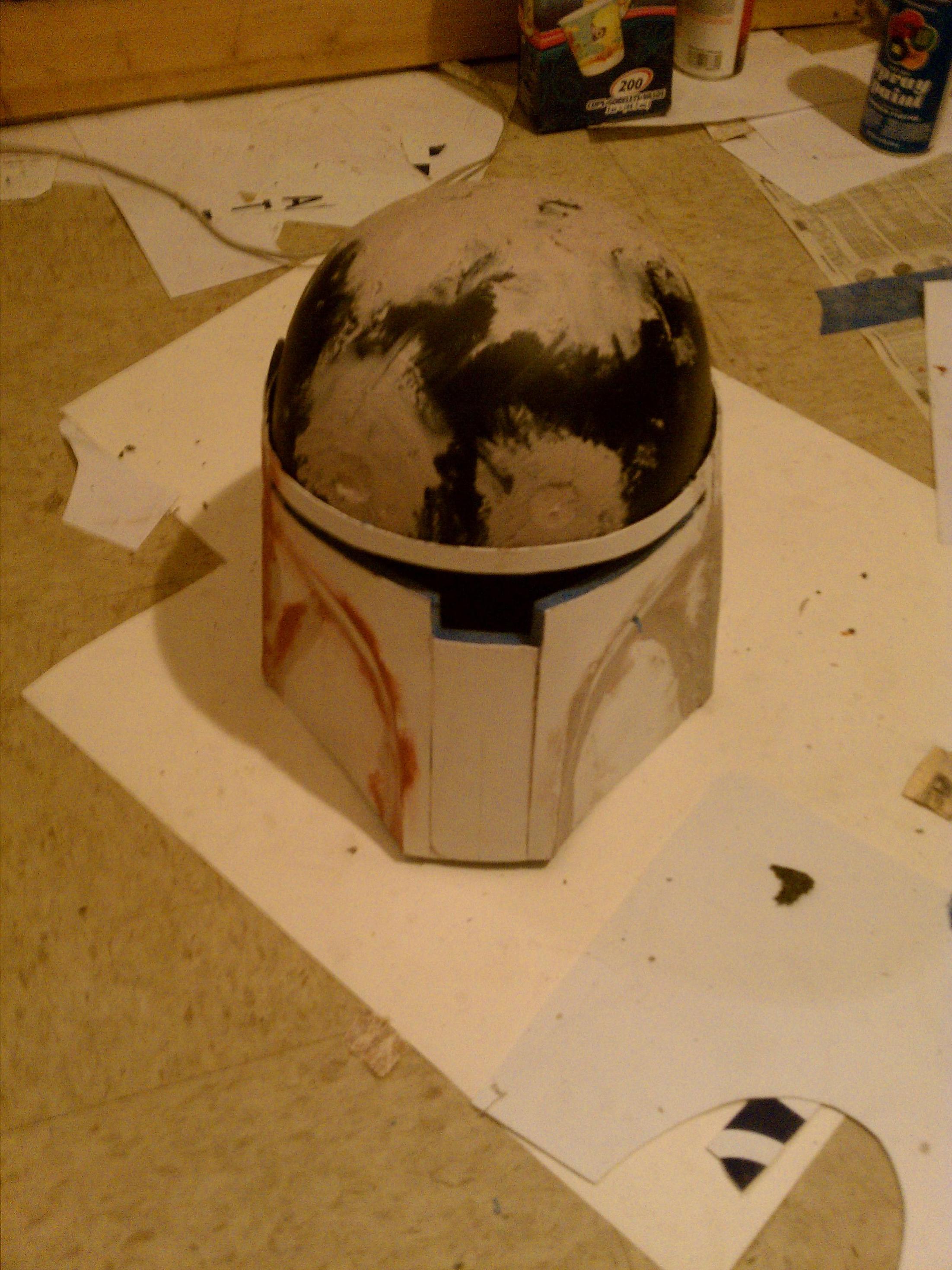

Thanks sooooo much for the template! Here's my prototype using the biker helmet idea. I used handicapped parking signs for the plastic. I still need to do a bit more bondo work on the dome then sand it down. (I was playing around with some ideas thats why the face has the T partially blocked.
Childrens Medium I think (it's from walmart) the only thing I don't like about it is the back slopes a bit downward on this helmet. My next ones i'm going to see if I can find anything else to use.
