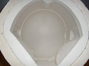

Finally got round to moulding the potty! Heres a pic of the skin mould sat in its two piece jacket, the T20 silicone rubber just peeled straight off the master leaving it intact, phew. (i had visions of having to break it up ) Luckily the T20 is very elastic:thumbsup: In 48 hours time (when its properly cured) i should have a cold cast aluminium bucket...........to start painting

Yeah lovely work. (I'll not gush :p) I'm about to work a custom helm design and was going to mold cast as well, but I needed to see someone else's work for a mental reference. Thanks so much for the rundown of your process.
I do have a question, I see you have a rubber mold above, within what looks like plaster (or harder casting stone). I would love to know how you did it, in specific, in which order did you cast the silicon, stone and did you use a frame for the stone?

Its a very simple process , your master is first painted over with silicone rubber, in the case of my mould, i used a one piece 'skin mould'. This is ok as long as there are no serious undercuts. This leaves no issues with lining up a two piece rubber mould. The jacket is casting plaster reinforced with scrim, its two piece with a join running front to back. I would recommend finding a publication on these processes, or better still, a sculpting supply shop, they will offer the best advice. Also start with casting something small and get the feel for the process as these materials can prove expensive!
