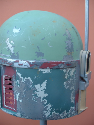

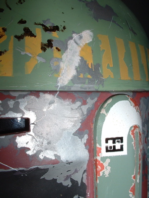

I've just added some weathering at last, no coffee, this didn't work:( (but the tar did:) ) So i started by collecting random sized flints from the garden, these proved usefull for scratching through to the gel coat, because they're awkard to hold, they make unpredictable marks, thus less uniform ( but also difficult to emulate the original!) Then i used a badly adjusted air brush to give mist/splatters in the base grey, then mixed down with a mid brown to do the mandibles and r/h side. I then used this same mix applied with a cotton bud for the rust spots, and flcked over the r/h ear. I found a pea size piece of bitumen, soaked in white spirit and dabbed/ drawn over the kill stripes to recreate the, er, bitumen thats dabbed and drawn over the kill stripes( i'm sure thats what this is) Just the symbols and crack/repair to go...

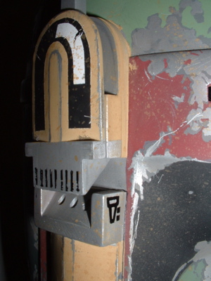

Finally added the symbols/markings. Using a fine point marker, i drew them on freehand, however the ink dosen't seem to be drying! The crack was dremelled with a compass point, then repaired using car body filler. I think i may still have to add some more weathering...

TF,
Do you happen to know the dimensions for placement of the borden connector in relation to the cheek bottom and the upper cheek. What are the dimensions for the connector itself -OD as well as the drilled holes? Planning on scratchbuilding one and want to be sure on the placement before I drill. Do you have dimensions on the small rectangular indent on left upper cheek also? Last two details I need to add to bucket.:thumbsup:
Hi SD, i used a piece of 10mm tube for the borden, the three holes were guesstimated and were filed until they looked good. As for placement, the best option is to line it up by eye with a scaled ref. pic. until it looks good! ( sorry, not much help really) The slot on the L/H cheekbone is approx 9mmx4mm, its paralell to the line of the mandible and on my sculpt is approx. 5mm from this edge and 75mm from bottom to the base of the mandible(:confused ) Oh and watch out for the step in this slot, only obvious in one of the ref. pics!
