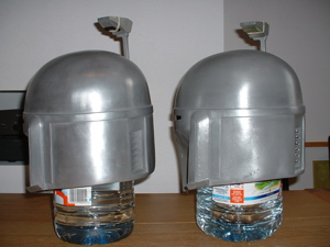

Yes, i've used three Gel coat layers of alu. resin, backed with two fibre glass tissue layers. this provides a good solid coat on the outside,with a rigid, lightweight and smooth internal surface....

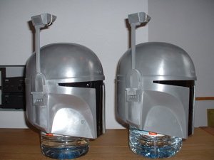

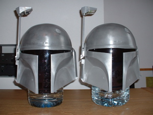

OK. Heres the ESB and ROTJ versions with hardware attached. I've got the whole bank holiday weekend to get these painted, wish me luck!

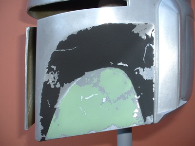

I managed to start the ESB colour scheme. I went straight on with art masking fluid on the left cheek, painting out all the silver. Then air brushed on my base grey. Peeled it all off, then masked off the lower cheek, then painted out silver and grey areas. I then air brushed on the green. I repeated this for the upper cheek. Although some of the details are slightly out, its a quick way of working and you can pick out some of the silver scratches with fine grey outlines; these would take hours to paint topicly. This works fine with a couple of colours but im not looking forward to attempting the back!!
i was gonna paint my next helmet this same way and work layer by layer, masking as needed. this helmet would be perfect for that since you are starting with a silver helemet.
since you can mask for the chips, then apply the scratches to the final paintjob (w/o worrying about scratching through the silver) I think the quality of paintjob with this layering technique will be second to none. In easier terms the topical painting should be minimal.

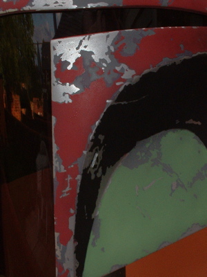

I've just painted the mandibles and brow using the same layering technique as the cheek. Starting with the grey, then purple and red. Masking the silver first, then spraying grey, i peeled off the liquid mask then painted it back on covering silver and grey areas, then air brushed purple. Leaving the silver and grey mask on, i liquid masked the purple areas, then sprayed the red. This technique gives details i could never achieve with a brush and also a slight releif to the paint which adds to the chipped look.....and no brush marks....
Ah, the paints! Well, they're Humbrol enamels. I'm trying to use stock colours, the only one i've had to custom mix so far is the purple, i love these paints, they're very.....errr, hard wearing...
