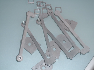

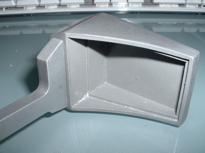

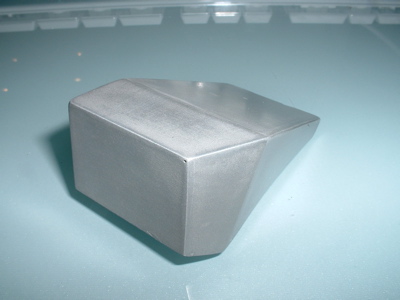

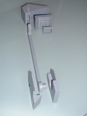

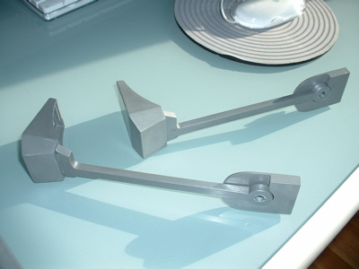

thanks for the comments. i' m still beavering away on the details, havent had a chance to mould the potty yet but heres the cold cast aluminium parts ive done so far! ( thanks to sss excellent tutorial, although its been adapted for casting )

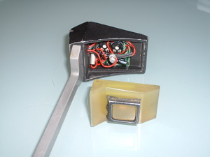

Just a quick update on my scratchbuild. I've just cast the clear resin piece and installed a basic led kit i modified to include a blue/white screen light. The kit included two adjustment screws for led speed and alternation and by a total fluke just snapped into place! I couldn't find a mercury switch so have installed a basic bearing tilt switch, seems to work just fine. I'm still tweaking details on the helmet and hopefully casting soon......

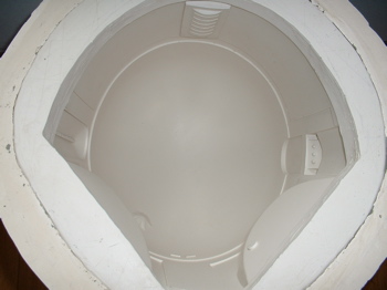

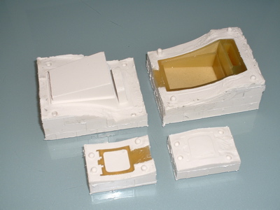

Finally got round to moulding the potty! Heres a pic of the skin mould sat in its two piece jacket, the T20 silicone rubber just peeled straight off the master leaving it intact, phew. (i had visions of having to break it up ) Luckily the T20 is very elastic:thumbsup: In 48 hours time (when its properly cured) i should have a cold cast aluminium bucket...........to start painting
