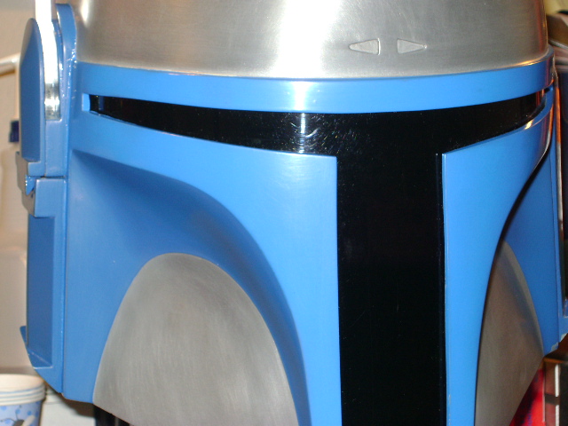

I ordered some black 3/32" pinstriping tape from our local auto paint store. Should be in on Friday.

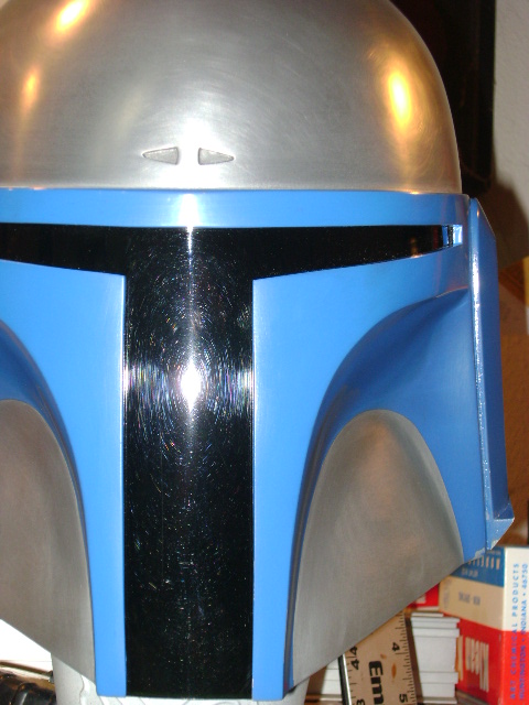

I also took some fine steel wool to the blue painted areas. It did a great job of getting rid of all the little dust specks. Then I polished everything back out with some medium rubbing compound. I think it looks much better than the original high gloss.
For all of my previous helmets where I Rn'B'd, I usually gave the entire bucket a coat of Rustoleum Royal Blue to make the entire helmet surface nice and smooth. Then on top of that I would tape off and paint the Krylon Ocean Blue, and Rn'B last. I would use 1/8" plastic auto striping tape for the check/mandible areas because I think it produces a nicer and sharper paint line, then I would apply the easy release 3M blue tape to that. I would also tape off the silver cheek areas before lightly sanding and Rn'B them...that way the Rn'B stayed where it was supposed to. So basically my last step in painting a helmet was Rn'B. I think most people Rn'B first though.

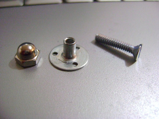

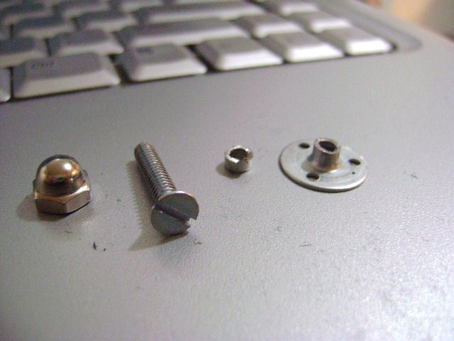

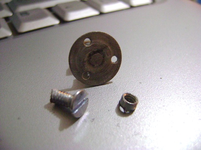

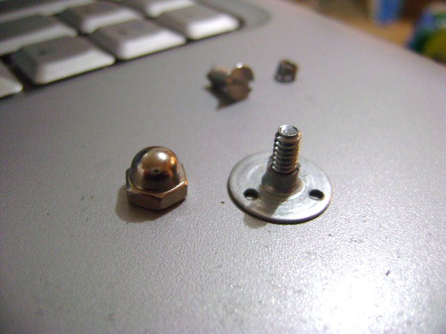

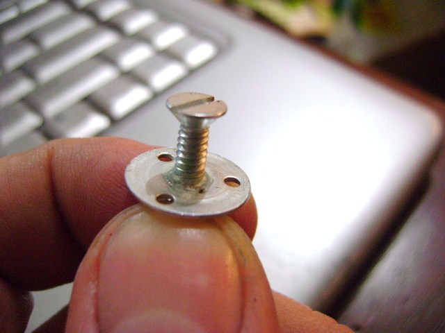

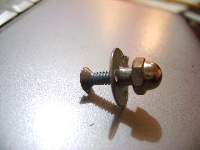

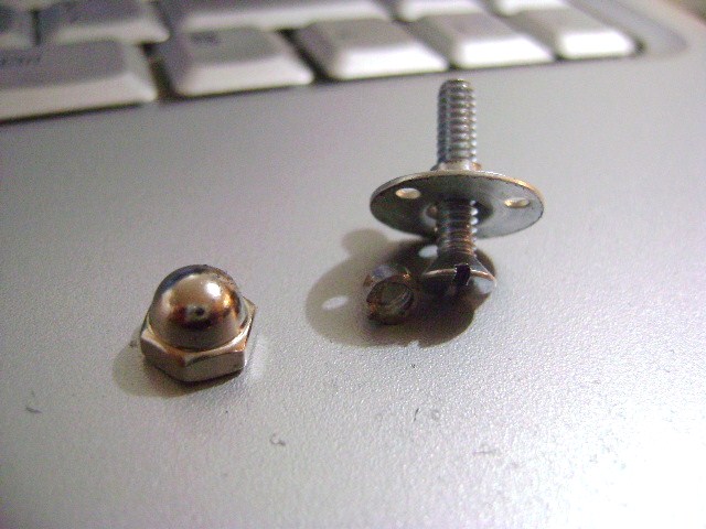

As for installing the visor. I tried something for the first time on this one and I think I like it over anything else I've ever tried. I got some 6-32 anchors, some 6-32 flat head screws, and some 6-32 acorn nuts (all found at Lowes). First I cut half the anchor stem off. I then threaded the screw through the bottom of the anchor. I put the acorn nut on the screw to where it bottomed out. I threaded the anchor to the acorn nut. I turned the anchor upside down and applied a small amount of CA glue to glue the screw in place. I then cut the excess part of the screw away and sanded smooth the bottom of the anchor on some 120 grit placed on a flat surface.............and viola! They are the perfect height for a welding visor when a flat 8-32 washer is used.:thumbsup::thumbsup:
Hope that description and the pics help.:)
