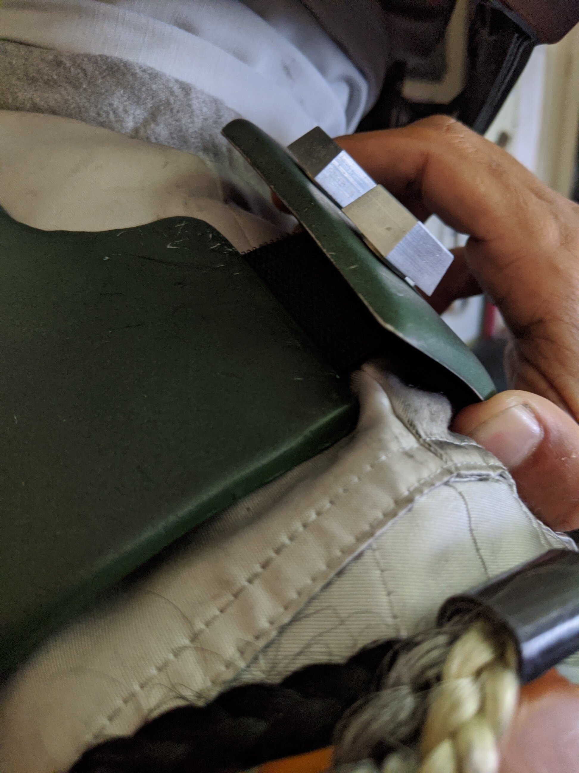

The armor plates is my biggest worry. I am happy with the placement on the vest. Everything looks fine when I only wear the vest and plates. But there have been some issues and head scratching.
First: The nuts I have are really lousy. The threads keeps ripping, and I constantly have to replace them. I had 20-30 spare nuts when I started. Now I have 2 left. New (and hopefully better) nuts are in the mail, but shipping these days takes forever. Because I have to make due with the nuts I have for now, I left them loose fitting when I mounted the armor plates. And, of course, I forgot to thighten them I did the photos for my submission, making the plates move and look aweful.
Second: When I mount the backplate and jetpack, the collar gets pulled up and start digging into me. It is very uncomfortable, painful even, and it messes up the vertical distance between the chest plates and the collar. I have reposition the screws a bit and added some padding under the vest. If I'm correct (and if those blasted nuts can hold on!), this should keep the plate from getting pulled up too much. But I won't know for sure until I can wrangle in some help putting on the jetpack.

for the jet pack collar pull problem, here is what i did
stick some the soft loop velcro to the underside of collar and back plate, you'll
attach them with a strip of the hook velcro.
hook on jetpack before you velcro together the collar and backplate
then kind of pull up the back plate closer to the collar, the JP will keep it
there, then attach the velcro. also, sometimes the bars at the bottom of the harness
will pull the vest downwards if you got it going thru the slits of the vest
hope this helps
