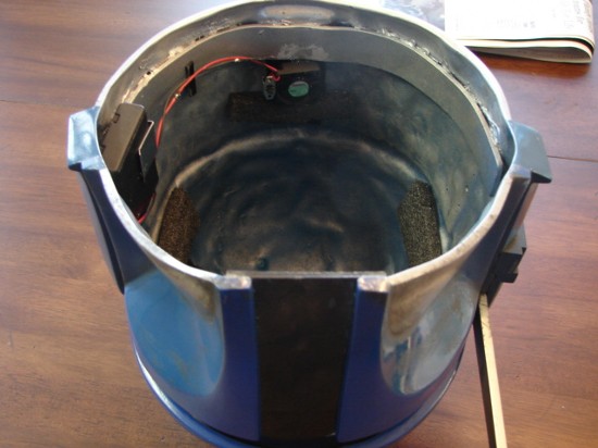

But before you proceed any further, I would recommend reinforcing the back base of your helmet with a strip of 3/4" wide aluminum stock so you can give you helmet a decent shape and to give it some sturdiness so any movement of the helmet doesn't start cracking your new paint job.
Just my opinion but I'd hate to see your new paint job runined because the helmet starts bending too much. Here's a pic showing how I reinforced a Rubies. You can use some 2 part epoxy Platic Welder from walmart as your adhesive since it's somewhat flexible and will give a little with your helmet.
