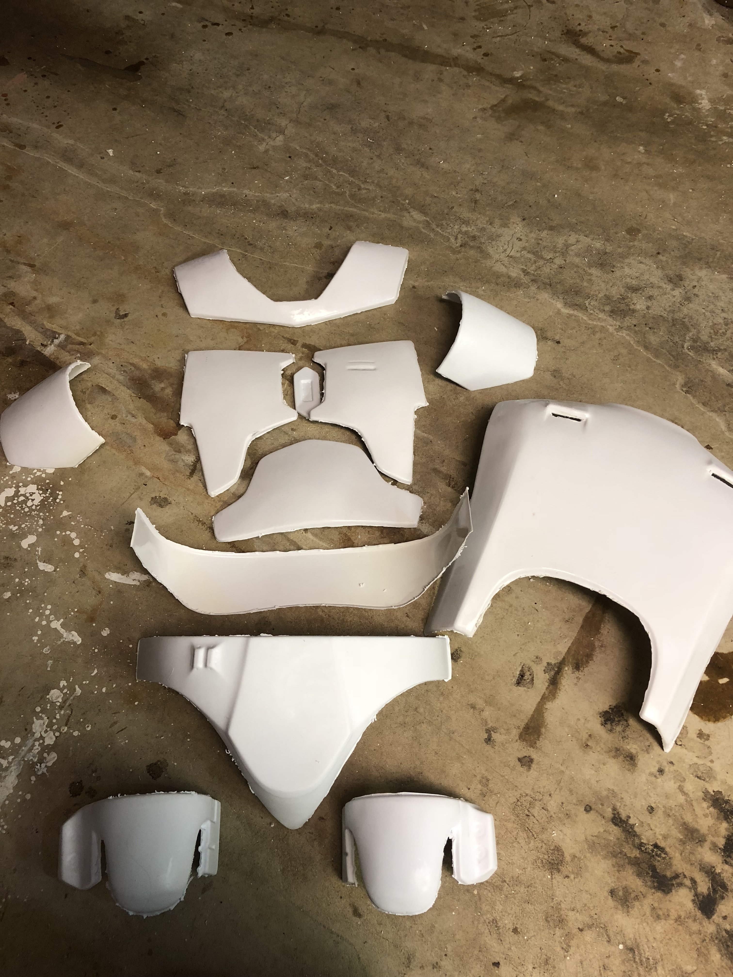

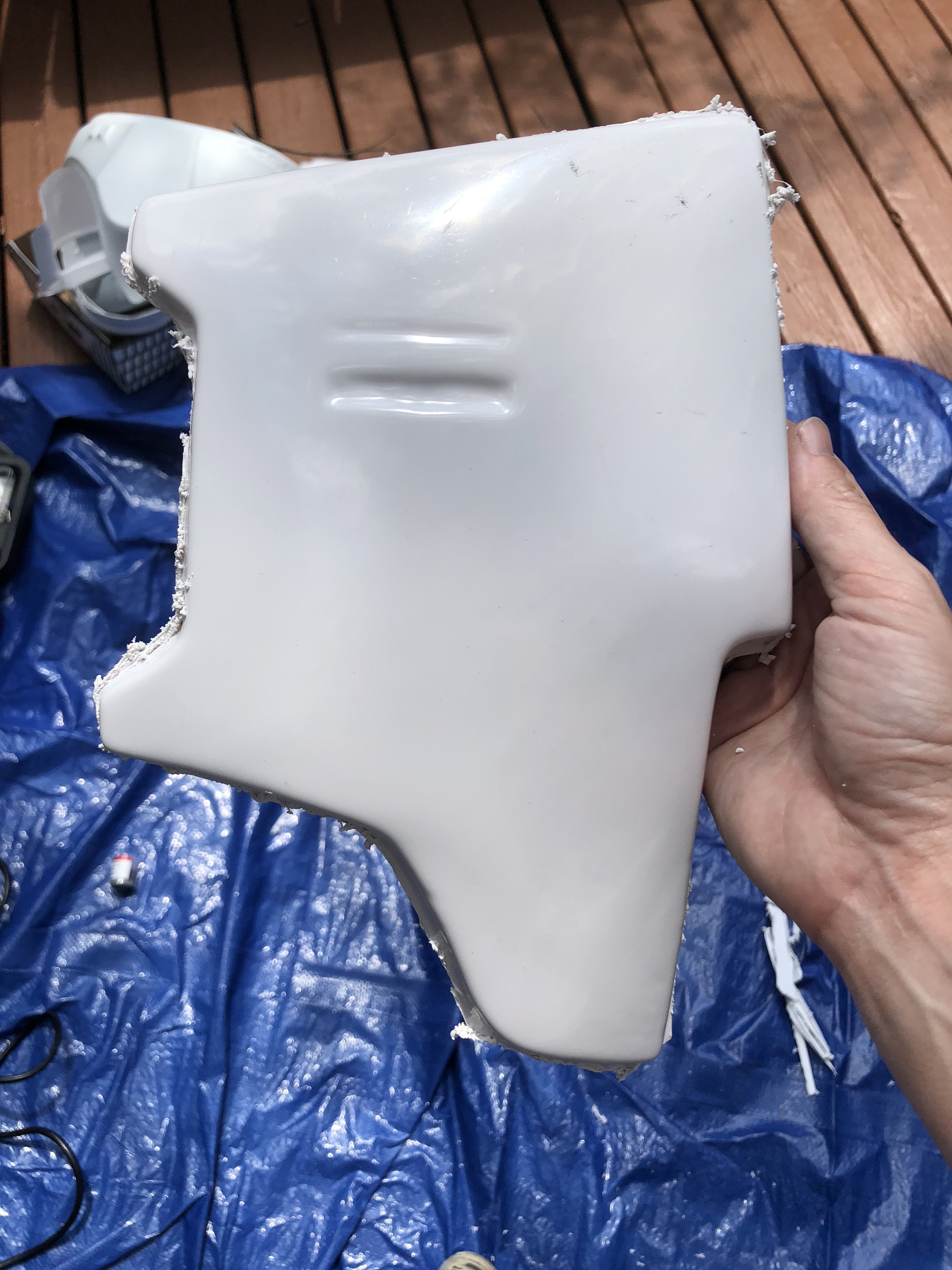

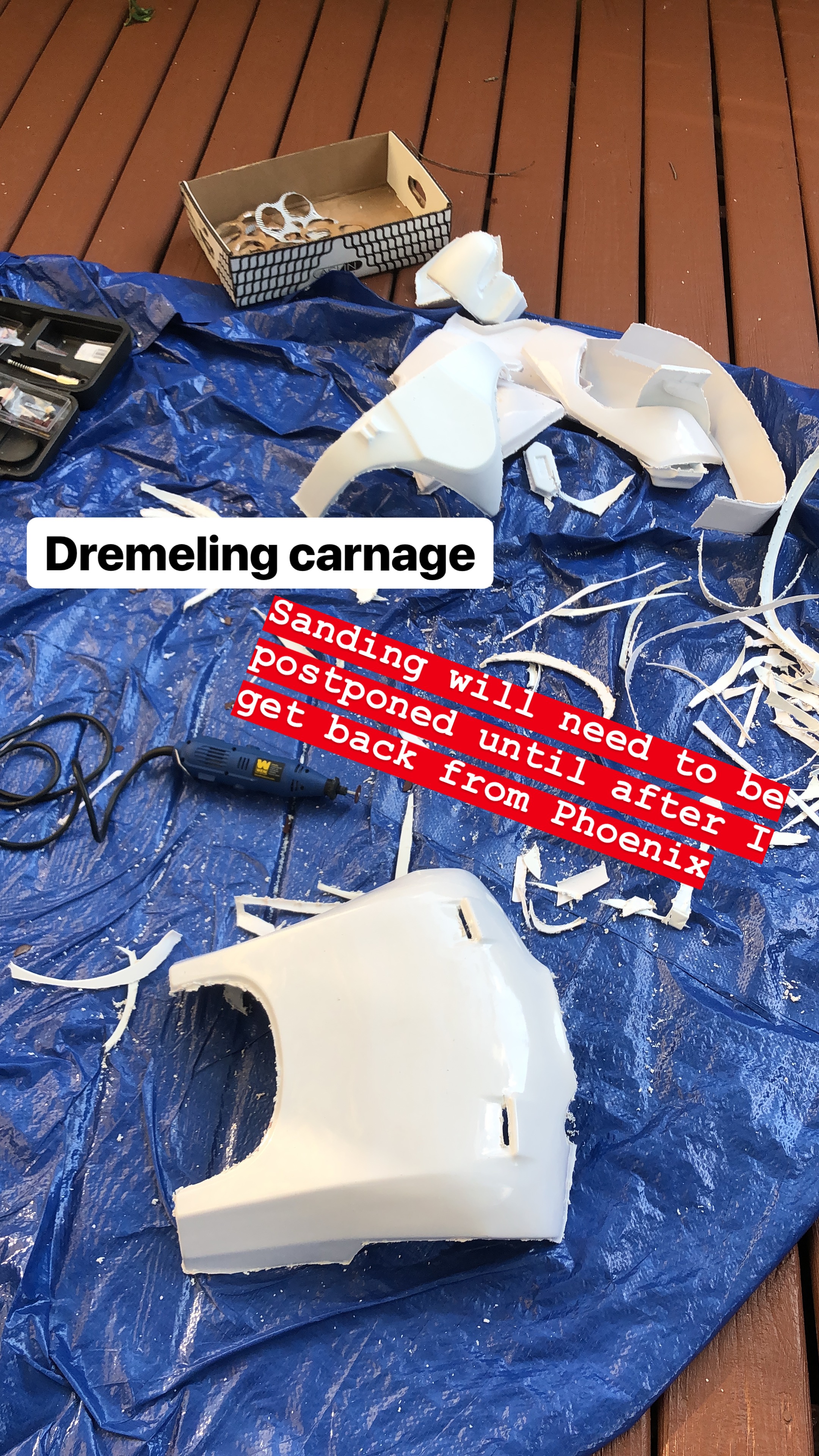

So far, I've dremeled out my Wasted Fett armor, but I ended up ordering a Dremel 3000 so I have a proper sanding drum attachment to smooth out the edges. I've also sanded the armor with 400 grit sandpaper. (Yes, I know the edges are rough, but so was the dremel I was using. Hence, the need for a new dremel for future projects.)

Trimmed my armor some more. Going to go over it with a file and some sanding blocks for one more round before priming it.

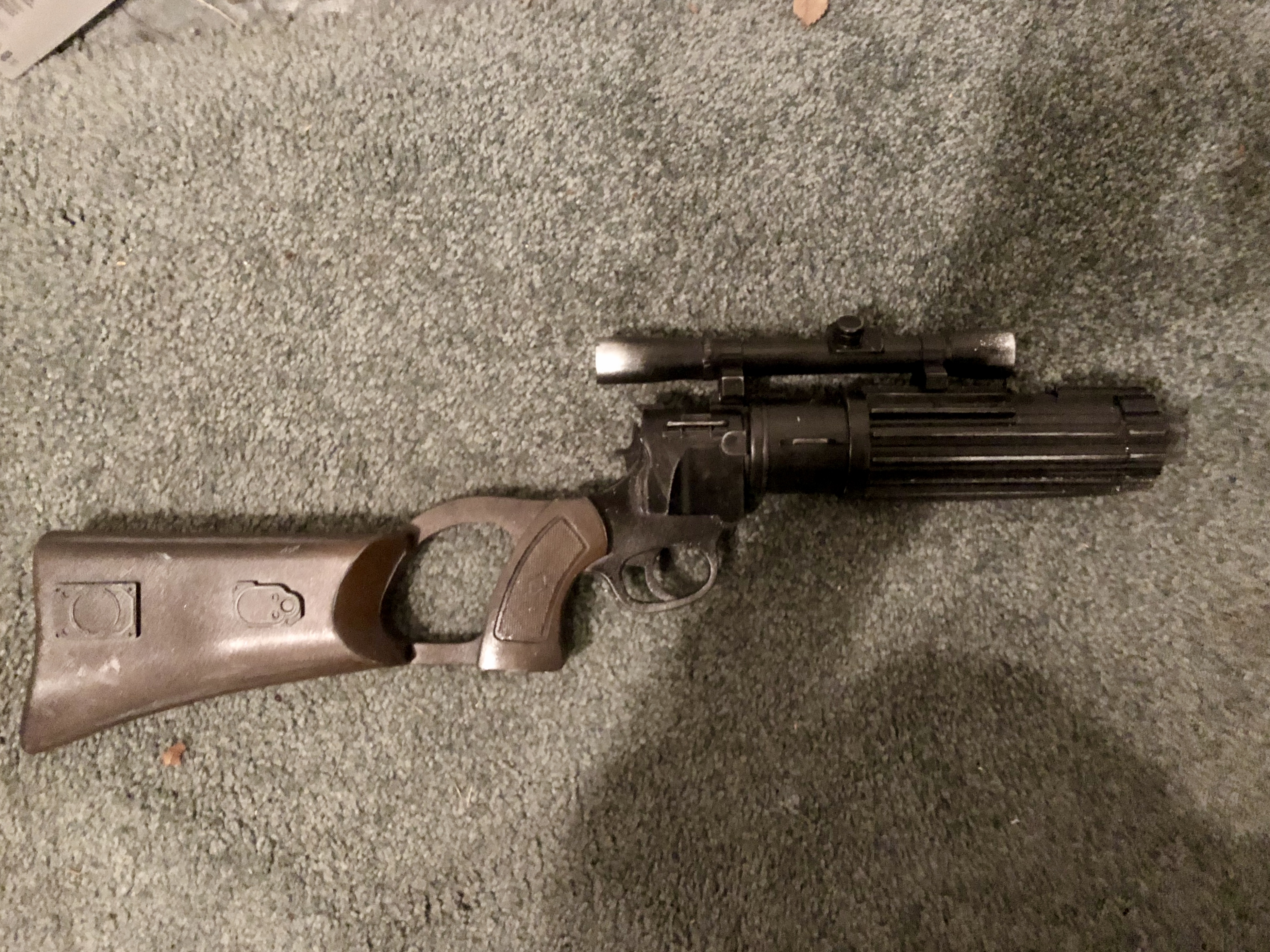

Got my EE-3 Carbine rifle from 208Brigade on Etsy! Really high-quality prop for a very reasonable price.

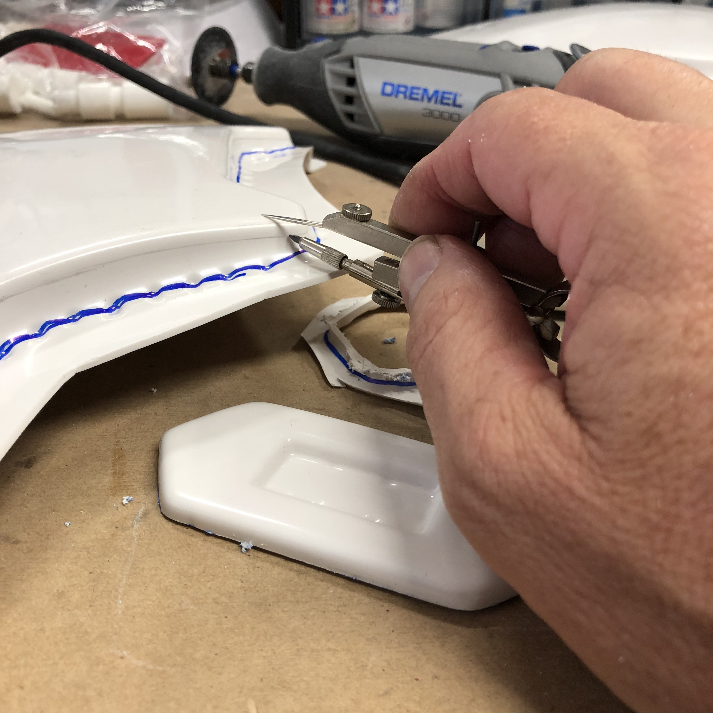

When you get your armor edges down pretty close to where they need to be, you
might try a sanding block with your sand paper to help level out your edges.
If need be you could start out with a course grade to knock the high points down and
progress to finer grits to get your finished edges...
2FD159BA-8A92-4776-8ACD-83AFD9BA40C8.jpeg Check out what I did I used a compass set just over 1/8 or 3mm between the point and the pencil lead. It made a accurate line. Then I went over it with a sharpie. I then cut just on the line with my dremel with a cut off wheel. Use high rpm. Then I used a half round and flat file to bring it down from there. Then used some 100 sandpaper and the some fine after that. This is what worked for me.
BeerFett
View attachment 168143 Check out what I did I used a compass set just over 1/8 or 3mm between the point and the pencil lead. It made a accurate line. Then I went over it with a sharpie. I then cut just on the line with my dremel with a cut off wheel. Use high rpm. Then I used a half round and flat file to bring it down from there. Then used some 100 sandpaper and the some fine after that. This is what worked for me.

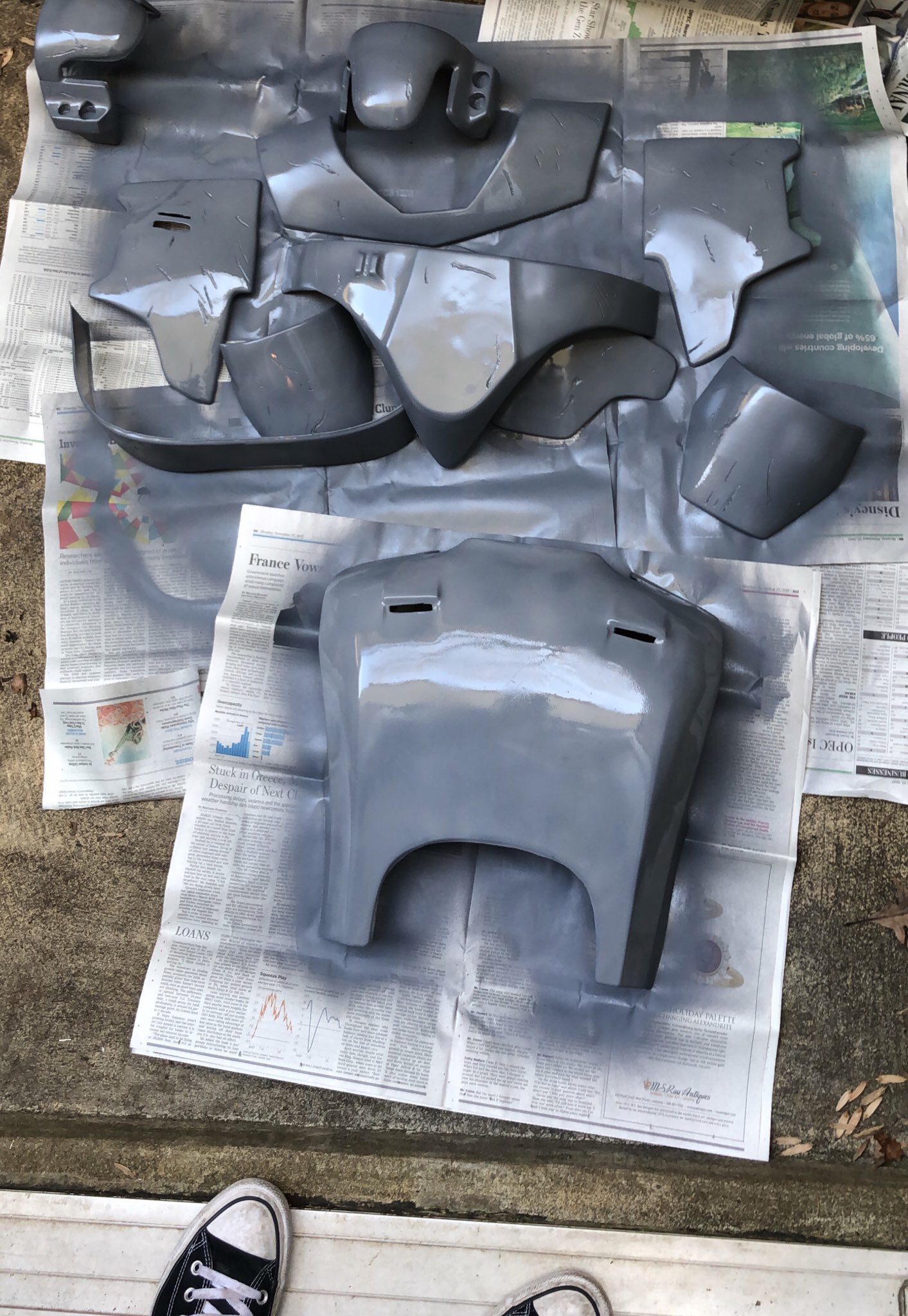

Finally got around to priming the armor today! Still need to do a second coat and apply the two coats of metallic lacquer before I can start the masking... but it’s good to see I did enough sanding to make the paint stick :)
