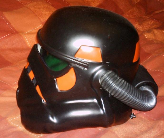

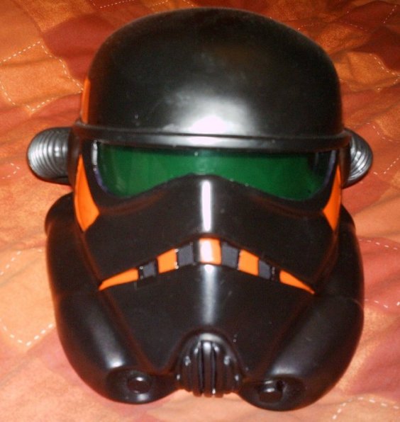

I faced this problem with my slighty too small Stormtrooper helmet, for my Sith outfit. I made two inlet pipes that fed air into the helmet from the back, see the pics below......
The Helmet has 2 fans in the unit at the rear, that blow into the Helmet. This is my Blackhole Trooper Helmet that is part of my sith outfit, from my Darth Valcar's back story..... below is the outfit.......
The fans are powered from 2 9v batterys inside the helmet. The leads are fed though into the back of the housing that sits flush with the back of the helmet. The feed air from a slot that was cut out, and suck it into the housing and blow it down the pipes into the sides of the Helmet. I have found that this not only cools me down, if too hot, but also keeps my visor clear from misting up....
