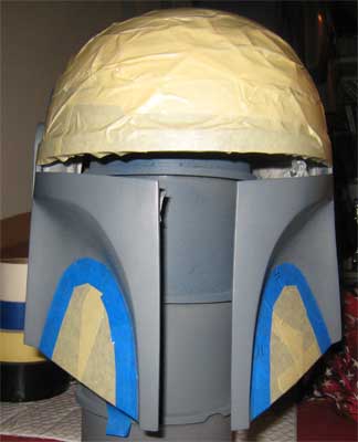

I spent a couple hours masking the cheek curves for painting, but I'm concerned it will look rough when painted, so I did some research and have a new approach.

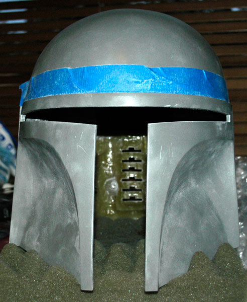

I have traced the curve of each cheek, and am going to cut the shapes from adhesive vinyl. The hard part is to then position the vinyl exactly in the right position, and I now know how! The trick is to wet the cheeks with soapy water, this allows the vinyl to slide a little when positioning, then when its in the desired position, use a small squeegee to remove the excess water & leave for a few hours to dry. I have had a practice & it looks like this will do the job.

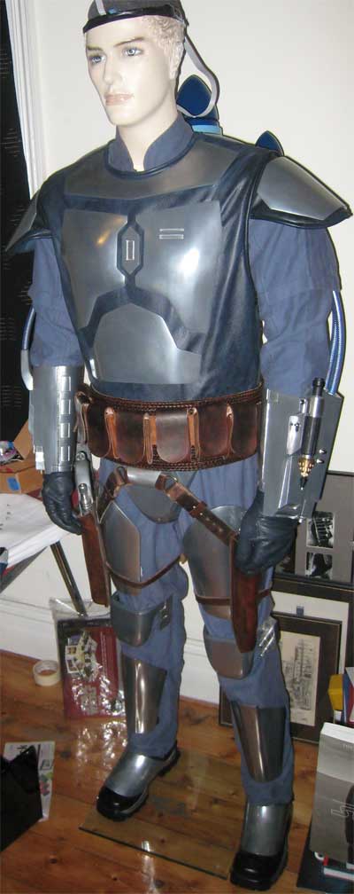

Shots as promised.
The first is the 'from the neck down' finished Jango.
The 2nd shot shows my first attempt to mask the cheeks. I have removed the tape & I'm going to try the vinyl masking right now!
I'll let you know how it goes!

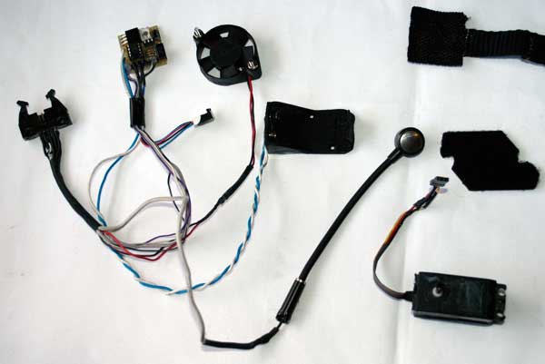

I have removed all the wiring & servo from my 'old' helmet (see pic) & have a new visor ready & waiting.

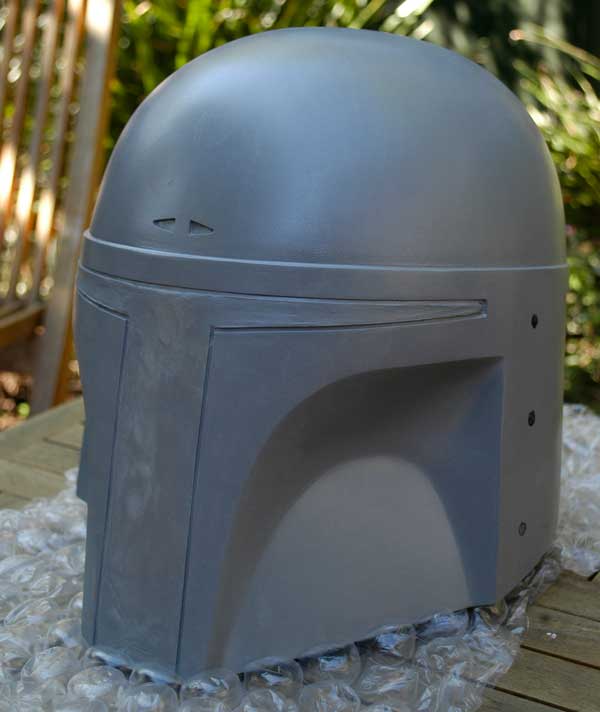

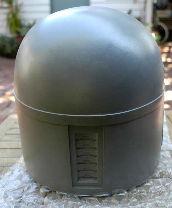

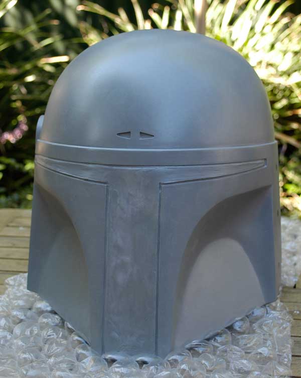

Here is how it looked out of the box (except for the guide marks I added).
Cheers.
I would recommend polishing the whole thing with the sanding sponges and then tape off and paint. No need for primer because you'll already have a smooth surface the paint can stick to. Then hit the unpainted parts with the steel wool once the paint has dried. I'd even lightly hit the painted areas with the steel wool to get all the dust specks off, and then buff the paint back out for some shine with some rubbing compound. It's exactly what I did with the one I painted. http://www.thedentedhelmet.com/showthread.php?t=30075

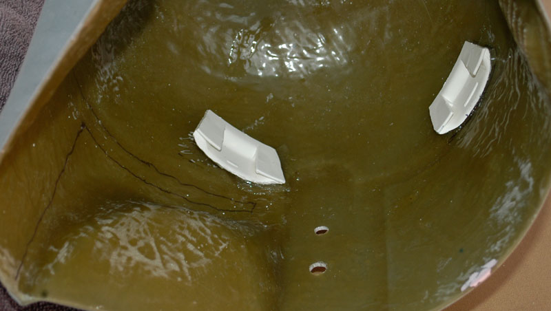

OK, I have the clips to hold the helmet liner in place.

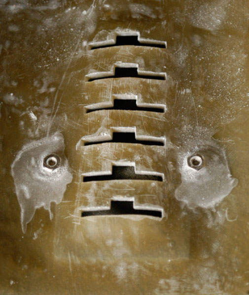

The bolts to hold the fan are in.
The 'ears' have been aligned, gaps filled, holes drilled & it all bolts in place.

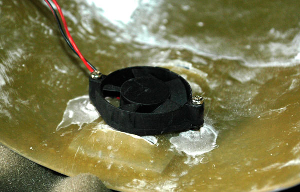

Here are a couple shots showing the bolts I glued in for the helmet fan attachment.
About the fan, I cut two corners off a square PC fan to keep it lean & change the look from a common item.
