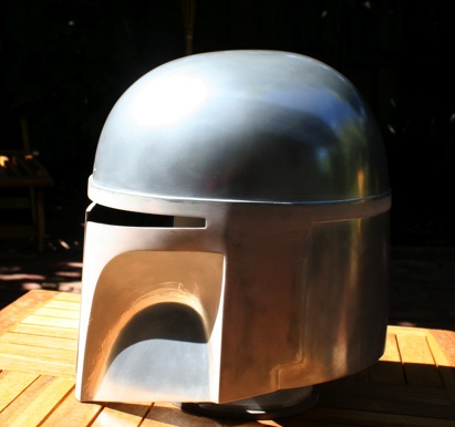

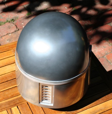

On that topic, after much filling, sanding and failed Rub'n Buff attempts, my BKBT Jango bucket is ready to paint.

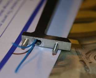

I have installed (and slightly modified) the Rangefinder electronics and have hollowed out my aluminum RF stalk for the wiring.

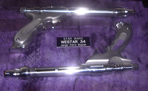

For fun, here is a pic of a nice set of Jango blasters I got a few years ago, anyone here know the maker?
They look fantastic & have solid metal grips giving them a nice balance. Here is a pic of the grips being made.

awsome job cap'n, look forward to seeing progress. Maybe i missed it in the first post, but where did the bucket come from? looks awsome
The bucket is from the 2nd run of the BKBT Jango. It has a few slight differences to the first, mostly in the 'cheek' thickness & earcaps.
And it came with that sweet metal RF stalk!
Also, most here would know, BKBT is a pleasure to deal with.

:eek: :love :eek: :love HOLY HOTNESS BATMAN!
Dude they are some ultra sweet pistols, even more so becasue they break down... if you ever find who did these please let me know, i am after these pistols now like a moth to a flame....
The Blasters were from an e-bay seller named Roger, about 3 or 4 years ago. He claimed that only 3 sets were going to be made.
And they were very expensive....
Anyway, I finally found his contact info, so you got a PM.

Thanks GCNgamer, I was inspired to drill-out the RF stalk after I saw it done here recently.
All it takes is a long drill bit & a steady hand.

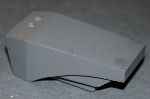

I have modified my BM hollow raingfinder to give it a more Jango look, extending & thickening the lower screen housing.

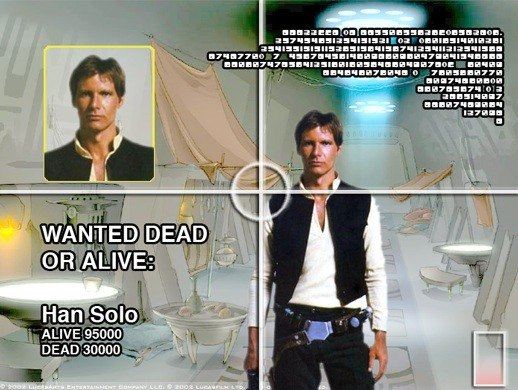

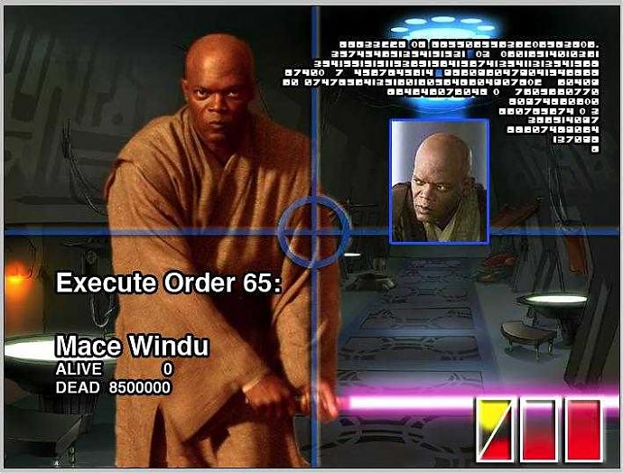

I have slightly modified the Hyperdine Labs RF board. It controls the RF servo & provides 2 blinking circuits for the LEDs. But I also want to include the white backlight for the RF screen. Here is a demo pic (from my BOBA) of the image I'm going to put into the RF screen, made in Photoshop. Any suggestions of who to put in the pics? Mace, Obi Wan, Winona Ryder...

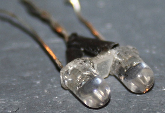

So I set 3 white LEDs inside the RF with a tilt switch (2nd Pic)
On the RF board (3rd pic) I have gone against the provided instructions & done the following:
The 2 blinking LEDs & 3 White LEDs all share a common negative (White Wire).
The 2 Blue LEDs have a Positive each (Blue wires).
The white LEDs are powered from the Radio unit power output pin with a resistor to drop the voltage. I have let this set-up run for 30 minutes and had no problems. All 4 required wires fit in the hollow stalk.
I have sealed the RF & will give it one more coat of primer before a final sanding. I hate the look of a RF top that looks like it opens & have gone to much effort to seal it good. The blue LEDs slip in from underneath & have been set & glued together to sit correctly when inserted (see pics). Adding the LEDs after painting gives a nice finish.
Anyone done it like this before? I suspect someone here has.

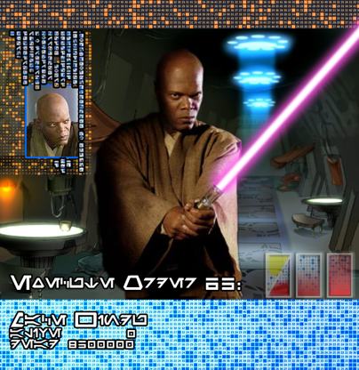

Here are a couple Jango RF images I did today.
I will replace the english words with symbols when I like what I have.
The plan is to take a few slides (REMEMBER FILM) of the comp. monitor & trim them up when processed.
Any comments / ideas / recommendations?

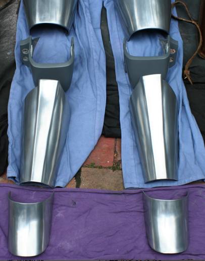

I worked on the leg armor today, it's ready for the first coat of spray putty.
Yesterday I Rub'n Buffed my boots & added the studs for the armor.
It's all coming along.

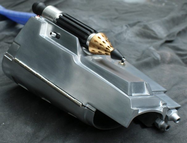

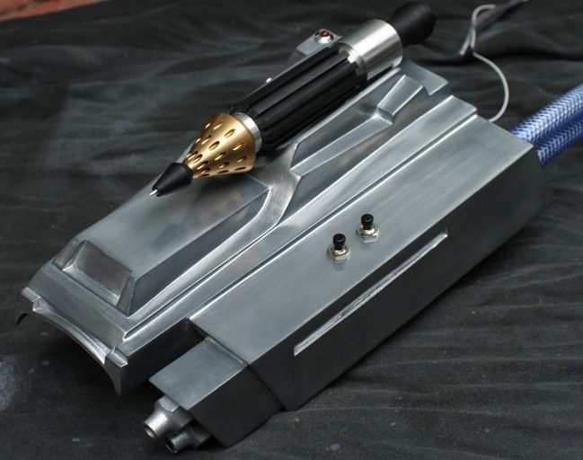

I decided to strip-back my MOW gauntlets & have another go at them. I am now Very Happy with the finish. Added all metal details & working switches to activate the Helmet Range-finder servo. Some light weathering to come...later.
Also, I (changed & then) photographed Slides of the RF pic & have installed a slide into the FR top. I haven't turned the interior lights on yet as the RF top is not connected at the moment, but it already looks cool.

Thanks JangoUri,
I have used a Russ Replicas' Gauntlet rocket as it's slightly bigger than the DS and looks more in scale with my Man Of War Gauntlets. The Dark Side rocket is a thing of beauty, just a tad too small for my MOWs.
The left Gauntlet switches are from an Australian electronics distributor called Radio Parts. Here is a link to the switch on their web-page.
http://www.radioparts.com.au/ProdView.aspx?popup=1&Category=SX091705&Product=41162017
And since I'm posting....Here is the New RF Pic I have installed in my RF top!
It has a bit more play in the edges for cutting to size & shape.
